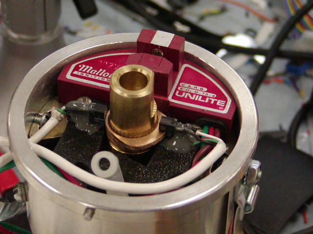

For the stock D-Jet, the ECU gets the signal to fire the injectors from a set of mechanical breaker points inside the base of the distributor. There is nothing wrong with the factory method except for the fact that if you want to run the D-Jet injection, you have to keep the factory distributor...not anymore (IMG:http://www.914world.com/bbs2/html/emoticons/smile.gif)
I have successfully been able to electronicly trigger the ECU from a pair of optical sensors inside of the billet Mallory distributor....so far I have only put a few miles onto the car with this setup and I don't know how it'll work when the temperature is much higher (currently it is 45° outside.....)
it's ugly right now, but give me some time to clean it up... (IMG:http://www.914world.com/bbs2/html/emoticons/smash.gif)
(IMG:http://www.914world.com/bbs2/uploads/post-2-1106100569.jpg)
So for my ignition, I have the Mallory distributor, accel coil and new 8.5mm plug wires....starts right up and idles fine, but I might install a CDI box anyways...

QUOTE (DJsRepS @ Jan 23 2005, 08:14 AM)
Nice work there Mueller! Keep us posted how it run's out. What's on the shaft that triggers the sensor's. Did you build somthing in the rotor? And the pickup's what are they? Do they hook up directly to the FI harness and have there own fast acting gate switch or do they connect to a board you made then to the FI / ECU ?
the wheel on the shaft is just a bronze flanged bushing that I filed down....
no seperate PCB board, it's just a few resistors and a transistor....the transistor acts like an electronic valve...when the wheel blocks the light from one side of the sensor, the transistor gets "turned" on which allows a ground path to flow from ground to the ECU, triggering the ECU to fire the injector...the transistor is sorta like a relay, but it's done with no moving parts inside of it..
the red Unilite sensor is just as simple in operation.....only 3 wires and about $2 in electronic parts (thing costs from $90 to $120 at the stores)
these are very simple as well
brown wire ground, red is power (+ on the coil), green goes to the (-) coil...when the car is turned on, the green wire has 12 volts as does the red wire..the coil is "even" and happy .....when the rotor goes past the "lights" and has an open window, the 12volts going to the green wire is turned off, the coil is no longer even and the windings freak out releasing the energy within producing spark......sorry for the simple simon description, LOL

Mike,
What timing relationship did you keep between the "ignition points" and the the "trigger" signal??
With your setup can that relationship be varied??
Ken

QUOTE (KenH @ Jan 23 2005, 02:54 PM)
Mike,
Ken
currently I just threw the wheel in the dizzy.....I know with the stock unit there is a "slight" relationship of the timing, I say slight, cause the fuel injects right before the intake valve opens on 1 side, however on the opposite bank, the fuel is injected at the intake valve while valve is closed (exhaust stroke I think)
this happens on both banks...so, 2 cylinders get "fresh" fuel, while 2 valves always get a shower until the valve opens....with the L-Jet, all 4 injectors spray every time there is an ignition event
I honestly do not think there would be any measureable differance if I did index the new triggers to match the trigger timing of the stock dizzy
since the ignition advances (as does the L-Jet) with my setup the injectors advance also, with the stock D-jet, the injectors are always fixed relative to crankangle
I can play with the staging, but unless the car is on a dyno, I wouldn't be able to tell the difference and even on a dyno, I doubt we could see it as well

I was just looking at the stock trigger points....the timing relationship on those do change with wear of the phenolic blocks....

Some time ago - sombody indicated there was an optimum relationship, depending on driving conditions. I will try and find the info.
Another way to do it might be to "trigger" an IC "divide by 2" off the points and feed that to the ECU. Hummm

QUOTE (KenH @ Jan 24 2005, 08:46 AM)
Ken
If there is an "optimum relationship" between timing of valve events and timing of injection events, it's mostly theoretical, and will only be effective at light loads and low revs.
L-Jet works very well, and doesn't time injection events with spark events. It only uses the distributor input to determine engine speed. K-Jet also works very well, and it's injecting 100% of the time. No timing of injection to engine events at all.
True "sequential injection", which times injection events to valve events, can help a small amount near idle for smoother idle quality. It also has some effect on reducing idle emissions. If you hunt up the DIY EFI email archives, or go over to the MS EFI board, you'll find the details. The short answer is that the injectors are open for so much of the cycle at higher loads that timing them simply makes no difference.
