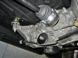

I found the clutch cable under the car
I tightened it 3 turns but felt no improvement.
I will turn it a few more turns this weekend to see if the engagement point moves closer to the drivers position.

Well I checked for the clutch tube movement did not see any.
I crawled under the car
Grabbed the clutch cable with a set of vice grips to stop it from spinning
While I tightened the 2 nuts on the opposite side of the shifting fork.
I only have 3 more threads left
Jumped inside and the clutch feels much better.
