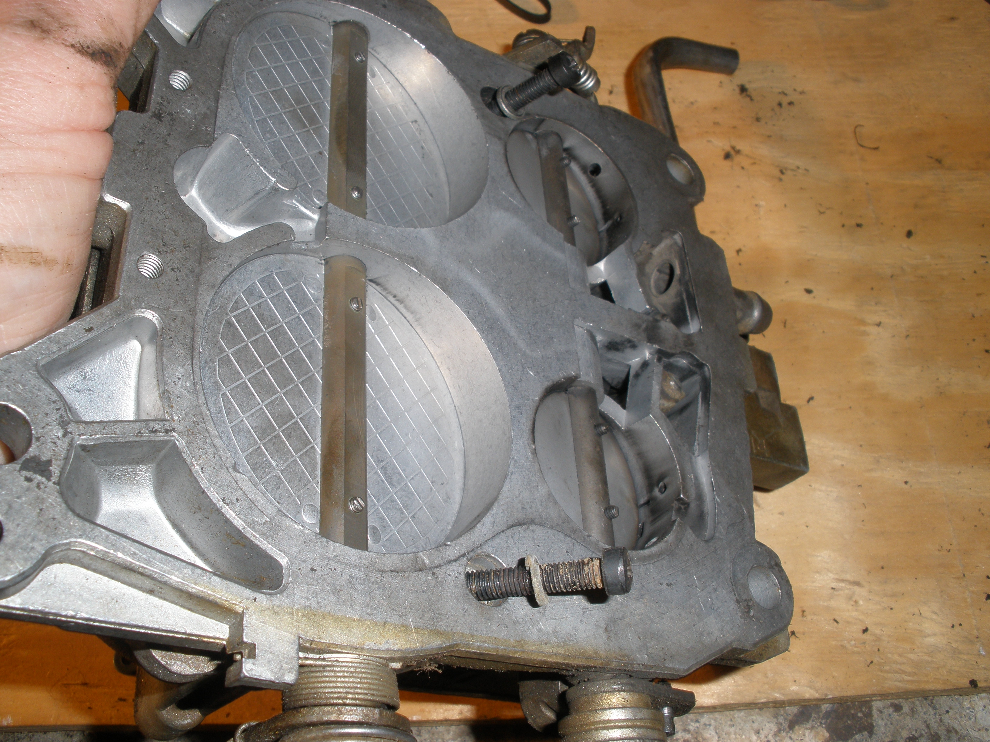

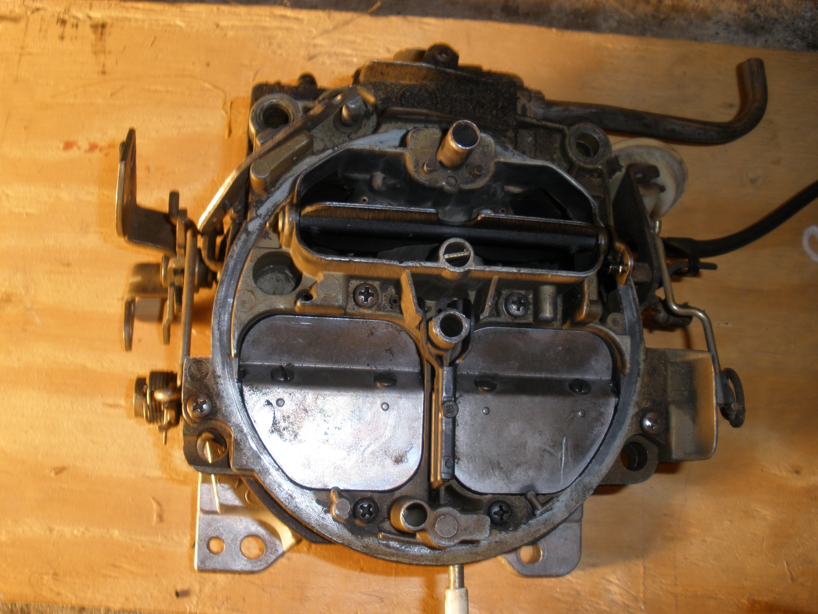

As previously stated:
"Baffles" (and that's what the diagram refers to them as) whch is to say the lower flaps in the base of the carb have had the choke/preventer pin removed (ages ago) so that's not holding them back.
The servo you are referring to for the upper "air flaps" is holding them closed (when hooked up) no matter how long you allow for warm up nor within any throttle position after warm up (which means the port from which a vacum source is powering that servo is not un vaccuming in any range or basically locked when attached to the correct vacum line) I have disabled it and the servo unloads allowing the air flaps to open. But that said, a bog is surely to occur as the air flaps will bounce during shifts.
Attached Image Scondary air "baffles"
Attached Image Secondary "air flaps"

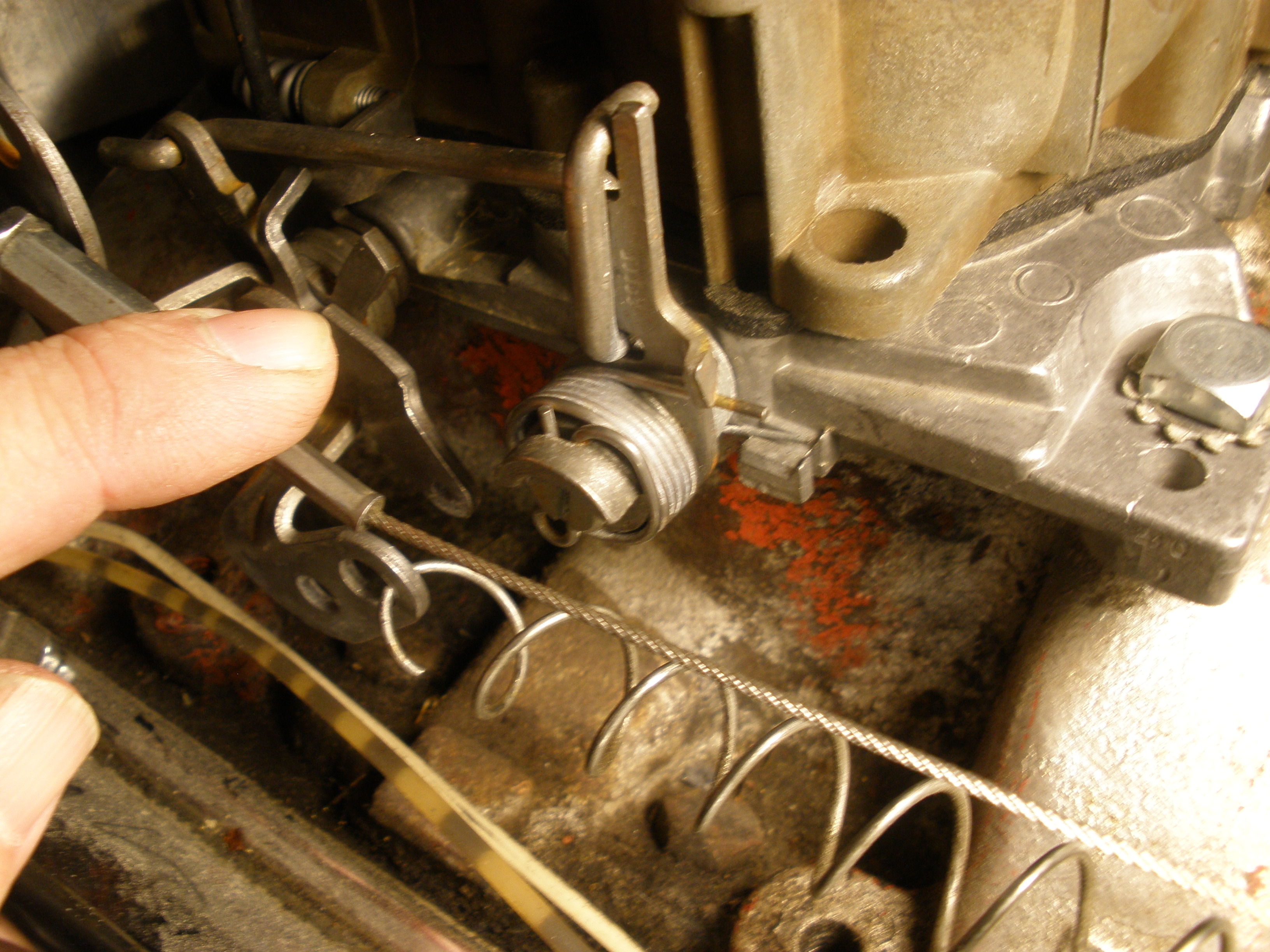

Here is the throttle linkage that controls the primaries and the rod controls the secondary baffles (the flaps located down inside the carb).
When the linkage is fully opened it fails to wide open the secondary air baffles. You can manually open them by hand wide open. And no, the gasket is'nt preventing them as this was my first thought so I tested with the carb off the engine. Same results. Messing with the rod will only achieve premature opening of the secondaries before the primaries have fully opened (creating a bog)

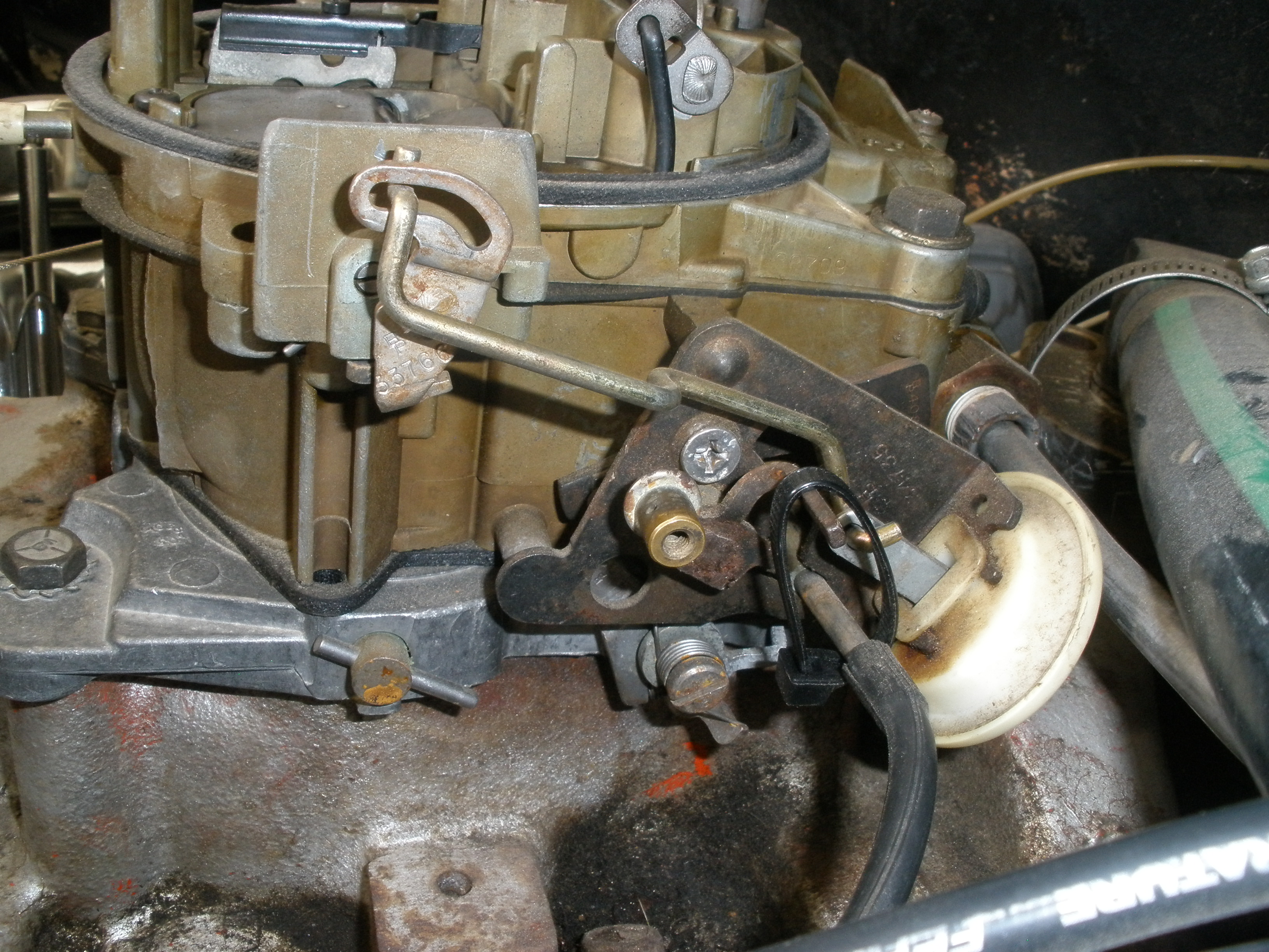

And here is the dashpot that does not release (when hooked up) thus freezing the secondary upper air flaps (different than the lower secondary plates called "baffles")
Suffice to say the zip tie from the PO was a lame attempt at addressing a malfunctioning choke. That is a seperate issue that I have rectified by installing a simple (and stock) divorced choke system and had nothing to do with the secondary upper air flaps.

This was the problem. The spring that creates tension on the linkage that opens the lower secondaries did not have enough tension when who ever last (before me) had the carb apart. Fixed the problem. Lower secondaries now open almost 90 degrees.
