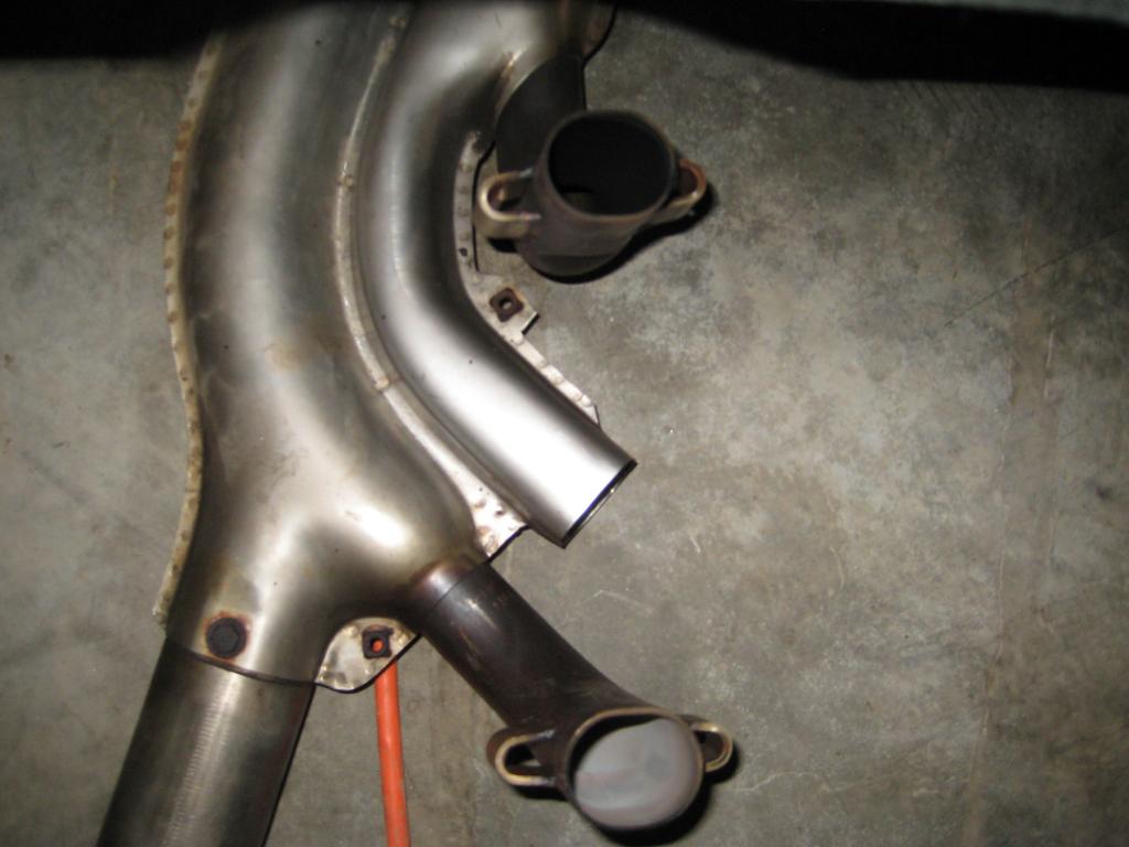

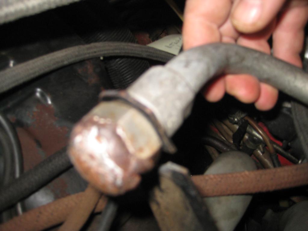

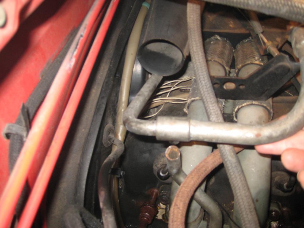

So I ordered new copper exhaust gaskets (and new nuts) thinking that maybe I had a leaky gasket. The new parts arrived today so I removed the passenger side heat exchanger and to be honest, there didn't look like any leakage between the header pipe, gasket, and head.

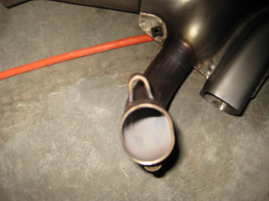

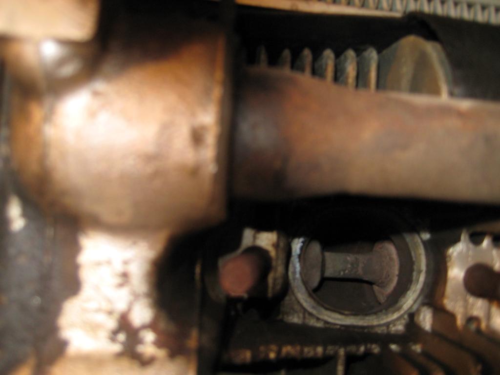

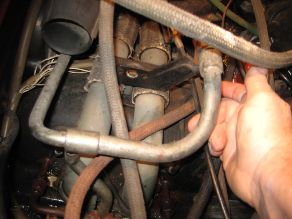

I started the car and immediately knew that the exhaust seals weren't the problem. I had read about some noise problems that were due to the air injection components of the 2.0L 914, so I began tugging on the metal lines. Here is what I discovered:
(IMG:http://www.914world.com/bbs2/uploads_offsite/i921.photobucket.com-7636-1411089036.4.jpg)
(IMG:http://www.914world.com/bbs2/uploads_offsite/i921.photobucket.com-7636-1411089036.5.jpg)
(IMG:http://www.914world.com/bbs2/uploads_offsite/i921.photobucket.com-7636-1411089036.6.jpg)
Not only had the metal tube on the passenger side broken off, but the mount over the air intake tubes had also broken off. The breaks were not visible and the LOUD valve train noise didn't need much of a gap to sound like there was no exhaust on the car!
I had a lot of rust on the couplers, so I have sprayed them with penetrating oil and will be welding or brazing the parts back together shortly.
