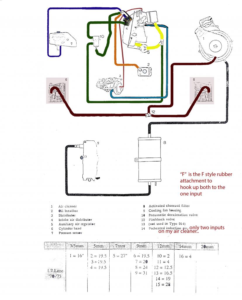

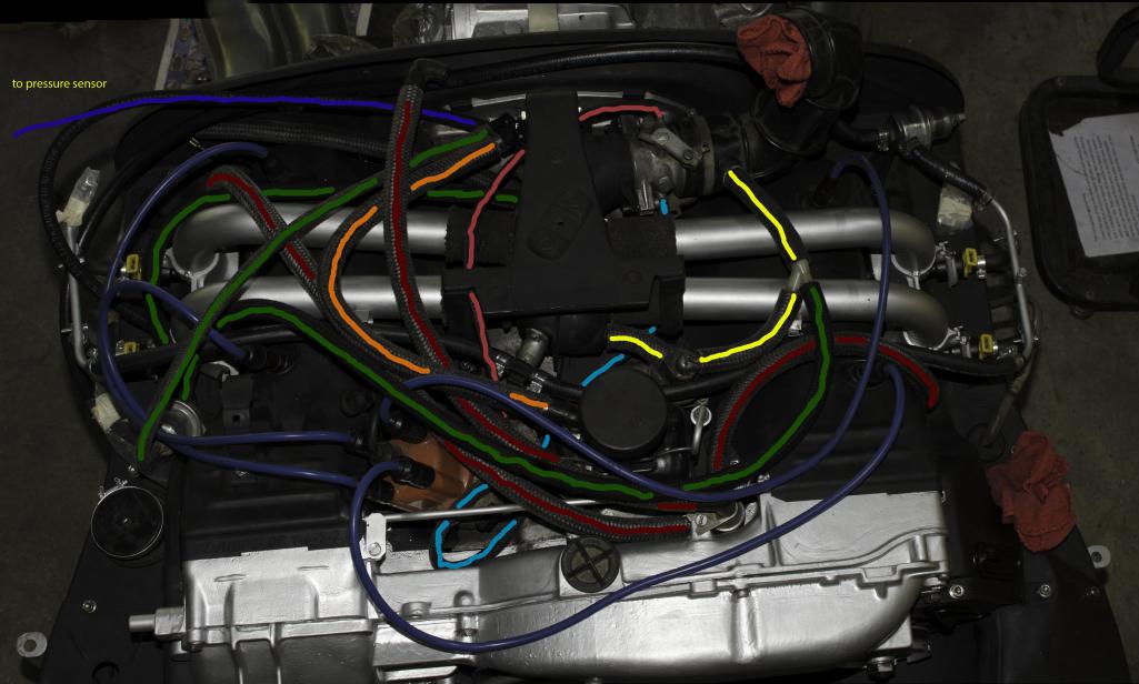

just checking with everyone for your input as to correctness of
the vacuum lines.
1973 1.7L

That looks pretty much like what I have except for the connection to the decel valve. Mine goes to a tee between the aux air regulator and the air box. BTW, that tee is NLA, so the F connector is probably a good alternative.

Here is the 1.7 diagram from Jeff Bowlsby;s site.
http://bowlsby.net/914/Classic/TechNotebook.htm
(IMG:http://www.914world.com/bbs2/uploads_offsite/bowlsby.net-10496-1411229516.1.jpg)
