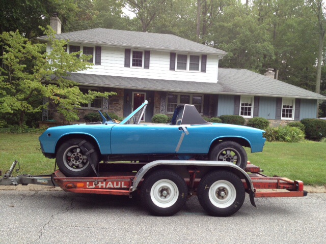

We had the opportunity to buy this fairly original '71 914 recently. The car is fuel injected, complete and everything works, right down to the light between the seats and the bell when you open the door. The car is almost completely rust-free. We are looking forward to taking it back to original color (Gemini Blue) and doing the restoration.
We are hoping to finish it in time for next year's (2015) Octeenerfest., eventually. The primary goal is to drive it to the 100th running of the Indianapolis 500 in 2016, with my son. But, in the back of my mind I would still like to make a cross-country trip in a 914 someday. Maybe this is the car to do it in. I will post our progress here.

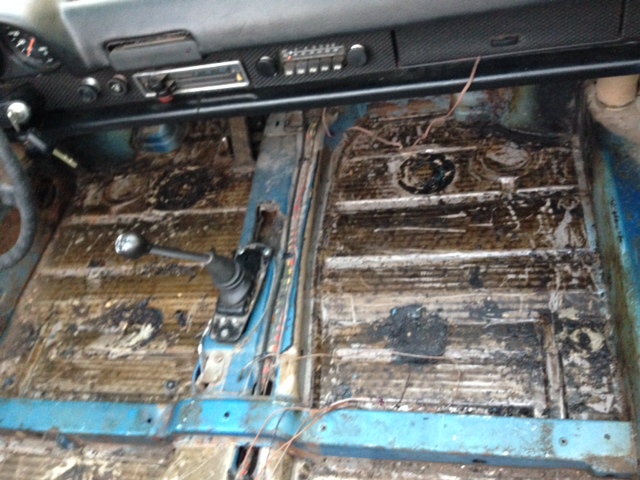

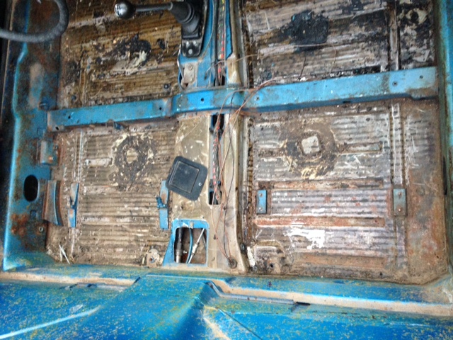

Yesterday we started to strip the tar out of the floor pans. A heat gun and a scraper makes the job go fairly quickly. It took about 3 hours to get them to this point. Now we need to strip them to bare metal.

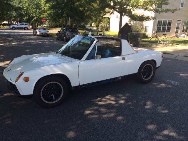

Great color. Here's mine.

Very cool. This is a Gemini Blue car? I have been looking everywhere for a picture of a narrow-body 914 that was definitely Gemini Blue. So we could see what the color will look like.
It had a respray so the exterior wasn't exactly the same as the interior but my firewall looks identical to yours. The car had extensive rust and terrible welded patches so I cut it up into little pieces so other cars could live.

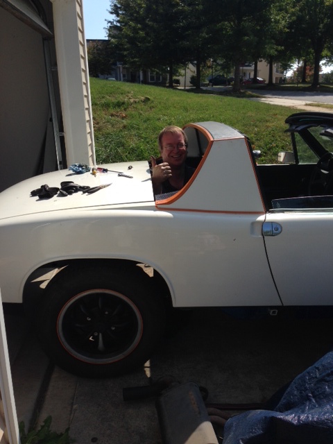

Somehow got locked out the rear trunk. I know it worked when we bought the car. But, when I went out to the garage this week I couldn't get in. I read quite a bit (on 914world) about going through the plastic roof holder things with a very long extension. I finally decided to drill the lock out. I used a small drill bit, drilled straight through, and then used a screw driver to push the mechanism in. Worked like a charm. But, now I need to replace the lock.

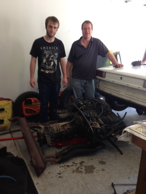

My son is home from college for Fall break. So, we pulled the engine out of the '71 914 to get it ready for restoration. It went well. It always amazes me how easy it is to pull these engines. I remember doing it by myself in the 80s and 90s in about an hour or so. I am a little older now, so it took us about 2 hours.

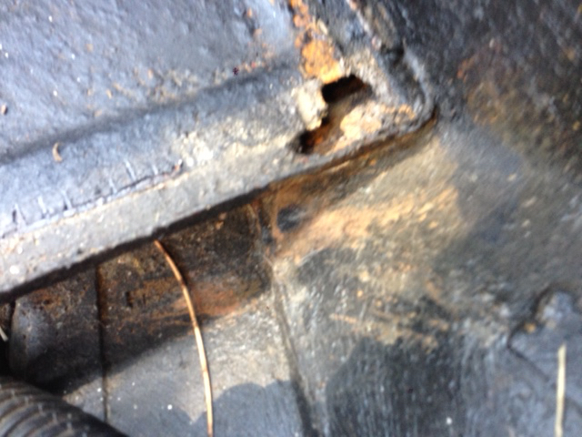

Once the engine was out, I had to jump in the engine compartment and really inspect the hell hole. I had looked at it pretty well with a flashlight before we bought the car. But, you know there are often surprises once you get the engine out.
I can officially say - we have a heaven hole (if that is a term). No rust. Zero. Original metal, no repairs. No rust. Thumbs up.

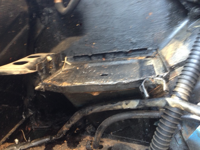

Is it possible that this car has the original battery tray? Does this look original? It has the bracket for the computer box on it. The tray itself has a little rust (3/4" hole) in it. But, it is only in the tray. Should I replace the tray with a new one?
