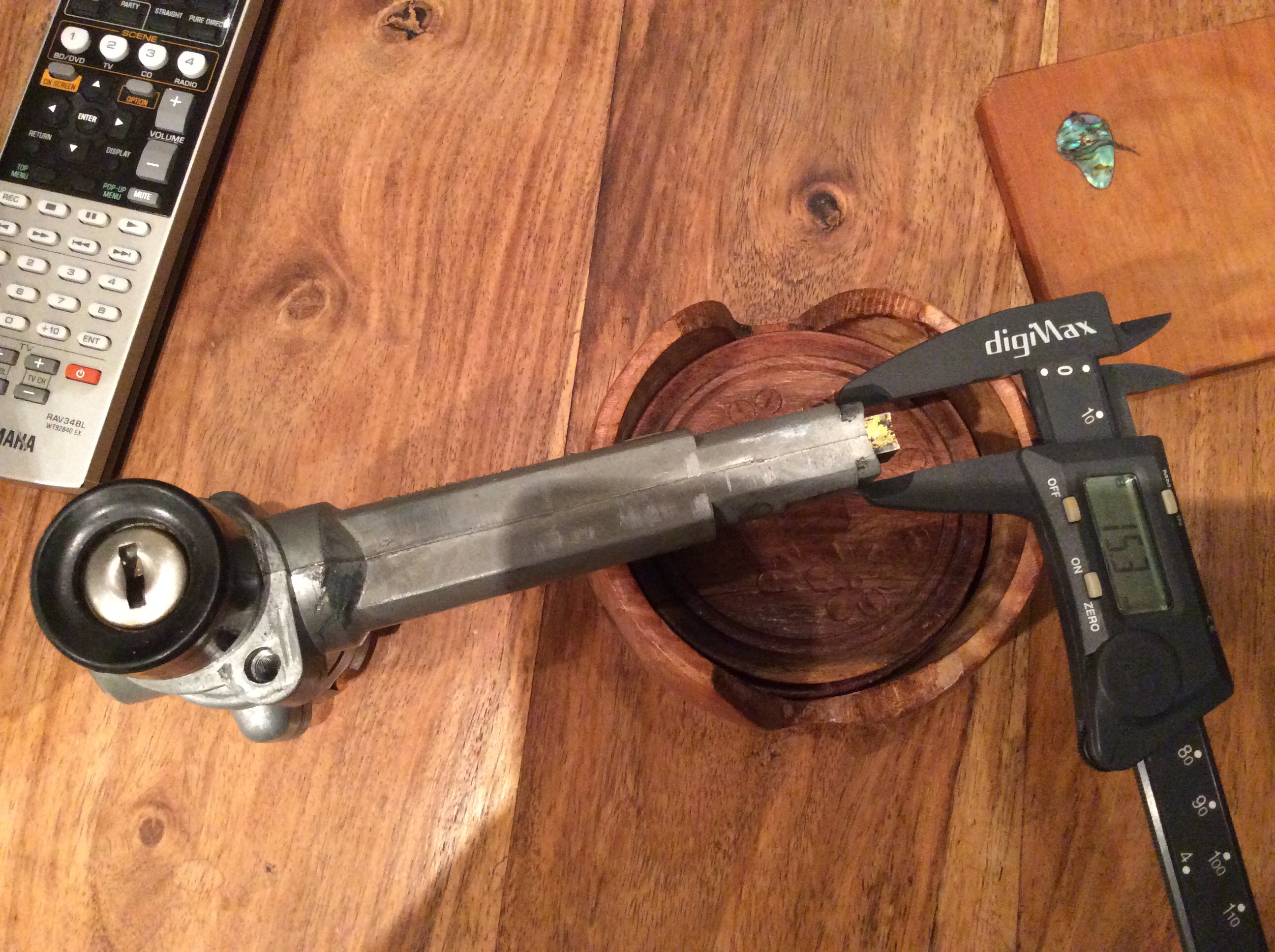

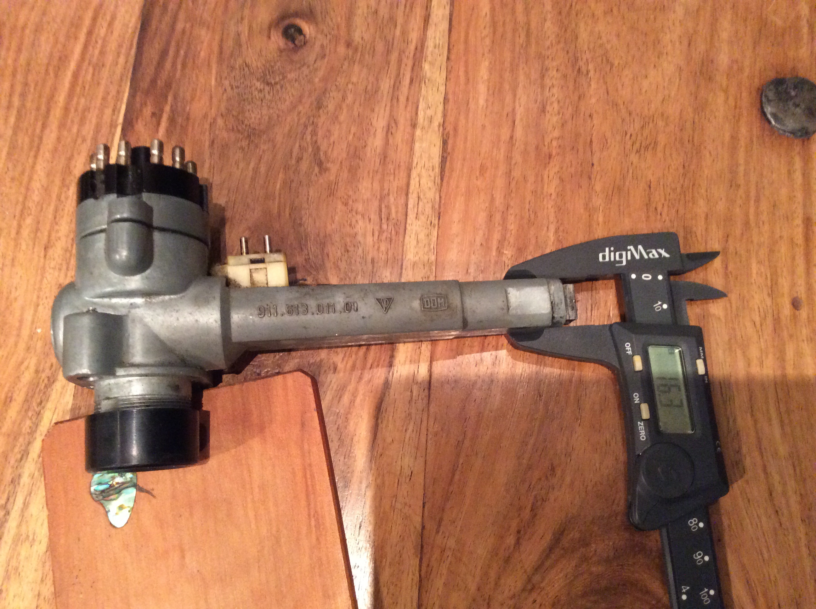

Hi Mark, does this help?
I bought a complete -6 lock set (or at least that's what it was advertised as) of the bay about a year ago - Sir Andy?
Let me know if you need more pictures
Jon

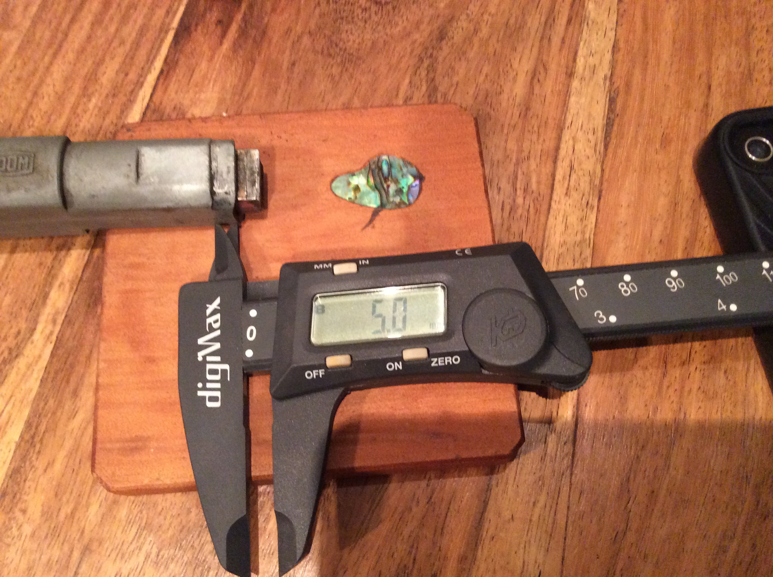

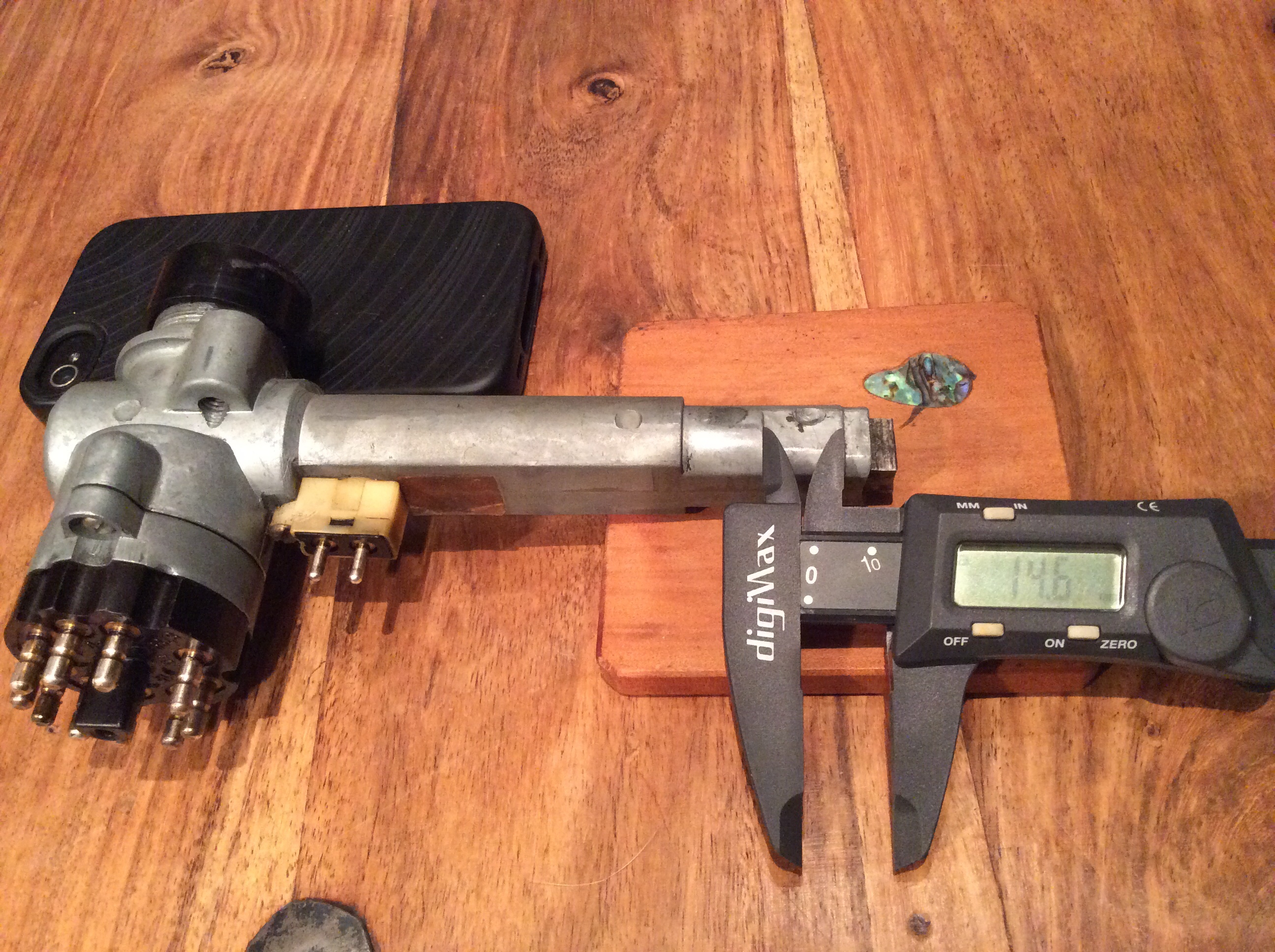

Last 2 pictures, the last one was a bit difficult to take in situ
5mm recess measurement is when viewed from the front of the lock

SixerJ, THANKS! Can you take one more with the part number facing down?

Here you go, should have thought about it in the 1st place

914-6 PET shows the lock assembly as 911.613.901.00. So the one you are using is a later one. There was one assembly for the 65-68 911 column, one for the 69-73 911 column and then 74-89.

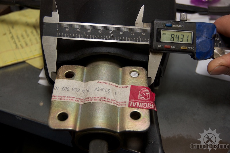

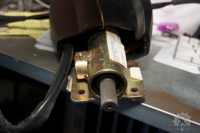

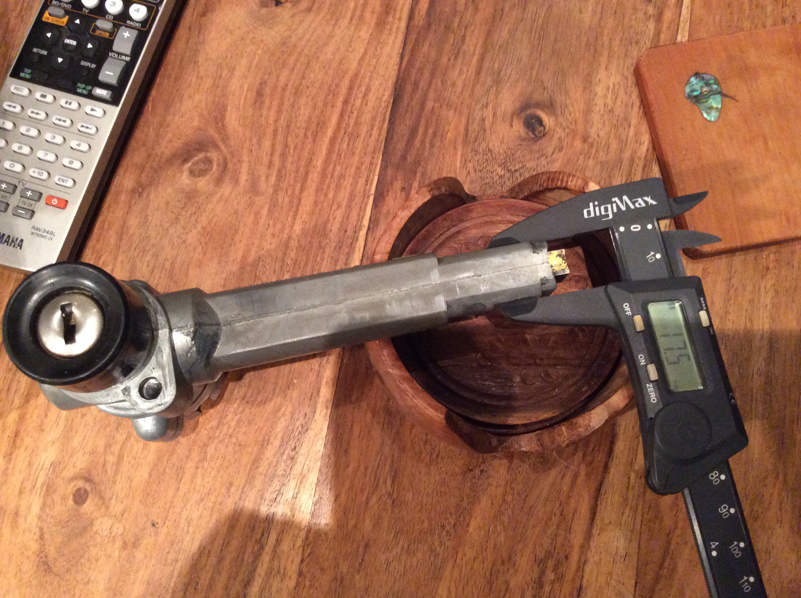

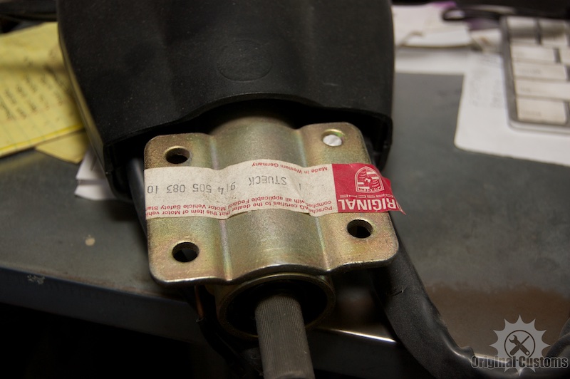

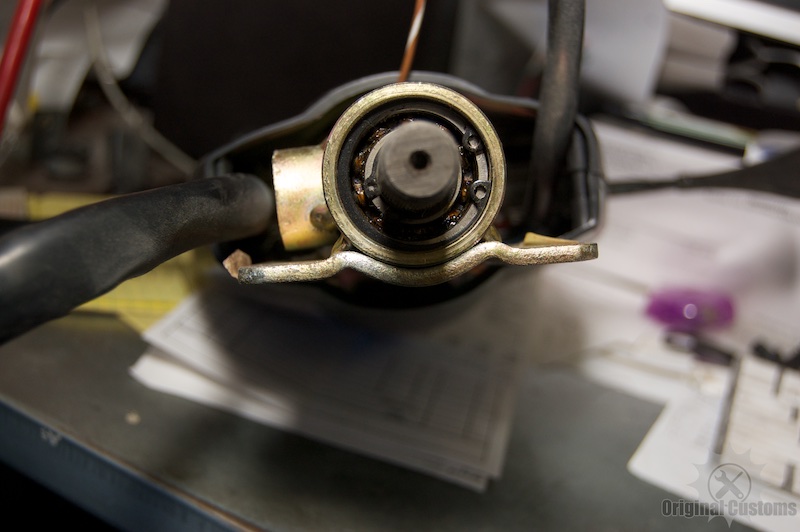

Pictures of the steering column. Let me know what else you need.
