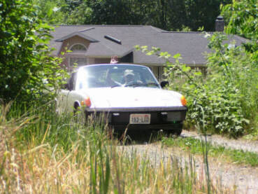

DNHunt   Need some suggestions. This is my driveway. Everyo...   Jun 6 2003, 04:03 PM
ChrisReale   No, you are not crazy, just Autocross-ism-ized. :m...   Jun 6 2003, 04:36 PM
Aaron Cox   pardon my ignorance, :gilloutine: , but i need t...   Jun 6 2003, 04:40 PM
DNHunt   If the Koni sports are on full soft how harsh will...   Jun 6 2003, 04:48 PM
