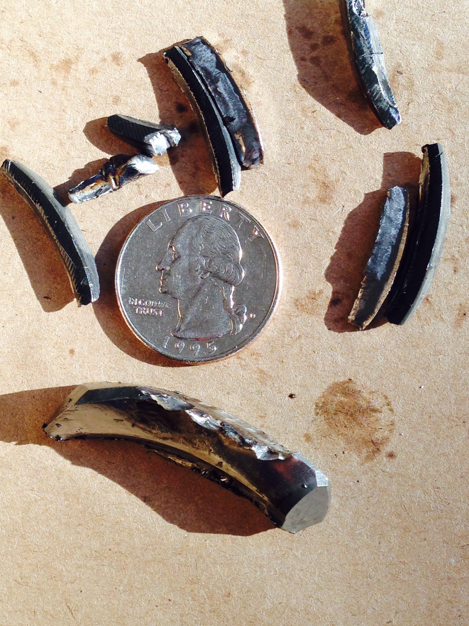

Whats the diff look like? A sheared roll pin at the block in the center of the diff would cause a grenade like this.

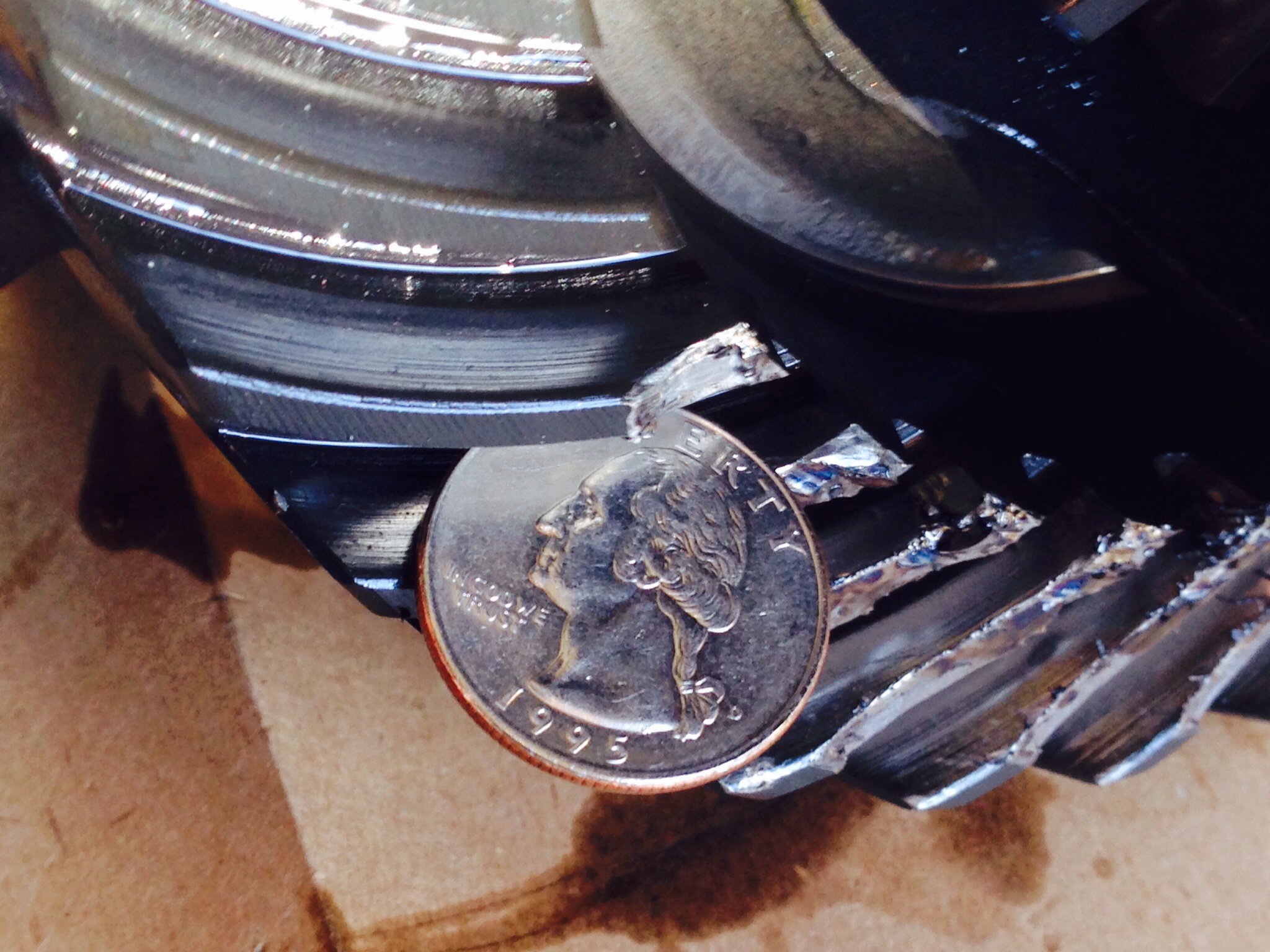

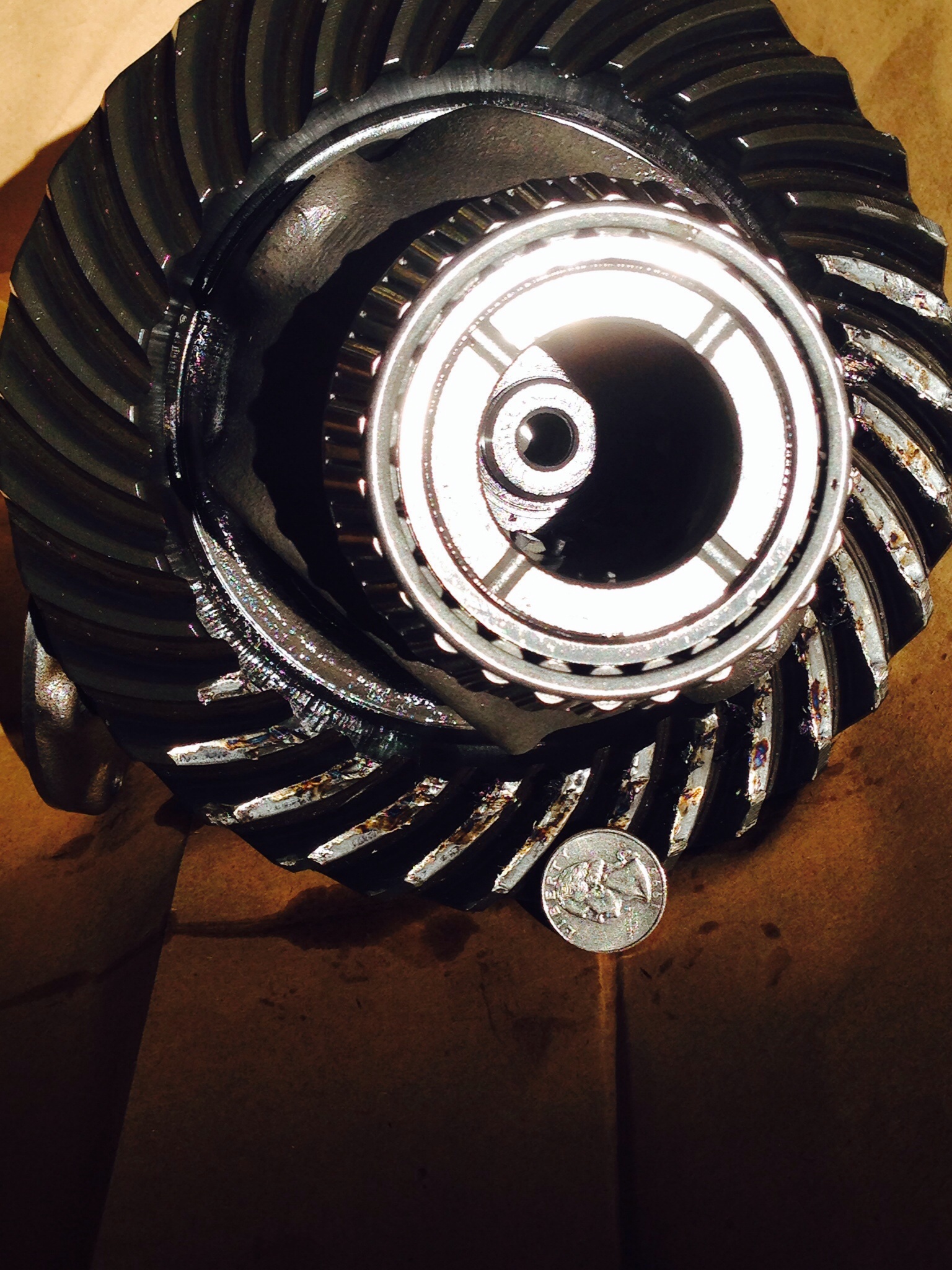

More pics. The big piece is from the pinion.
The small pieces are from the diff. 15 outta 31 teeth shredded. Attached Image

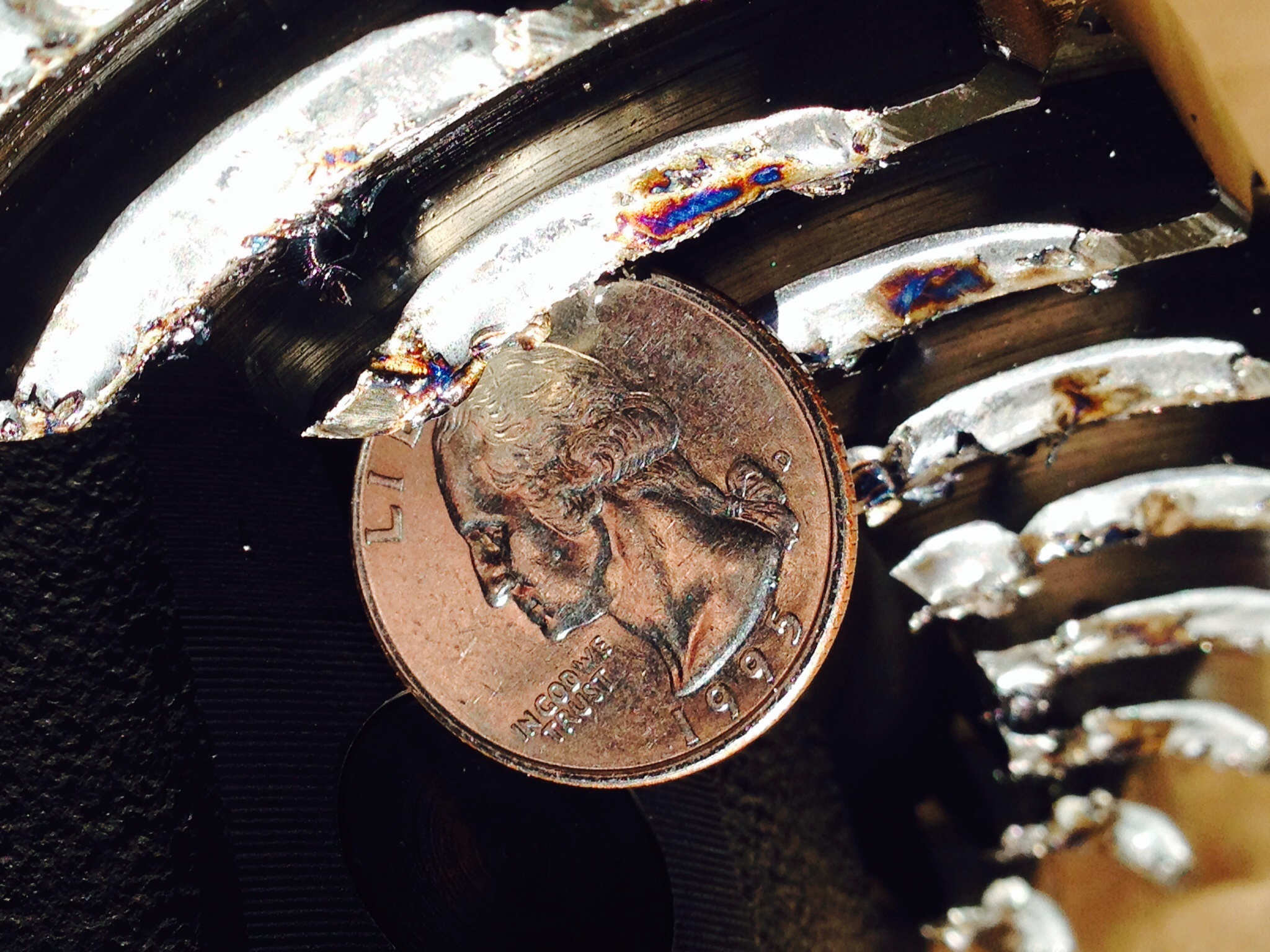

The differential. The quarter is for reference only. It was not in the transaxle.
And now some close ups.
The quarter is underneath the first (or last?) broken tooth on the diff.

Here is a pic of the quarter next to the other side of the diff, where the teeth broke. Attached Image

QUOTE(Hank914 @ Nov 7 2014, 02:50 PM) *
(IMG:style_emoticons/default/unsure.gif)

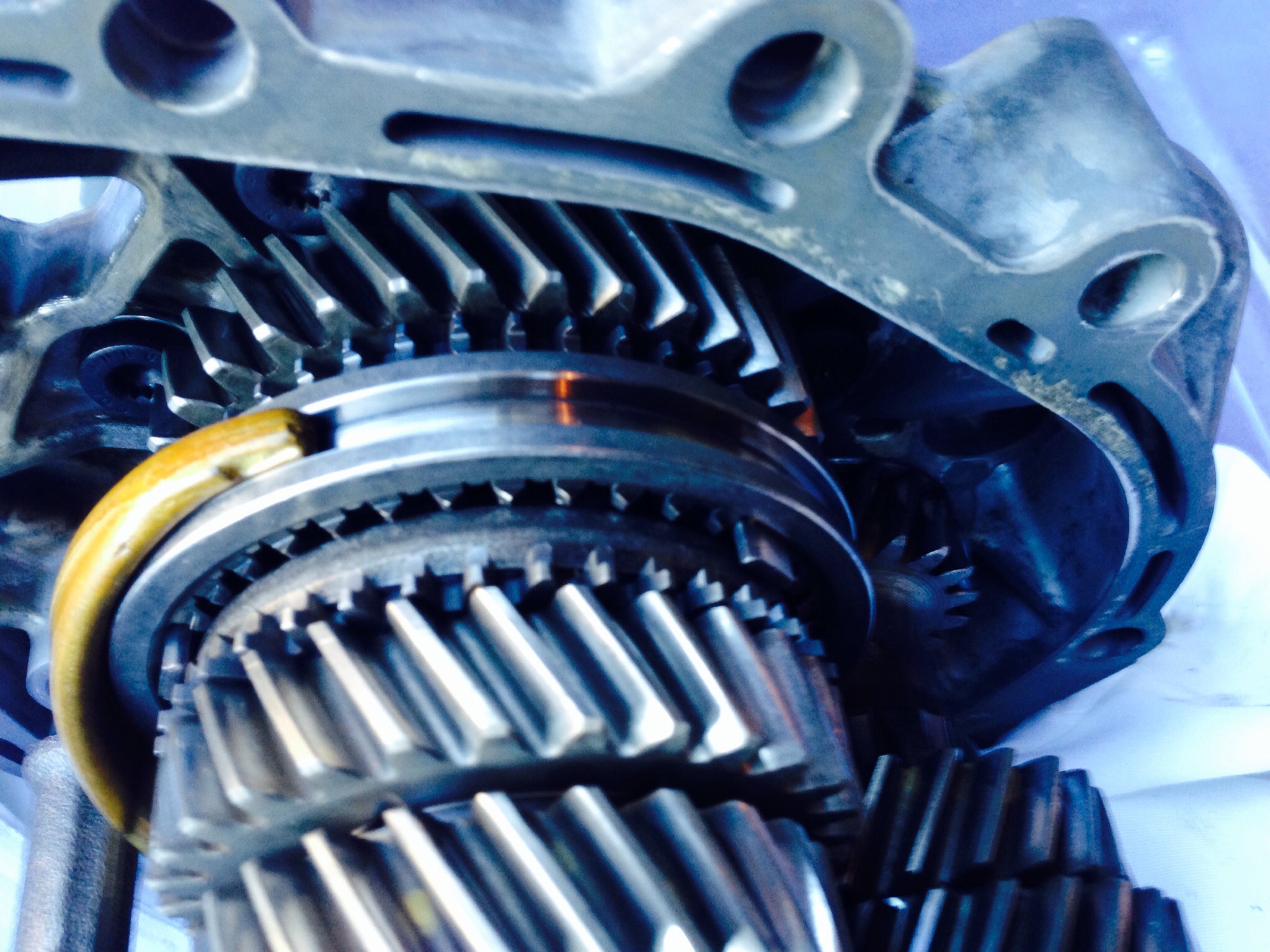

How about the guts of the diff? I expect the gear carnage, but the guts may tell us something.

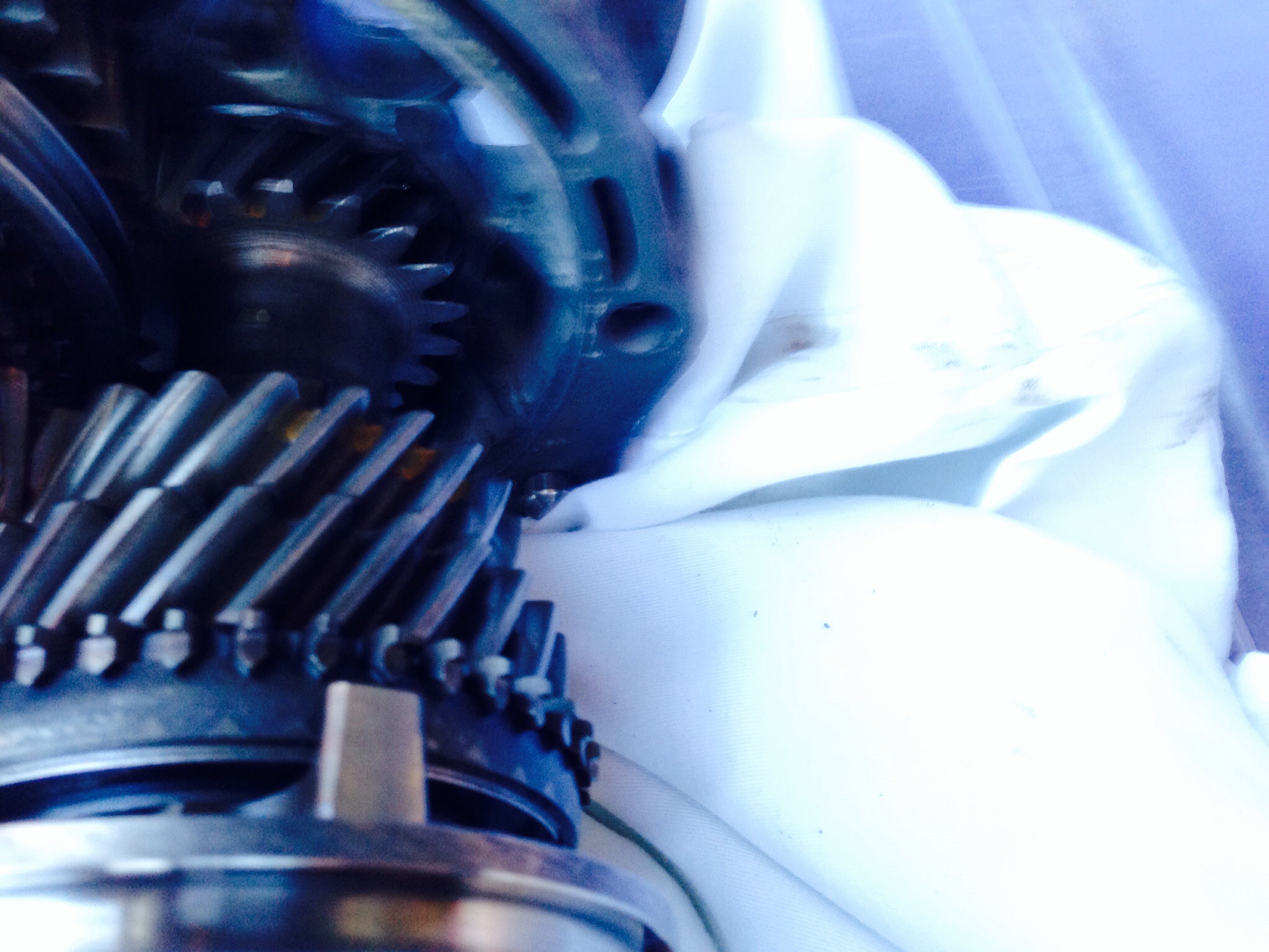

Guts looked clean. Both bearings spin freely. Pics to follow.

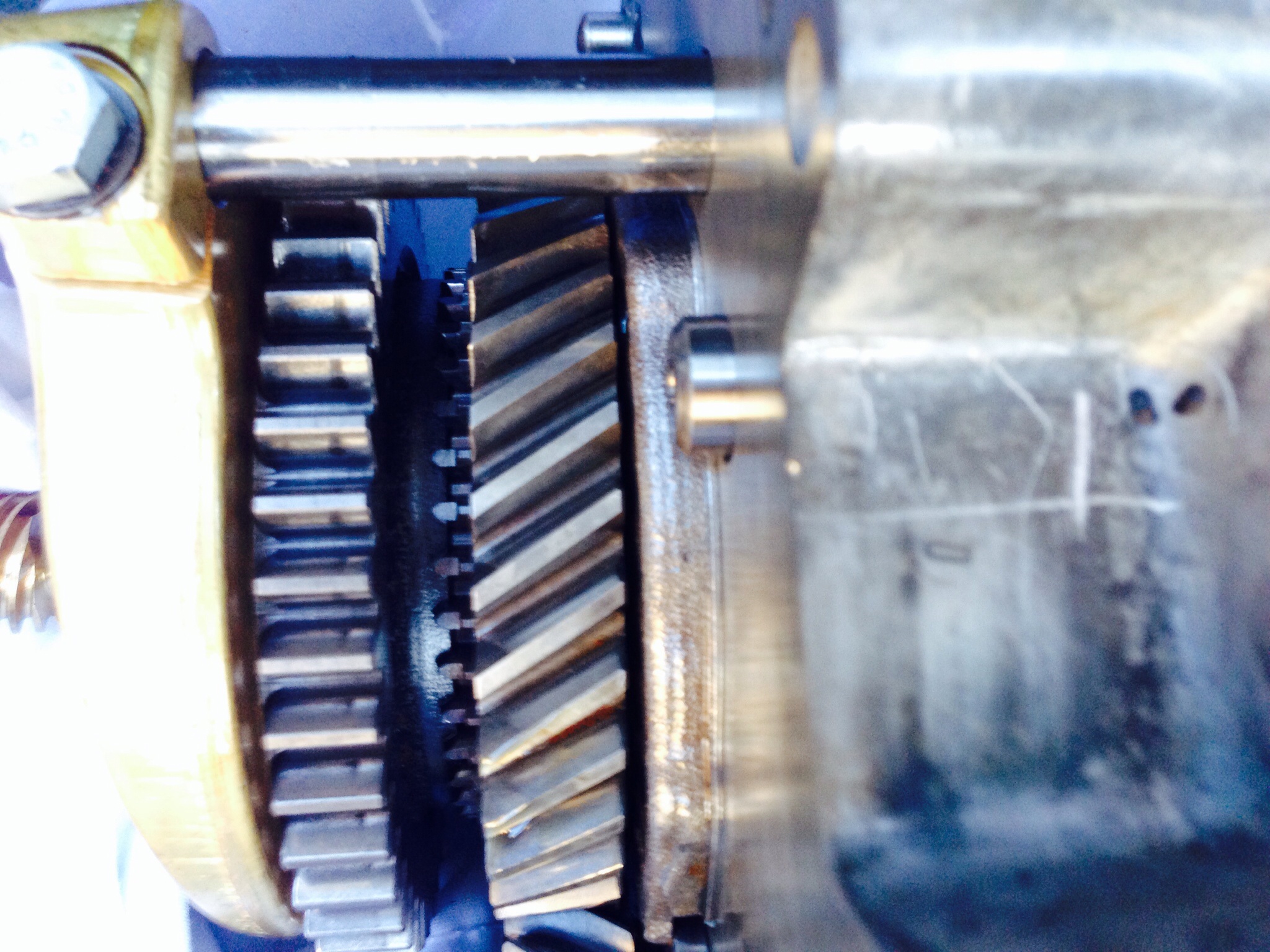

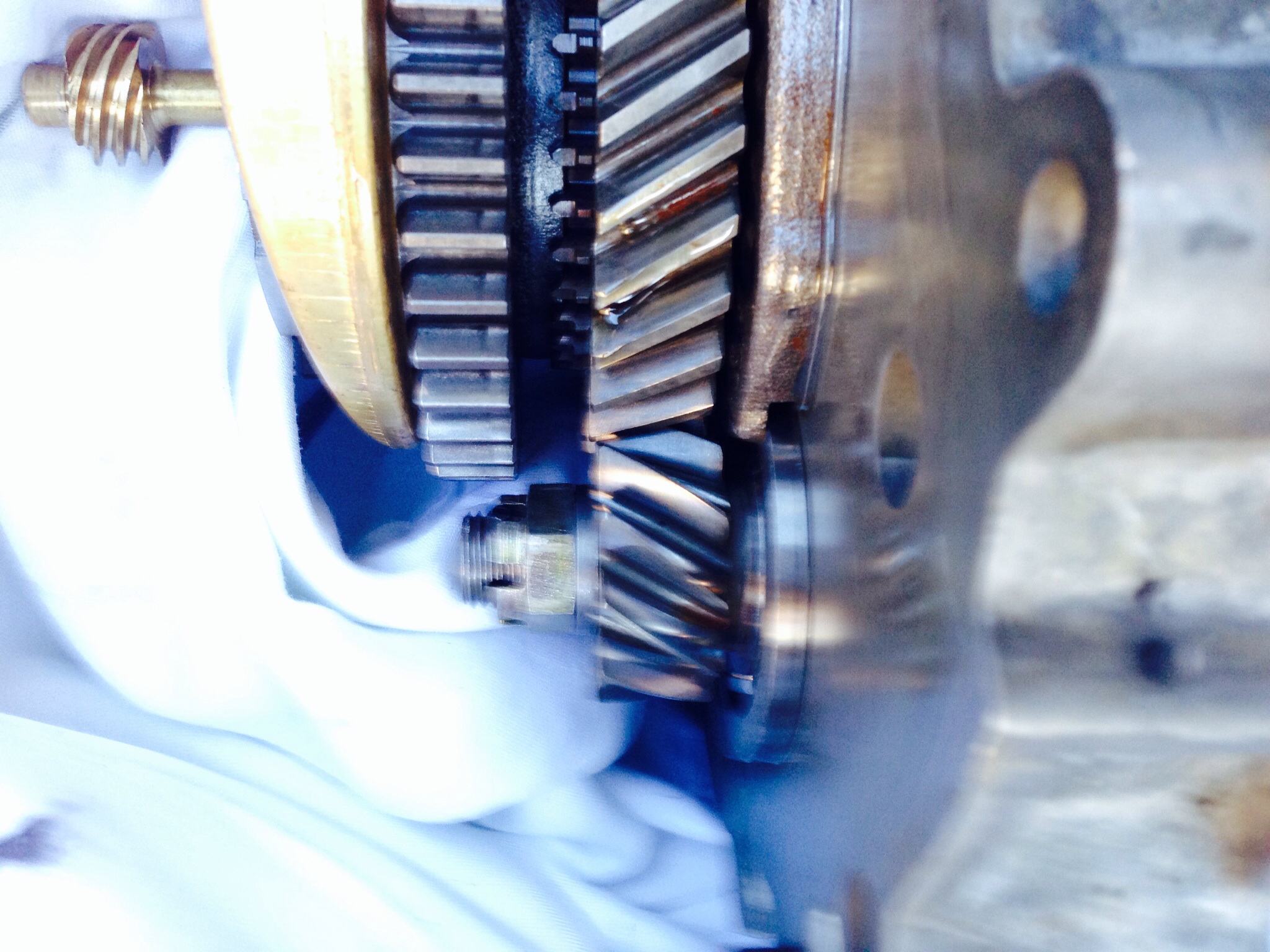

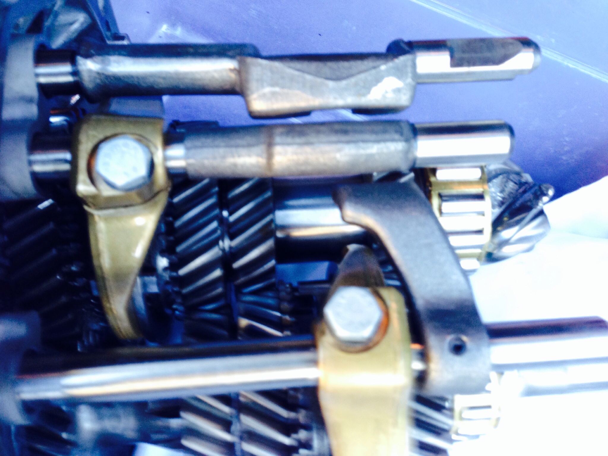

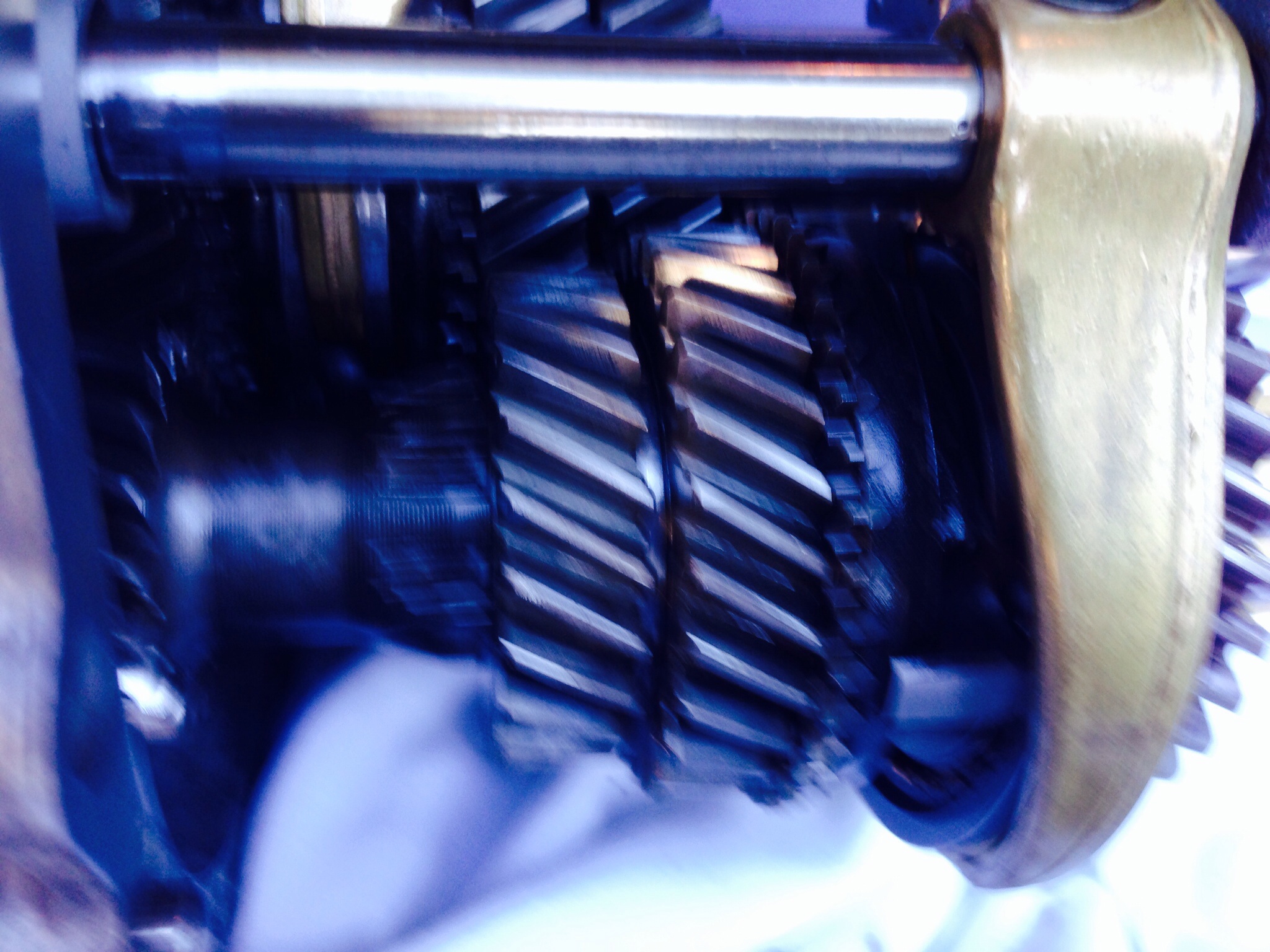

Pics galore. Attached Image
Attached ImageAttached ImageAttached Image

More
