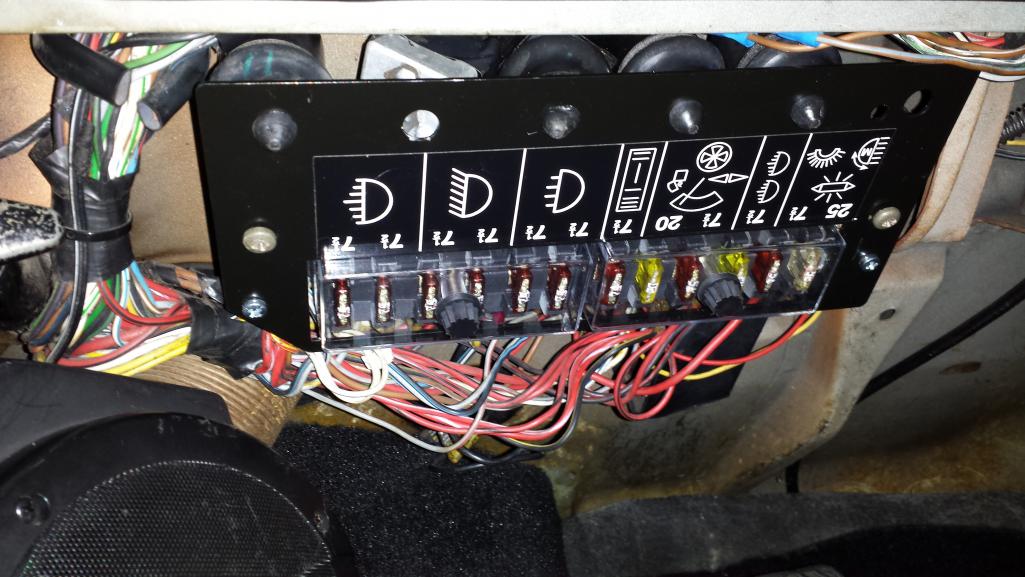

I am installing the new Jwwest fuse box and
I have a 3" section of wire off the #5 back row fuse that has melted insulation(grey with black stripe)
what is the best way to replace and splice in the new piece and what gauge wire is correct?

Circuit board in place with a few new connectors and a couple damaged ones replaced. I have to wait for tomorrow when I get the new battery.
No more bumping fuses out with my knee getting into the car!

QUOTE(Philip W. @ Nov 5 2014, 10:21 PM) *
Well i installed a new optima battery last night, turned the key - no smoke or electrical fires so thats a good sign, checked all the circuits, fuses are all good, so no apparent shorts (IMG:style_emoticons/default/smile.gif)
SO went to start the car, starter turns it over but it wont start (IMG:style_emoticons/default/blink.gif) .
i drove it last week before parking it and marking the wires for replacement of the board. - i have good battery connection, good wires there.
ive rechecked all electrical grounds, connections to the coil(which was new 2 weeks ago) and distributor. Fuel pressure is at 30, fuel pump obviously primes
so in order to check for spark what voltage should i see across the coil( i have a hotspark module not points- its same as petronixII) i can pull the injectors and put them in a jar to double check but i am sure they are firing.
i just need a few tips on how to double check the coil and each plug for spark.
The only other times ive had this car not start was back when i pull ed the tank and had pinced a fuel line, and the other was when the MPS was shot.
-i tried both MPS's i have that hold vac and test as good.
i'm at the point where i might want to try another ECU i know they rarely fail but i have read several members that have chased their tails on d-jet only to find a bad ECU.
i will be working on this saturday morning-

Some of the fuse circuits in the old panel are bridged on the hot side so one hot lead supplies three fuses with power.
The aftermarket panels don't have the bridging and must be added or some circuits won't have power.
Is it possible that the ignition wire from the switch is one of those coming off the panel from a "dead" circuit?

Chris,
that's interesting, and if that is the case why with the manufacturer of the aftermarket panel not provide that information with the product? that bridging should be in the case of this panel, on the inside? Seems strange to me that bridging wouldnot be built in.
How would i test this? do you know which circuits have this? but also i would be seeing other systems on those fuses not working as well, correct? like my tail lights, signals starter fuel pump etc which all work.
But if lets say 8-9-10 are connected with a common power supply on one side but the bridging is not present but the wires going into 8 test hot 12v, and 9 and 10 are zero that would support your idea. so i need to know which circuits are connected and i can test them to see if power is being supplied. - but first i will check the coil to see if it is getting the 12v when ignition is on like rich suggested, if it is then we should be good(also will do as dave suggested and test the spark on #1 wire with grounded plug)
My initial feeling is that since all the light circuits are working that all the circuits are getting their power. But if we find that not to be the case how the heck do you put in that bridging.
Anyone else here have one of these circuit boards installed? i thought they were plug-n-play!

ChrisFoley
post Nov 7 2014, 01:44 PM
I am Tangerine Racing
Posts: 8,031
Joined: 29-January 03
From: Bolton, CT
Member No.: 209
QUOTE(Philip W. @ Nov 7 2014, 01:42 PM) *
Take a look at your old fuse panel to see which circuits are on a common hot lead.
