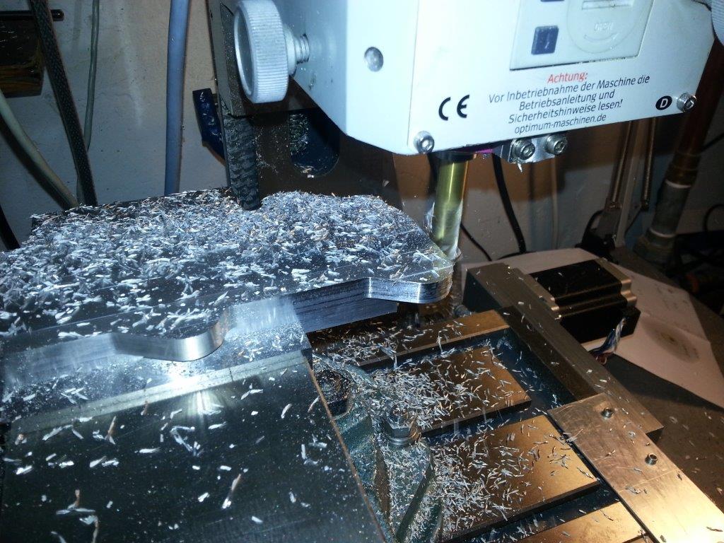

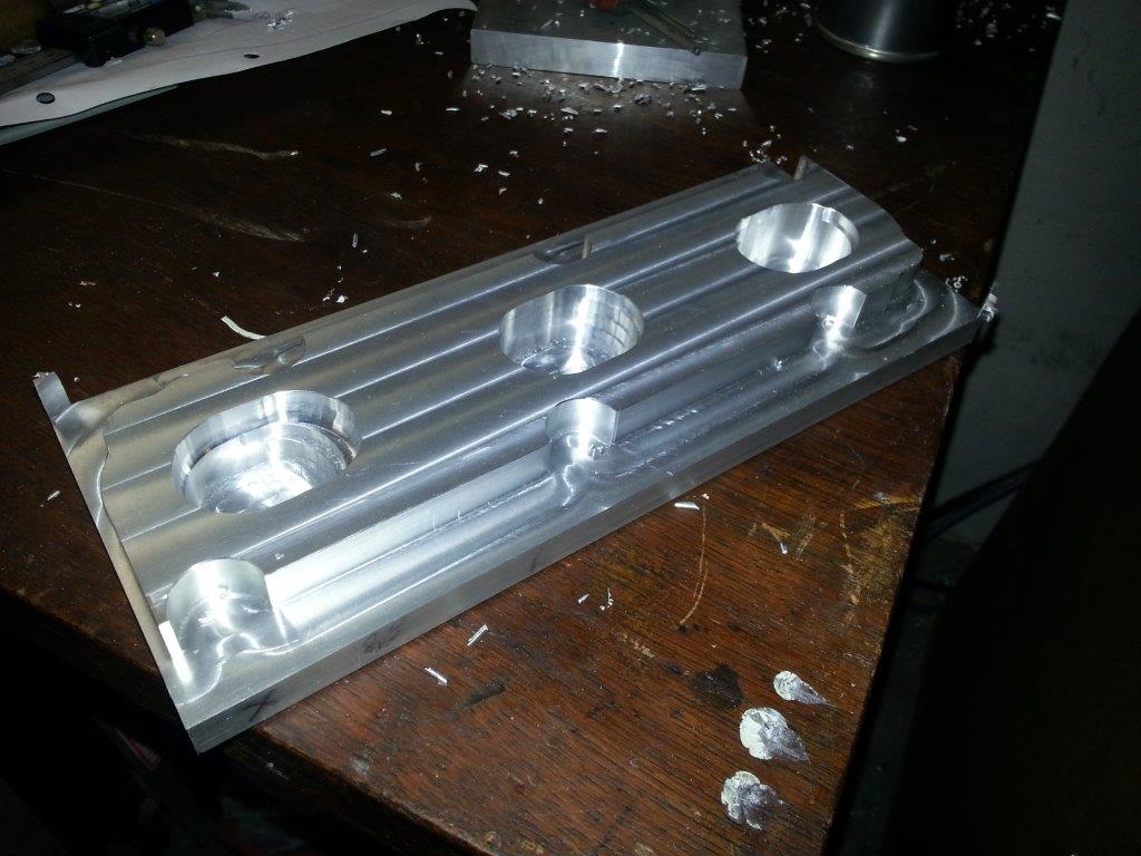

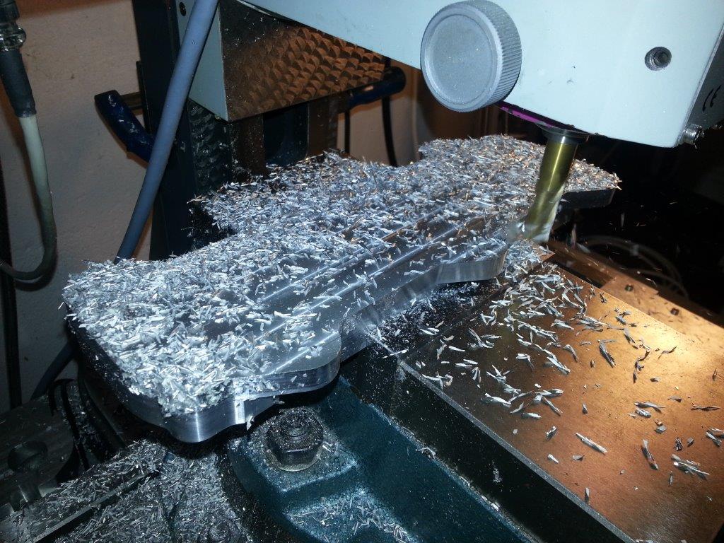

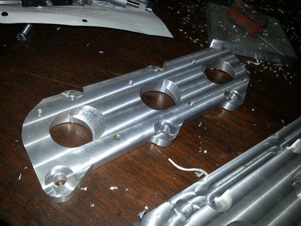

There are some sellers that provide ITB for Porsches like TWM or PMO. These were way to expensive for my Budget, so i did some Research and found Motorcycle ITB that fitted nearly perfect to the Motor.
So i bought one set at about 70,- Euro to do the Engineering for the Adapter.
The first pics Show the milling process, last one the finished part.

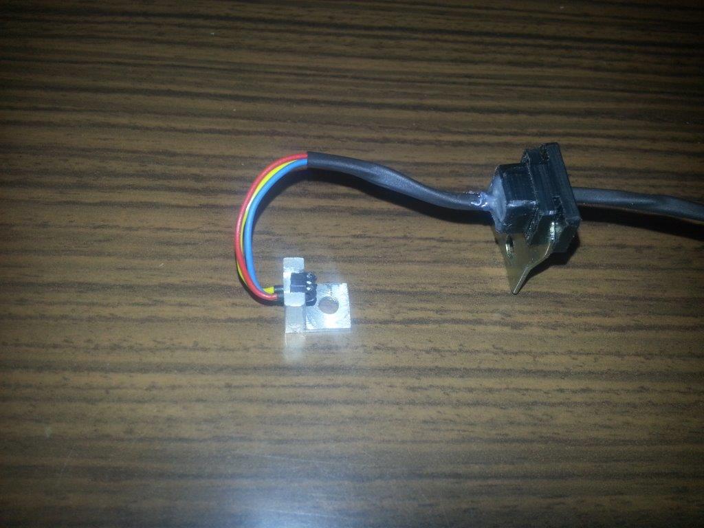

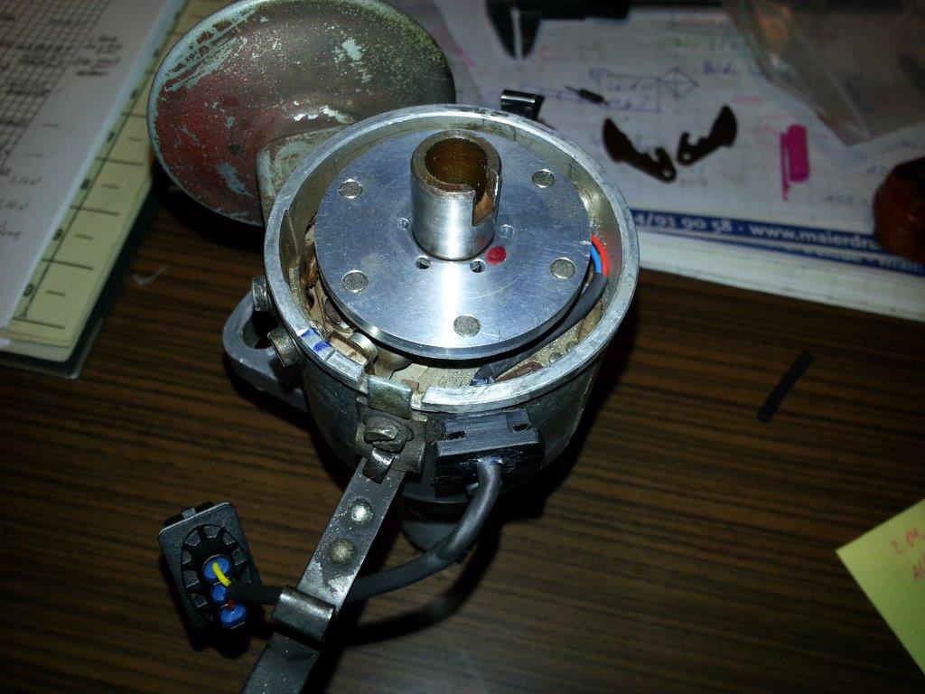

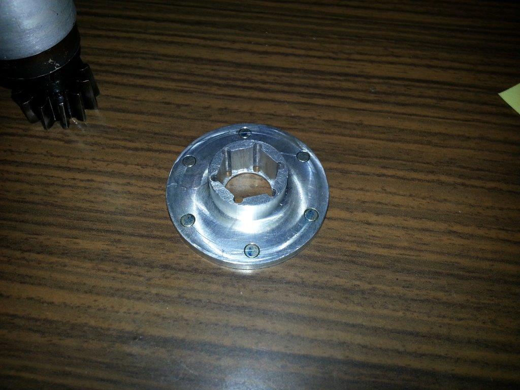

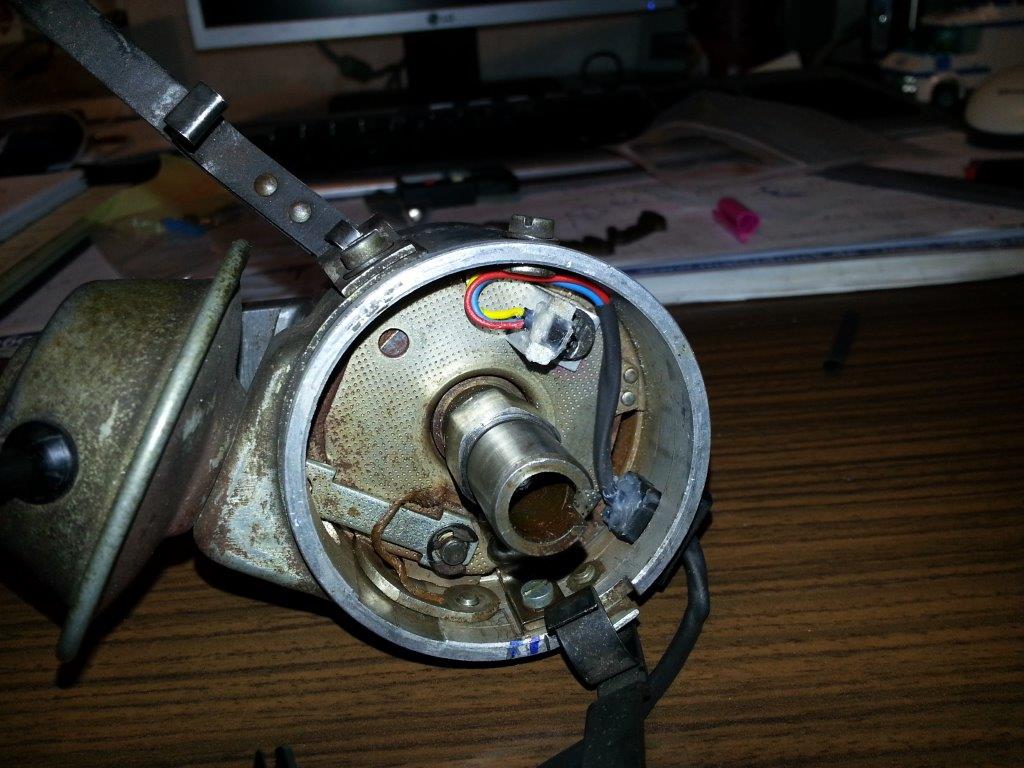

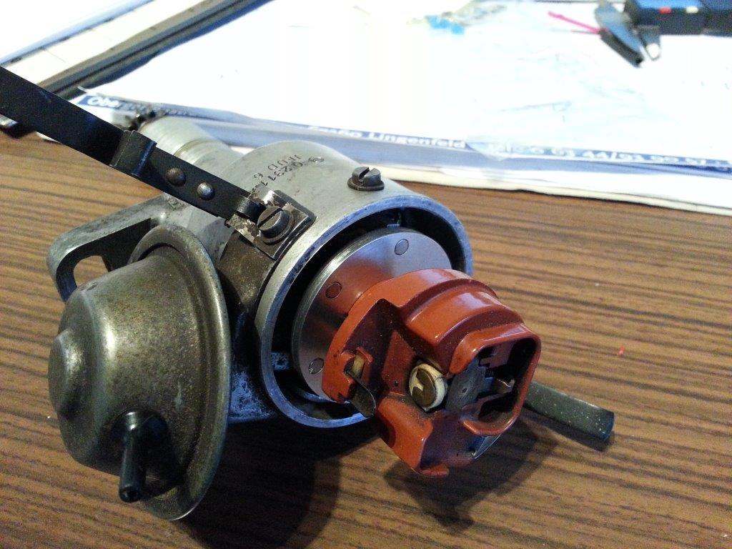

michelko   First step of the conversion was to lock the distr...   Nov 9 2014, 03:50 AM

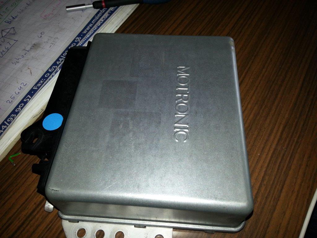

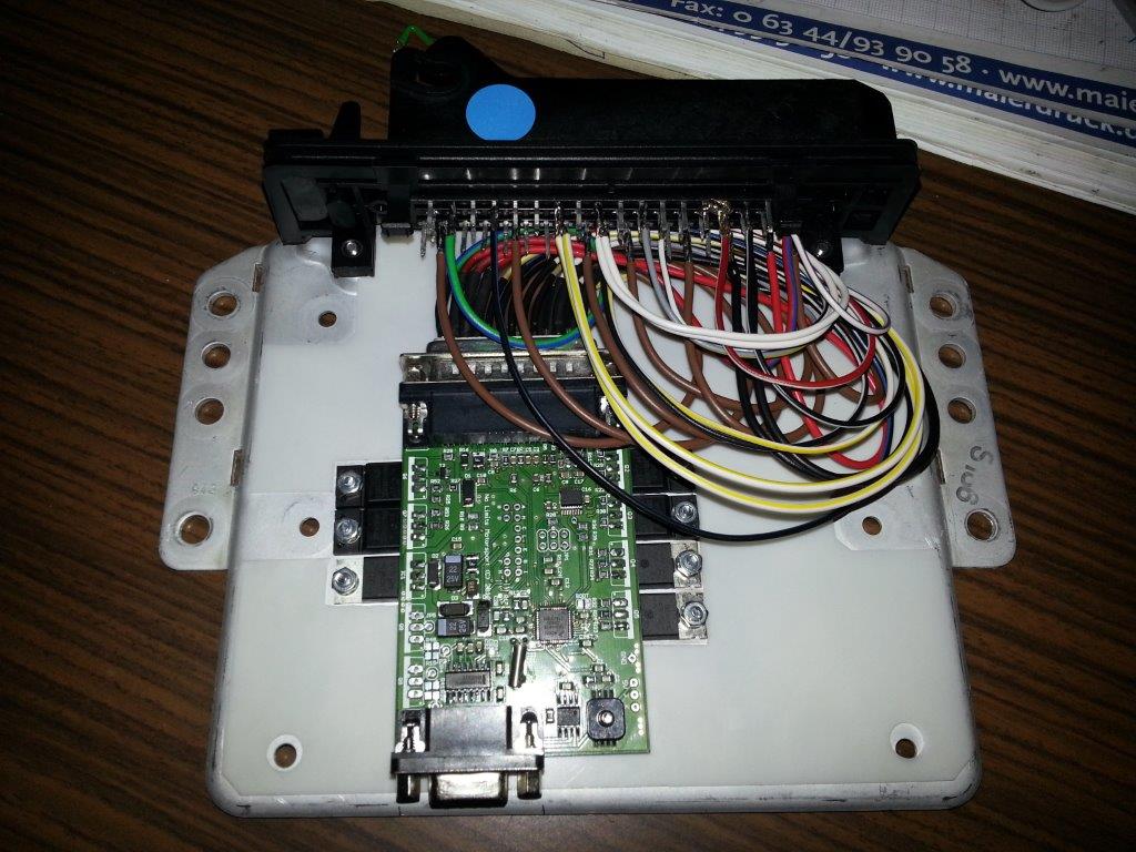

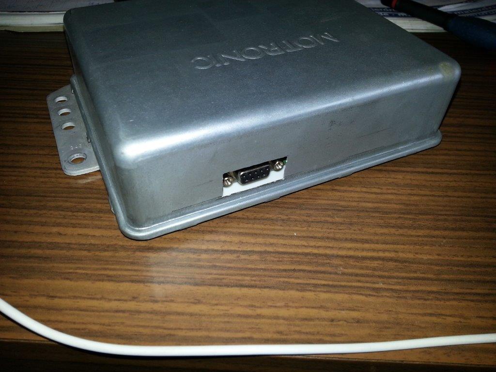

michelko   Next step was to fit the controler board into a mo...   Nov 9 2014, 04:00 AM

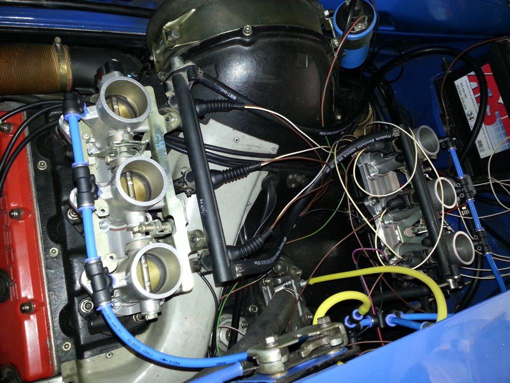

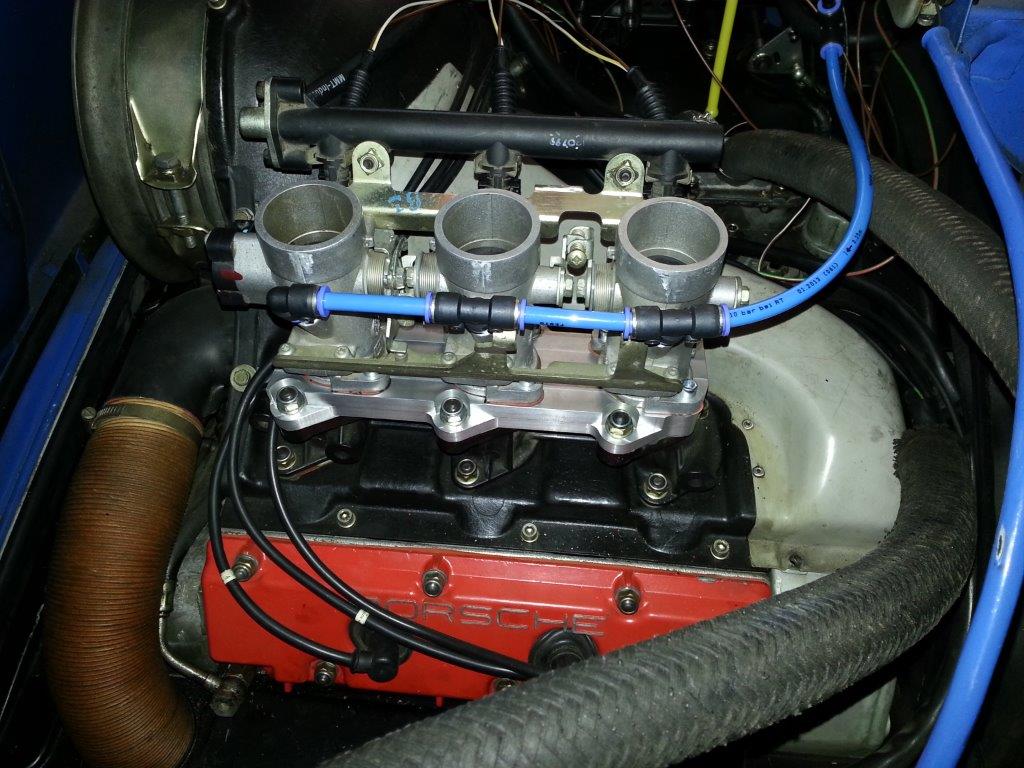

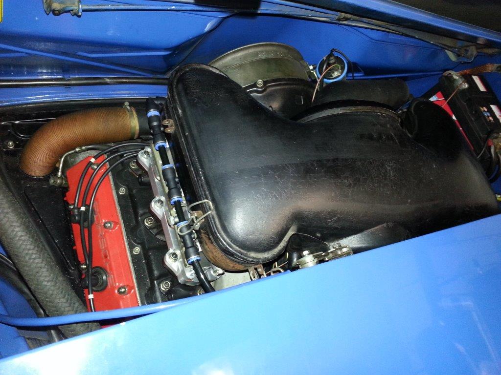

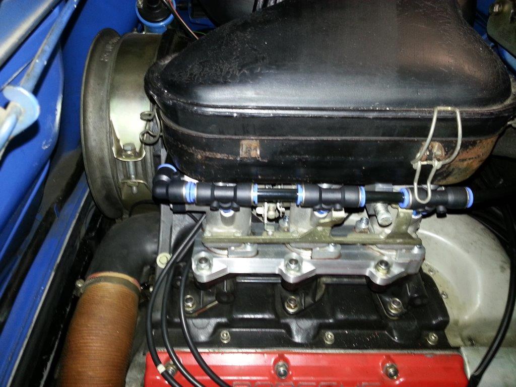

michelko   So here are some pics of the Stuff mounted in the ...   Nov 11 2014, 07:50 AM
RobW   Awesome setup! Looks fantastic! I assumed...   Nov 11 2014, 07:59 AM
Mark Henry   Nice job. :first: Is the blue hose a balance tu...   Nov 11 2014, 08:55 AM
michelko   The blue hose is for the map sensor, the idle valv...   Nov 11 2014, 09:55 AM
