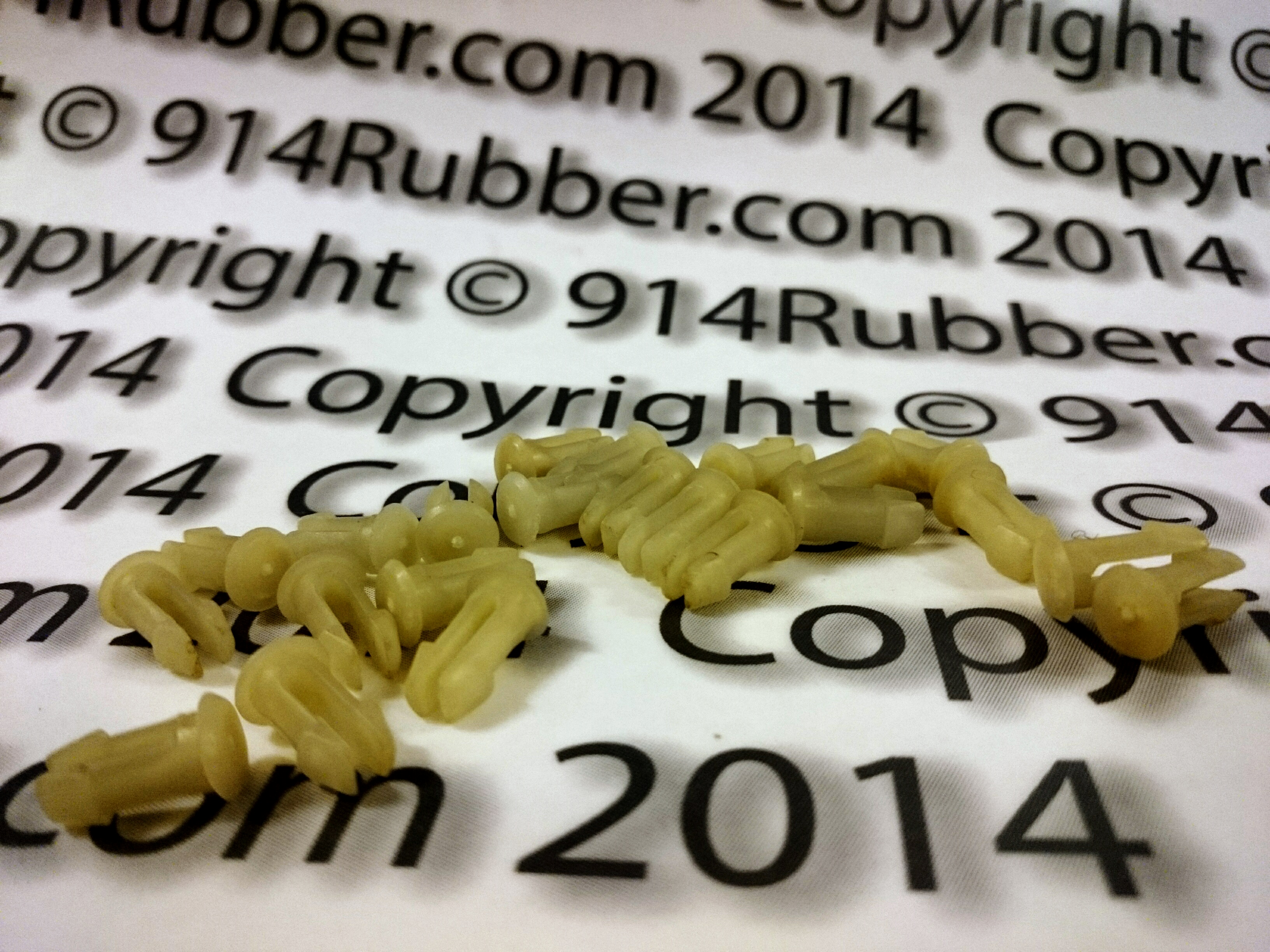

Mikey914
post Nov 17 2014, 10:18 PM
The rubber man
Posts: 12,772
Joined: 27-December 04
From: Hillsboro, OR
Member No.: 3,348
I do have a bag of the plastic clips hanging out somewhere. I'll dig tomorrow, but they are for these side markers, just like OEM.
-Mark

Mikey914
post Nov 18 2014, 03:03 PM
The rubber man
Posts: 12,772
From: Hillsboro, OR
Member No.: 3,348
Got them-
Up on the site here-
http://www.shop.914rubber.com/Side-marker-...ar-914SMLBC.htm
Matt Romanowski
post Nov 18 2014, 08:28 PM
Posts: 878
Joined: 4-January 04
From: Manchester, NH
Member No.: 1,507
Those are perfect. I've been using regular body christmas tree fasteners and trimming the head down to fit.
