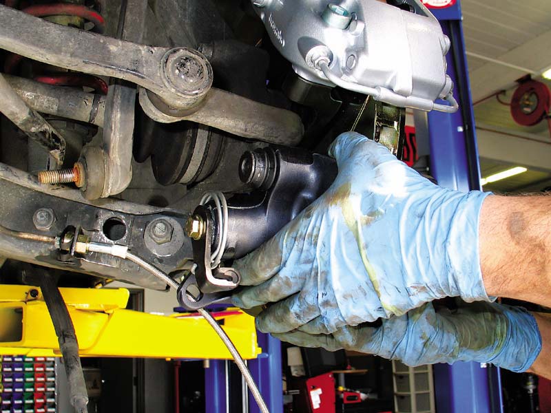

Doing some "surf'n" and came across these being installed on an Audi A4
I never knew that they made a parking brake caliper...

iiibdsiil   Someone please have pricing and it better be cheap...   Jan 31 2005, 10:25 PM
cdmcse   I am seriously considering using these.... Wilwoo...   Jan 31 2005, 10:36 PM
scott thacher   here is a simply way to make a parking brake. buy ...   Jan 31 2005, 11:06 PM

bondo   Our 87 Subaru GL-10 has it's parking brake in ...   Feb 1 2005, 10:53 AM
BigD9146gt   Sorry boys, I have some dis-hearting numbers... i...   Feb 1 2005, 11:15 AM
iiibdsiil   Any thoughts as to whether it would be easier to m...   Feb 1 2005, 11:16 AM
cdmcse   Here is another company that makes mechanical cali...   Feb 1 2005, 11:33 AM

cdmcse   Anybody know the width of a vented rotor and toler...   Feb 1 2005, 01:27 PM
BigD9146gt   cdmcse, the early-SC (late 60?-83) vented is 20mm ...   Feb 1 2005, 01:31 PM

scooter311   SteveSr got me thinking (there I go working withou...   Feb 1 2005, 02:36 PM
SteveSr   <...   Feb 1 2005, 07:45 PM
iiibdsiil   Wow, that is pretty well thought out and looks lik...   Feb 1 2005, 07:47 PM

bondo   That looks pretty much like my plan for mounting t...   Feb 1 2005, 07:53 PM
BIGKAT_83   Wilwood also makes a drum brake setup like the 911...   Feb 1 2005, 08:37 PM
scott thacher   aaron, your drawing is basicly what i thought of w...   Feb 1 2005, 08:41 PM
Maltese Falcon   Hey guys and gals, I'll be finishing off the W...   Feb 1 2005, 09:24 PM
BigD9146gt   Maltese, you wouldn't happen to have a drawing...   Feb 1 2005, 09:40 PM
Maltese Falcon   Don, I've adapted the horizontal fan "As is" f...   Feb 1 2005, 11:34 PM

iamchappy   Ive been considering the e brake for some time now...   Feb 2 2005, 07:31 AM
94teener   A picture of the Wilwood spot brake install.   Feb 2 2005, 09:41 AM
joea9146   Looks great.... Did you Fabricate the Bracket ? Is...   Feb 2 2005, 09:45 AM
Maltese Falcon   Clay, you're right on the money with needing o...   Feb 2 2005, 09:46 AM
ClayPerrine   <...   Feb 2 2005, 09:50 AM
joea9146   ...   Feb 2 2005, 01:32 PM
iiibdsiil   So how much do you think the bracket is going to c...   Feb 2 2005, 01:44 PM
ClayPerrine   It won't come with spacers. If I do this, it w...   Feb 2 2005, 01:55 PM

iiibdsiil   If they are that easily accessible (the spacers) t...   Feb 2 2005, 02:38 PM

Aaron Cox   EDIT2: also... who made the above one? EDIT3: als...   Feb 2 2005, 02:48 PM
iiibdsiil   I'm not gonna argue over a couple pounds of un...   Feb 2 2005, 02:49 PM
ClayPerrine   The caliper mounts UNDER the rotor. That way you c...   Feb 2 2005, 02:55 PM
Aaron Cox   okay. thanks clay. that looks like a winning solut...   Feb 2 2005, 02:57 PM
ClayPerrine   I am not going to supply the calipers. You have to...   Feb 2 2005, 03:00 PM
andys   Clay, Another question came to mind. How does th...   Feb 2 2005, 03:41 PM

DuckRyder   That looks intresting. I do have one question as f...   Feb 3 2005, 07:25 AM
ClayPerrine   ...   Feb 3 2005, 07:37 AM
DuckRyder   Ahh I see, 1) Isn't a problem here 2) I sup...   Feb 3 2005, 08:26 AM
ClayPerrine   When I said "over time" I mean within an hour. M...   Feb 3 2005, 08:42 AM
