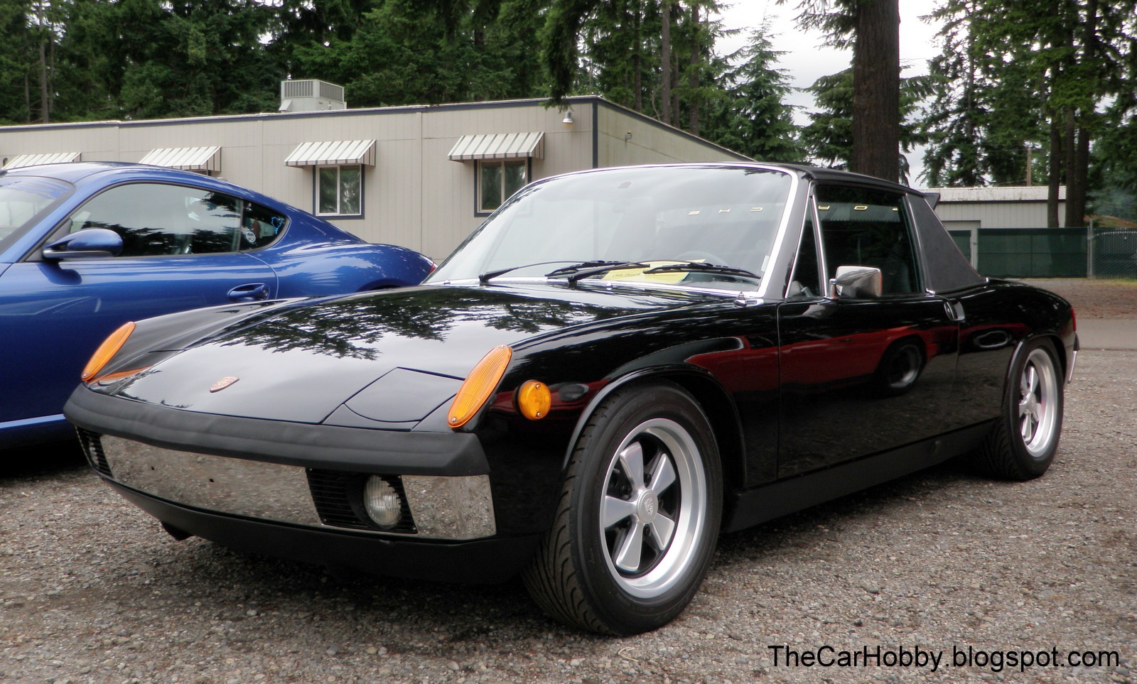

I like the look of this wheel / tire setup on the stock narrow body.....any idea what size combination this is. 15x7 Fuchs with 195/60/15 is my guess....any thoughts?Attached Image

My guess would be 205-60-15. The wheel wells look pretty full.

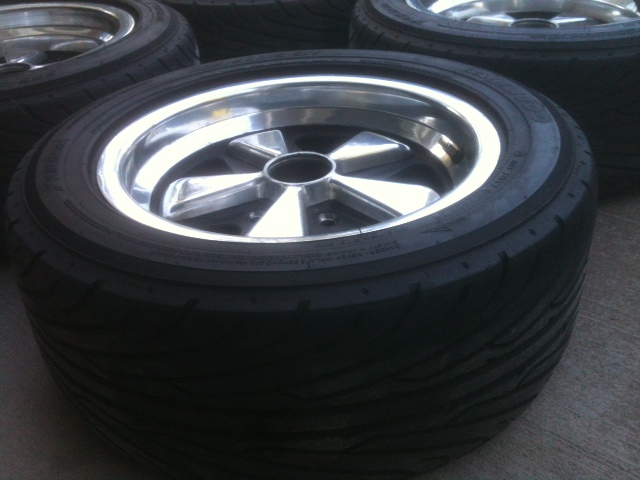

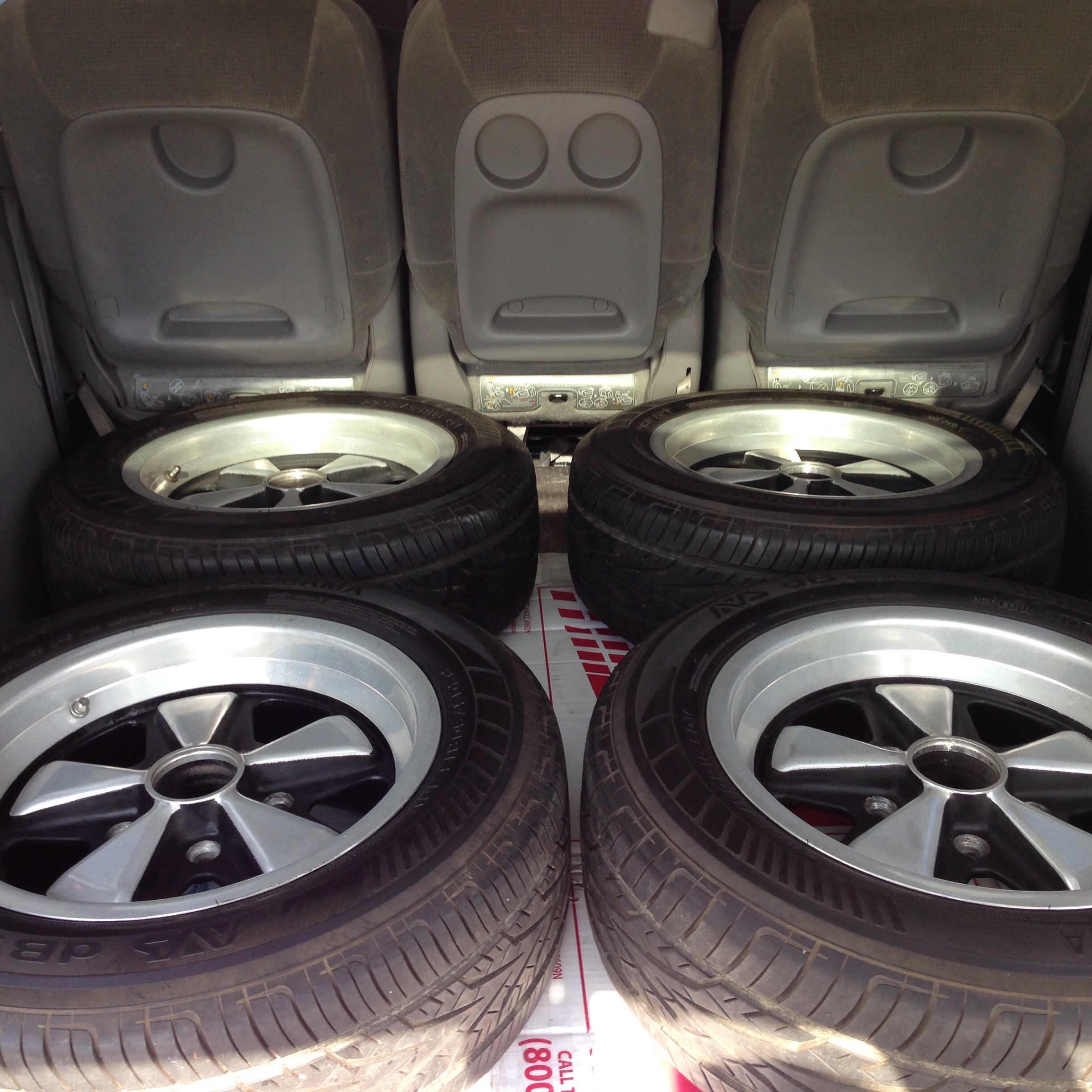

These are the exact same tires, shallower rims are 15x7 205-55's, deeper ones are 15x8 with 225's. These were fake, but I wish I held on to them, best fake set I've seen...

These wheels look like 15x7's to me.

Looks like 15x7s all around with 205/55R15 Yokohama ES100s. Had those tires, in that size. Never liked them. Square edges weren't real progressive at/near the limit, and not great in the rain (felt greasy on my 914 and my WRX).
I suppose they could be 225/50R15s or maybe they are 205/60R15s. Whatever they are, I suspect the rear fenders were worked a bit to make everything fit.

Looks like 15x7 wheels with 205 tires and rolled rear fender lips.

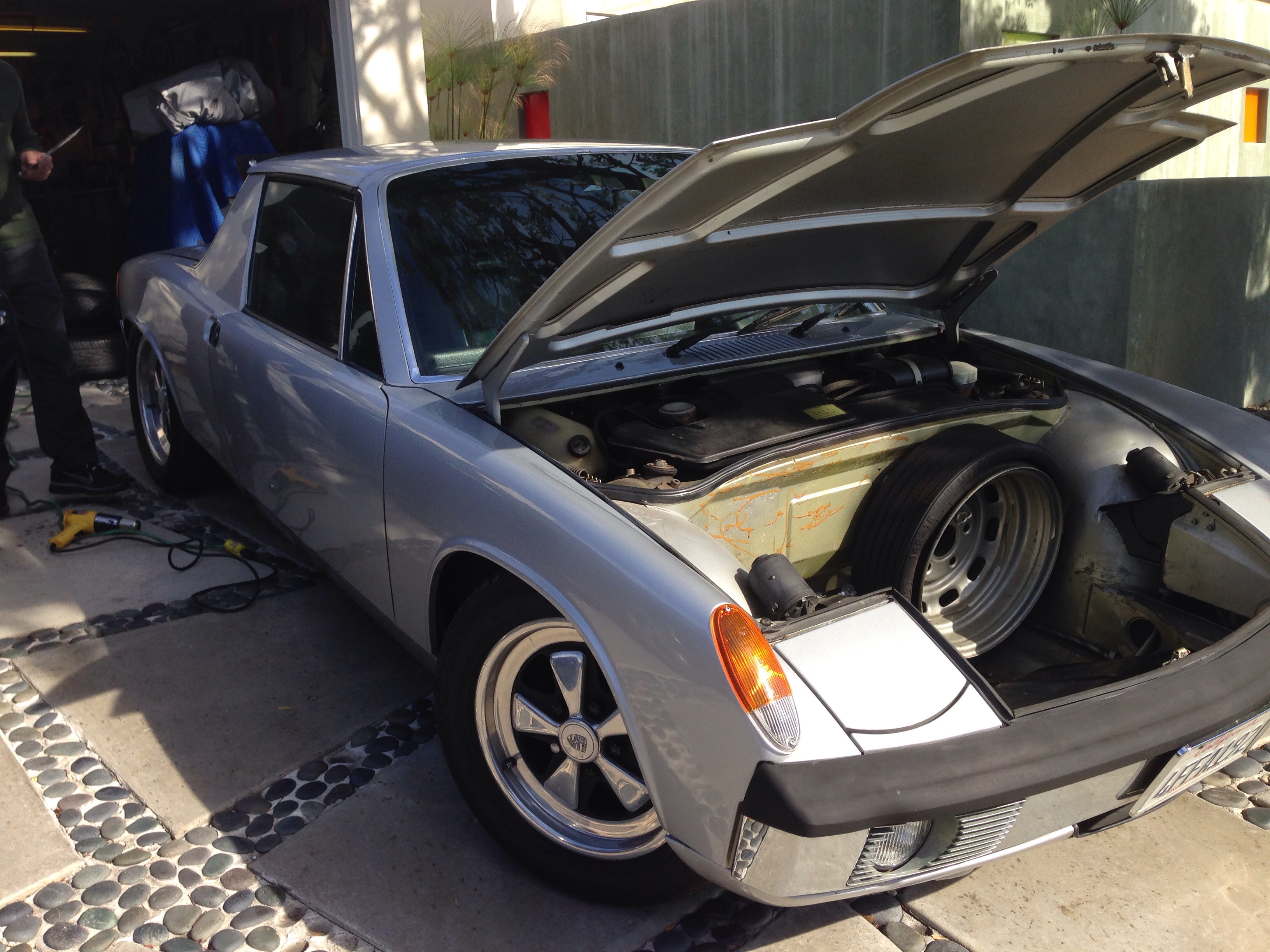

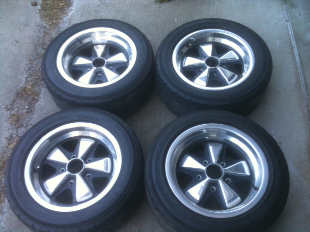

Just pick up this after market fuchs wheel 7x15 with 205x60x15 tires. It was removed from a 914-6 conversion with 1973 body. The owner did rolled his rear fender.
This car already has a 7x16 wheels on it with 205x55x16 tires.
