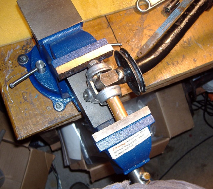

No danger of bending the welded block that retaind the pin? It will be unsupported.

Use a piece of pipe or tubing that will fit over the pin and set it in a vise. Using a drift sized slightly smaller than the pin, press the pin through. Be VERY sure that the vise jaws are on the pipe tubing AND the drift (I used a bolt slightly smaller than the pin) and NOT on the coupler itself. The vise jaws press the bolt into the pin, pushing it out through the hole in the pipe tube. I reversed the process with a few modifications to press in the pin with the new bushing. Here's a pic of my removal setup:
