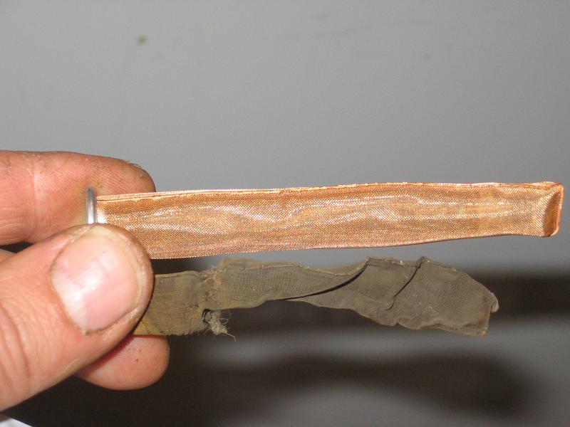

In your tank you will one of these.
The top one will let your car run, the bottom one wont. Its on the suction side of the pump in the tank. Fully remove tank to replace.
Still cant figure out how the hair and lint got in my fuel tank?

QUOTE(cwpeden @ Nov 25 2014, 06:23 PM) *
Adult swim for a mouse sometime in the cars lifetime.....?
