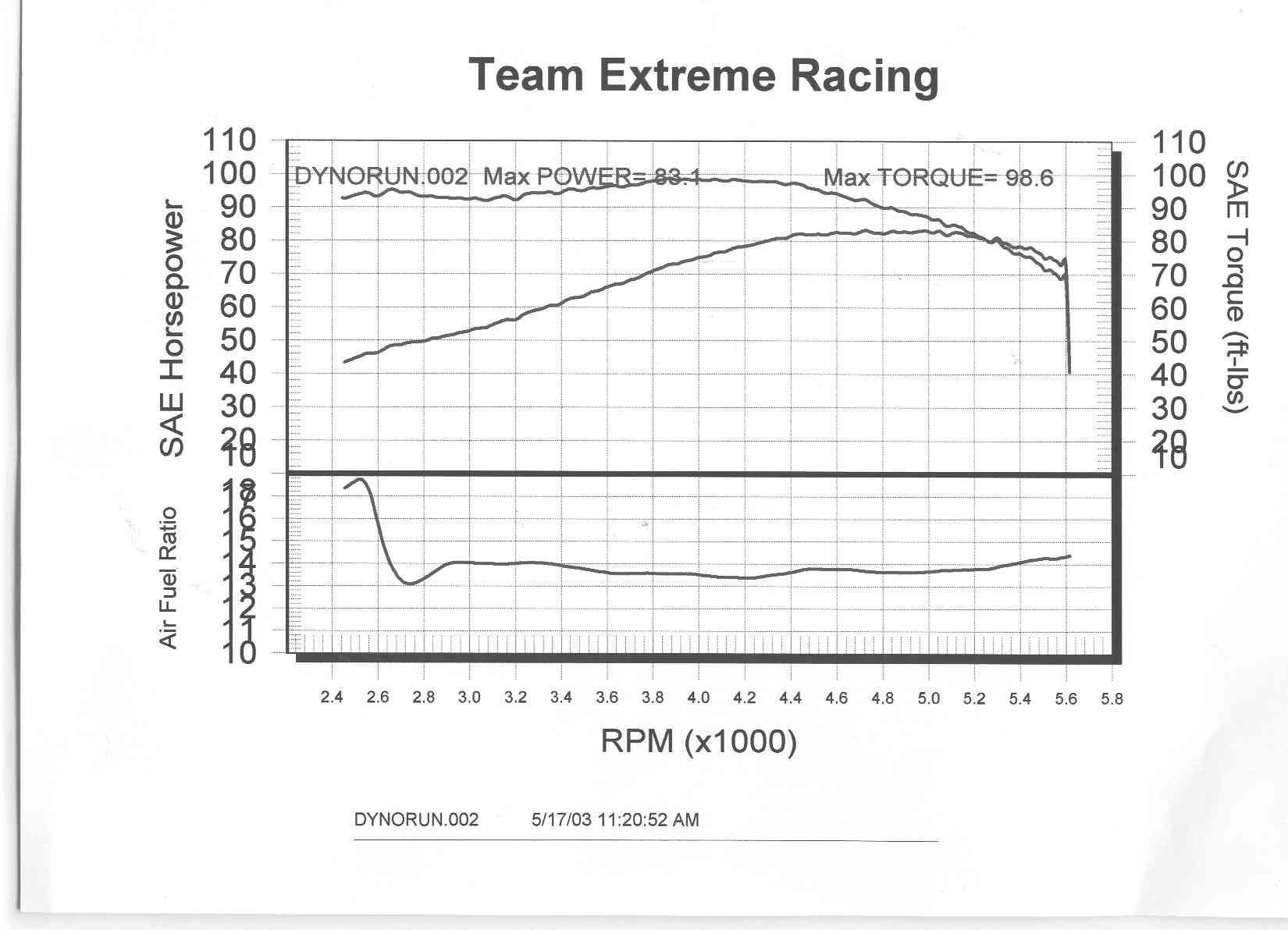

That's about right for a 2.0L with a stock cam.....
Here is my dyno chart from before I went with a Raby cam.

post Dec 5 2014, 08:36 AM
Posts: 430
Joined: 8-January 12
From: OK
Member No.: 13,979
QUOTE(Bleyseng @ Dec 5 2014, 06:17 AM) *
(Please excuse the blatant hijack. Enquiring minds want to know...)
After?
And which cam, P&C's?
My "stock" 2.0 L FI with 9550 and flat top pistons FEELS nicely stronger. I'm very happy just having a well running car but having before and after numbers would have been intriguing.
