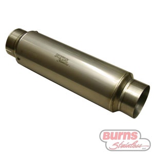

I have a 2.0L with Kerry Hunter headers and a SuperTrapp muffler. I want to replace the SuperCrapp and was looking at the Burns Stainless. It seems to be pretty good and made in the good ole USA. Anybody here have experience with these? I want to get the most out of the the top end of the rev range. I really don't mind if it's loud as the SuperTrapp is already loud. Problem is the supertrapp doesn't seem to perform that great.

Looks identical to the Magnaflow t304 SS round resonator/muffler.
2" to 3" od inlet/outlet sizes.

I've used these on my formula cars for years. They are great quality... you may have to re-pack the stainless steel wool every couple years.

Buy that same muffler from Coast Fab, thats who makes them for burns.

The Burns / Coast Fab mufflers should be a lot lighter than the SuperTrapps too ...

keep a eye out for their scratch and dent sale items.
Though when you buy it i highly suggest you replace the allen bolts that hold the mufflers together with a standard hex. that way its easier to get apart in the future to re pack.
I often repack with filling from cone Engineering.
