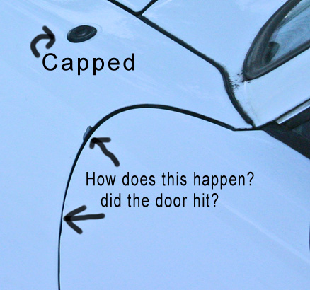

Had a 200+ pound guy sit in the passenger side with the roof off. Checked door gaps before and after. Door opened/closed fine. Also checked the door with the driver side of the car jacked up. Still same gap.

The engine looks a bit dirty for being rebuilt 4-5 years ago. Maybe they didn’t touch the exterior. A guy from Arizona PCA thinks it was built by Stuttgart Southwest. I found their website, very top notch.
The underside looks a tad rusty in near the firewall. Maybe its some form of coating peeling off, I can’t tell. I poked around, it all seems solid.
Second color under front trunk. Paint is nice, but small chips up front.

Doesn't look too bad. The rust on the back of the floor pans could be from a leaky back window. It doesn't look like the rust is too bad. Just grind it down and fix it up.

hole where the antenna used to be isn't capped, covered, plugged...makes me wonder how they did the turn signal delete
there are more things that others have said
this is at best a $4k car IMHO

Well, at least the seller didn't try to hide anything. Those pictures make the car look like crap. (IMG:http://www.914world.com/bbs2/html/emoticons/icon8.gif)
So, the car was originally blue, then painted white. But, what's going on in the front trunk? Why is that black? Was the front trunk floor replaced?

Thanks for all the insight guys.
I've been to Hershey the past two years, I know there is always some nice stuff going around.
I also agree that its best to find a west coast car and ship it. But i could never buy a car sight unseen. This car was an Arizona car that was shipped over a few years ago.
BTW - i took all those pictures, hehe. I tried to get as much as possible for you guys to see. I also tried to the pics of the areas that concerned me the most. I'm very meticulous and picky when it comes to inspecting a car. I tried to convey as many of the expected problem areas as possible. I wish I had the car up on a lift instead of on a little floor jack.
I didn't spend enough time around the 'hell hole' but if i go back i will definitely check. However there is no body sag and the guy knows what he bought and is looking at.
Yea, all those negatives mentioned make me hesitate for a bit. $7k is too much in my opinion. If things are all cleaned up and done right then its reasonable, but as is i can't say it is.
The car was blue at some point, then painted white. The trunk are by the windshield is still blue, but the front probably got some antirust coating put on it. i'm really not sure.
Unfortunately i'm bitten by the bug and "really really want one now!" before the autox season starts. But obviouslly i have to be patient and wait for the right one to come along at the right price. Assuming i can't get this one for the right price.
