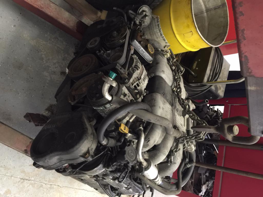

Engine is out

Pulling the engine was easy - my local mechanic did it for me. Next step is to pull the chassis harness. That's my job.

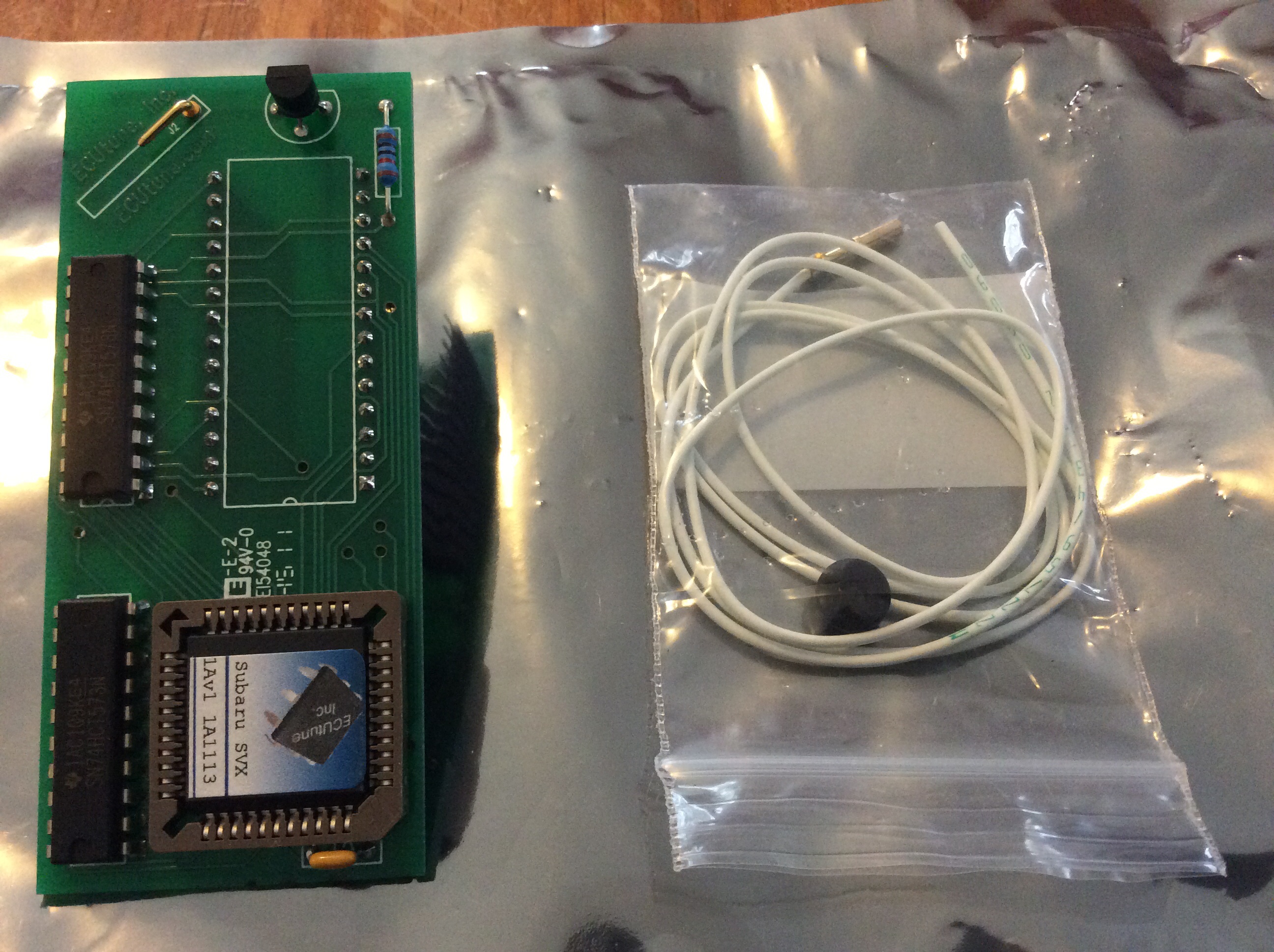

Got this chip from 914forme. Turbo boost control? I don't know?

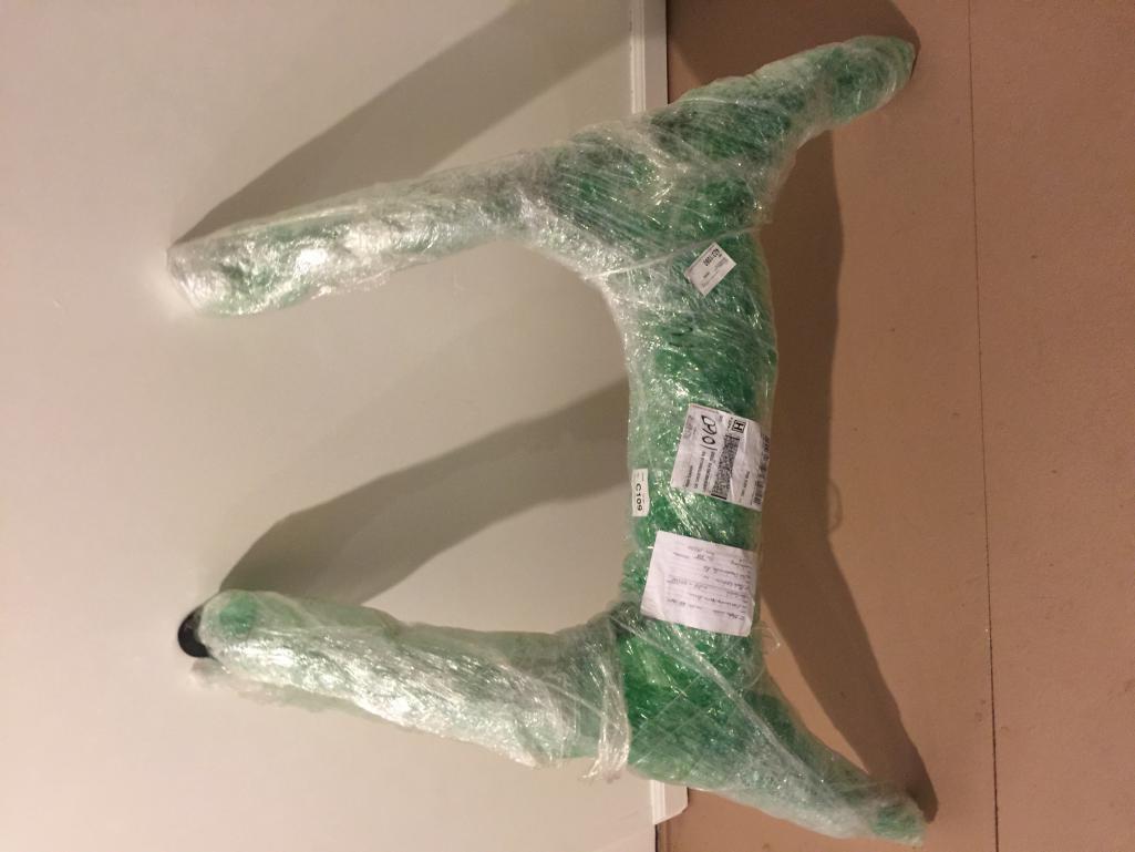

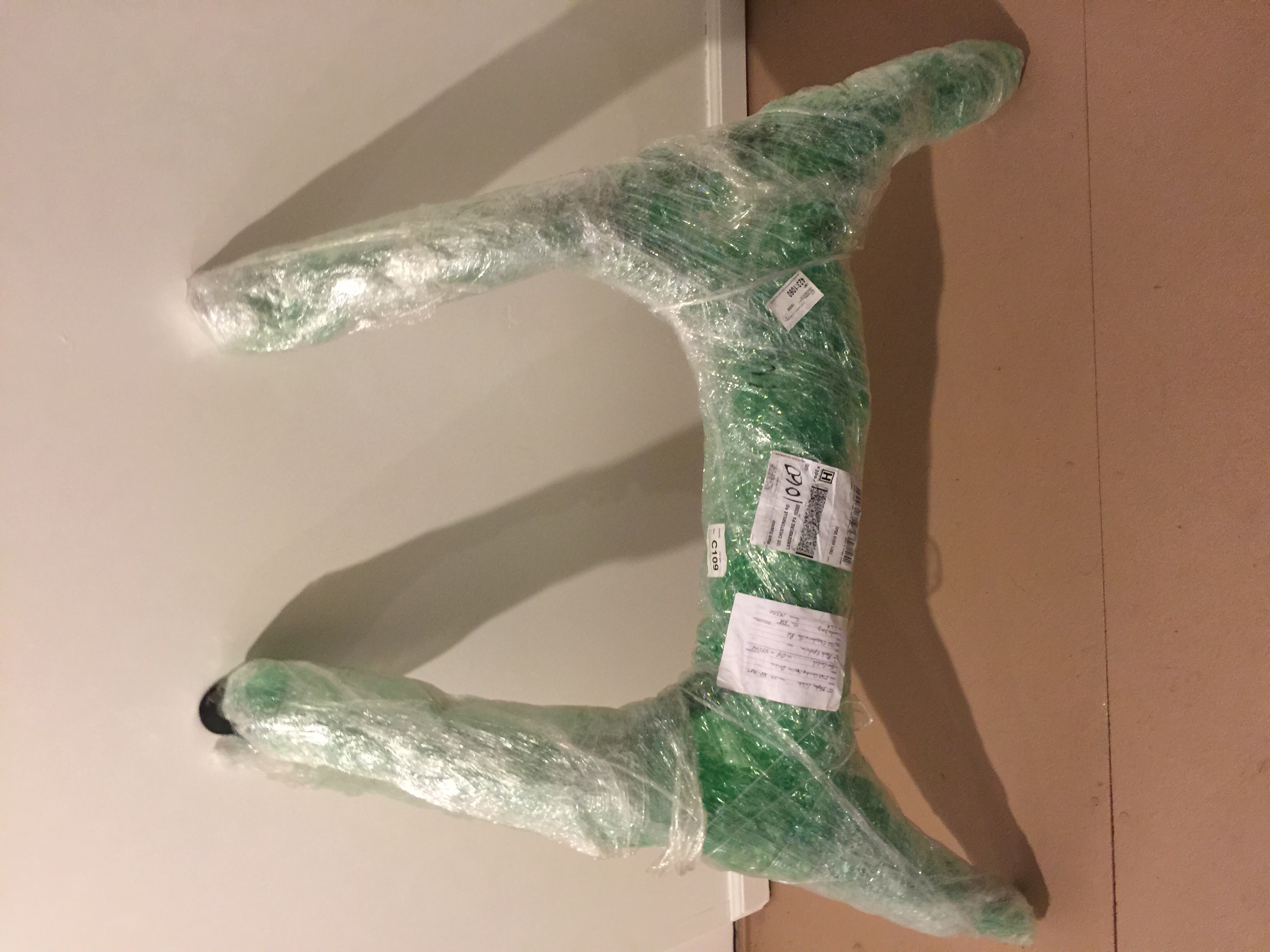

Another part from 914forme just showed up. Coldwater cradle. Great seller - just like most everyone on world.
Sorry, iPhone pics display rotated. (IMG:style_emoticons/default/dry.gif)
Its an argumentation to the stock ECU, ECUTune stage 1. If you need more you can upgrade it to stage 2, that will give you dual fuel maps, if you every want to run E85 (IMG:style_emoticons/default/happy11.gif)
Overview od stage 1
Features
More aggressive timing profile for more torque
Built in fix for M/T stalling when stopped
Improved power band with increased low rpm torque
7800 rpm rev limit
No vehicle speed limiter
Eliminates hesitation when shifting
Great for SVX automatics, SVX 5 speeds and SVX powered Vanagons 914s (IMG:style_emoticons/default/aktion035.gif)
Stage two requires new injectors, MAP etc...
