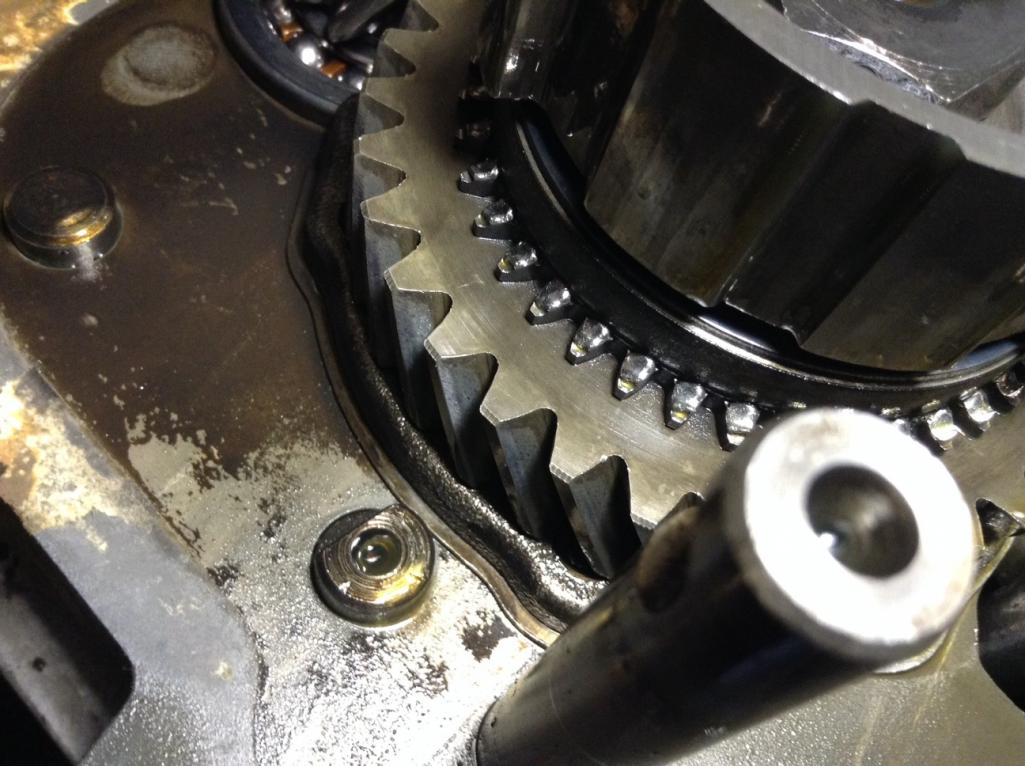

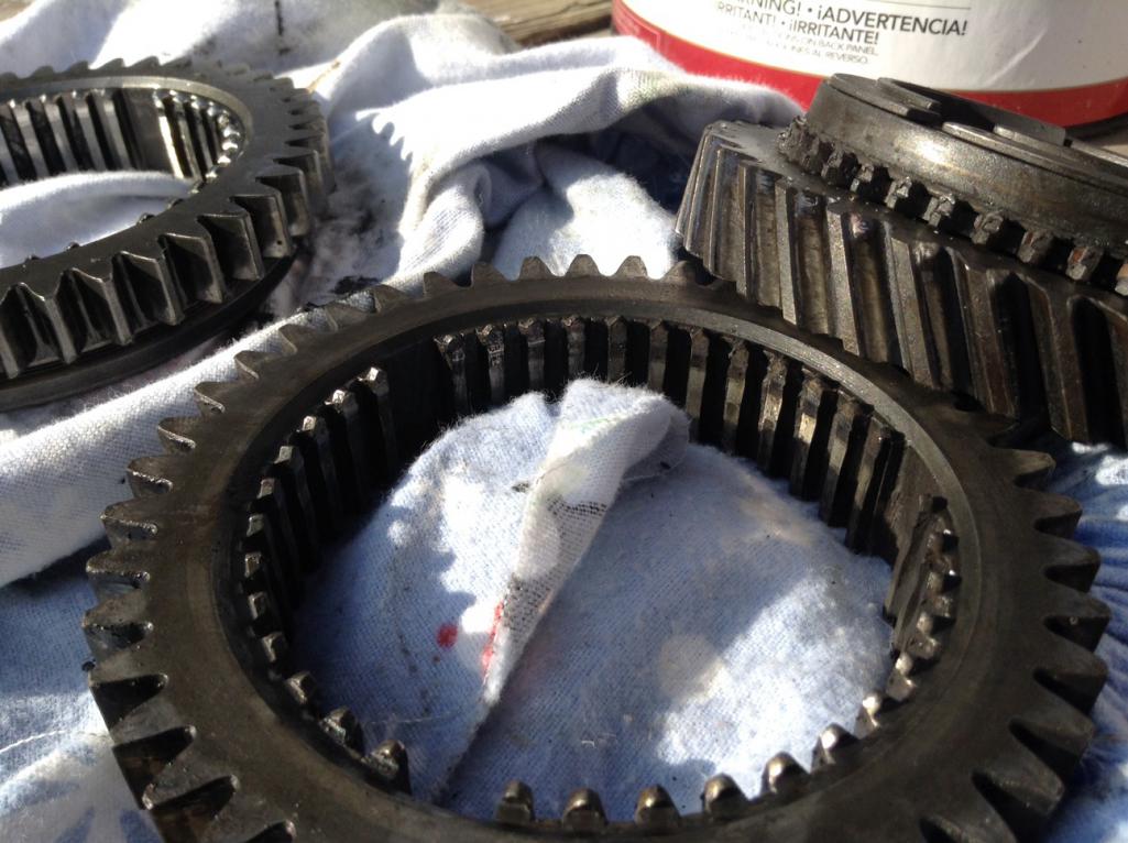

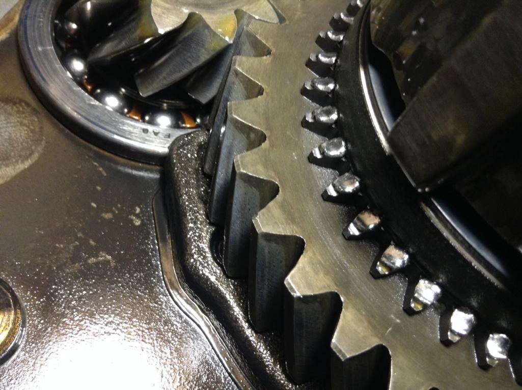

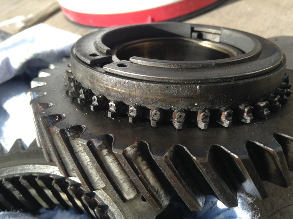

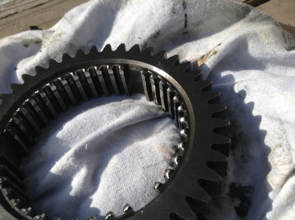

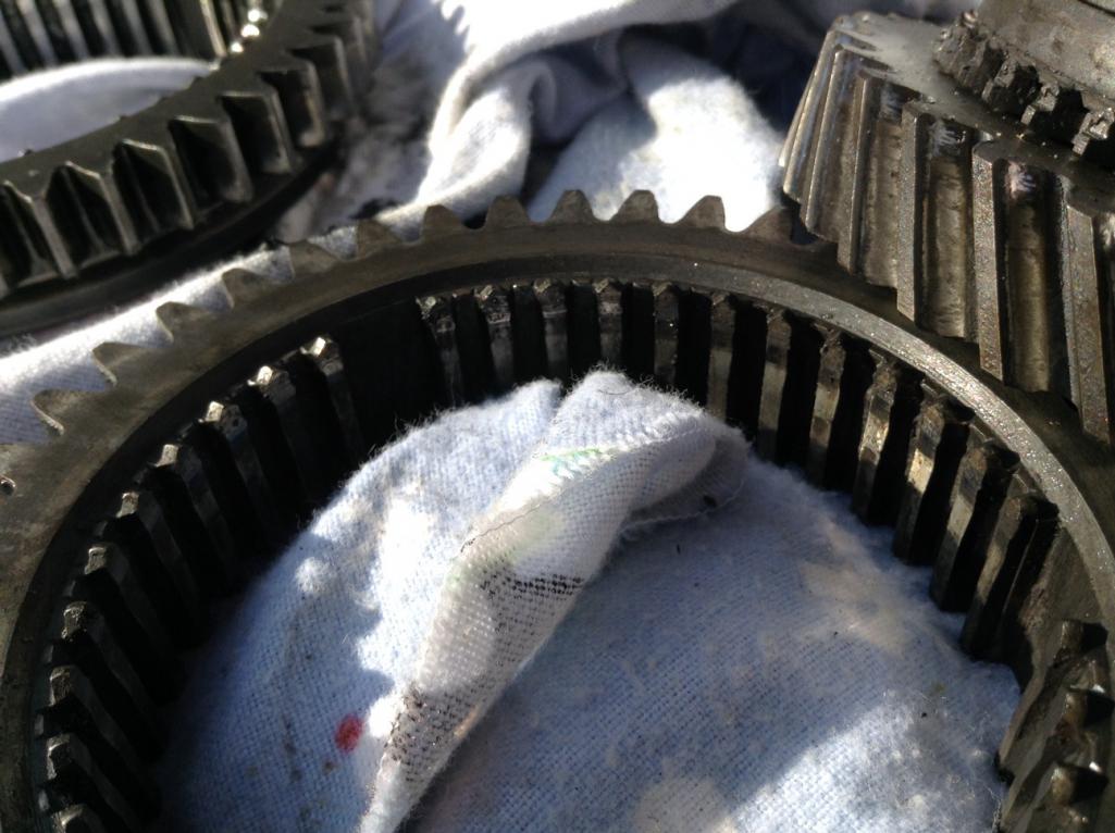

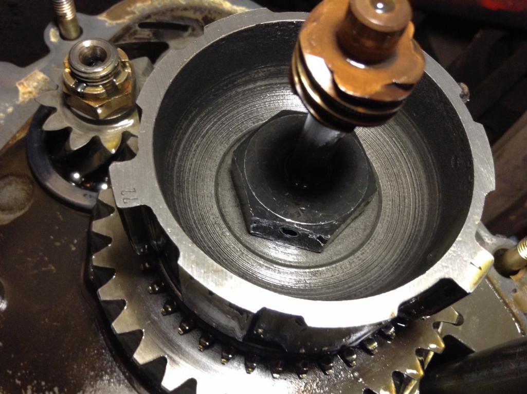

914bub   Ok so George,Thepaintedman, inspired me to tear in...   Jan 18 2015, 02:25 PM
Bartlett 914   Looks pretty bad. Dog teeth and no doubt the slide...   Jan 18 2015, 02:48 PM
Jeffs9146   I am in Discovery Bay and I have a few boxes of sp...   Jan 18 2015, 03:02 PM
dangrouche   all is not lost; you can repair 1st/reverse slider...   Jan 18 2015, 03:03 PM
914bub   I got the parts out of my core transmission. They ...   Jan 18 2015, 04:26 PM
Dr Evil   That slider looks useable, clean it up to be sure....   Jan 18 2015, 08:31 PM
Dr Evil   You will need to lock the trans in 1 and 5 to hold...   Jan 18 2015, 09:42 PM
Jeffs9146   I just grabbed a few of the dogteeth in my stash a...   Jan 19 2015, 03:36 PM
Dr Evil   Both are shit. Sorry. The wear on the better one i...   Jan 19 2015, 08:29 PM
Jeffs9146   I guess I wasn't clear, I wouldn't use e...   Jan 19 2015, 11:13 PM
Dr Evil   I guess I wasn't clear, I wouldn't use ...   Jan 20 2015, 07:11 AM
