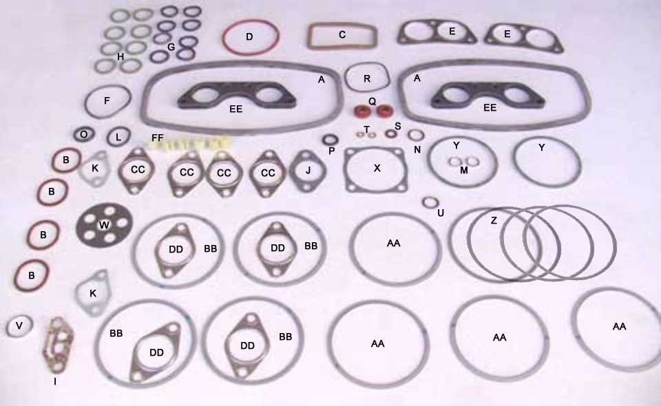

PET 039 198 075
A Valve Cover Gasket (2) CORK
B Exhaust Gasket Ring (4) COPPER
C Oil Breather Gasket (1) CORK
D Sump cover O-ring (1) RED RUBBER 77 X 4 mm
E Muffler Flange Gasket (2) Metalic / Fiber
F Flywheel O-ring (1) Graphite Impregnated
G Push rod tube inner (8) Black Rubber
H Push rod tube outer (8) Green Rubber
I Oil Filter Mount (1) Paper
J Oil Filler Tube Gasket (1) Paper
K Fuel Pump Gasket (1) Paper
L Fan Hub O-Ring (1) Rubber
M Oil Strainer Crush Washer (2) Aluminum
N Oil Plug Crush Washer (1) Copper 14 mm
O Distributor O-Ring (1) Black Rubber
P Oil Pickup Tube O-ring (1) Black Rubber 13.5 X 2.5 mm
Q Oil Cooler Seals (2) Orange/Red Silicone
R Oil Pump O-Ring (1) Black Rubber 60.8 X 2 mm
S Oil Pickup Case thru Bolt Washer (1) Copper 8.2 X 16 mm
T Oil Sump Crush Washer (2) Copper A6 X10 mm
U Oil Pressur Control Crush Washer (1) Copper 16 mm
V Oil Press Relief Valve Crush Washer (1) Aluminum 22 mm
W FLYWHEEL CRUSH WASHER (1) 5 HOLE Metal
X Oil Pump Gasket (1) Paper
Y OIL Strainer Gaskets (2) Paper -Pair w Alum Crush
Z Cylinder Base Gaskets (4) Metal 100 X 109 mm
AA Cylinder Head Gaskets (4) Metal 94 X 105 X 0.7 mm 2.0 L
BB Cylinder Head Gaskets(4)Metal 93 X 104 X 0.7 mm 1.7,1.8L
CC, DD Not Applicable to F.I.
EE INTAKE MANIFOLD GASKETS (2) BAKELITE
FF CASE VIBRATION DAMPERS (6) NYLON
