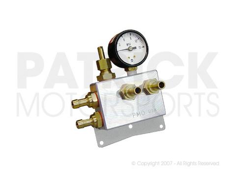

Im looking for suggestions on how to plumb the fuel lines for the PMO carbs. Where should the regulator be mounted?

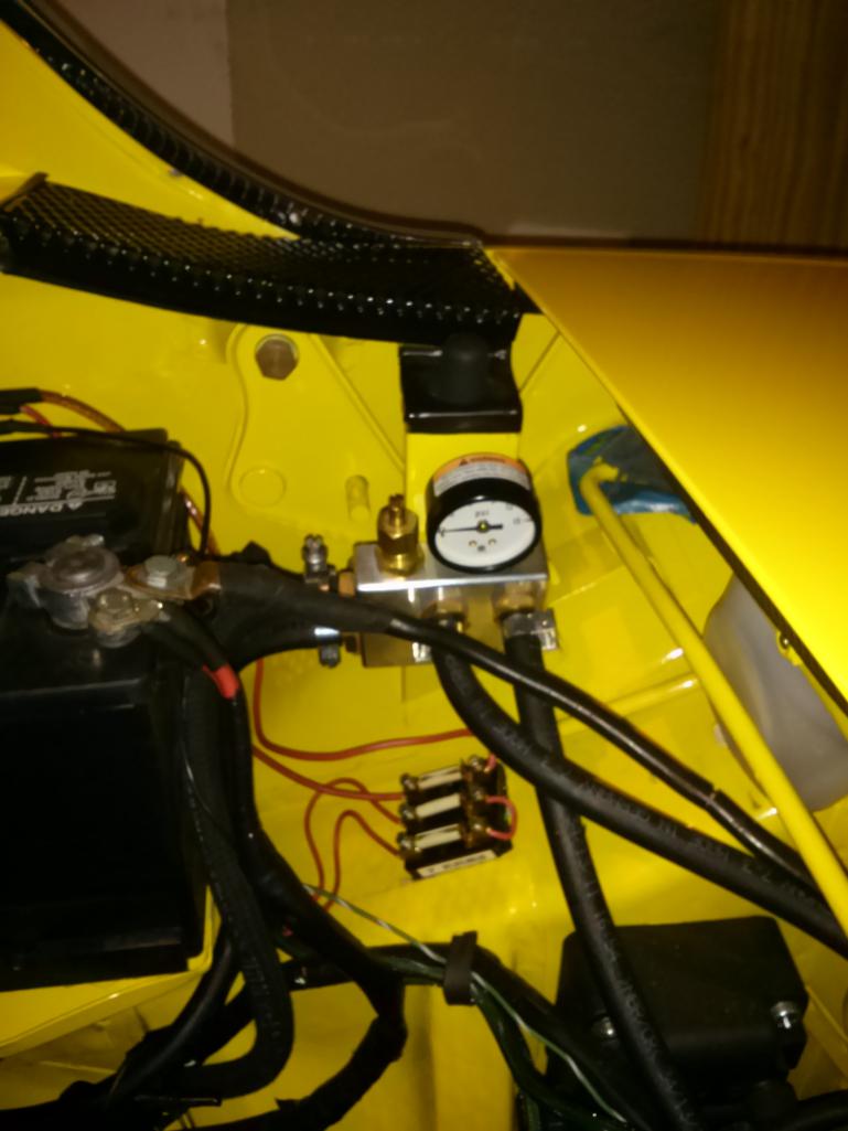

I dug this picture up from when the engine was installed. Clearly a cell phone picture (IMG:style_emoticons/default/sad.gif)

Doesn't really matter, but where ever you mount it make it easy to see the gauge, easy to get at the adjuster and not in the way for working on the engine. I've also seen it mounted on the back trunk firewall between the carbs.
You could take the gauge off and mount it to the PMO fuel bar.
I'd run your fuel lines in a loop like on FI systems.

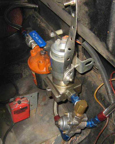

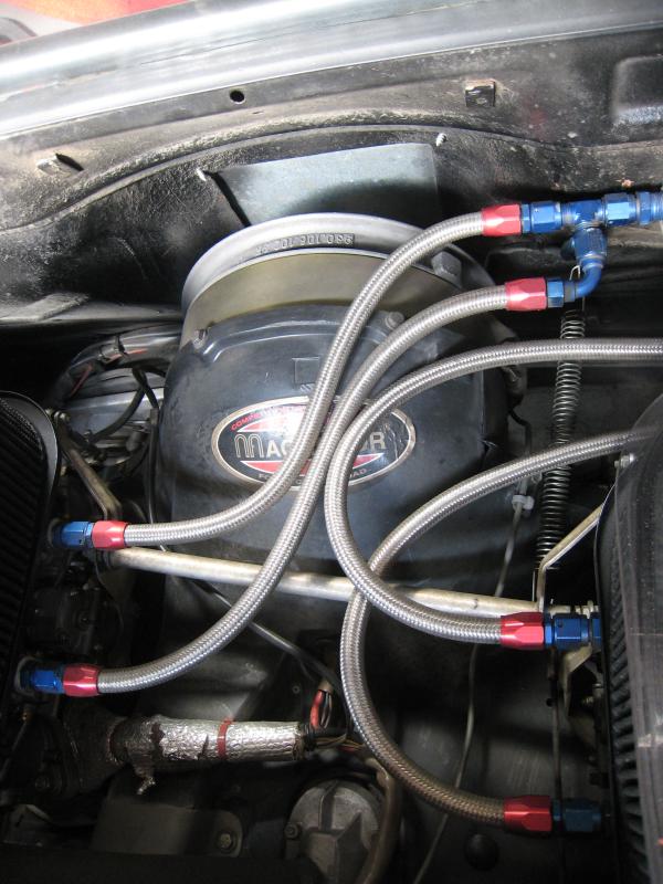

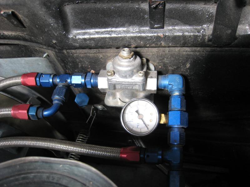

Two regulators - one in front reducing the pressure to about 12 psi. Second one in engine bay on firewall reducing pressure to 4 psi. This has served me well for about 10 years.
Attached Image Attached ImageAttached Image

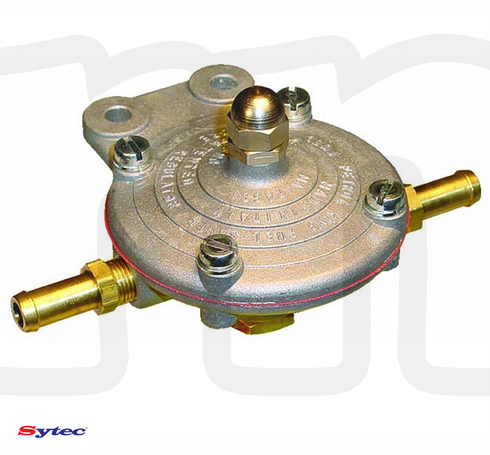

The Malpassi fuel regulator I'm using is favored by a lot of weber shops (Pierce Manifolds, aircooled.net, UK speed shops, etc) and should be easy for you to find in Europe. They came stock on a few cars over there as well. Made in Italy.
They are real small, less than 3 inches.
(IMG:http://www.914world.com/bbs2/uploads_offsite/www.rallynuts.com-26-1418761625.1.jpg)
Thanks Mark. Malpassi doesn´t have very good reputation here. Maybe because they are made in Italy (IMG:style_emoticons/default/biggrin.gif)
But, I have to say I had Malpassi in my ´63 Beetle with dual Dellortos and zero problems with fuel pressure.

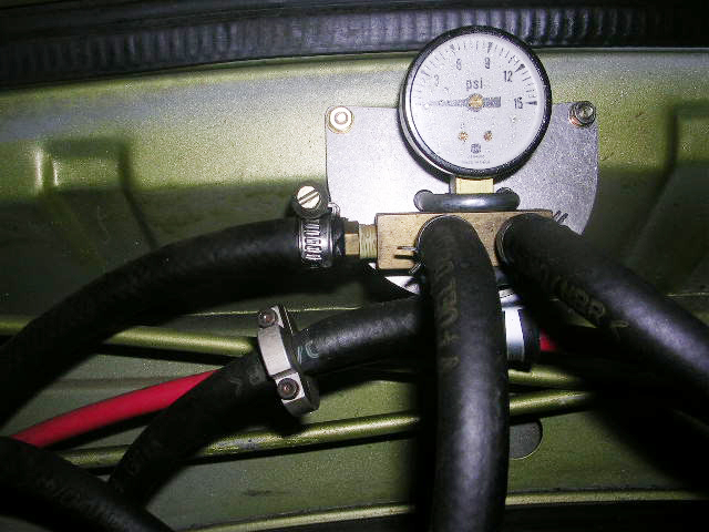

The one we installed on Glenn Sager's 3.0 conversion uses what I described above. If they have different ones I do not know. I'll add an image to this post in about 20 minutes.
(IMG:http://www.914world.com/bbs2/uploads_offsite/i239.photobucket.com-1696-1418767310.1.jpg)
Installed on the back firewall, between the carbs.

That must be very early, the ones I see now don't look like that. They have a big chunky body with a brass adjustment screw and lock nut like in the first pic of the thread.
