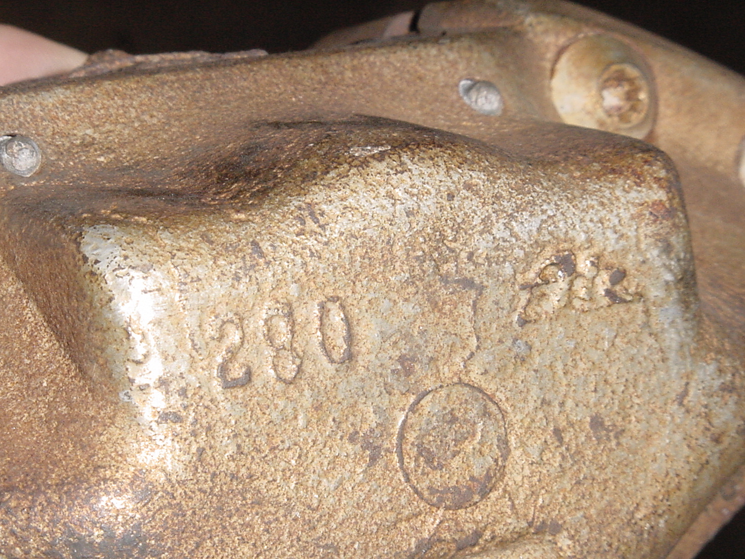

these too. 3 1/2' bolt spacing, '280' cast into the caliper.

280 is just a casting number. See the small lines heading out from the circle? Those are cracks beginning to form in the original casting. From looking at casting numbers on limited production cars, we're guessing 500 units out of each casting.
