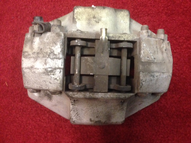

> What kind of calipers are these?
tornik550
post Jan 7 2015, 01:31 PM
Posts: 1,248
Joined: 29-January 07
From: Ohio
Member No.: 7,486

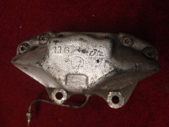

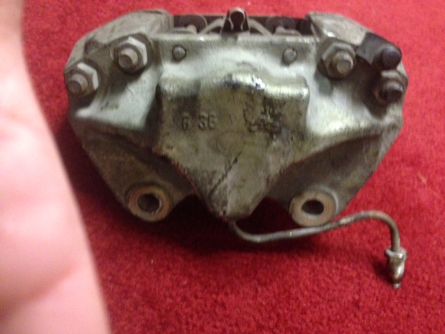

These are from a 911 however I do not know the year. I think it was somewhere in the 80's. What kind of caliper are they. If I am going to use them (I have a 911 suspension) what rotors do I buy?
tornik550   What kind of calipers are these?   Jan 7 2015, 01:31 PM
rhodyguy   Just went thru this. Measure the bolt hole spacing...   Jan 7 2015, 01:36 PM
tornik550   3.5" bolt hole spacing 1cm middle caliper spa...   Jan 7 2015, 02:01 PM
SLITS   Spacer between halves are either 7 mm or 10 mm as ...   Jan 7 2015, 02:27 PM
tornik550   Spacer between halves are either 7 mm or 10 mm as...   Jan 7 2015, 02:32 PM
SLITS   20 mm = 911SC calipers .. called "A" cal...   Jan 7 2015, 02:53 PM
rhodyguy   yes, they are 1 cm thick.   Jan 7 2015, 03:14 PM
Eric_Shea   11mm thick spacers = Carrera or "Wide A-Calip...   Jan 7 2015, 03:25 PM
colingreene   Could you take the spacer out and run the more nar...   Jan 7 2015, 05:35 PM
bdstone914   Could you take the spacer out and run the more na...   Jan 7 2015, 05:52 PM
Eric_Shea   Could you take the spacer out and run the more na...   Jan 8 2015, 09:36 AM
