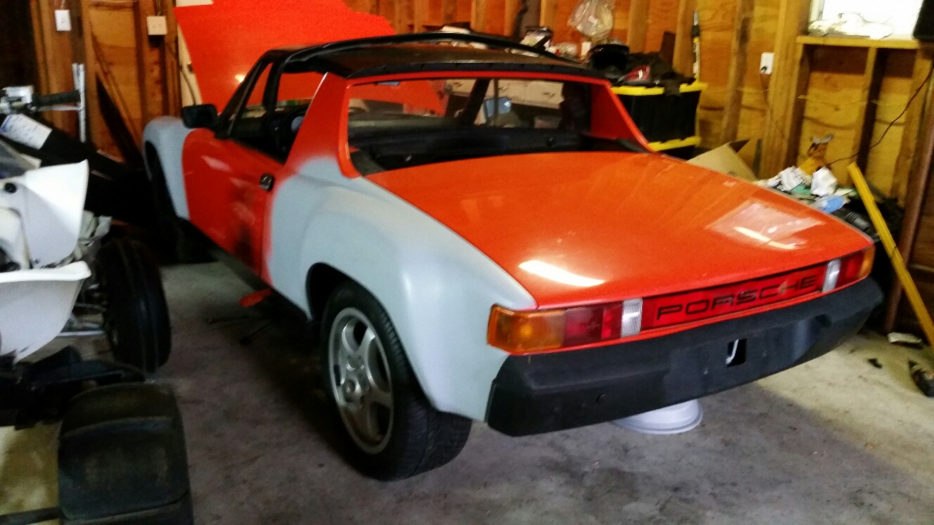

I've put this car off long enough. I am buying a 2004 WRX motor to put in. As well as a suby tranny. I plan to get everything up & driving in this car. Then swap the drivetrains with my green car. We'll see how that plays out.

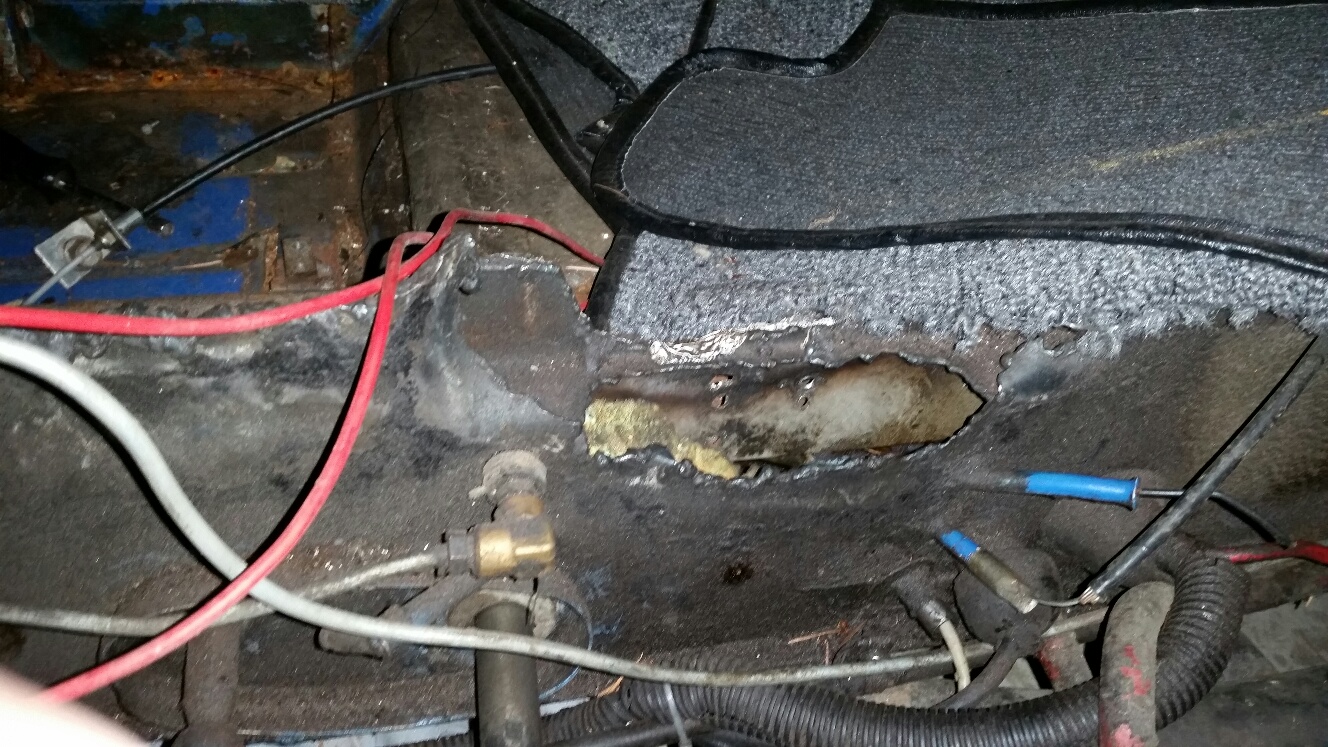

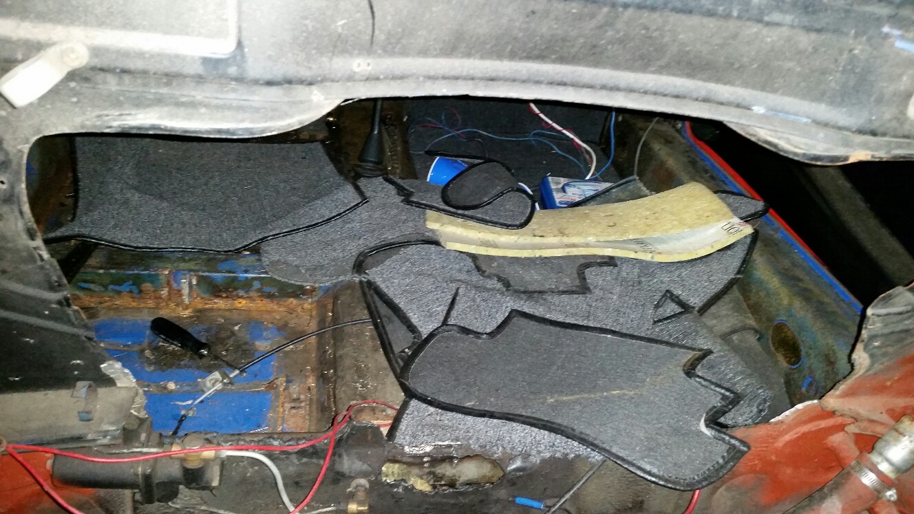

I need to replace the firewall section that was cut out by the PO in the late 80's. I'm going to replace the lower cutout of the firewall first. I like the idea of making the upper section of the firewall removable. Nice to have access from the front if possible. At least while I am getting it all setup. If I don't feel the need later I'll just make the firewall stock.
