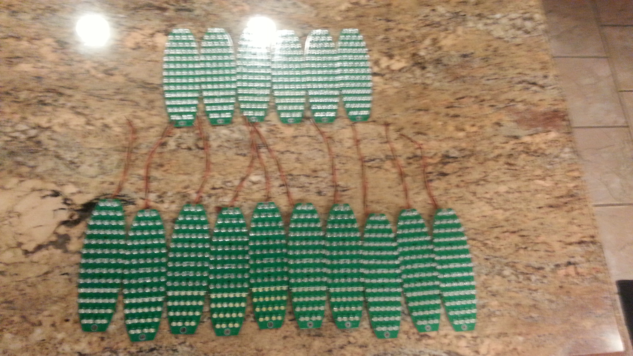

Making some progress on the front lights. Going slower than I hoped. These more complicated to make than the rears because of the blanking circuit and that the LEDs must be soldered with the body of the LED 115mils off the board so they can be pointed forward when mounted on the vehicle.

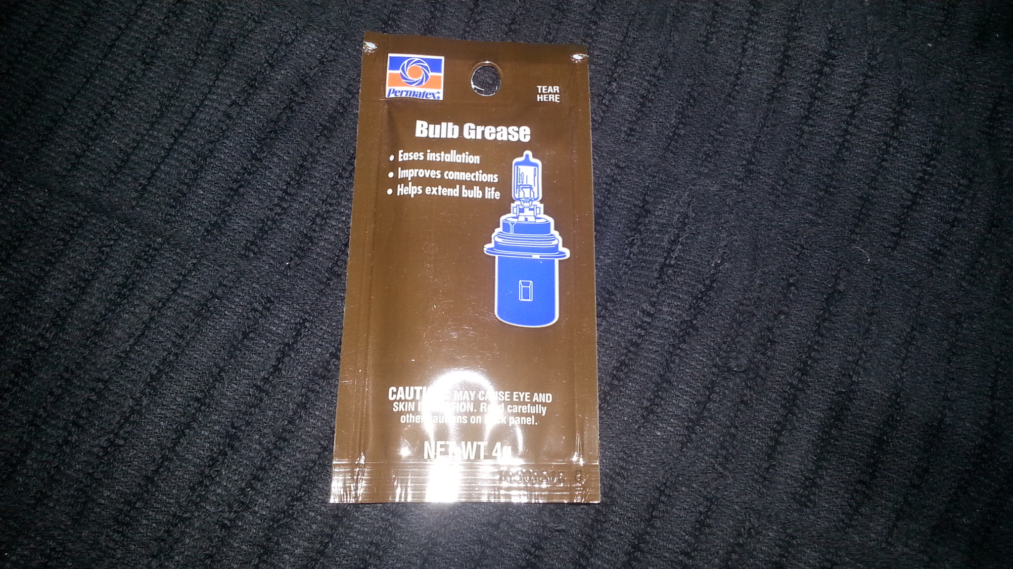

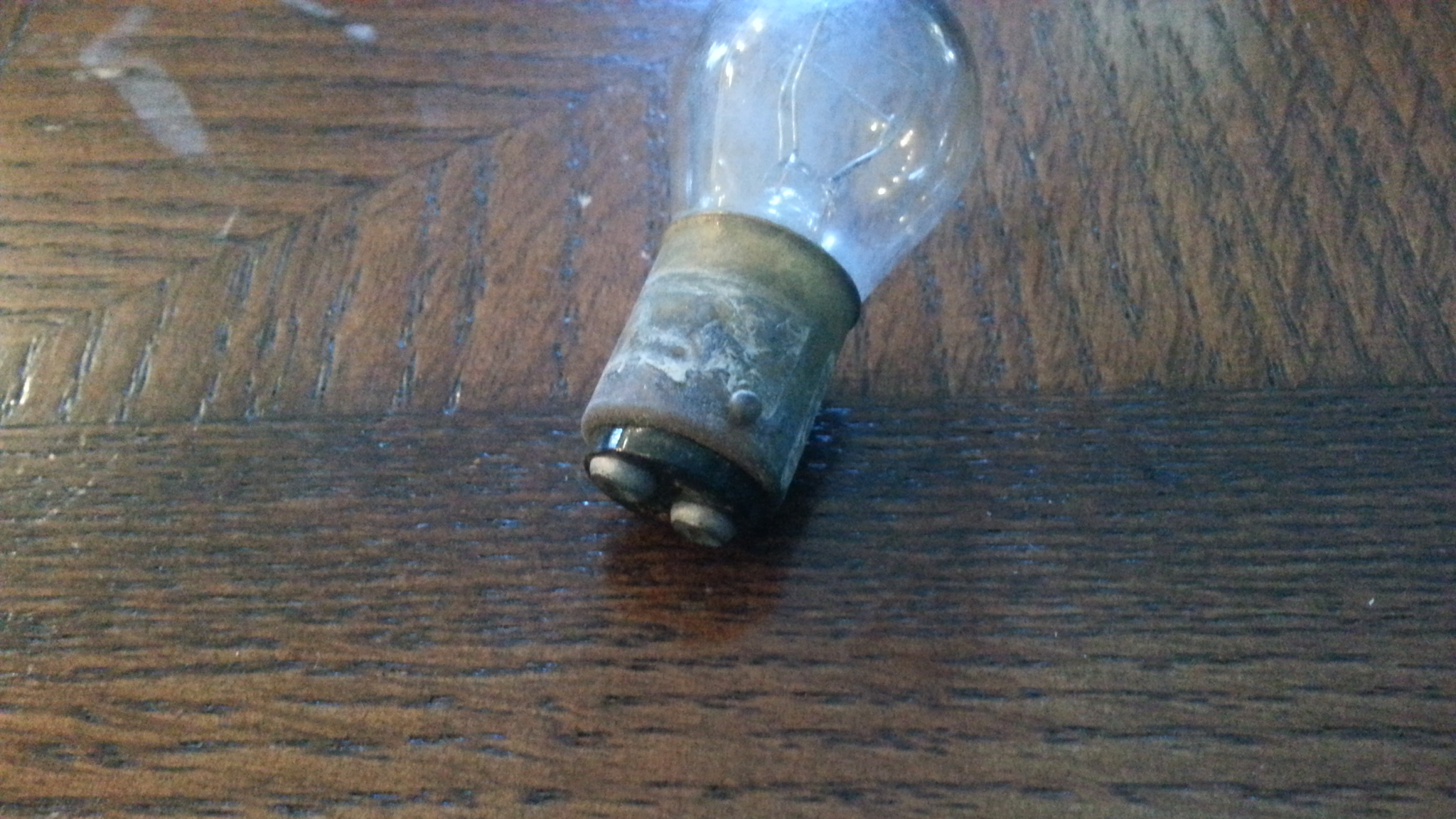

A couple of folks have had issues installing the bulb bases into the existing sockets. Much of the difficulty has to do with the existing socket which is over 40 years old and may likely have suffered from aging and moisture. This makes the bulbs hard to install/remove and can affect the electrical connection to the bulb.
This is a good time to do some preventive maintenance on the socket to improve electrical connectivity and ease installation of the LED bulb bases or even the standard bulbs.
Here's an example of a bulb with severe oxidation and crud that came off of my 930. This bulb was so hard to remove that I thought the bulb was going to break in my hand as I removed it. Likewise the socket looked in the same condition. I connected an LED board for the 911 in its place and it didn't light up at all. I had to clean the socket with a wire wheel on my Dremel before the LEDs would light up.
After cleaning the socket with a wire wheel, or scraping the crud with a small screwdriver, dielectric grease like this one are available at your FLAPS for less than $2 goes a long way to improving electrical contact and easing installation of bulbs/LEDs.

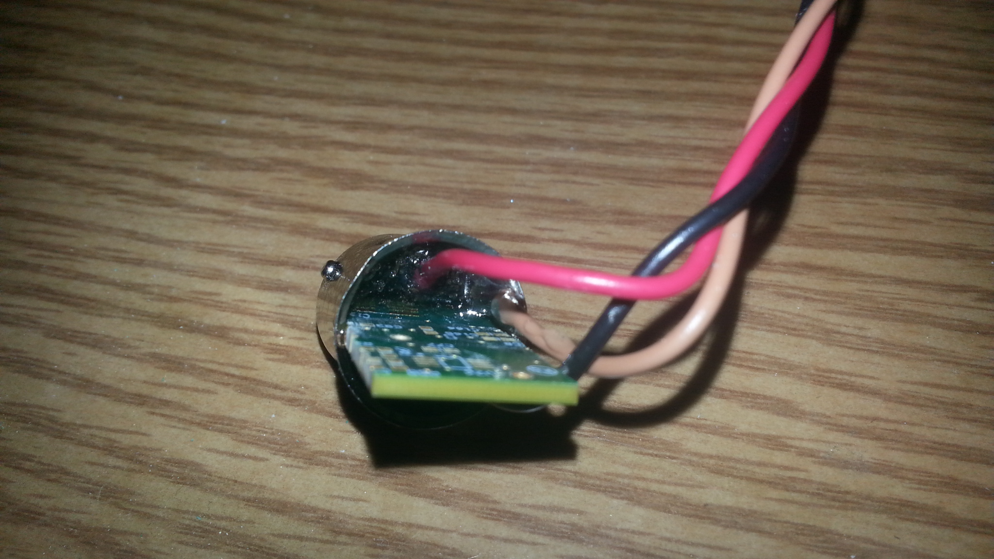

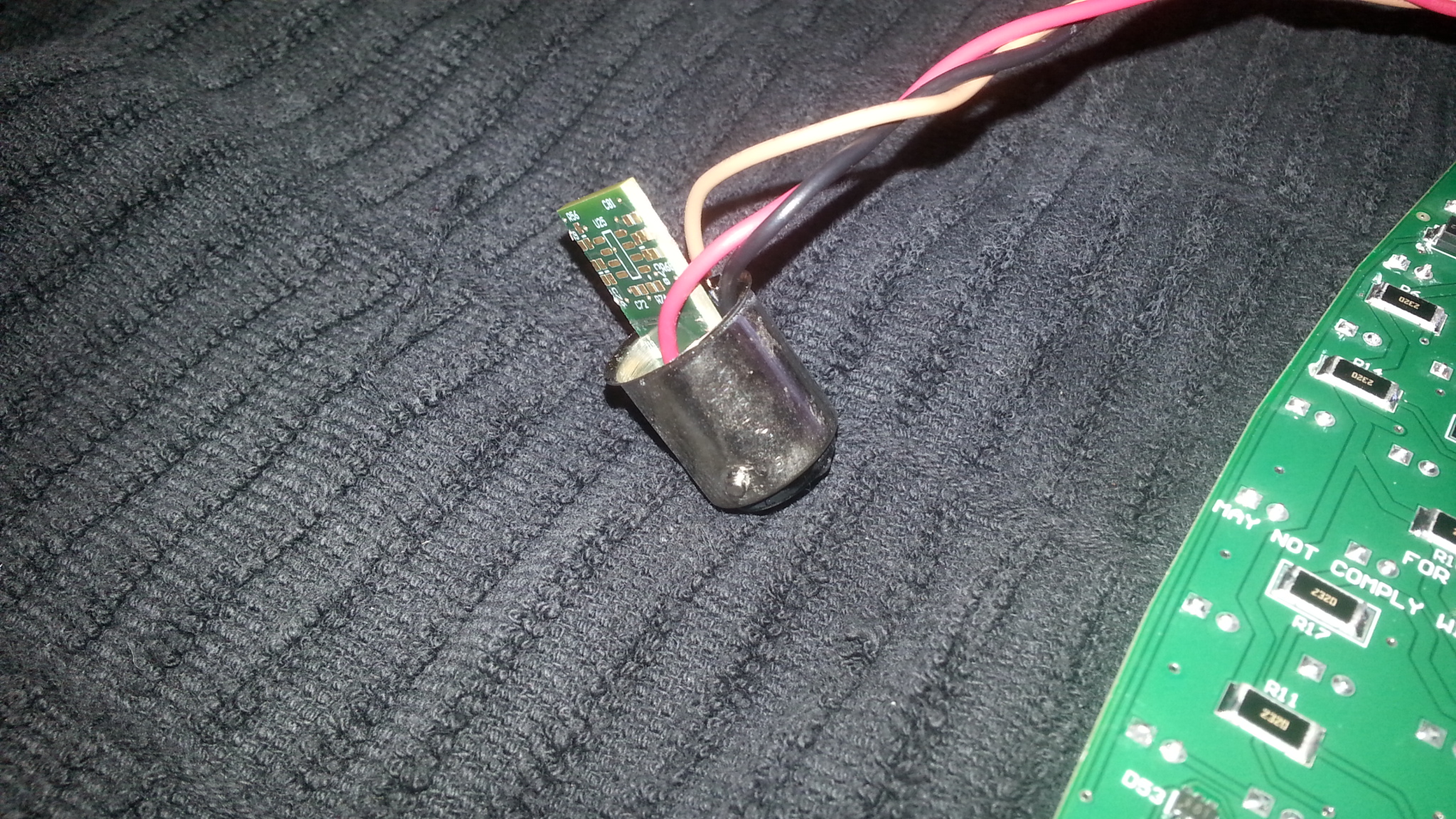

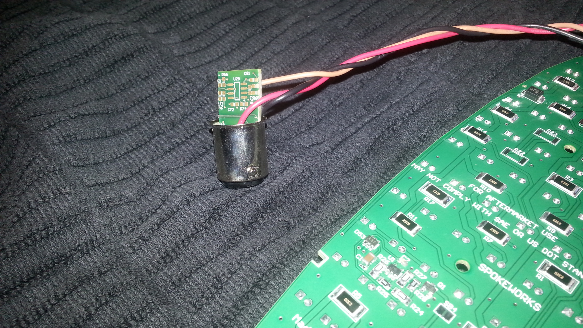

I've been thinking of ways to provide a handle to help assist the installation of the bulb bases. Thought about a piece of metal, wood, or plastic but nothing seemed to fit the bill.
Then I tried a piece of circuit board. Seems like it would give a good grip for installation and would not short out the wires if they touched. What I did was chop up some old boards we had lying around work. I will try this on these boards.
Would it take away from the product if I used old circuit boards for the handles? I could state that we're using recycled materials to be more ecologically friendly. Your feedback is welcome.

That'd be great! I buggered up one of my tail light bulb bases trying to get a good grip so it would turn and engage in the socket. This "green solution" is a great idea!

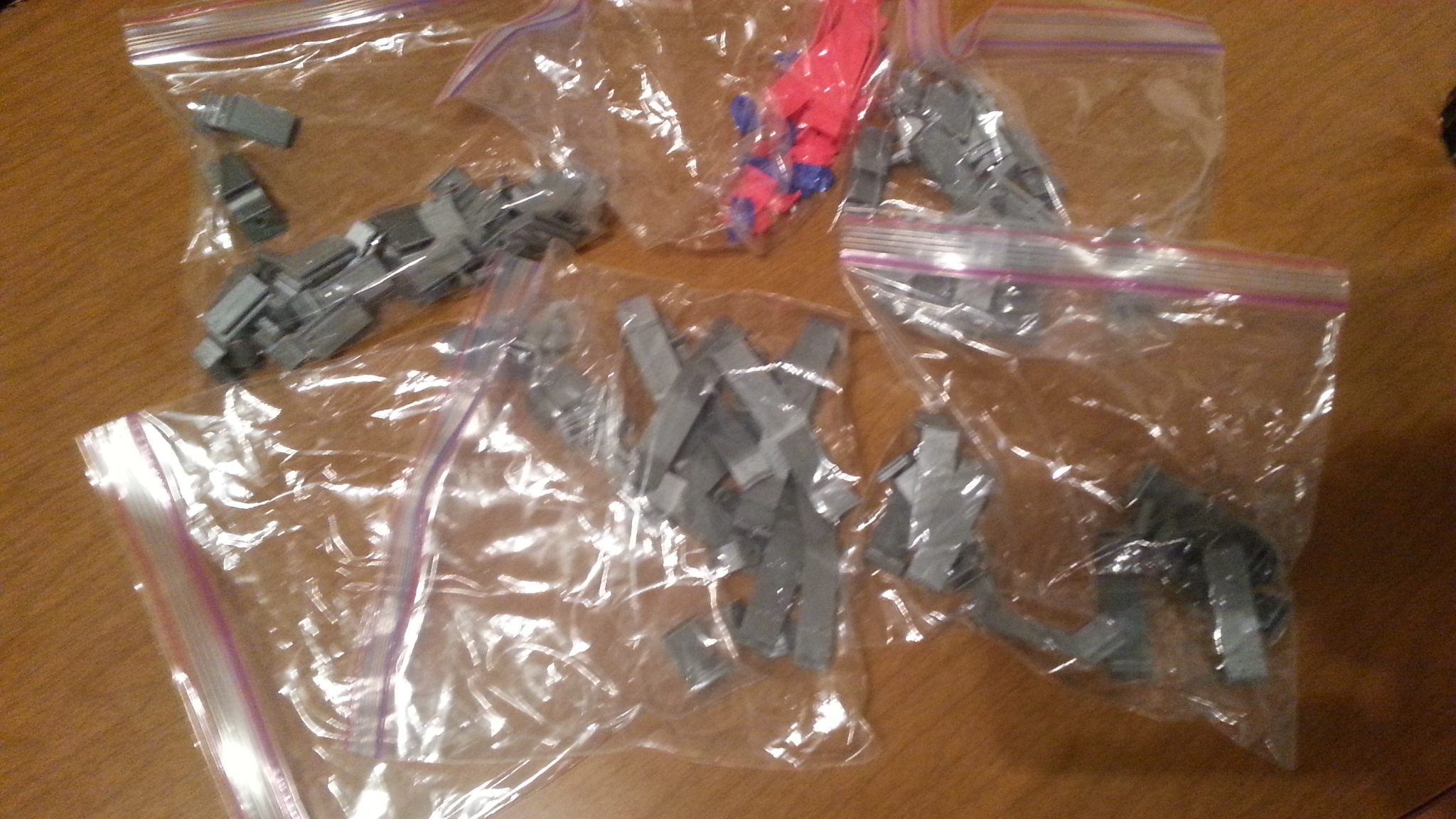

It's been slow getting all the cogs going for this project. Just received the first batch of clips for the fronts and rears. Things are going to start happening now. I gotta get my own 3d printer. (IMG:style_emoticons/default/dry.gif)

I'm good with it (IMG:style_emoticons/default/shades.gif)
Are you going to glue the boards into the bulb bases?

Yes. I fill the bases with epoxy then install the handle. The epoxy locks the wires in place so they won't work loose from the base. The handles are in rock solid. So installation can be done with a pair of pliers or your fingers. Should make installation very easy.
