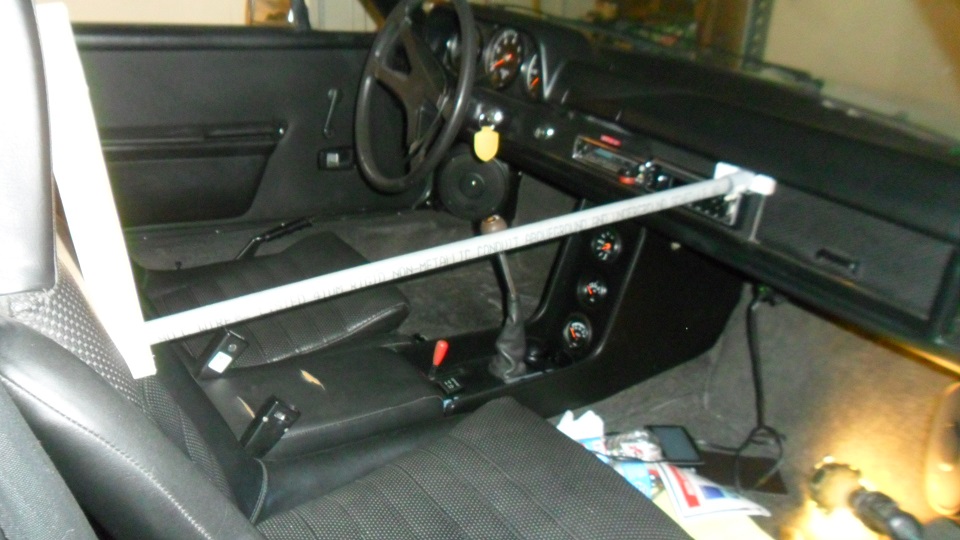

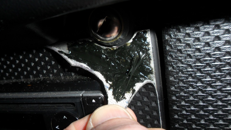

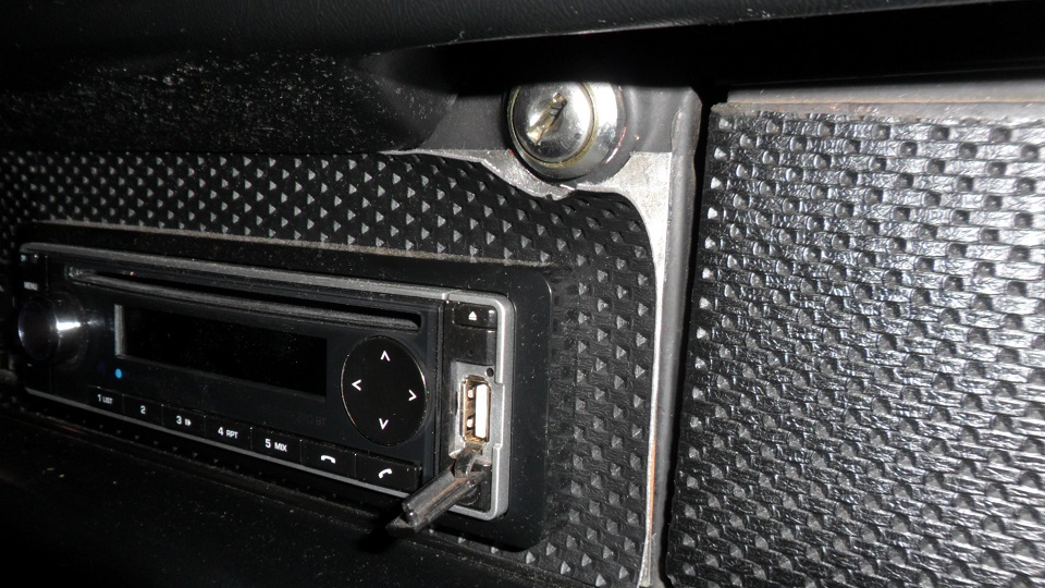

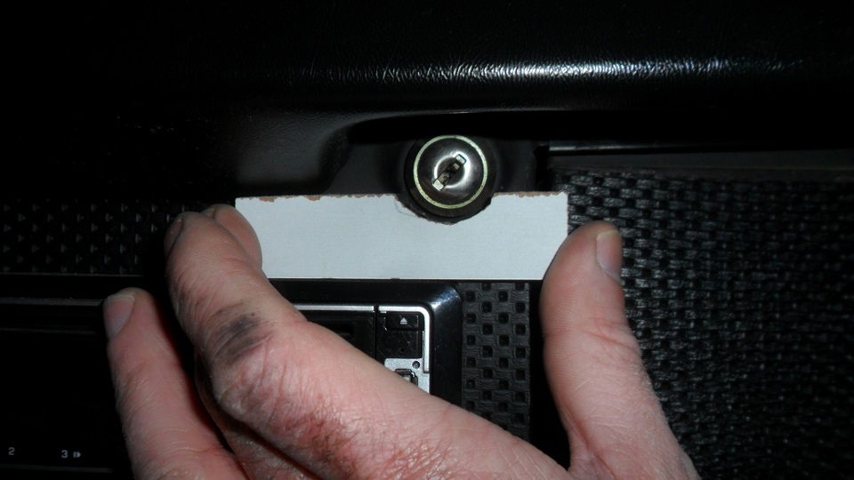

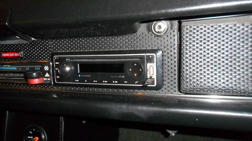

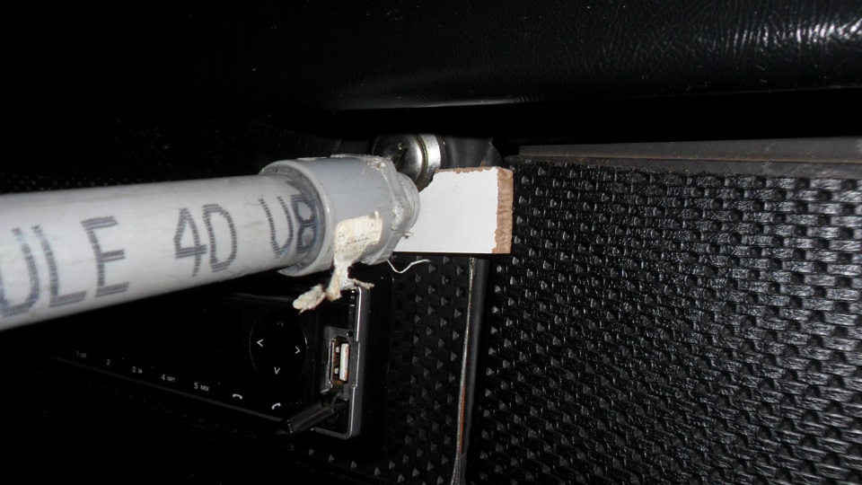

The industrial strength adhesive tape I used on my radio plate started pulling away in the heat of the summer. I needed to add some 3M adhesive. Cut a piece of PVC and scrap wood and used the seat to apply pressure. Turned out nice:
