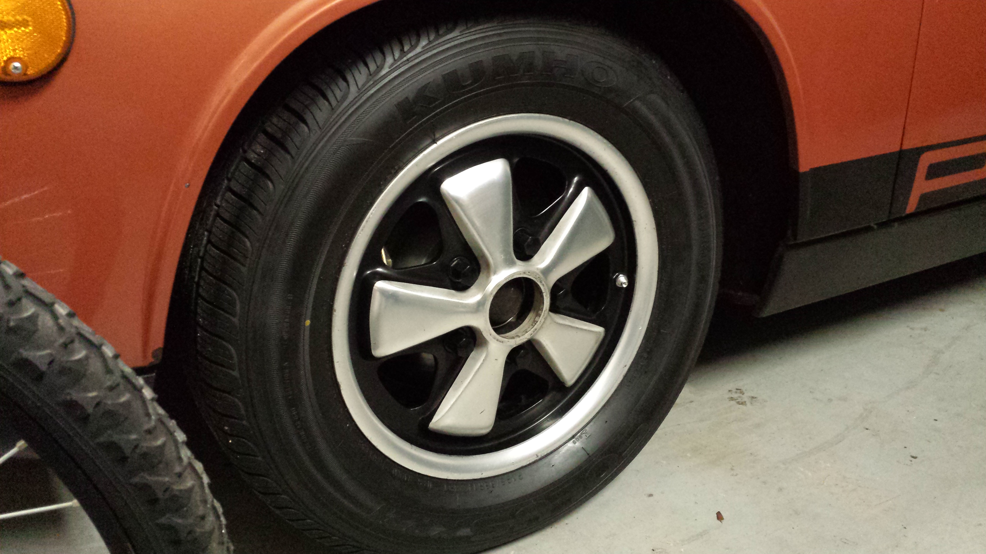

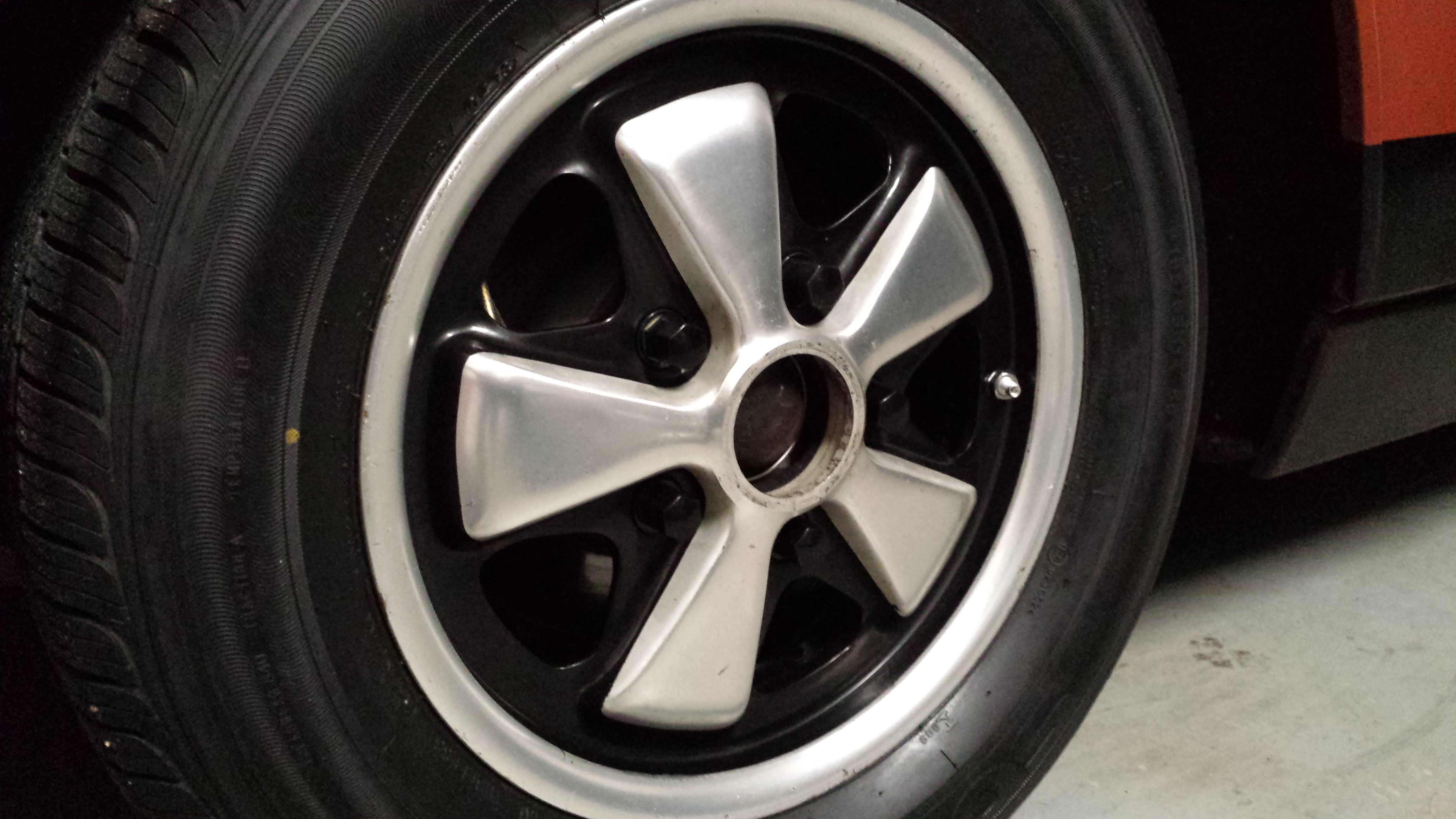

First wheel done with the rustoleum enamel gloss.
DRPHIL914
post Jan 23 2015, 07:37 PM
Dr. Phil
Posts: 5,968
Joined: 9-December 09
From: Kennesaw, GA
Member No.: 11,106
I think this worked pretty good. Just prepped it by degreasing it good and making sure it's level before pooring.
