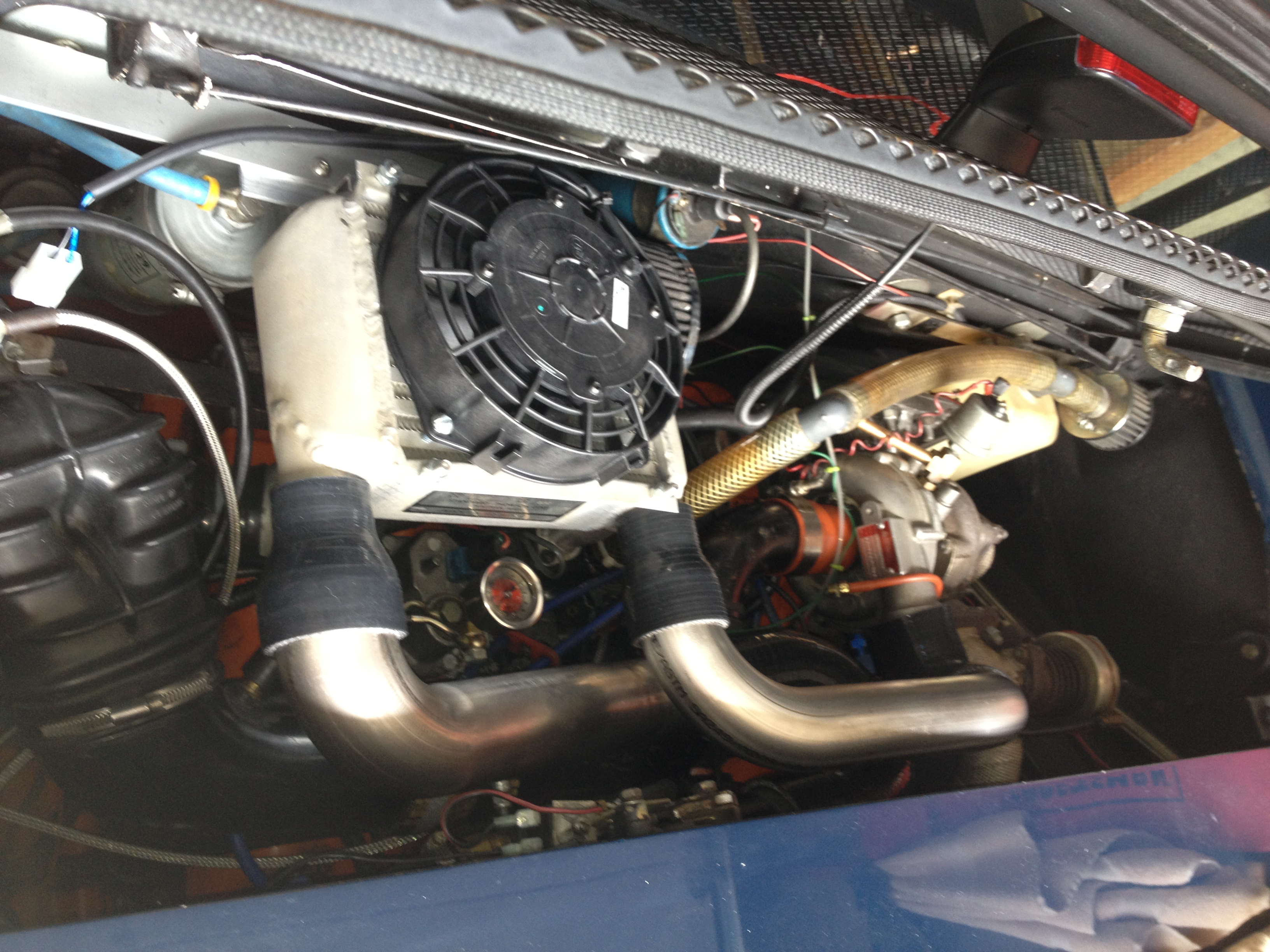

McMark   The difference is that an electric fan charger is ...   Jan 29 2015, 08:39 PM
ConeDodger   The difference is that an electric fan charger is...   Jan 29 2015, 08:56 PM

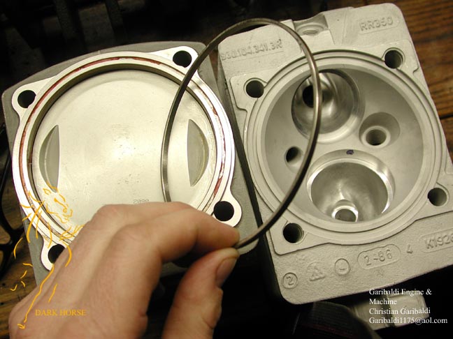

Maltese Falcon   Barrel to cylinder head flame rings, there are mat...   Jan 30 2015, 11:45 PM
r_towle   Barrel to cylinder head flame rings, there are ma...   Jan 31 2015, 10:17 AM

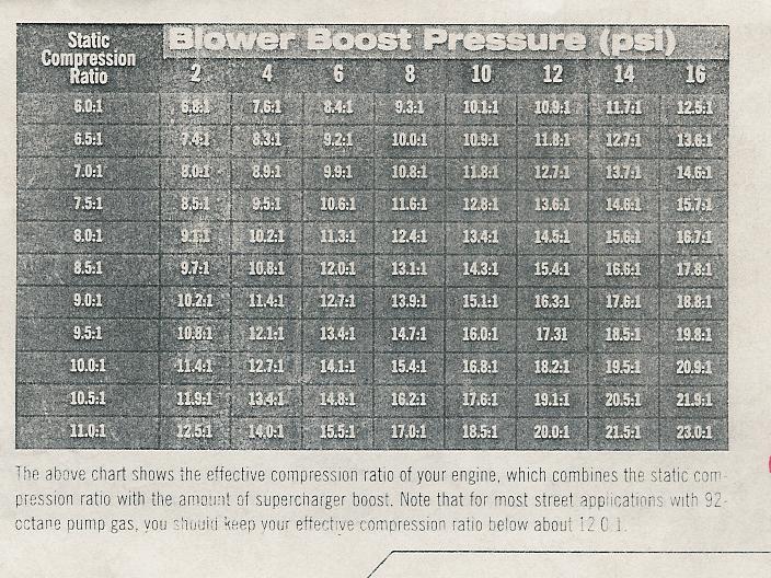

Maltese Falcon   Compression ratio chart, or: What happens to your ...   Jan 30 2015, 11:56 PM
mepstein   Compression ratio chart, or: What happens to your...   Jan 31 2015, 08:30 AM
