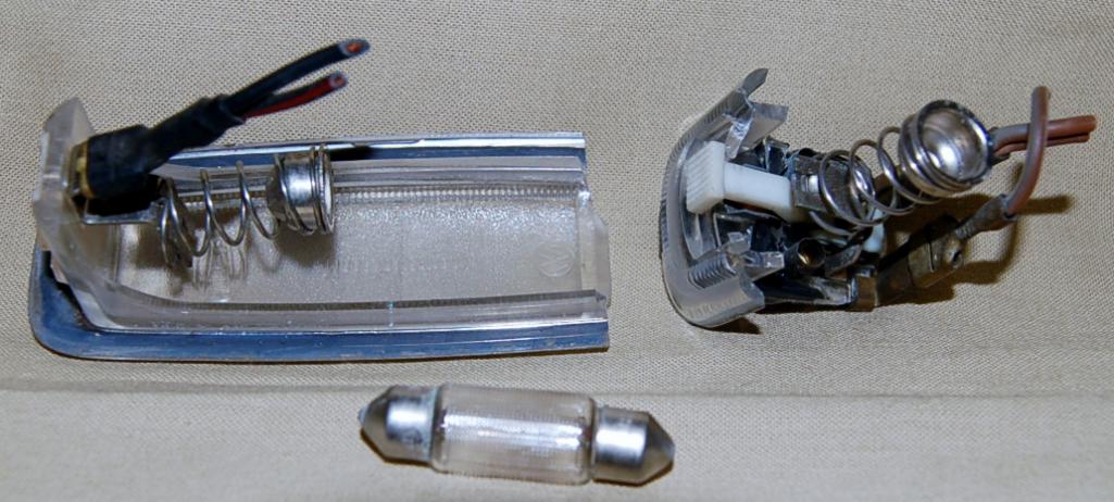

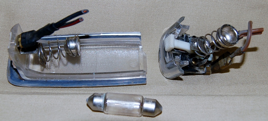

QUOTE(Jeff Bowlsby @ Feb 10 2015, 09:54 PM) *
This photo breaks my heart. Like seeing an abused child.
How many more milliseconds would it have taken someone to simply pull the disconnects off the light? But no...they had to cut wires...
I guess they wanted to make sure they knew how to re-connect in their car, right?.... (IMG:style_emoticons/default/blink.gif)

QUOTE(malcolm2 @ Feb 11 2015, 01:28 PM) *
Hey Guys (IMG:style_emoticons/default/popcorn[1].gif)
I didn't cut the wires, I am just trying to glue it together so I can sell it for big bucks. (IMG:style_emoticons/default/stirthepot.gif) I am open for someone to restore it & we split the profits. (IMG:style_emoticons/default/happy11.gif)

QUOTE(Jeff Bowlsby @ Feb 10 2015, 07:54 PM) *
I really hope that came from a parts car ...
(IMG:style_emoticons/default/sad.gif)

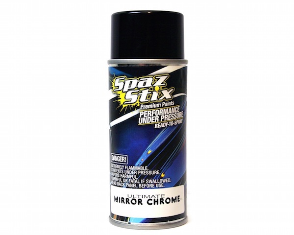

QUOTE(porsche913b_sp @ Feb 17 2015, 06:43 PM) *
I found the Spaz Stix Ultimate Mirror chrome paint at Amazon, but it says it is meant for airbrush, stupid question, I dont have an airbrush, can I use a paint brush and paint it on.
http://www.amazon.com/Ultimate-Mirror-Chro...rror+Chrome#Ask
Thanks in advance.
No, I wouldn't do that ... just get the aerosol spray if you don't have an air brush. I recommend spraying several very light coats rather than one big, heavy coat.
http://www.amazon.com/Ultimate-Mirror-Chro...t/dp/B0015H1FGA

Gotcha, good thing I ask, Thanks

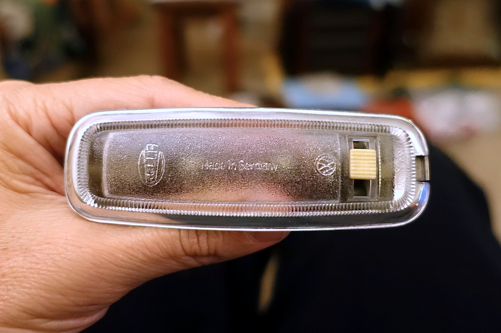

QUOTE(tweet @ Feb 17 2015, 08:42 PM) *
On the light you re-silvered, did you remove the old silver or paint over it?
In a perfect world you would want to start with a clean surface, which I know isn't always possible. My Sidler was a filthy mess when I got it. It looked like it went through the Baja 1000 or maybe a baby Osprey had decided to build a nest in it. So I used a toothbrush and some dish soap to clean it. What silver was there kinda flaked off, but not entirely.
This is a Hella dome light that was pretty good. I just sprayed over what was already there. It's not flawless by any stretch but it's hard to tell from the picture ... close enough for government work as they say.

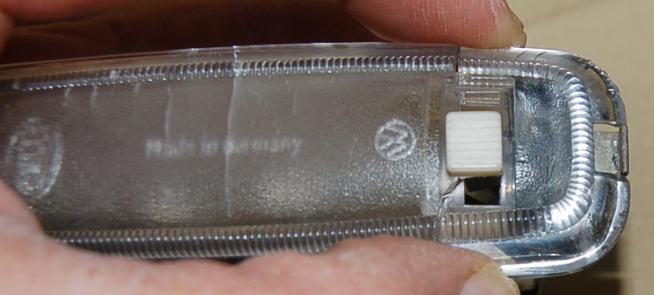

Good review Tom,
Here's a photo front & rear of an real one for the record. I have one broken in half I am trying to glue together, grrrrrr. (IMG:style_emoticons/default/idea.gif)
Tom
Thanks for this photo - it helped me reconnect my light the correct way. Now the light works correctly in all three modes. (IMG:style_emoticons/default/beerchug.gif)

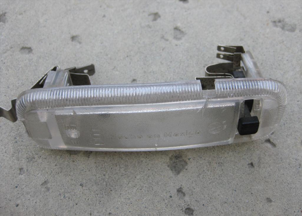

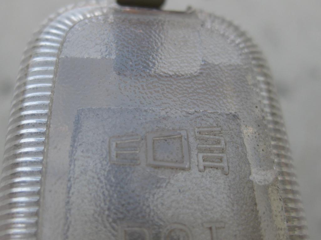

I ran across another example. Marked "EOSA", "DOT", "Hecho en Mexico", and VW logo. Has three positions and split terminals.
