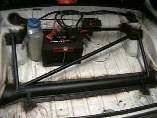

drew365
post Feb 7 2005, 08:08 PM
These are the good old days!
Posts: 2,004
Joined: 29-December 02
From: Sunny So. Cal.
Member No.: 37
Here's a pic that shows mine. A plastic bottle next to the battery in the trunk. I cut a hole in the side and ran the breather line through the plastic cap in the trunk. It's not stainless steel but I can see how much is in it and it was cheap like me.
