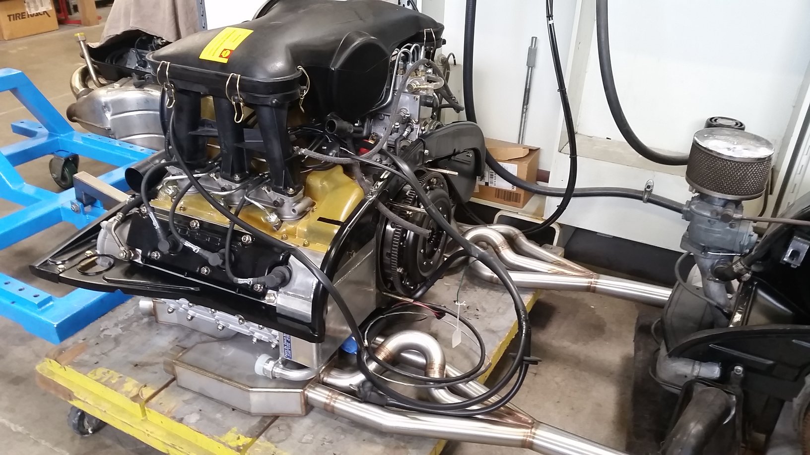

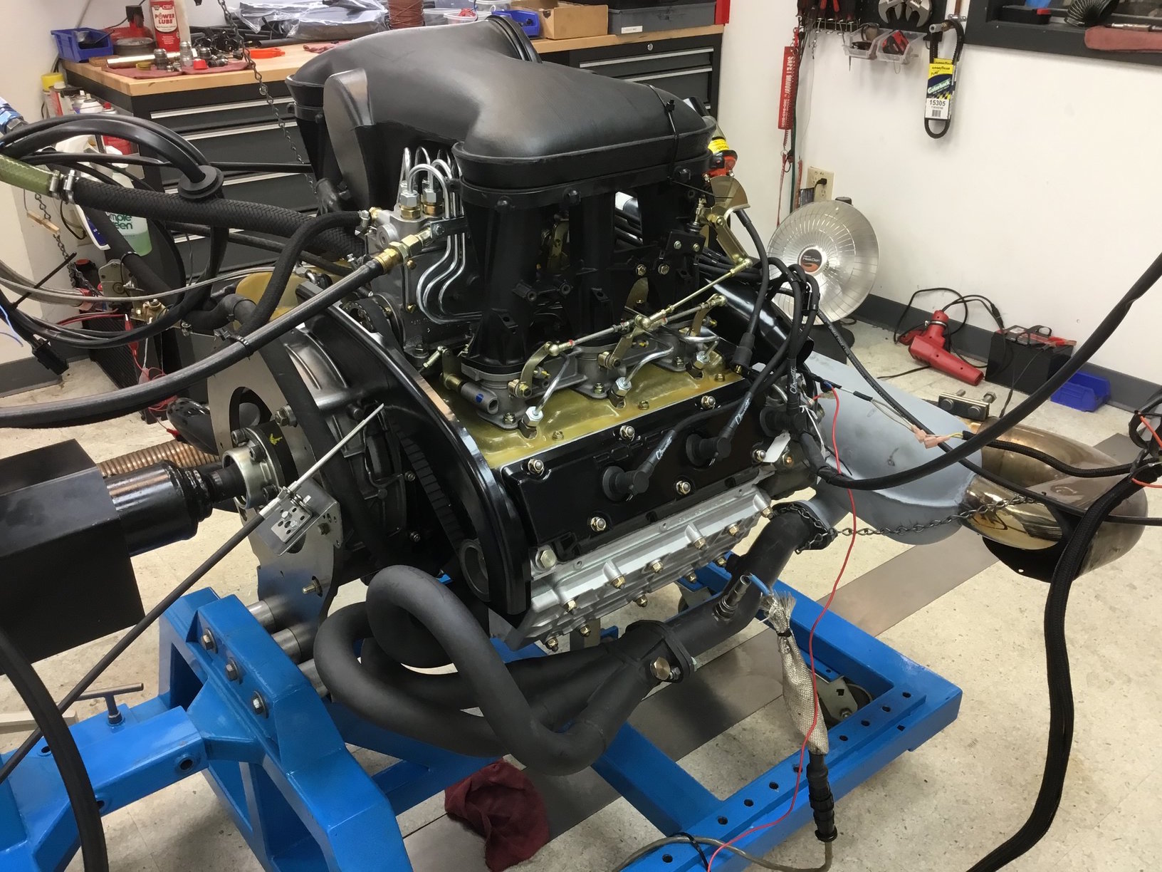

raynekat   I sourced a 2.4 T MFI motor from Australia of all ...   Jun 10 2016, 11:25 PM
raynekat   Of course, you'd have to have the mouse nest s...   Jun 10 2016, 11:33 PM
raynekat   MFI requires a CDI unit, so I sourced a used one t...   Jun 10 2016, 11:42 PM

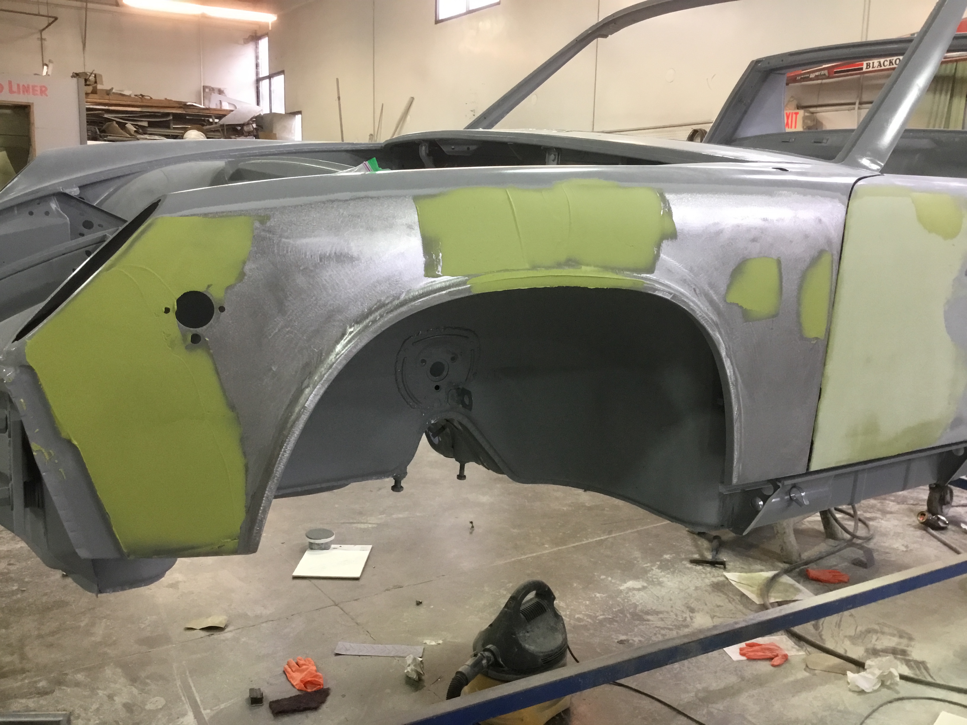

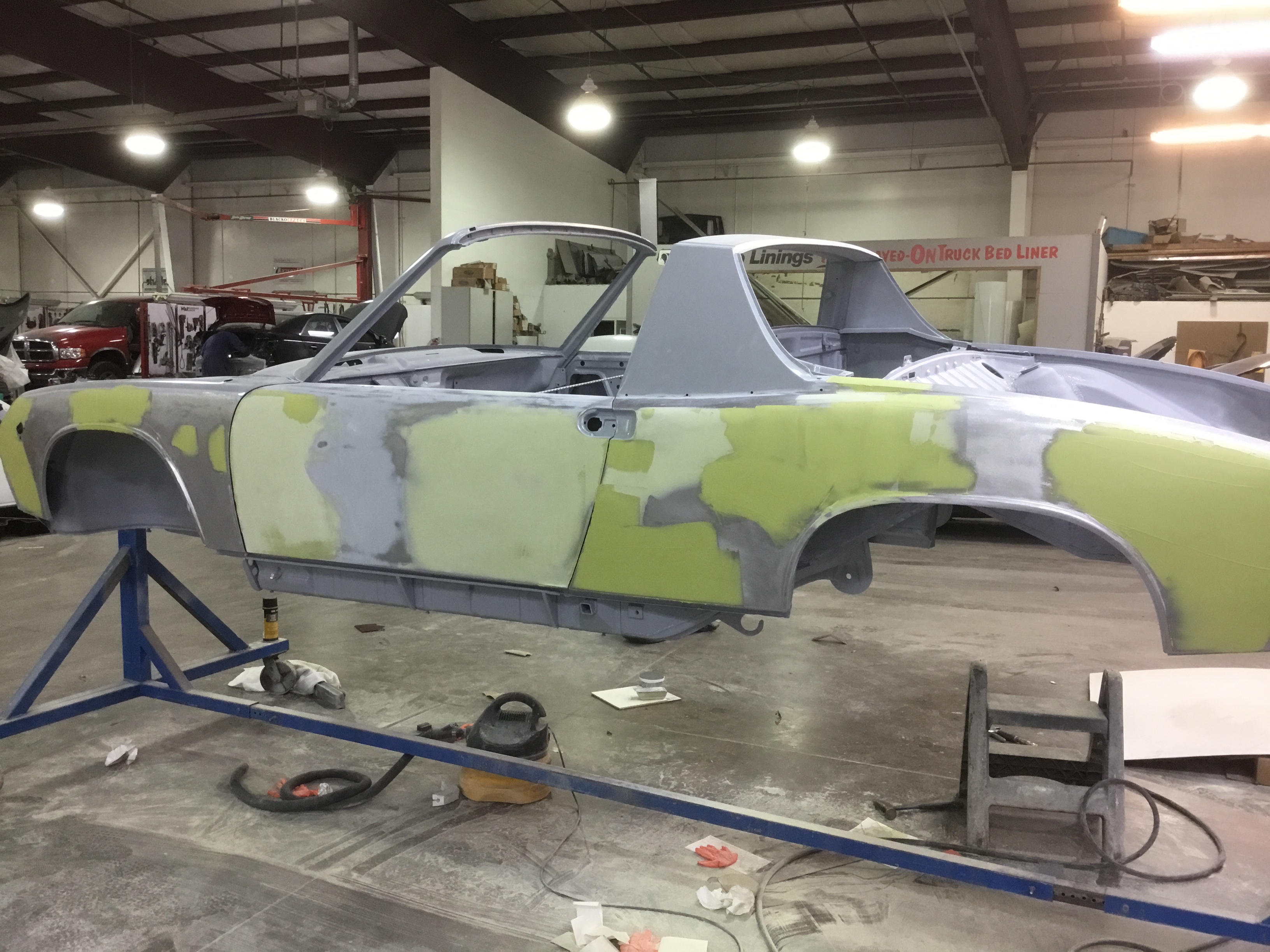

cary   I decide its time to start using the plasma cutter...   Jul 7 2016, 09:17 PM
cary   Then on to removing the exhaust shield from the ol...   Jul 7 2016, 09:41 PM
cary   We did extract the other hole plug. Have the templ...   Jul 7 2016, 10:09 PM

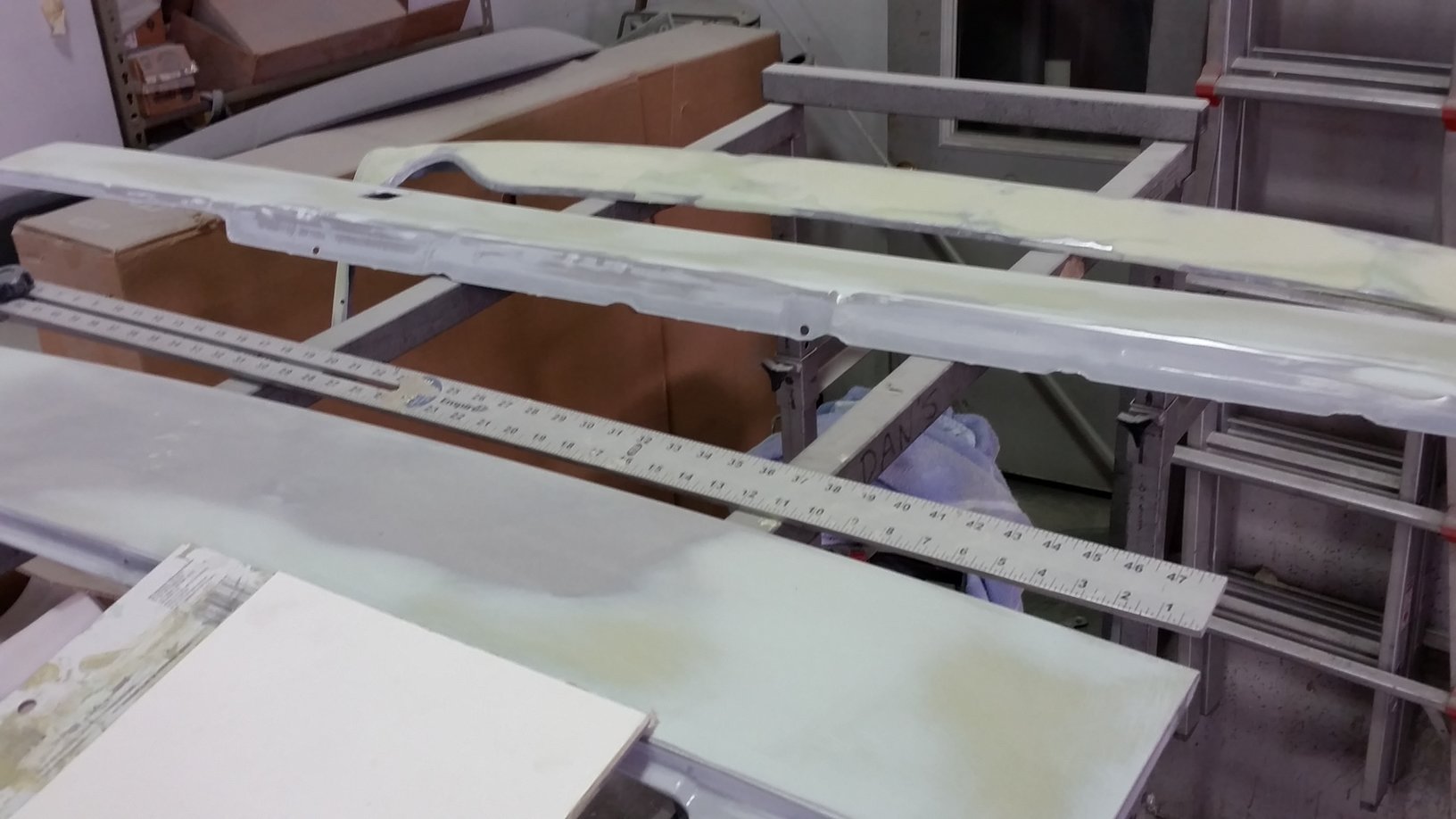

cary   Monday AM : Pulled out the torch cart and started...   Jul 11 2016, 09:50 PM

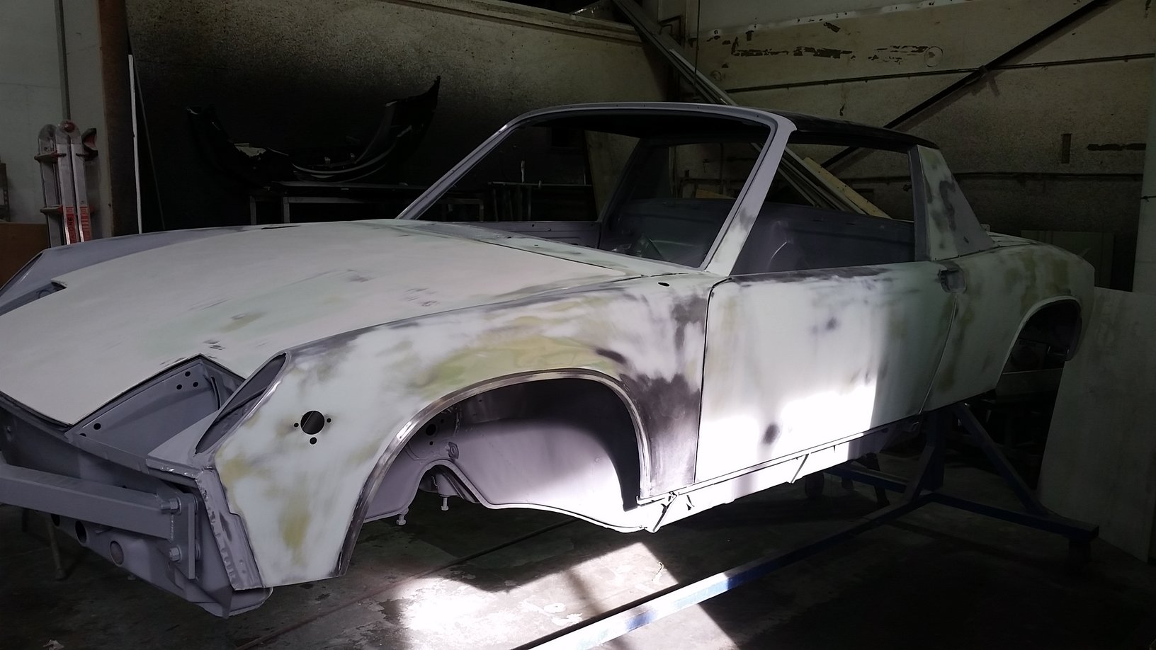

cary   Start the day with trimming the trunk panel. Not a...   Jul 15 2016, 08:33 AM
cary   Feel asleep while writing the post. Early start an...   Jul 15 2016, 09:06 AM
cary   Here's a shot of the buggered up tail light pa...   Jul 15 2016, 11:23 PM

cary   Back to the task at hand. Welded in the left insi...   Jul 28 2016, 10:46 PM
raynekat   Last hot day today. Back to cooler temps after tha...   Jul 29 2016, 09:41 AM
cary   Still hot ..................90 degrees when we lef...   Jul 29 2016, 09:13 PM

cary   Then went after trimming down the trunk panel some...   Jul 29 2016, 09:46 PM
cary   After extending trunk panel I'll start on the ...   Jul 29 2016, 09:53 PM
cary   Began with cutting the right corner of the trunk p...   Jul 30 2016, 11:14 PM
cary   The left corner needs a larger extension. But with...   Jul 30 2016, 11:22 PM
cary   While I was expanding the trunk floor Super In Law...   Aug 1 2016, 08:09 AM

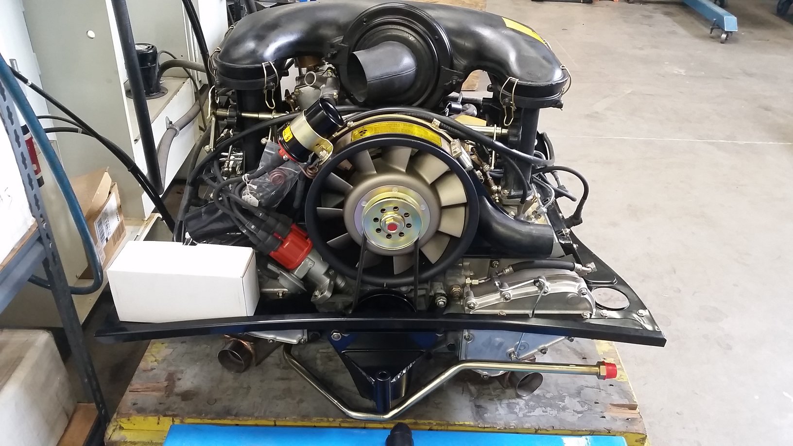

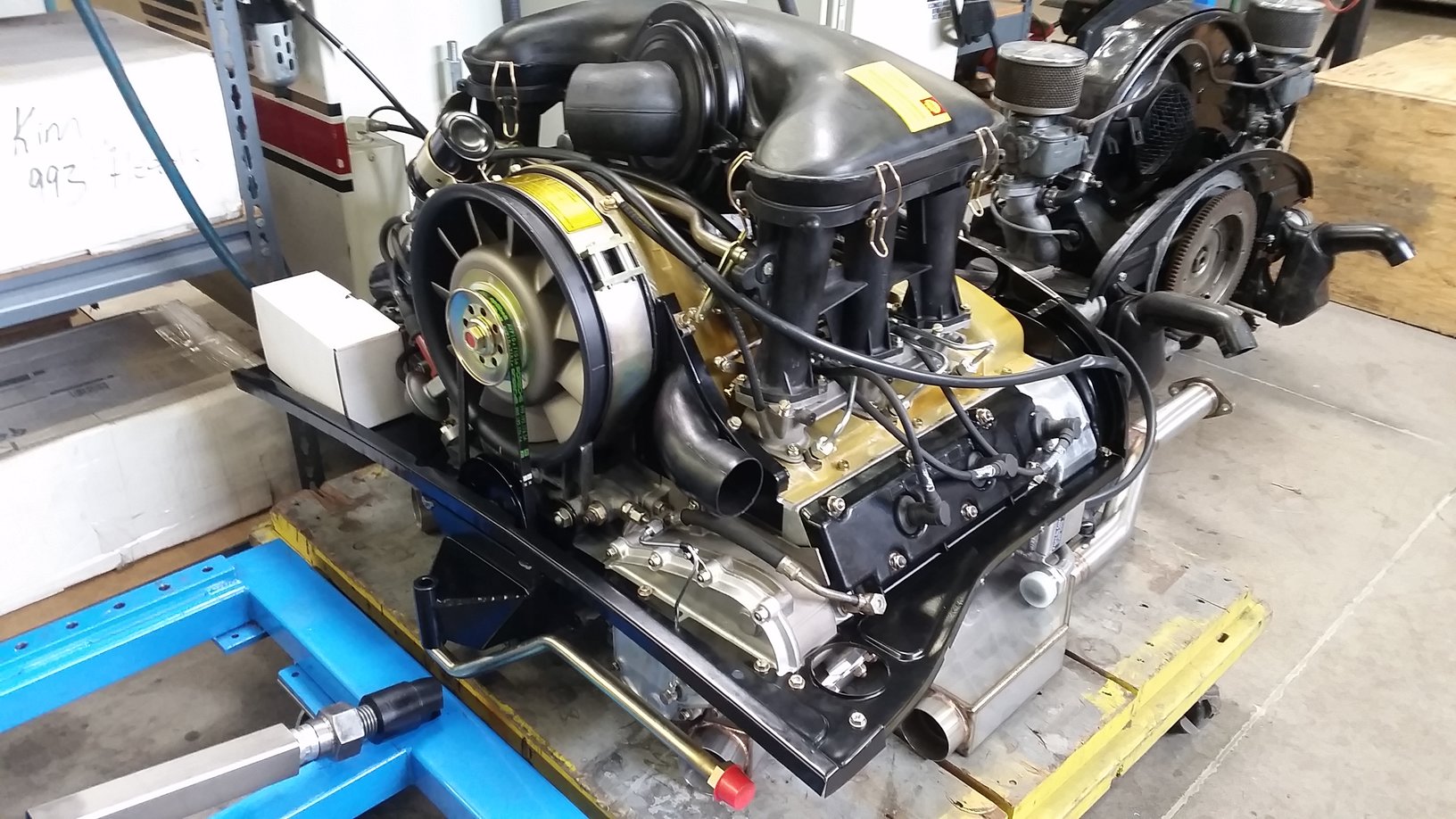

raynekat   Some of the 911 conversion parts arrived today. Bi...   Sep 22 2016, 08:17 PM

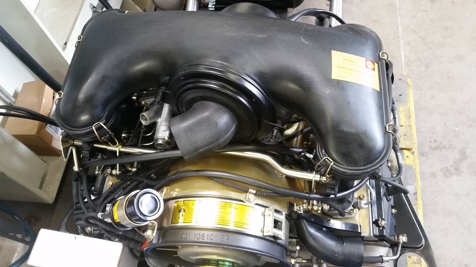

raynekat   Because I'm putting a 2.4 MFI engine into the ...   Oct 23 2016, 08:03 PM
raynekat   Next up an MFI specific fuel feed/supply pump. Wit...   Oct 23 2016, 08:05 PM
raynekat   From Stoddards, a new high efficiency 914-6 oil co...   Oct 23 2016, 08:09 PM
