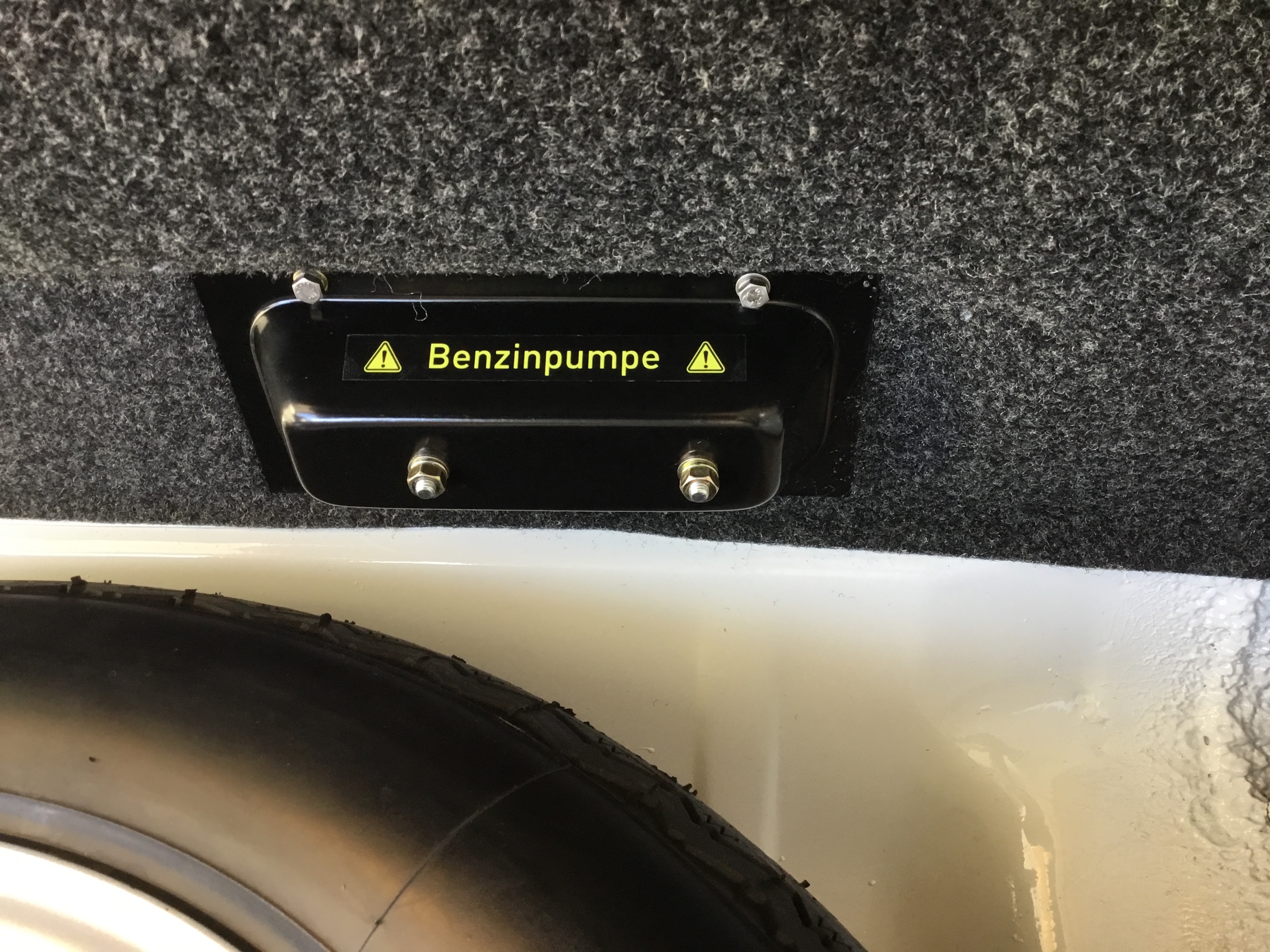

So here's some of my "satanic details" on this 914 special I'm building.
First is the fuel pump that was relocated to the front trunk and resides under a factory cover plate.
I wanted to put a fun decal on there, so this came to mind.
Love it or hate it...it's there for eternity I'm sure.

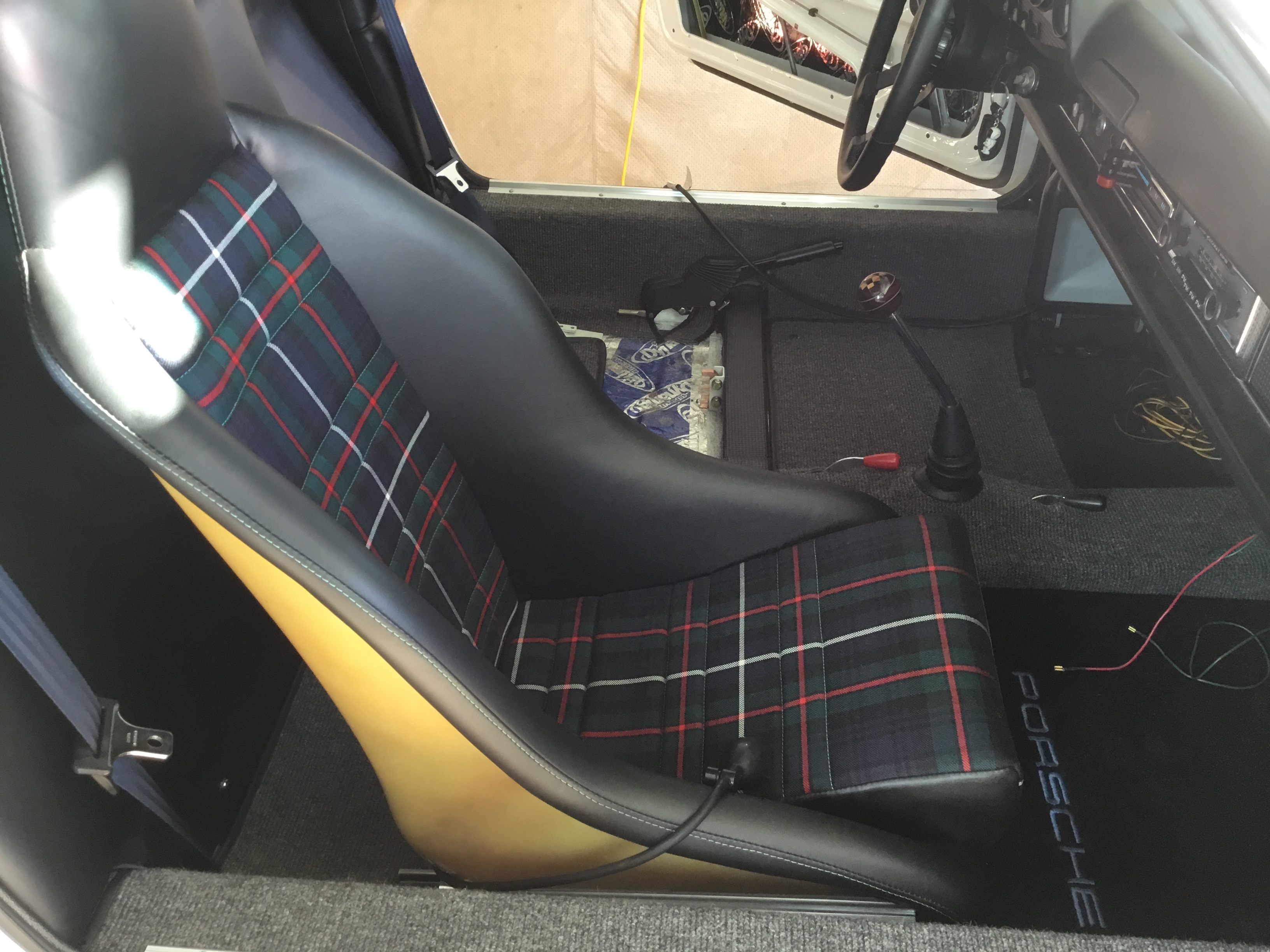

Starting to mock up the installation of the seats that are going in this car....more satanic details.
These are the Watkins Glen model from GTS Classics.
I picked them because they were more like a sports seat but still fit into the recess of the backpad.
German black vinyl along with my custom selection of tartan plaid...Robertson Hunting Modern tartan.
Stefan did a great job putting these seats together.
I opted for the raw fiberglass backside as well.
Most folks get these painted black I think.
I wanted the raw fiberglass to tie in with the undersides of the front and rear bonnets and the engine cooling shroud.
Need to finish up a bit of under dash wiring before the seats go in for good.
I'm a big guy at 6'2" and 200+, so I need a lot of ground space to spread out and get my head up under the dash. (IMG:style_emoticons/default/tongue.gif)
The bulb is for the lumbar support adjustments.

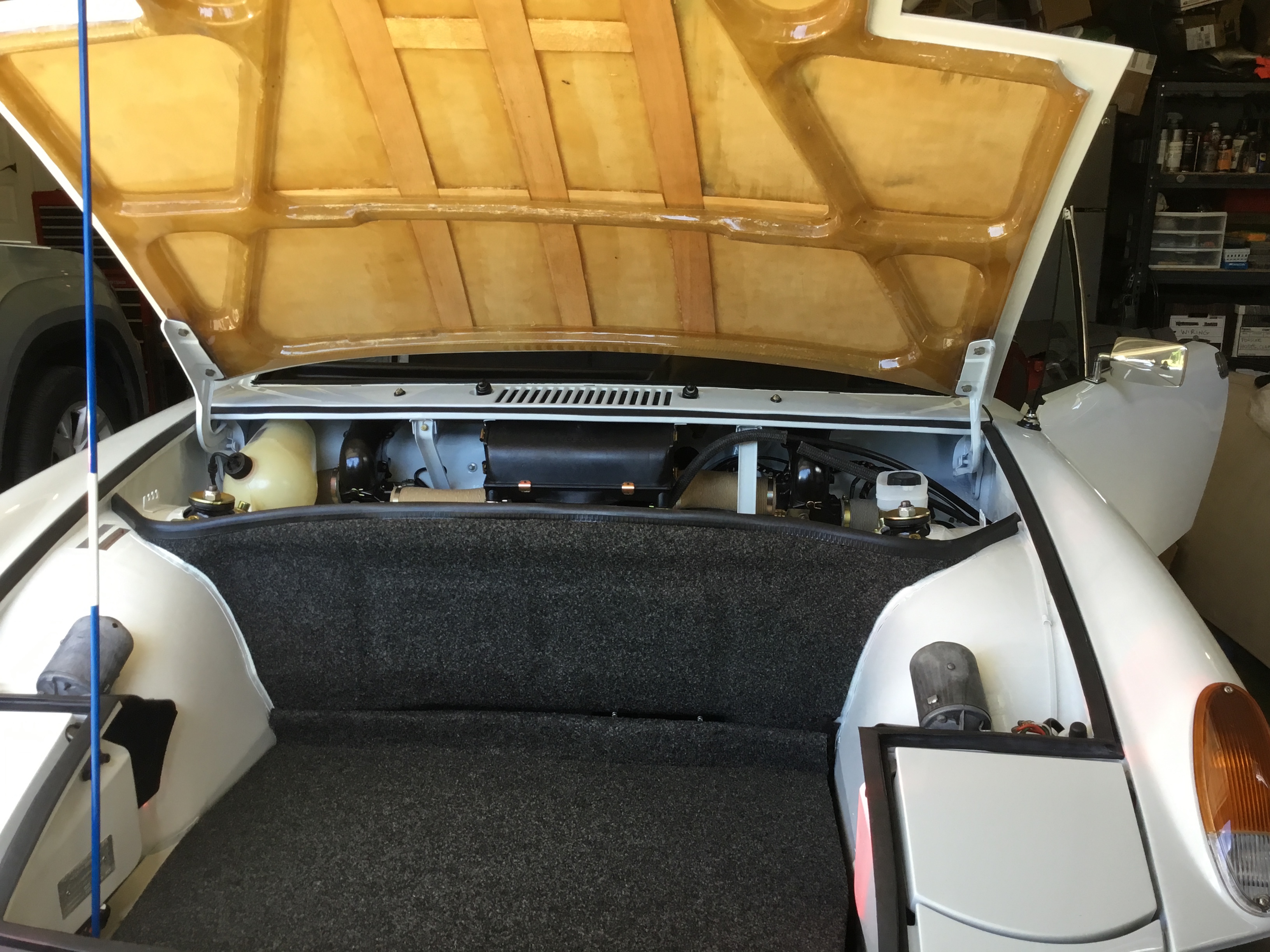

A pic of the engine and trunk lid underside to show how well the seat backs will tie in with everything.

man those seats are sweet!!! (IMG:style_emoticons/default/beer.gif) i have nice seats , stock though with no lateral support. i like the GTS and would go thet way if i get different ones. if i could find a plaid thst had some copper metallic stitching that would be really cool- any issue wirh putting the vinyl pieces down that go before you put in the carpet? i will be doing that tomorrow.
Phil
raynekat
post Aug 31 2018, 10:24 PM
Post #652
Posts: 2,172
Joined: 30-December 14
From: Coeur d'Alene, Idaho
Member No.: 18,263
QUOTE(DRPHIL914 @ Aug 31 2018, 09:22 PM) *
Phil
No issue with that.

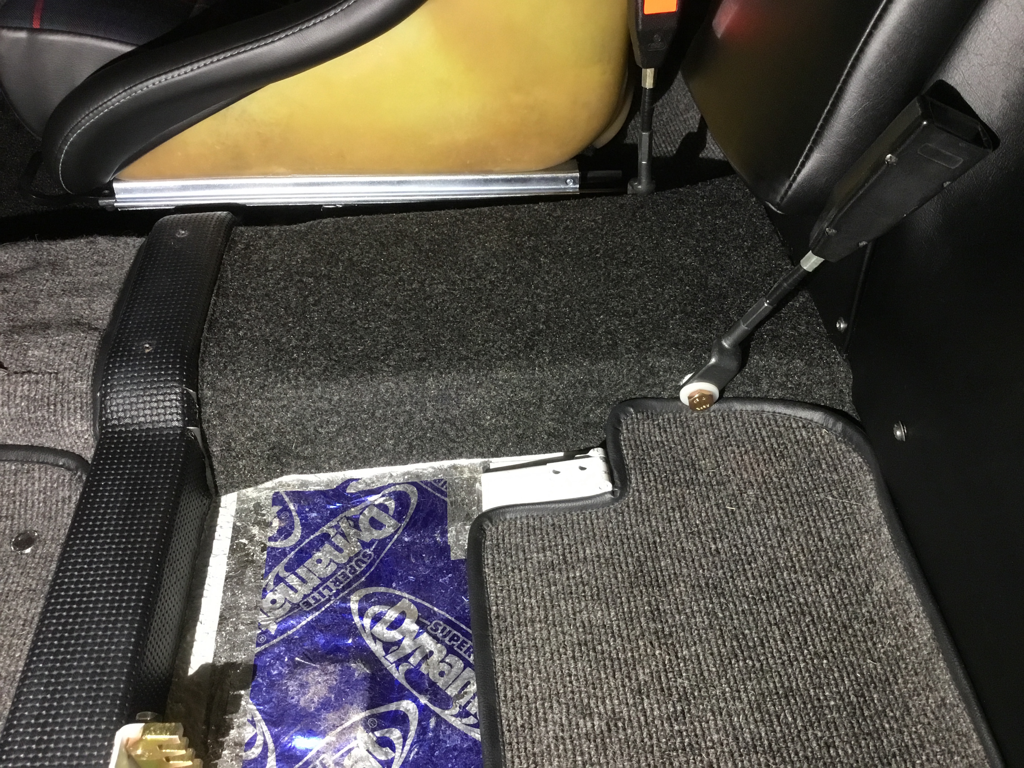

Pic of the floorspace I think you're talking about.
I used the same vinyl that is on my dash and door cards to cover the humps just in front of the seats.
I also used come dark charcoal perlon to fill in other areas that might catch your eye.
I don't like seeing the white paint on the floor or the sound deadening material when possible.
I've ordered a set of full size rear carpets for under the seats from Autobahn Interiors.
They did the rest of the German square weave wool carpets that are in the car.
For some reason you only get half carpets for under the seats....what's up with that?
Easily corrected.
I do have an arm rest/box that goes between the seats, but still the perlon covers many sins.

QUOTE(raynekat @ Aug 31 2018, 10:09 PM) *
(IMG:style_emoticons/default/av-943.gif) When I first saw this pic, I thought, "Ah crap! Another decal I have to track down." Then it sunk in this was your satanic detail and was relieved. (IMG:style_emoticons/default/biggrin.gif)
Hehe....gotcha man.
