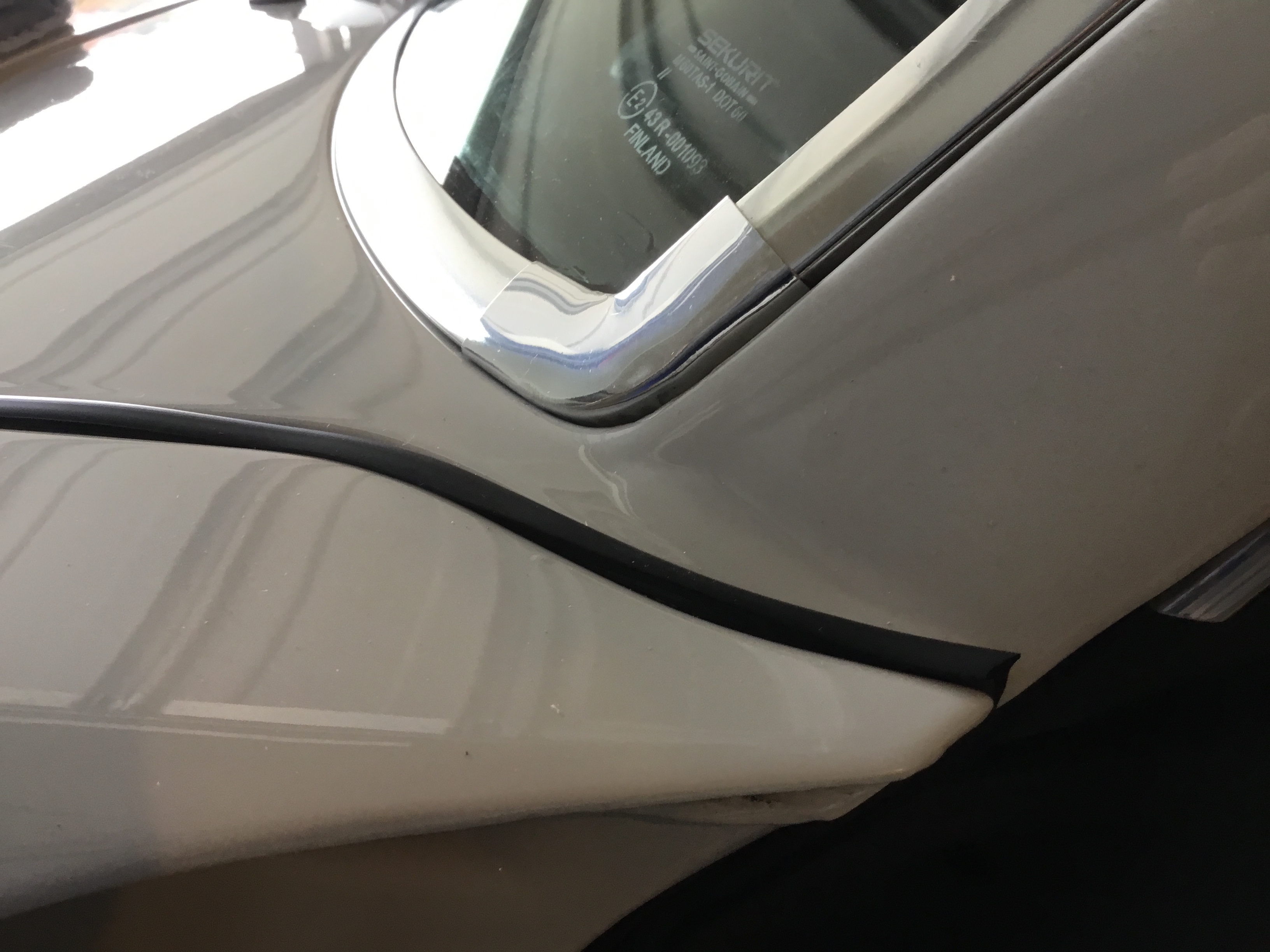

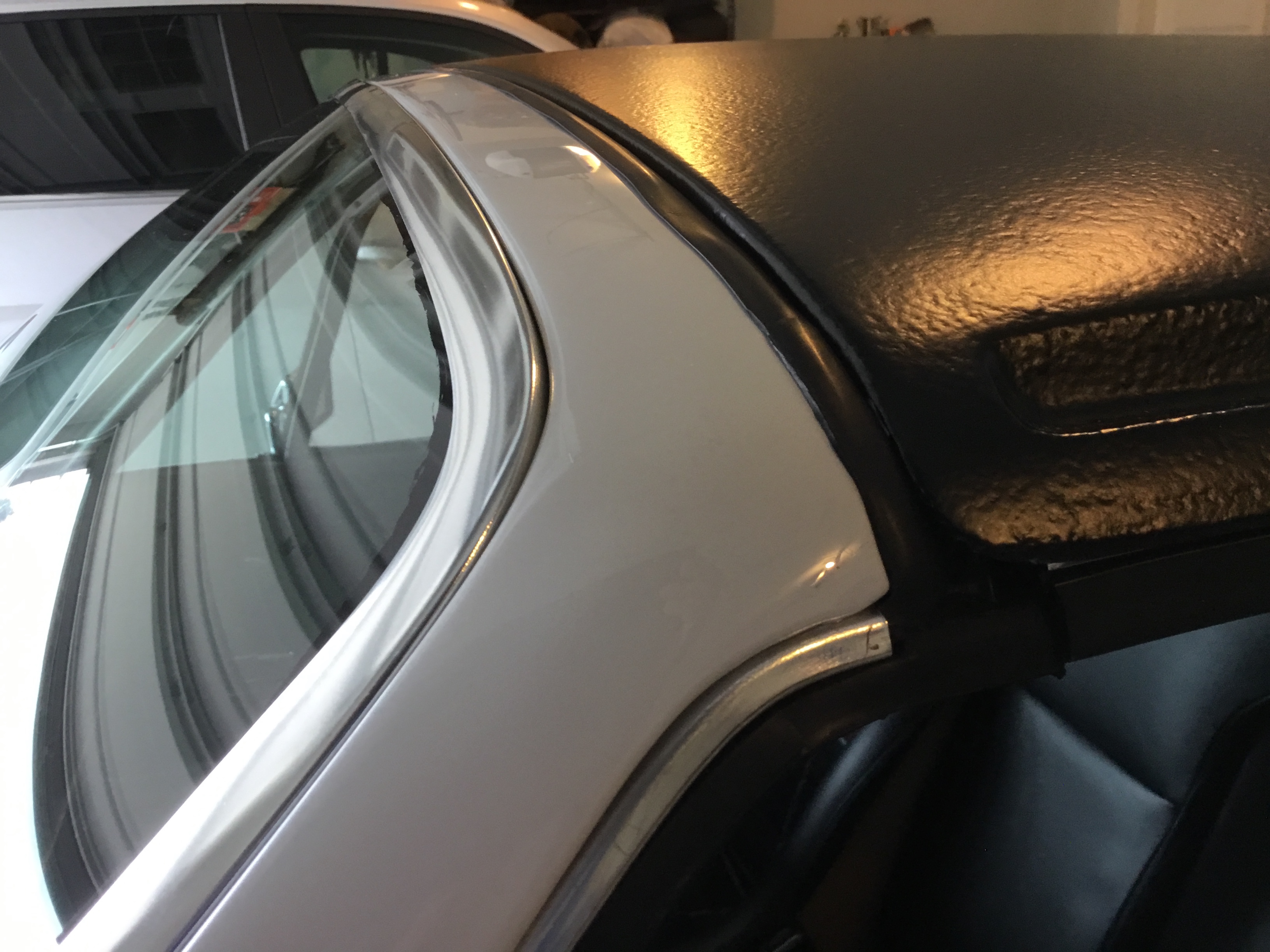

Here are a couple pics of the corners and how they finally fit.

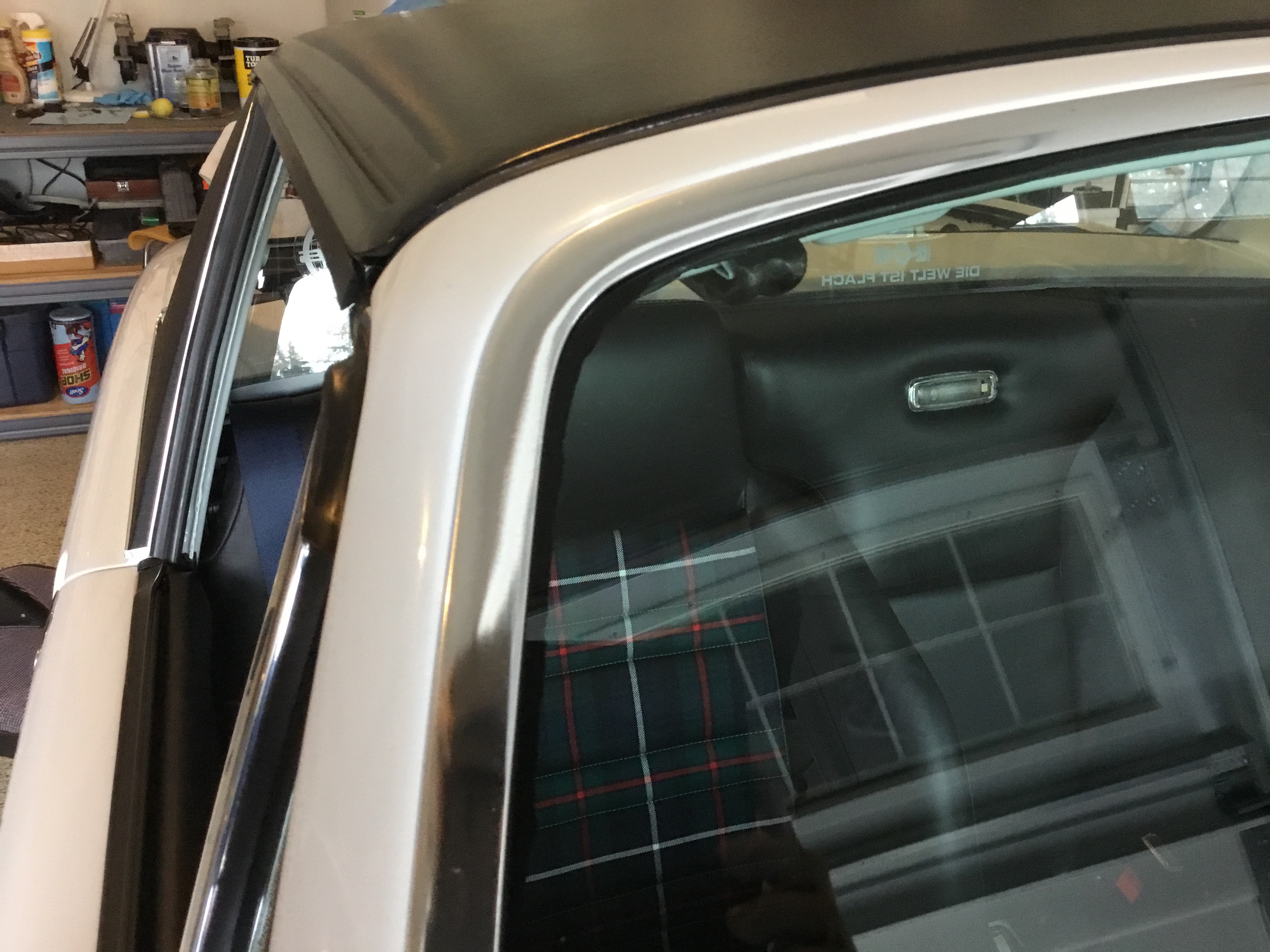

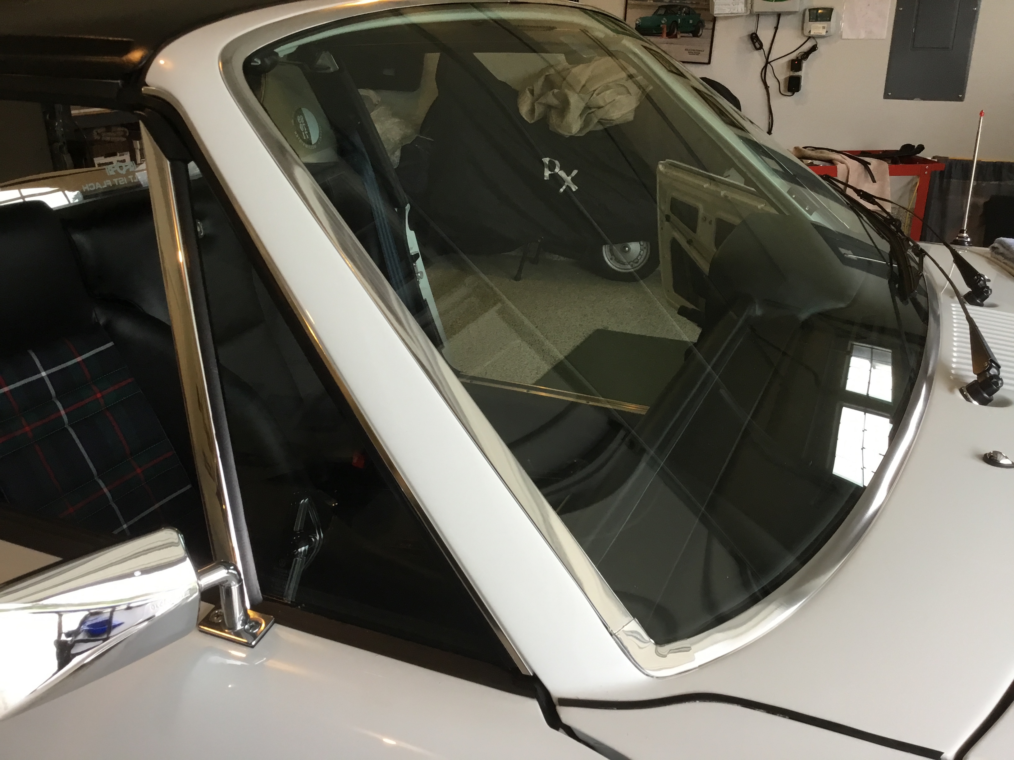

Couple more pics of the fitment of the trim.

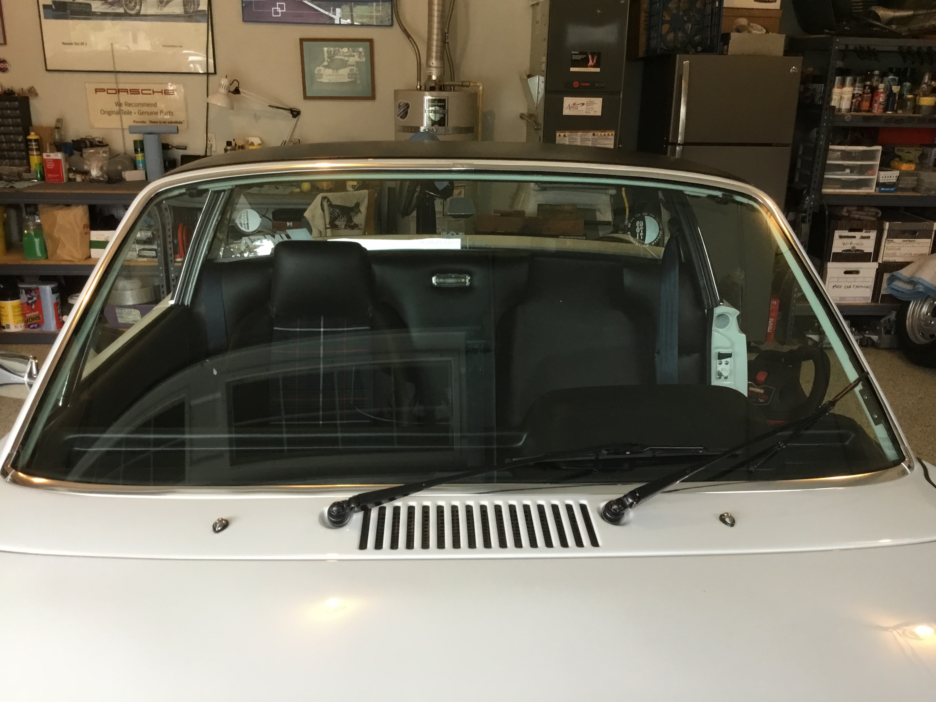

Big picture....
Finally pretty satisfied with how the windshield fits now.
The Sekurit glass from Finland (and ProSource) is super nice and very high quality.
Fits like a glove.
Definitely going with the smaller butyl cord (5/6") was the ticket as well as using the factory trim clips.
Still a tough demanding project, but very doable by the DIY type.
I had my wife help me place the windshield, but everything else is a one man job.

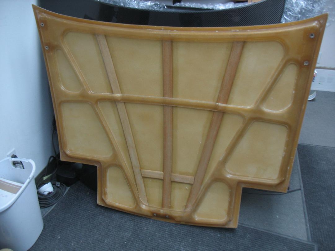

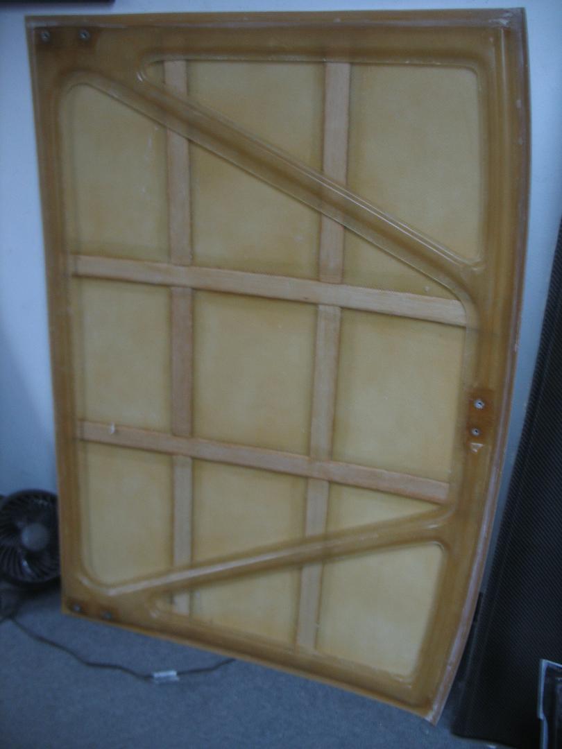

These are trucking their way to me as we speak.
A pair of GT hoods from Getty Design.
They look great and are much thicker so supposedly hold their shape better and will accept body working.
Still only weigh something like 14 lbs each so are still much lighter than stock steel units.
The original "Armando" GT hoods just didn't work out.
They were much too flimsy and fit like heck.
These will be up for sale soon for someone with a race car that wants the absolute lightest hoods possible.
They would have been acceptable on a race car but not on a predominantly street car.

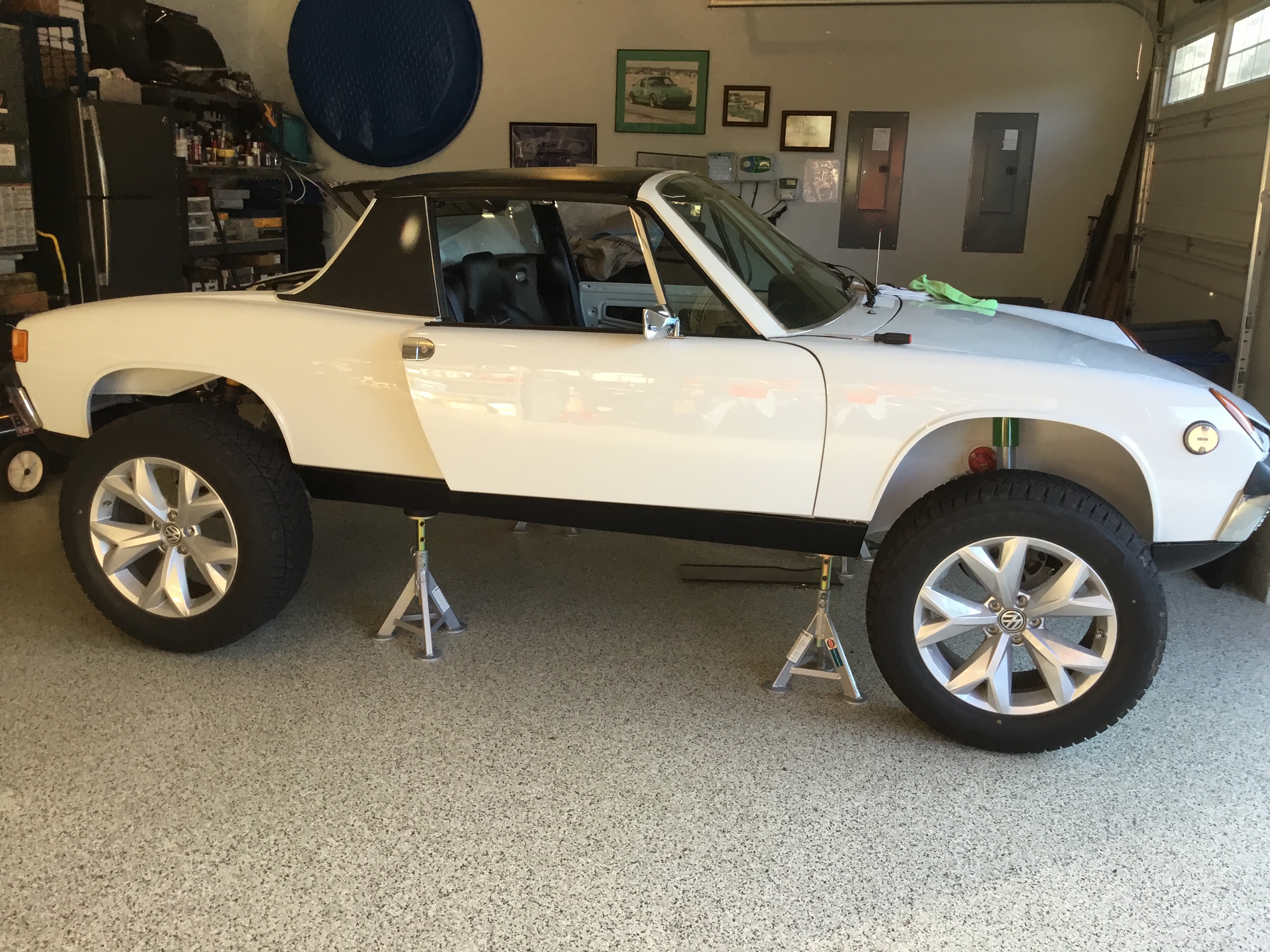

Getting the 914 set up for winter travel....
They "might" fit with a little more work in the fender wells.
Is it April yet?
When I see something like this, I get an itching to do an offroad 914 and take it rally crossing.
Obviously I was up to no good today with time on my hands.
(IMG:style_emoticons/default/blink.gif) (IMG:style_emoticons/default/huh.gif)

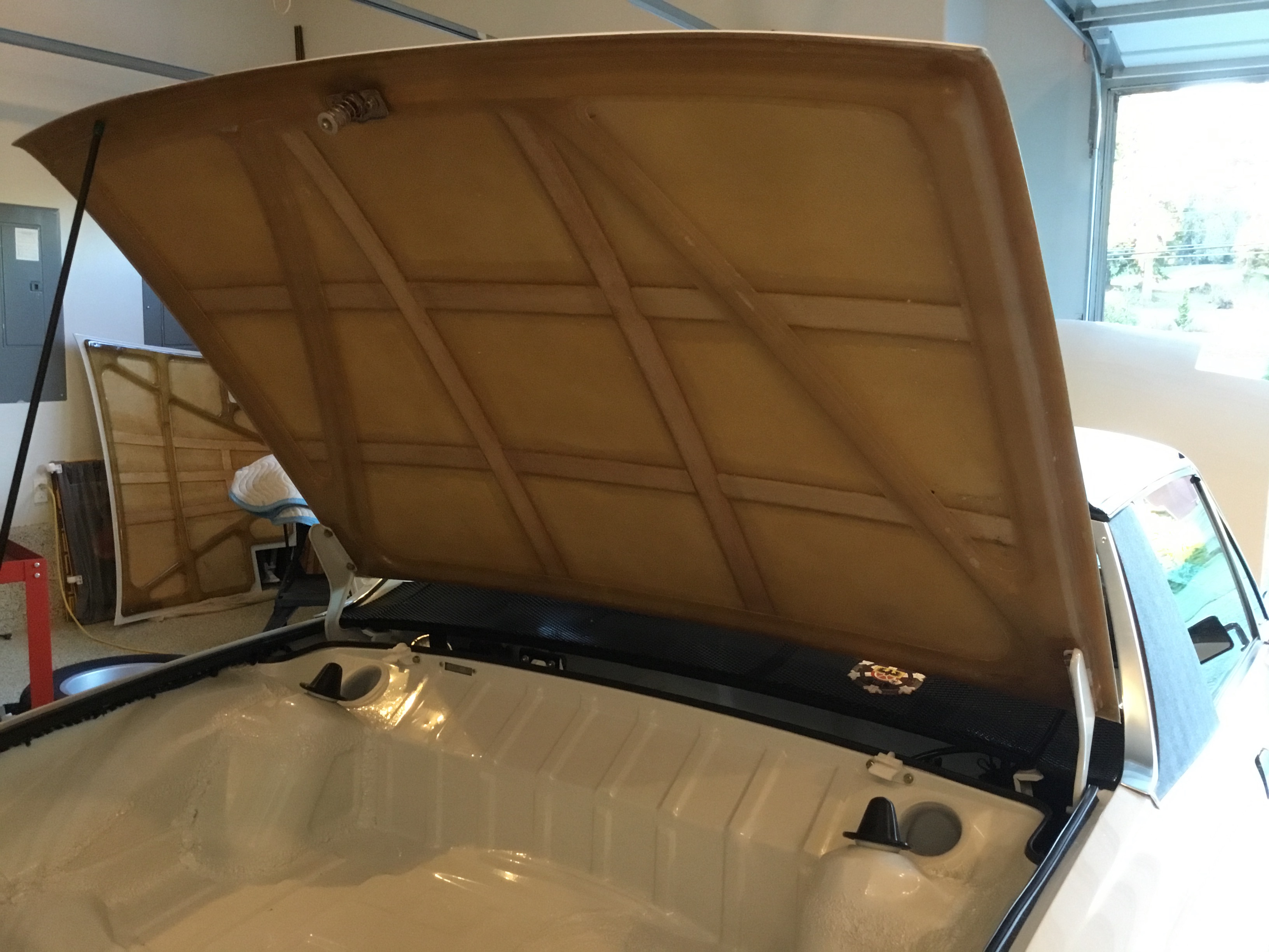

Getty GT hoods are in hand and on the car.
What a difference in fit compared to the other hoods I had.
These are much thicker made so show none of the wavy nature as the previous ones.
Still these hoods are very lightweight when compared with the steel hoods but still tough enough for a daily driver/street car (I'm assuming/hoping for).
The unfinished fit is already miles ahead.
Again these hoods will get the Carrara Weisse on the top with the underneath just getting a clear coat.
You can see the old front hood in the background.
Those will be for sale for someone with a race car in the very near future.

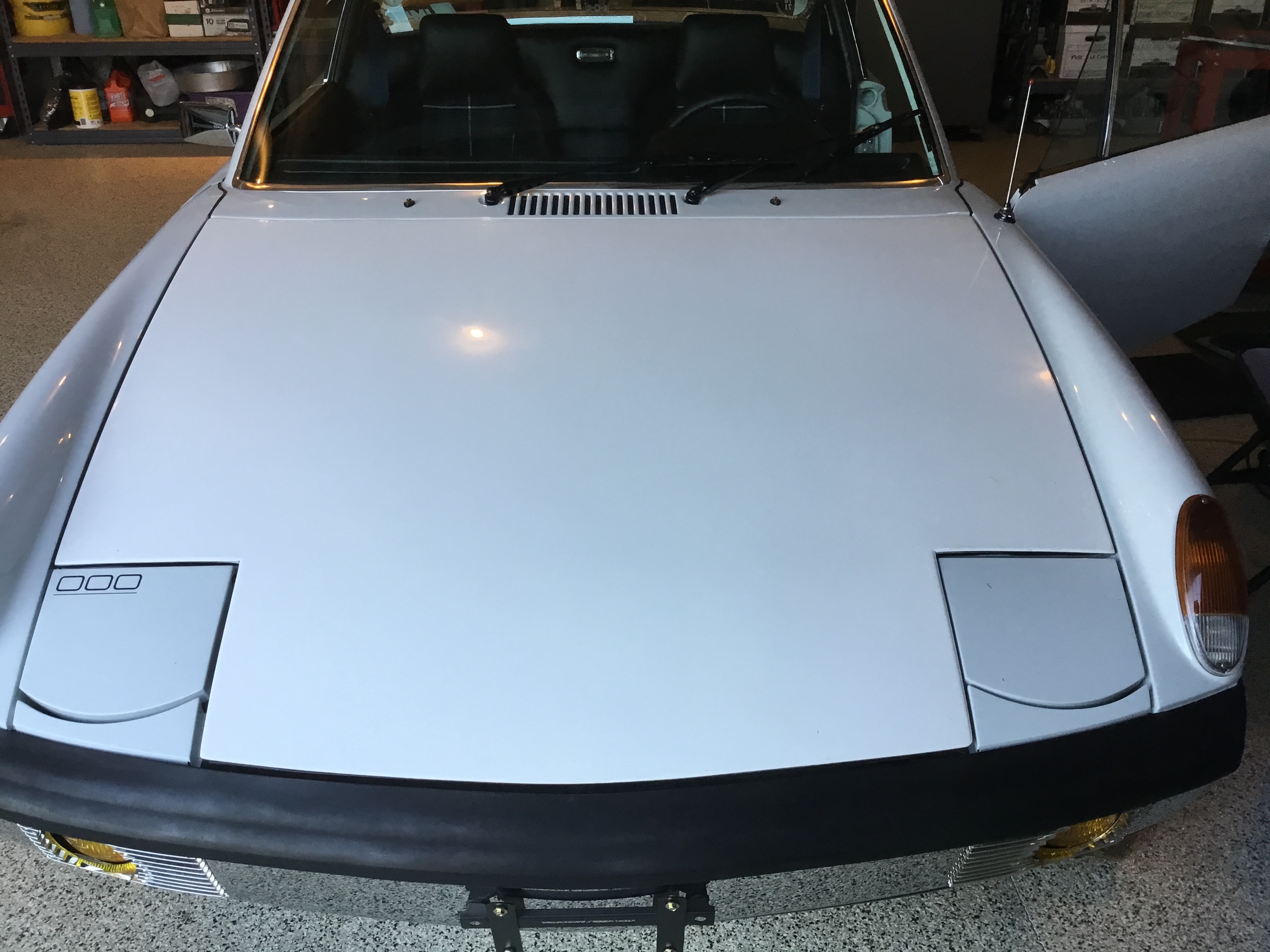

Here's the front Getty hood and it's "out of the box" fit and alignment.
Again, already miles ahead of the other hood.
I can easily recommend Getty for a set of these GT hoods.
High quality and it was fairly quick build/delivery....something like 3 weeks time.
Still an expensive proposition at $900 per end plus shipping, but this is the look I wanted for this car.

To date, I have been unable to align the side window/door such that it all fits into the door/window seals correctly.
Possibly the geometry of the door opening was slightly altered with all the work we did on the car previously.
Hopefully not.
This shop is good, so they'll have some solution I believe.
They also have the 73 911 in for some touch up work, so the garage is completely empty of sports cars for the first time in modern history i think. (IMG:style_emoticons/default/tongue.gif)
Celebrated by washing the floor later in the day. Ha
Bye bye for now.
When the car returns, hopefully I'll have in hand from PMB the newly refinished/rebuilt 914-6 GT-ish rear calipers to install.
At that point, I am completely finished with my part of the re-assembly.
The car will then be scheduled for an appointment with Rothsport Racing for installation of the drivetrain, ride height/alignment, aux cooler install to finish up the build.
