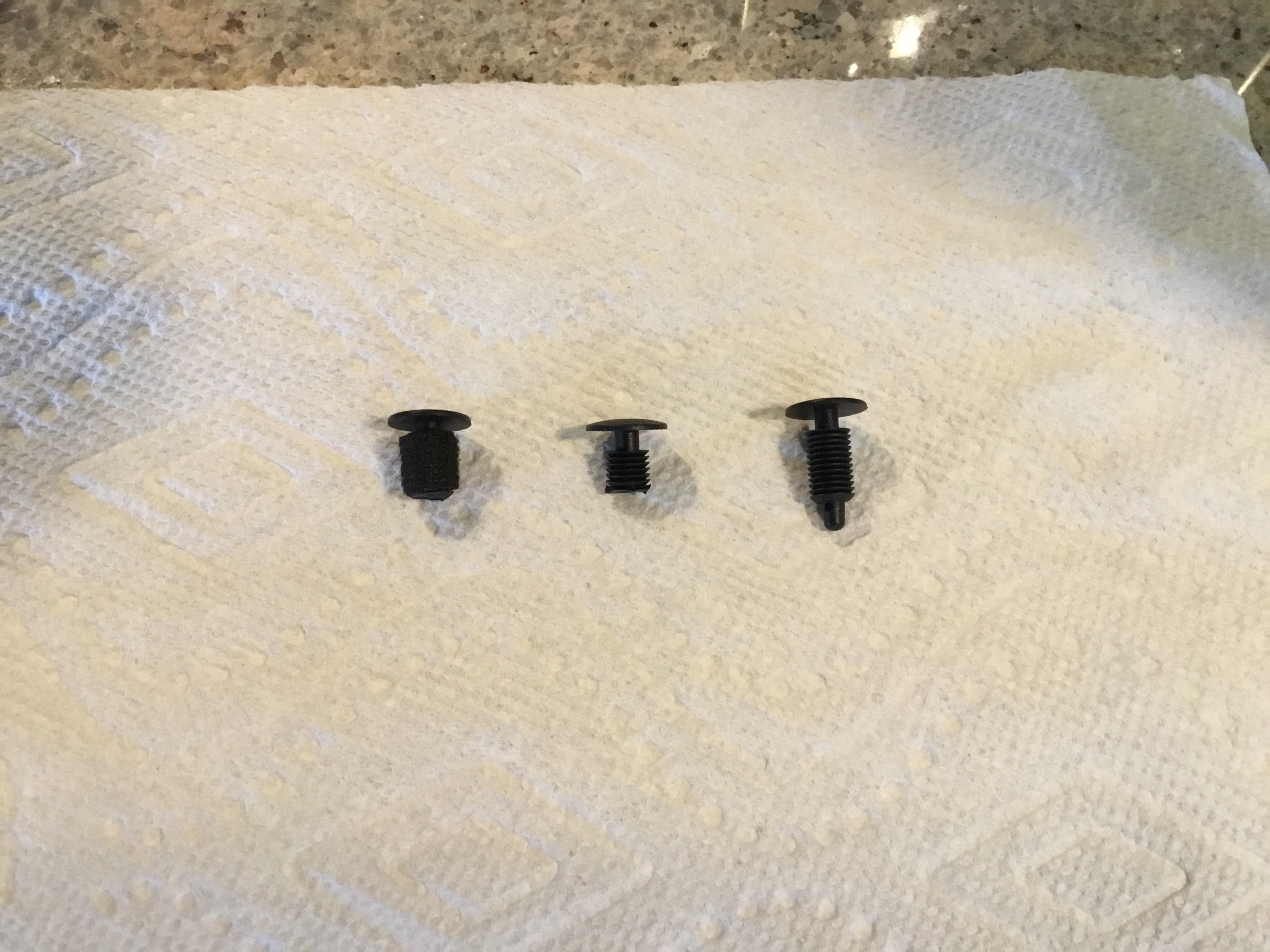

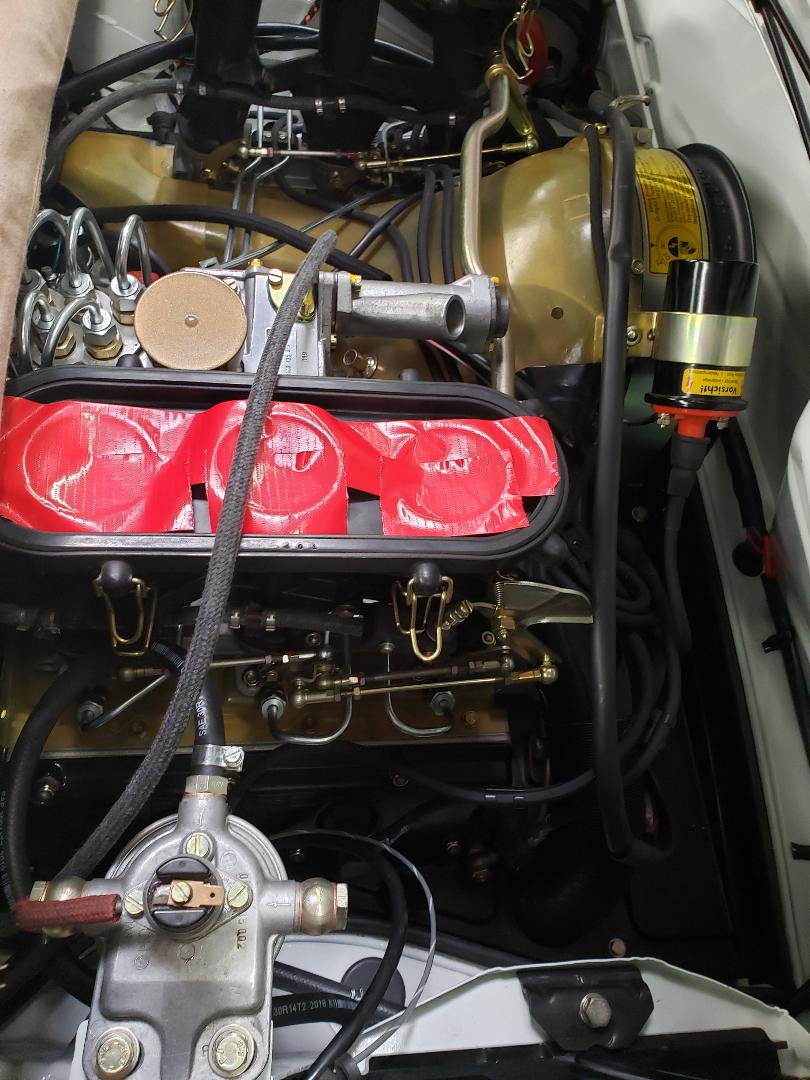

From right to left...
Full length plug.
Cut down plug.
Cut down plug with base wrapped with cloth wiring harness tape.
Like I said you can find these at your FLAPS, but they're expensive.
You get 3 for nearly $5.
I got mine on Ebay here (50 for $7.99):
https://www.ebay.com/itm/50-Black-Nylon-Tri...8edfa%7Ciid%3A1

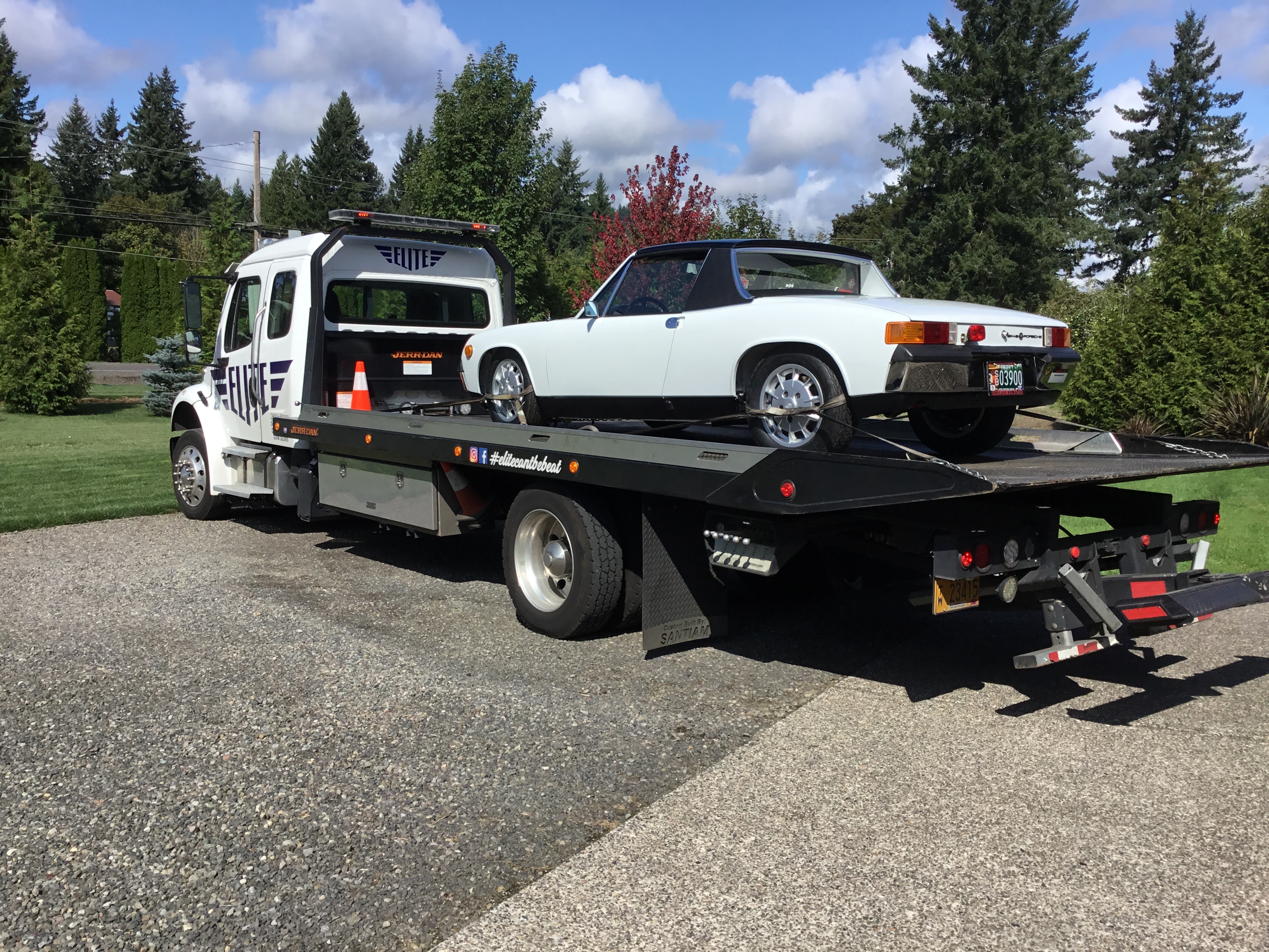

So off we went today....to Rothsport Racing's shop.
Dropped the six conversion hotrod off and they will begin work next week I believe.
Need to install the drivetrain (2.7 MFI motor - 230hp, modified 901), adjust ride height and alignment, add an aux oil cooler, and whatever odds & ends.
Hoping to have the car back in time for a bit of autumn driving before monsoon season arrives here in the Pacific NW.

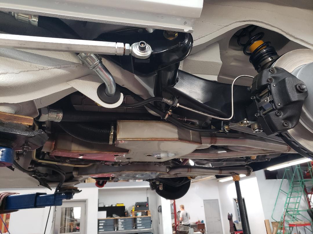

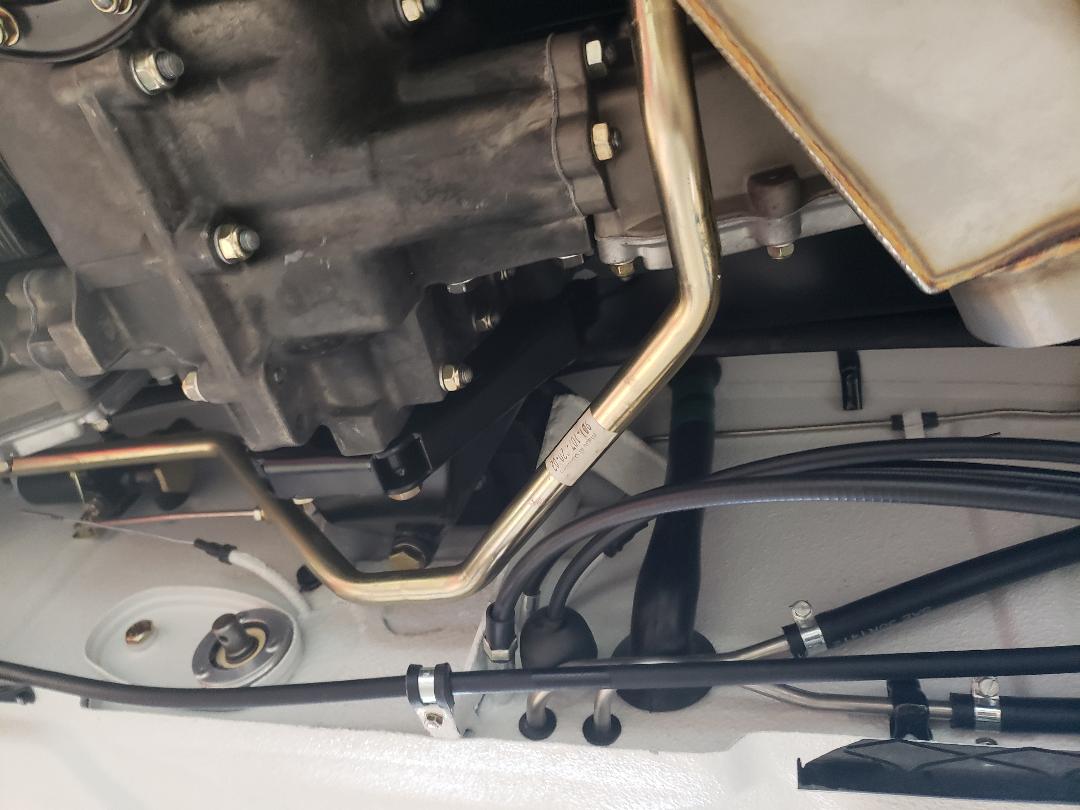

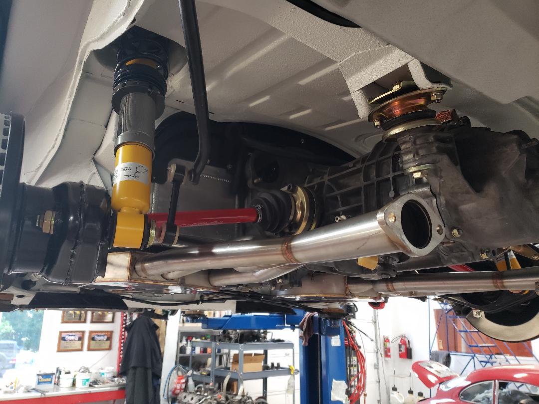

Things are happening already.
Stopped by Rothsport Racing today and saw that the drivetrain (engine and gearbox) were bolted into the car.
Excuse the crappy cell phone pics.
Looks like it belongs there.
Little bit of tweeting to do on Ben's heat exchangers, but nothing major.
Had to reroute the driver side parking brake cable.
Also modify the 914-6 front engine mount cap plate, but again nothing too crazy.
Re-welding the outlet on the sport exhaust to exits in just the right place.
The engine fits into the car very nicely. You'd think this car had been designed for a six cylinder. (IMG:style_emoticons/default/rolleyes.gif)
Lots of work still to do.
All the cables, fuel lines, etc.
Need to hook up the side shifter transmission parts.
Install oil cooler with fan on the underside and plumb it up.
I'll likely check in next Monday for the next update.

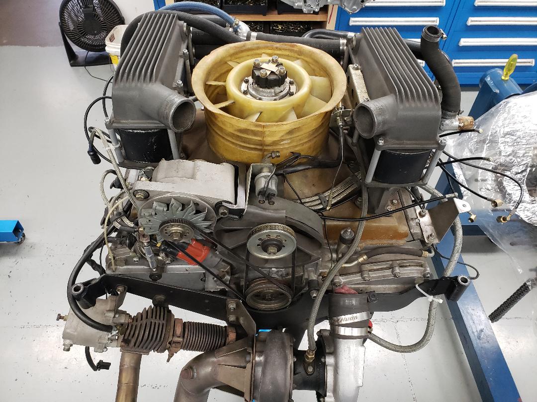

Everyone in the shop seems to enjoy the 914 being there for the most part. Their bread and butter are the 911's but there was another 914 race car there besides mine.
Too bad this baby wouldn't work in my car..... (IMG:style_emoticons/default/drunk.gif) (IMG:style_emoticons/default/blink.gif)

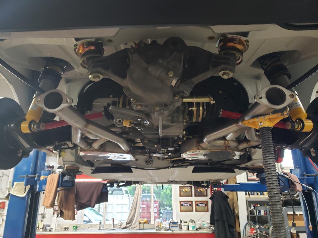

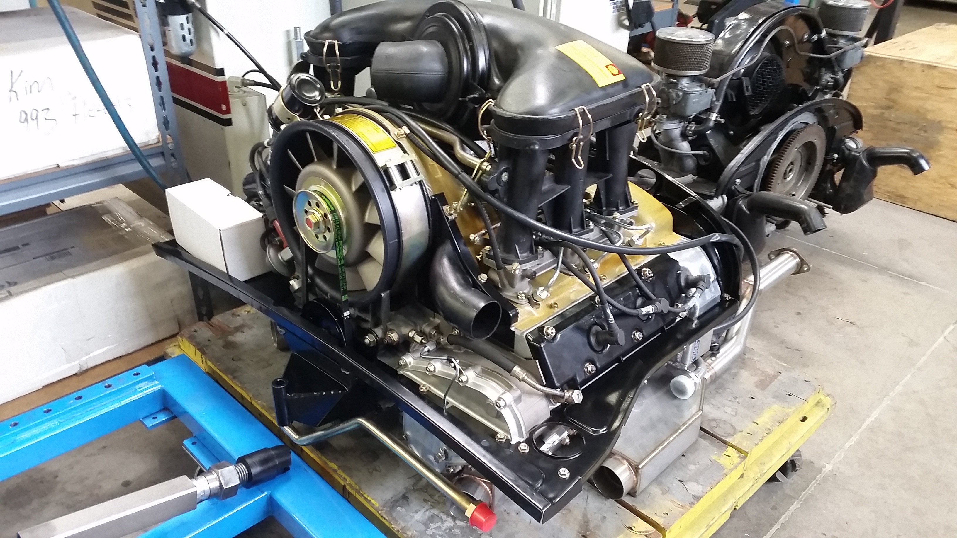

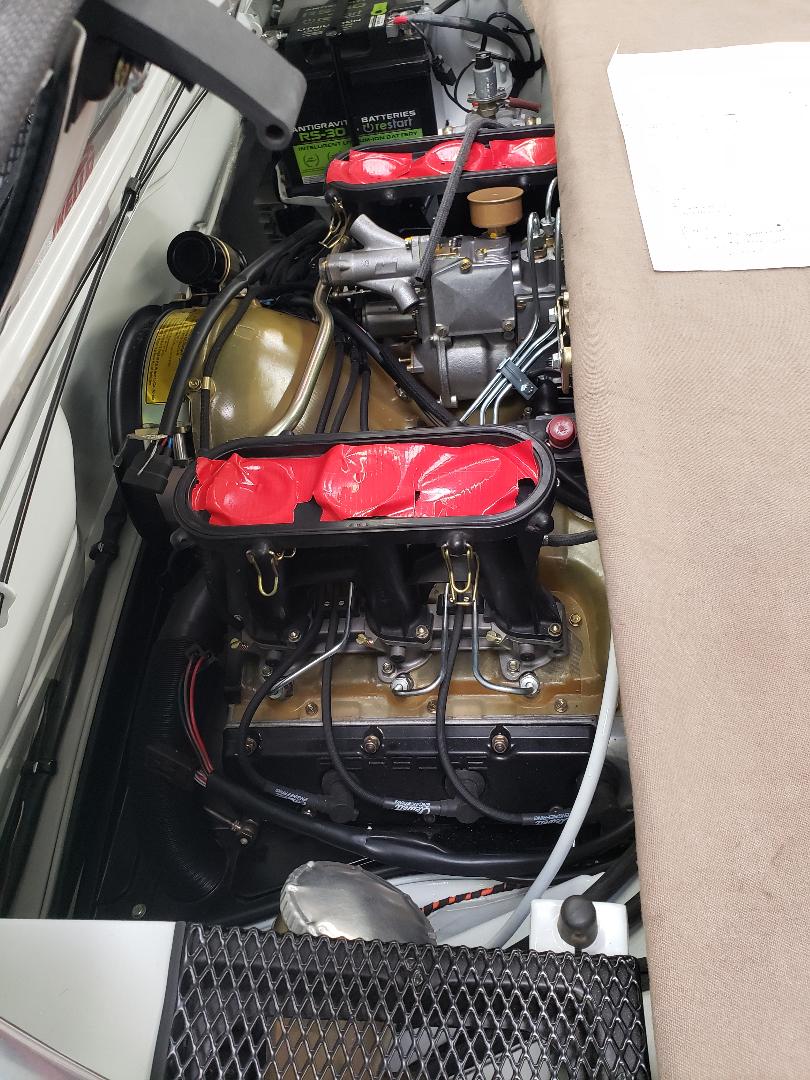

The engine is in it's final resting place.
All 2.7 liters of MFI wonderment.
Obviously the trick gearbox is in as well.
HE's hooked up along with the Dansk single outlet sport exhaust.
Most of the plumbing is done, as are the electrical hookups.
We had one question this morning with the 3 wires going from the alternator to the voltage regulator.
We had a blue wire instead of a red wire.
Had to be educated by Perry Keihl that 914-6's all came with a red wire, while most 911's have a blue. The other 2 wires (black and brown) are the same with both vehicles.
You learn something every day.
Will be starting up the engine pretty soon.
Afterwhich, a nice aux cooler and fan setup will be inserted into the oil flow system.
Think the shop said they'll be going with a compact Fluidyne cooler and fan.
After that, we just need a bit of ride height adjustment and a good performance alignment, and the project is fini.
Then there will some fun. (IMG:style_emoticons/default/drunk.gif) (IMG:style_emoticons/default/cheer.gif) (IMG:style_emoticons/default/aktion035.gif) (IMG:style_emoticons/default/smilie_pokal.gif)
