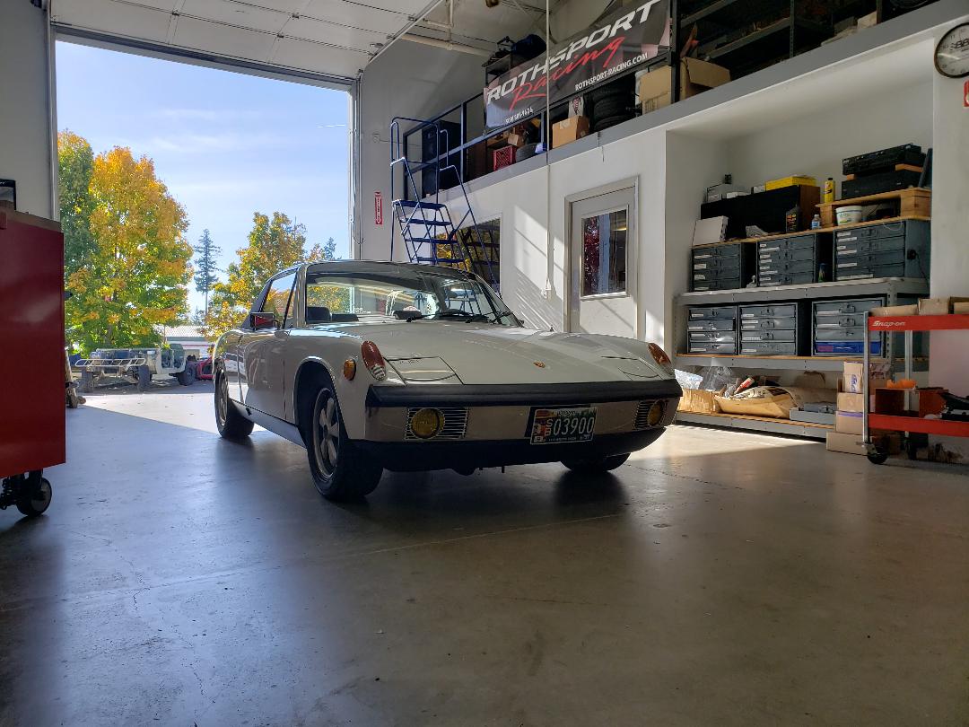

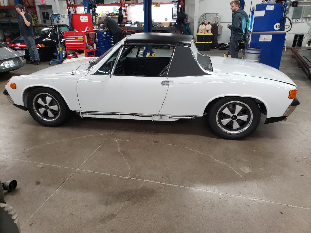

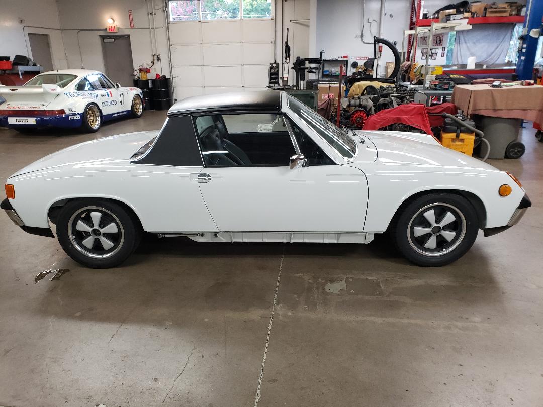

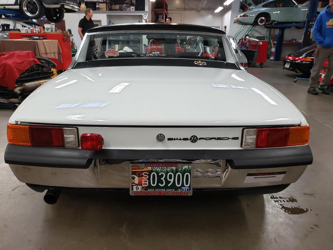

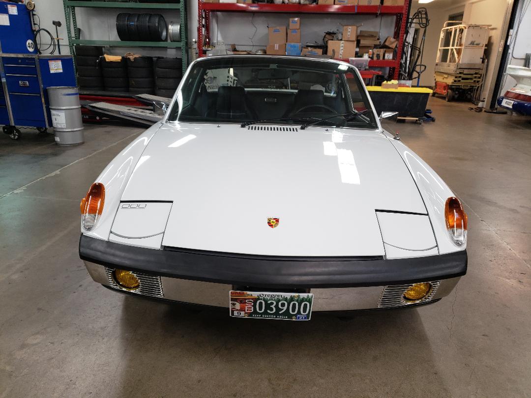

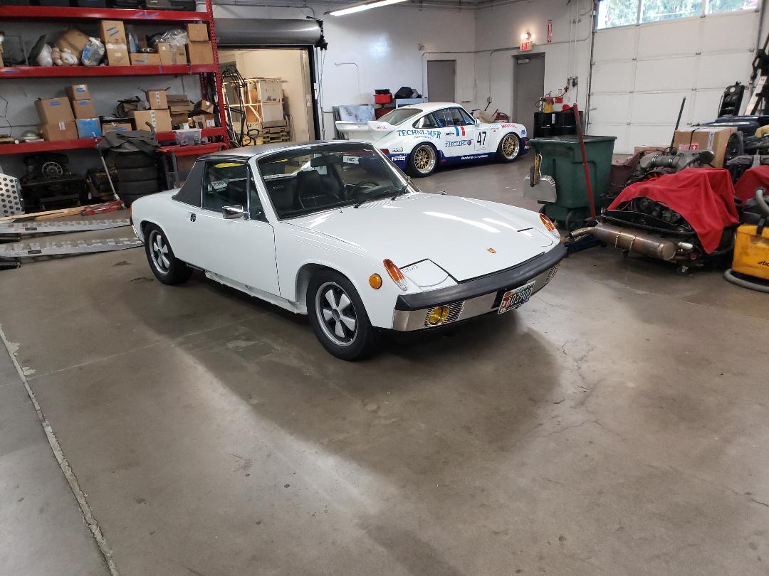

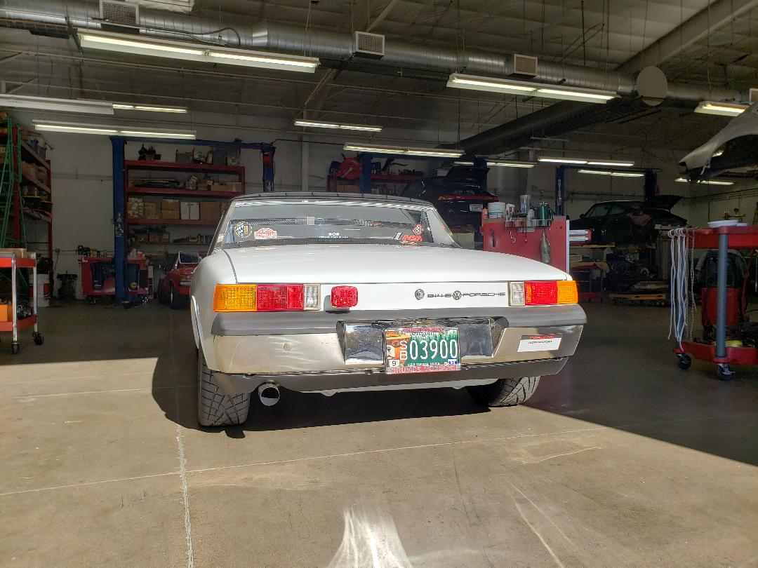

Stopped by the shop today to get a couple of pics for the insurance company. Excuse the pseudo crap pics from my cell phone (thought all modern cell phones took pretty nice pics....mine not so much? (IMG:style_emoticons/default/tongue.gif)) Think my insurance company (Safeco) uses Haggerty for these special interest cars.
Here's a couple of exterior pics.
The car just came off the alignment rack so the rocker panels are not back on yet. These had to be removed to access the rear toe control arm set from Patrick Motorsports.
I'm happy with the ride height. Definitely "Euro" or performance height.
jmz
post Sep 30 2019, 03:18 PM
Post #742
Posts: 175
Joined: 11-April 16
From: Lone Star State
Member No.: 19,886
Cute little car Doug! (IMG:style_emoticons/default/wink.gif)

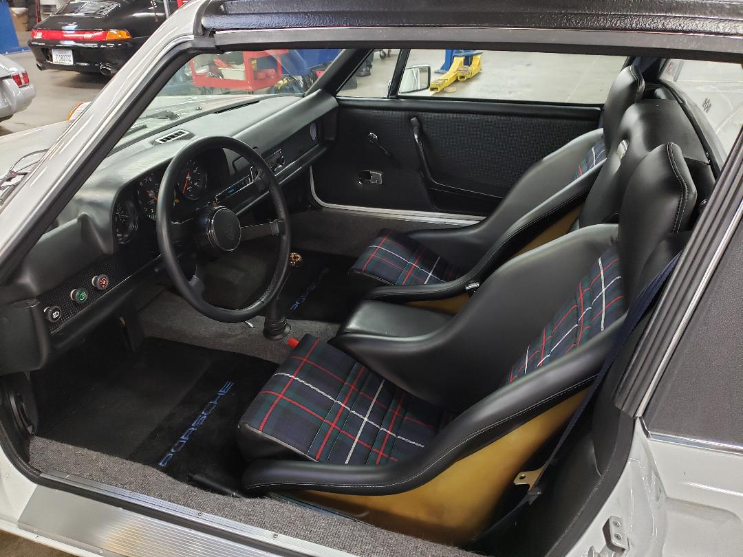

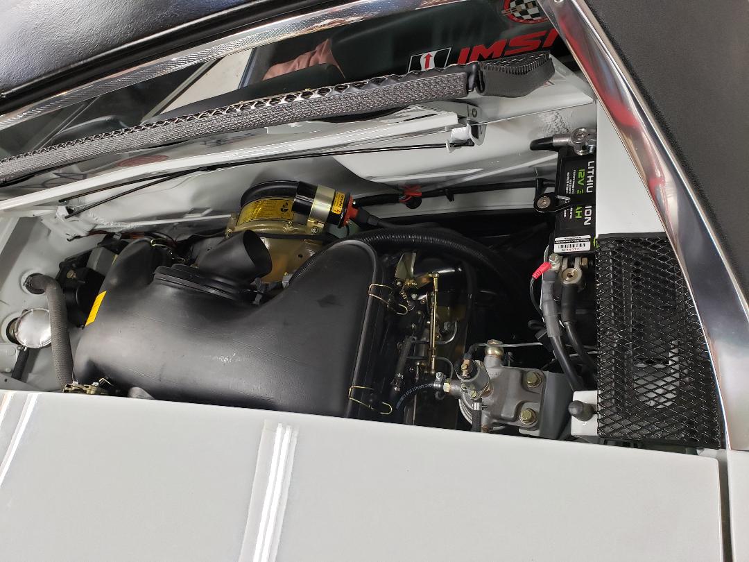

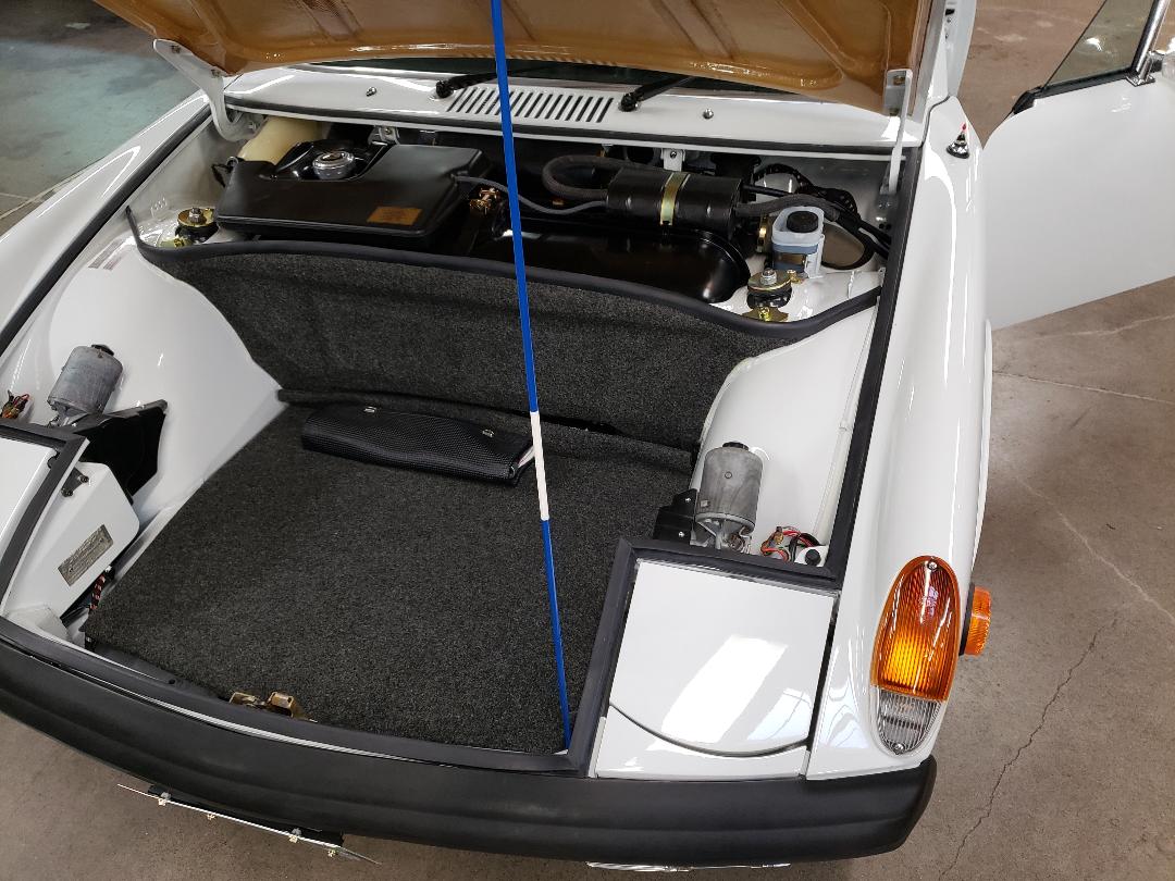

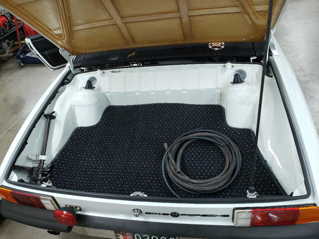

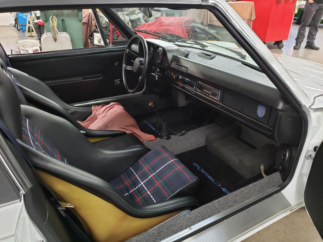

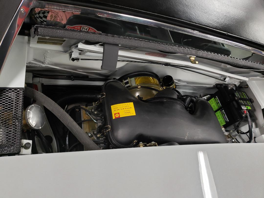

Assorted other pics....engine bay, interior, trunks.
2.7MFI and it's accessories all fit nice and tidy in the engine compartment.
Wasn't sure how much of the amber fan shroud would be visible, but it shows pretty nicely down in there.
Amber backs of the sport seats ties in well with the engine shroud and undersides of the lids.
Think I'll be losing the "Porsche" mats and going with the same Coco mats I have in the rear trunk.
Here's the Coco mat I have for the rear trunk. It's heavy but nice and fits the mood of the car.

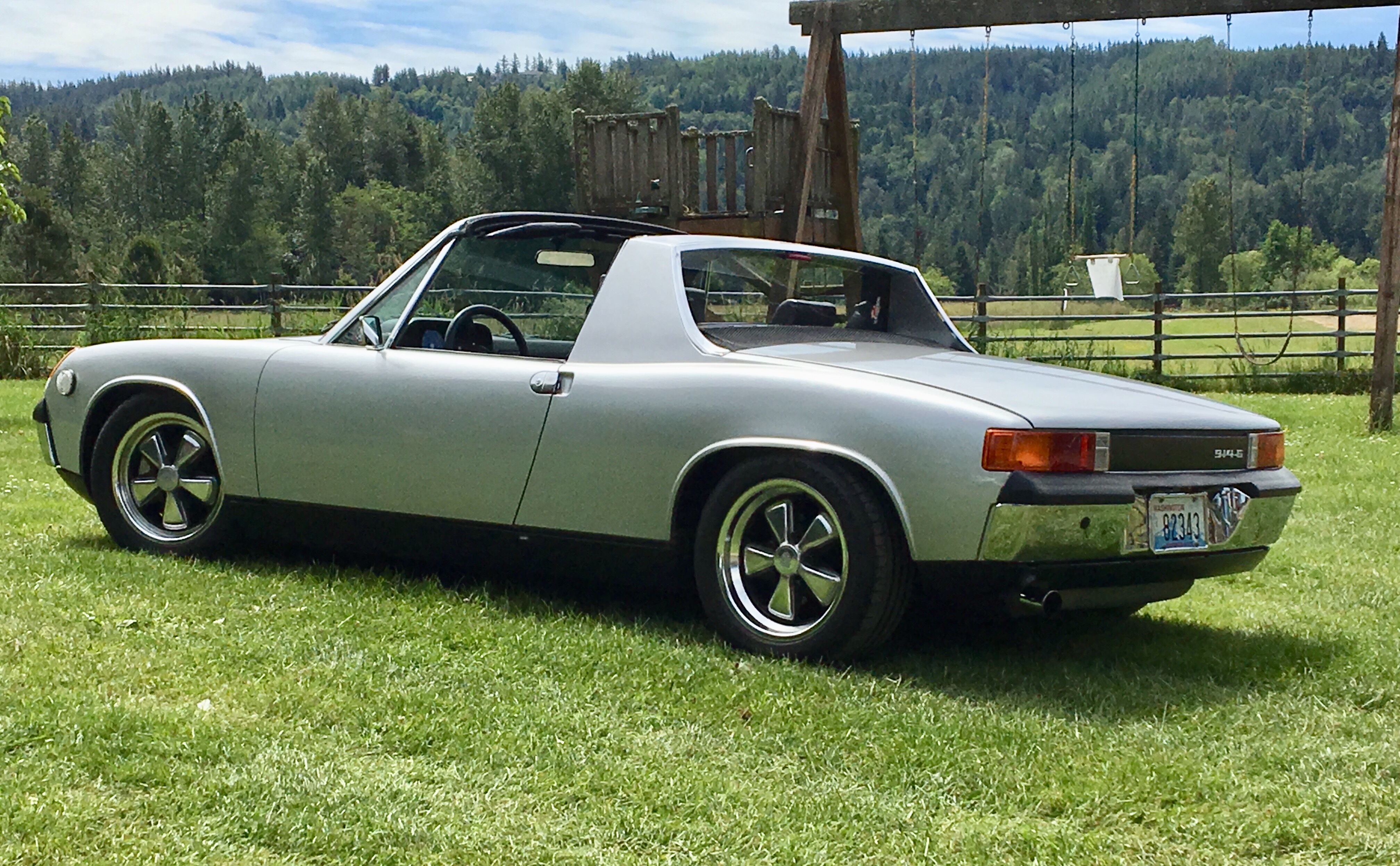

My other P car is a 73 RSR hotrod with a 3.6 Vram, steam roller wheels and tires, and something I've been driving for almost 30 years.
This was the car I purchased and modified over the years since selling the orange 914 a long time ago.

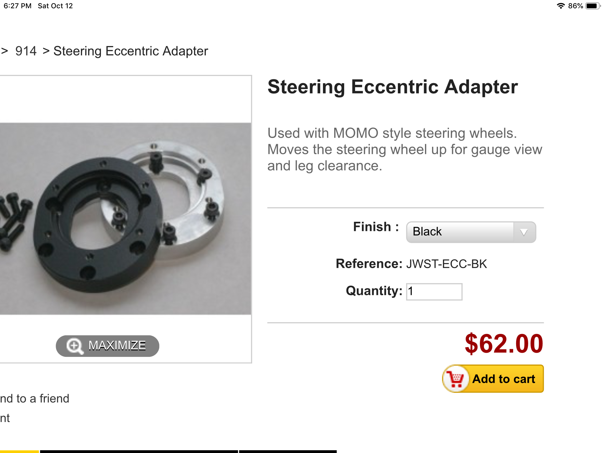

The Nardi will require either re-drilling the adapter as the bolt circles between Momo and Nardi are slightly different.
Or buying a Momo to Nardi adapter piece.

I use this with my Momo wheel. Every little bit counts.

This thread has been a fantastic read from start to finish. It’s always interesting how the finished product varies from the original vision, whether by chance or purpose. Really enjoyed your writing and pictures. It is magazine worthy. Not to get too bromancy but then there are your mad metal skills (as well as the Super) which make reading really enjoyable. Very well done.
I went down a similar path with my ‘71 1.7, but fortunately the only metal work was flaring the rear fenders a bit for the 7s and some minor repair around the jackpoints. Went with the Rennshift + Jwest + tailshift which makes a nice “gated” shift. Did the reinforcement thing and 5 lug conversion with a complete elephant polybronze setup. Like you even converted the passenger seat to slide fore/aft. Then completed it with a carbed rebuilt 3.0 with a 914-6 oiler. Had as sport muffler but got tired of it making my ears ring, so went with a stock Danske with the 6 HEs. Like yours, wanted it looking pretty stock on the outside, but relatively radical for the drivetrain and suspension. I too felt like the suspension was way too firm but got used to it and in the corners it is just unreal. It turned out to be a great ride which I enjoy much more for short haul than my hot rodrodded 911. Very similar paths indeed and very well done, from your neighbor to the north.
Enjoy your beauty!Attached Image

I've never been a fan of wood rim wheels in a 914. I don't get the "hot rod" vibe from them. I like the Nardi since it looks a lot like a 911R wheel - my favorite. It's funny, The 380 wheels fit me fine.
The stiff chassis might be sending more of the road through the wheel than a stock car. It just proves that there is no one setup that is best.
Guess I have most of my height in my lower body....meaning long legs.
I can live with the 380mm for cruising.
But for auto-crossing, I'll need the 350mm for rapid action when blasting through the slalom pylons.
So it looks like I'll be going with the Momo distressed wheel.
Should be a good one for the car.
