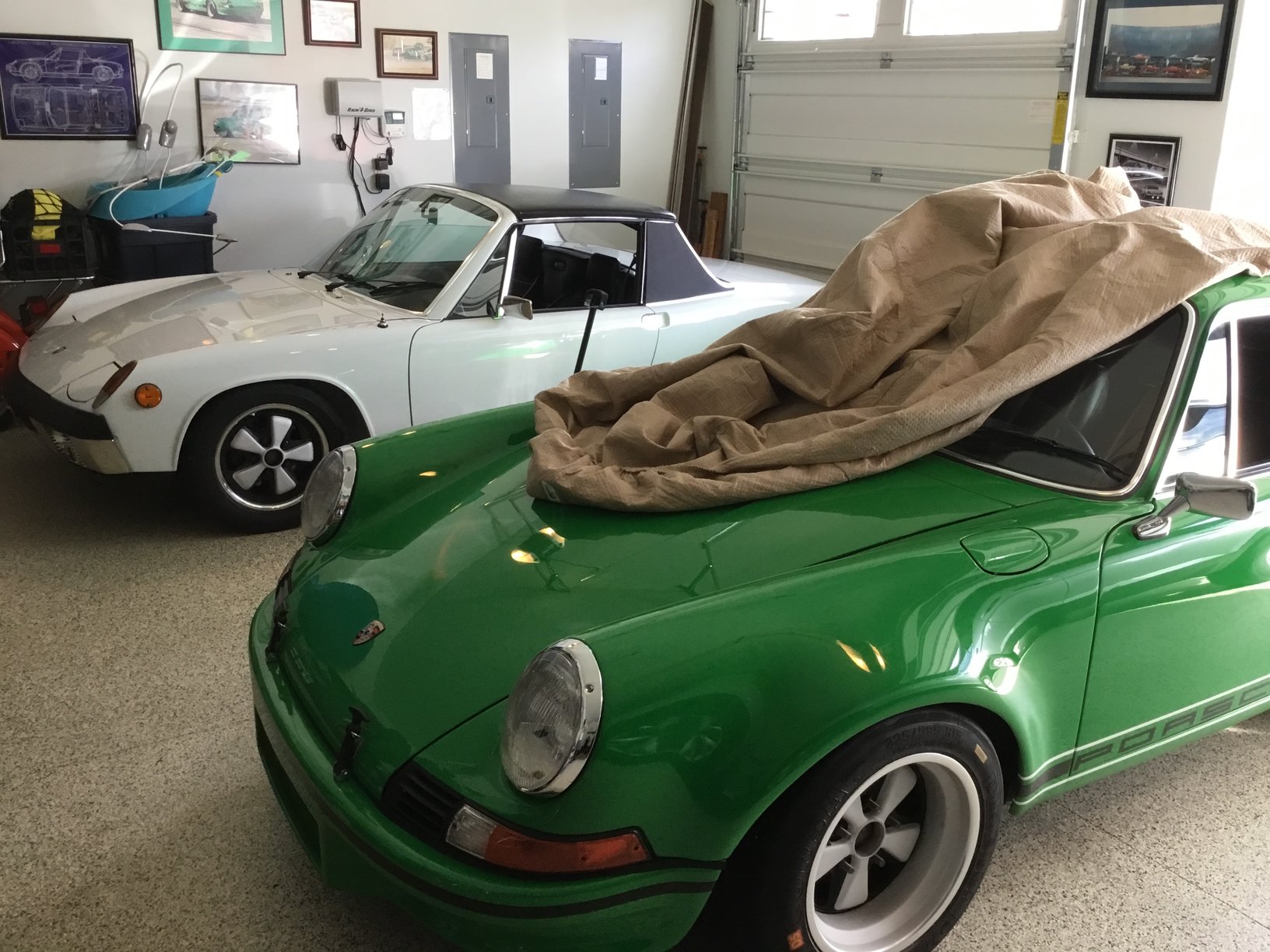

She's home finally.
Had a false start last week.
Half way home, the engine started to cut out and wouldn't run at any kind of throttle.
Trailered back to Rothsport, and they tracked it down to a fault in the fuel shutoff solenoid for the MFI system.
Beautiful day in Portland, so I went back out and fetched the car.
Safe at home in the garage.
Sharing space with its stablemate.

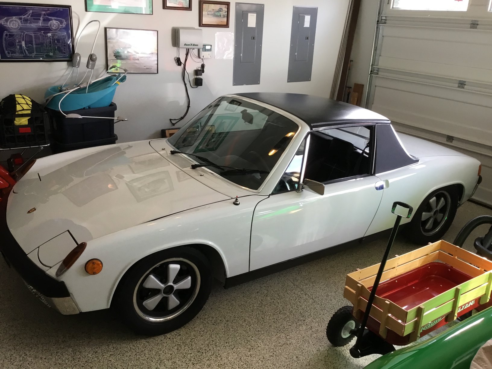

The handle on the wagon is making me cringe.
raynekat
post Oct 22 2019, 06:54 PM
Post #765
Posts: 2,172
Joined: 30-December 14
From: Coeur d'Alene, Idaho
Member No.: 18,263
QUOTE(mepstein @ Oct 22 2019, 05:09 PM) *
It's actually wrapped in harness tape....but you're right.....have to move that. Ha

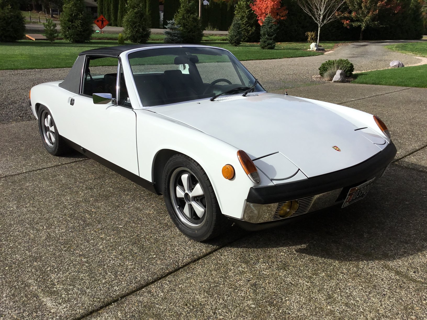

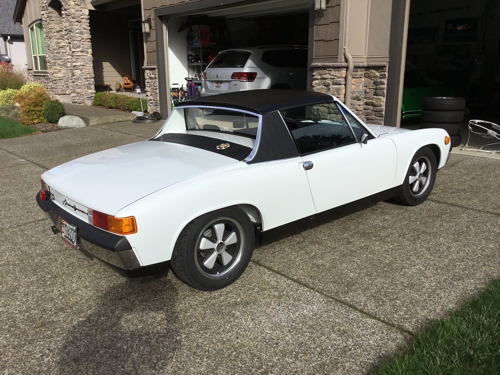

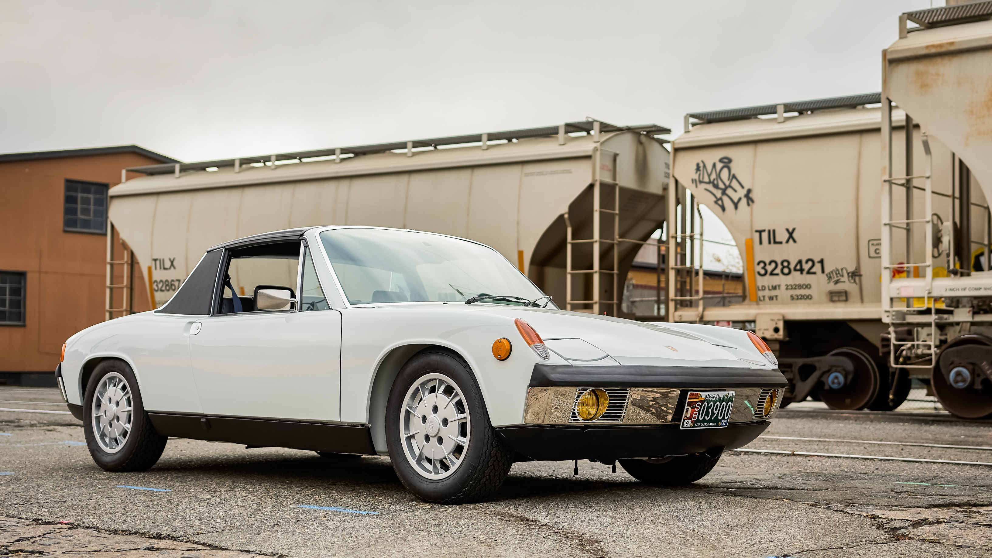

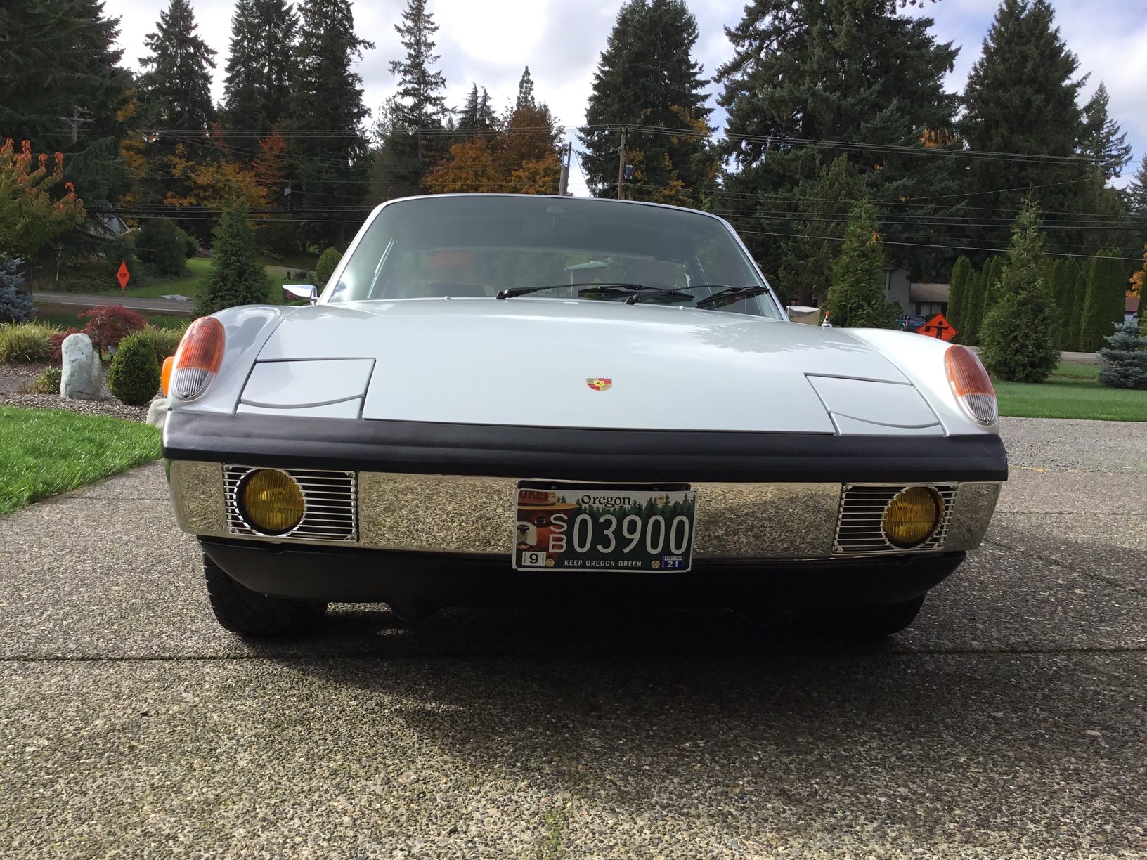

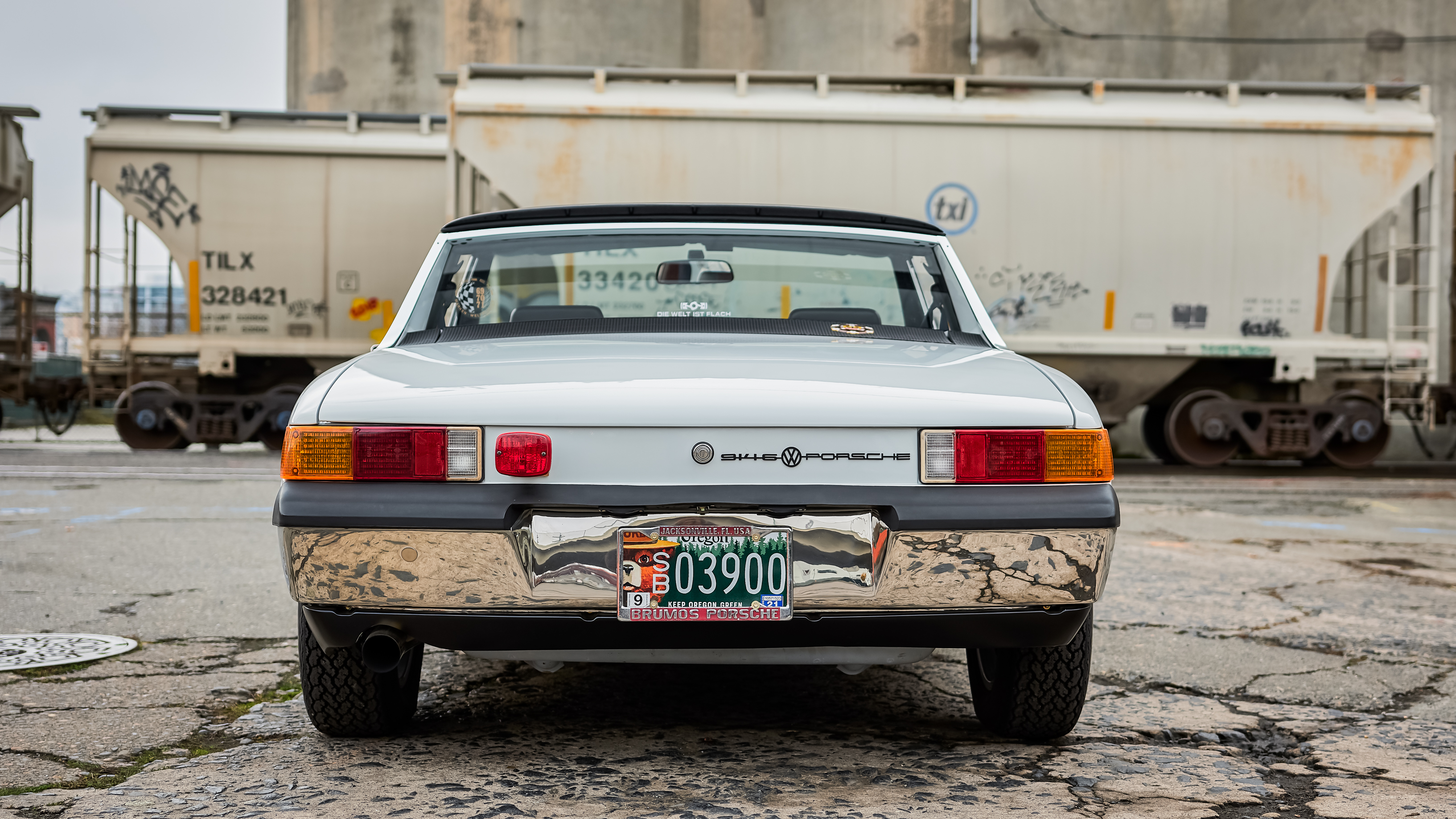

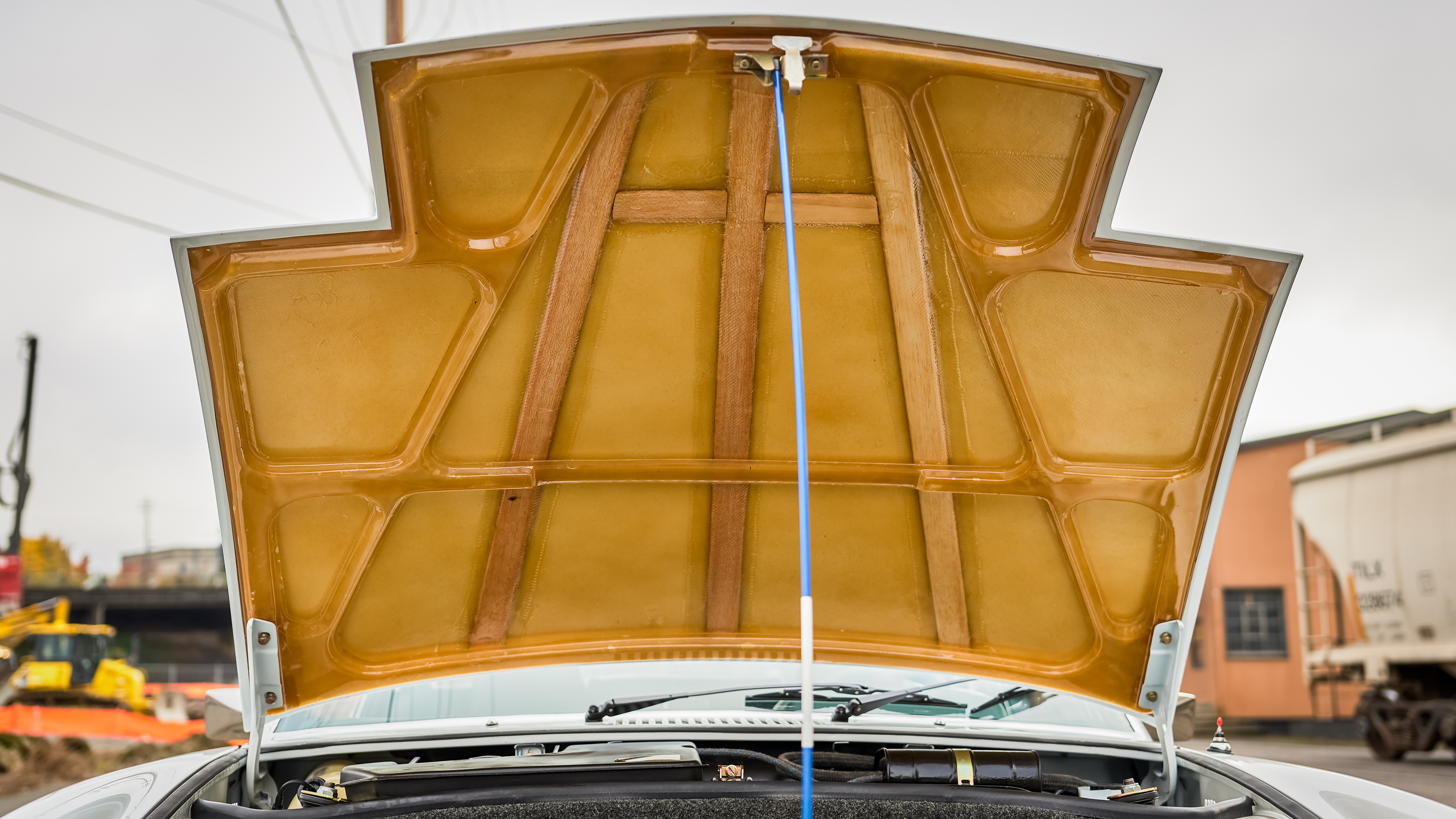

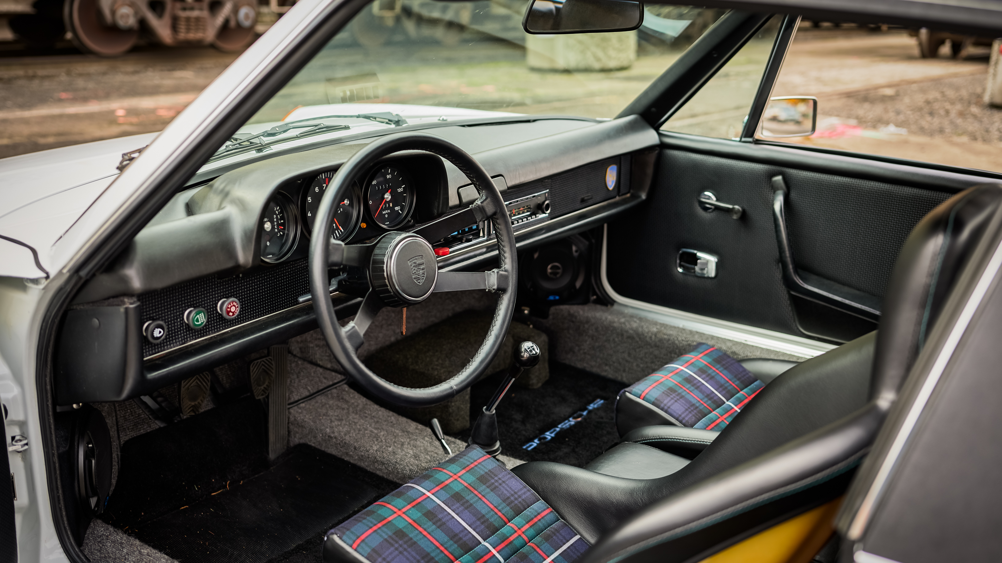

Got the car out for an appraisal this week.
Avant Garde Collection doing this took some nice pics of the car.
They have an incredible photographer you may have seen on BAT once or twice.
These are big, but I'll not shrink 'em down as the details get lost.
