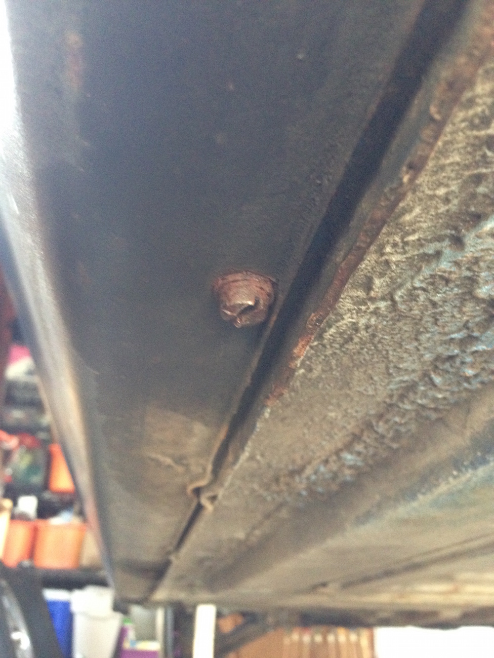

I'm trying to remove my rocker panels to inspect and clean out the longs but can't get the cheesehead screws loose. I've sprayed them with PB Blaster every day for a week, to no avail. Any other tips?

bandjoey   Pb :shoot2kill: blaster for 36 hours heat vice gr...   Feb 13 2015, 02:30 PM

ThePaintedMan   If those fail, this always works for me on stuck s...   Feb 13 2015, 03:20 PM

The Cabinetmaker   Yes on the impact screwdriver. No to harbor freigh...   Feb 13 2015, 03:29 PM
pete000   I had one stubborn one and it eventually broke off...   Feb 13 2015, 03:40 PM
sdthomas   Thanks for all the advice! What's the bes...   Feb 13 2015, 03:50 PM

rgalla9146   That screw looks to be in very good condition. ...   Feb 13 2015, 04:18 PM
ThePaintedMan   Still think the impact screwdriver is worth a shot...   Feb 13 2015, 05:01 PM
Cuda911   I just ran into the exact issue last week. As ever...   Feb 13 2015, 05:14 PM
ThePaintedMan   Aha, good point Mike. I forgot that you'd have...   Feb 13 2015, 05:16 PM
rhodyguy   Soak in between the inner edge of the rocker. Tap,...   Feb 13 2015, 05:48 PM

warrenoliver   couple of years ago, I had the same problem. I go...   Feb 13 2015, 06:23 PM

sdthomas   Got it! The combination of heat from a little...   Feb 14 2015, 04:58 PM
