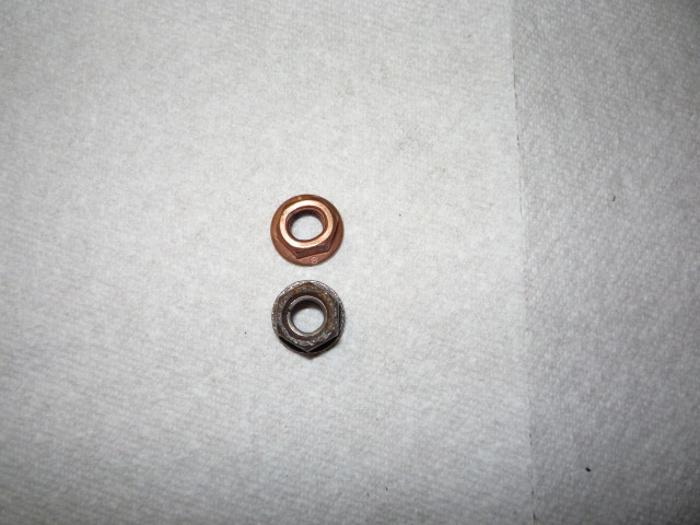

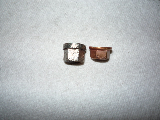

This might explain difference in cost between the two. The 2.0 nut is used and the copper is new. Note the copper one has elongated hole.

GeorgeRud   I believe the elongated center in the copper nut i...   Feb 26 2015, 10:20 PM
McMark   Yup, the top threads are squished. It's the w...   Feb 27 2015, 10:22 AM
Dave_Darling   Sixer, can you look at the OEM nut to see if there...   Feb 27 2015, 10:59 AM
Cap'n Krusty   I have one sitting right here. No slice, no defor...   Feb 27 2015, 11:10 AM
