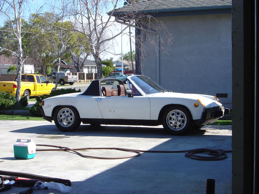

Here she sits in the driveway, I gave it a bath, I dont think it was EVER washed before. Since there was only one bolt holding the front bumper rubber on I went ahead and removed it from the car. I put a cheap set of mirrors on it to make it legal to drive. I may start doing the body work on it this next week. It will be covered in my driveway for the most part. As long as this weather holds up, I can get some stuff done.

Car looks good, I'm assuming its a 2L

Dang what all that light under the car. you can drive a Mack truck under there. I know it is probably stock ride hiegth.
