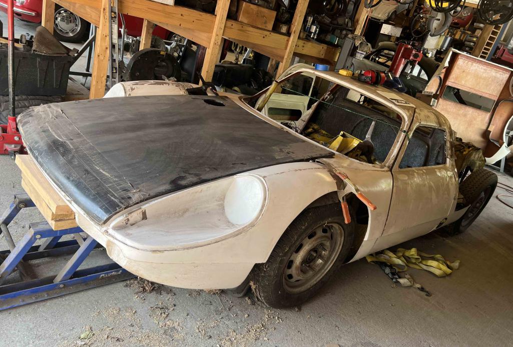

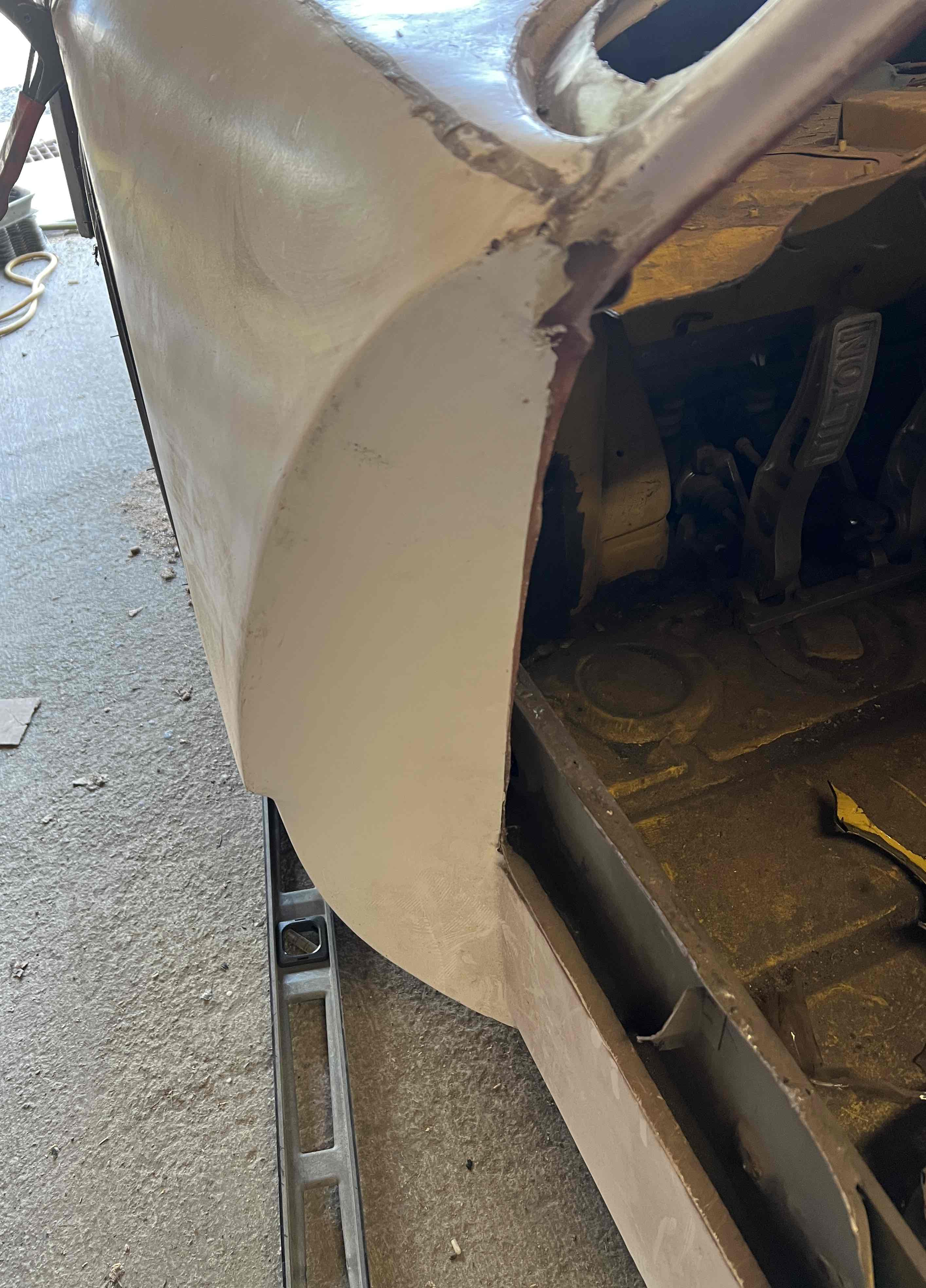

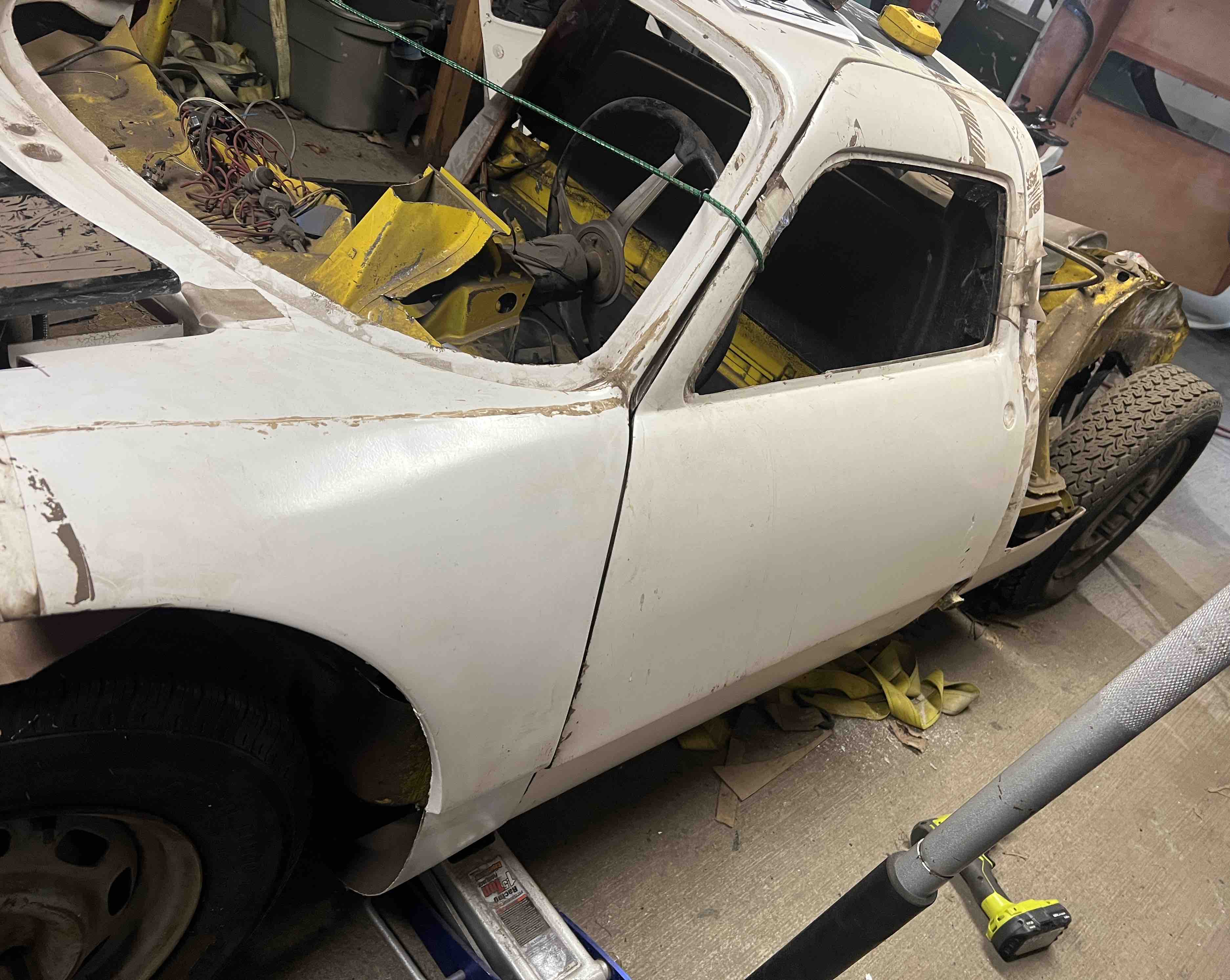

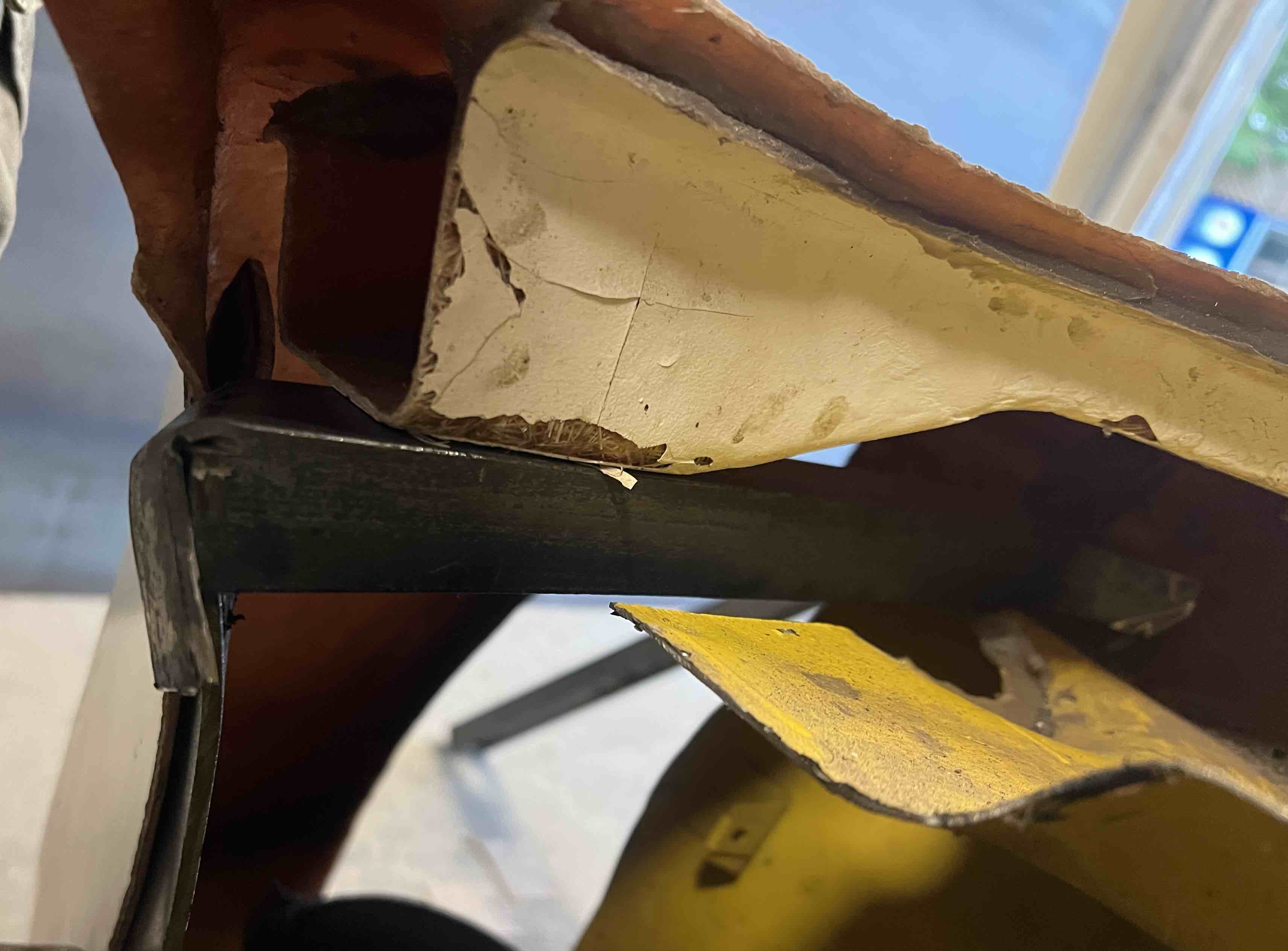

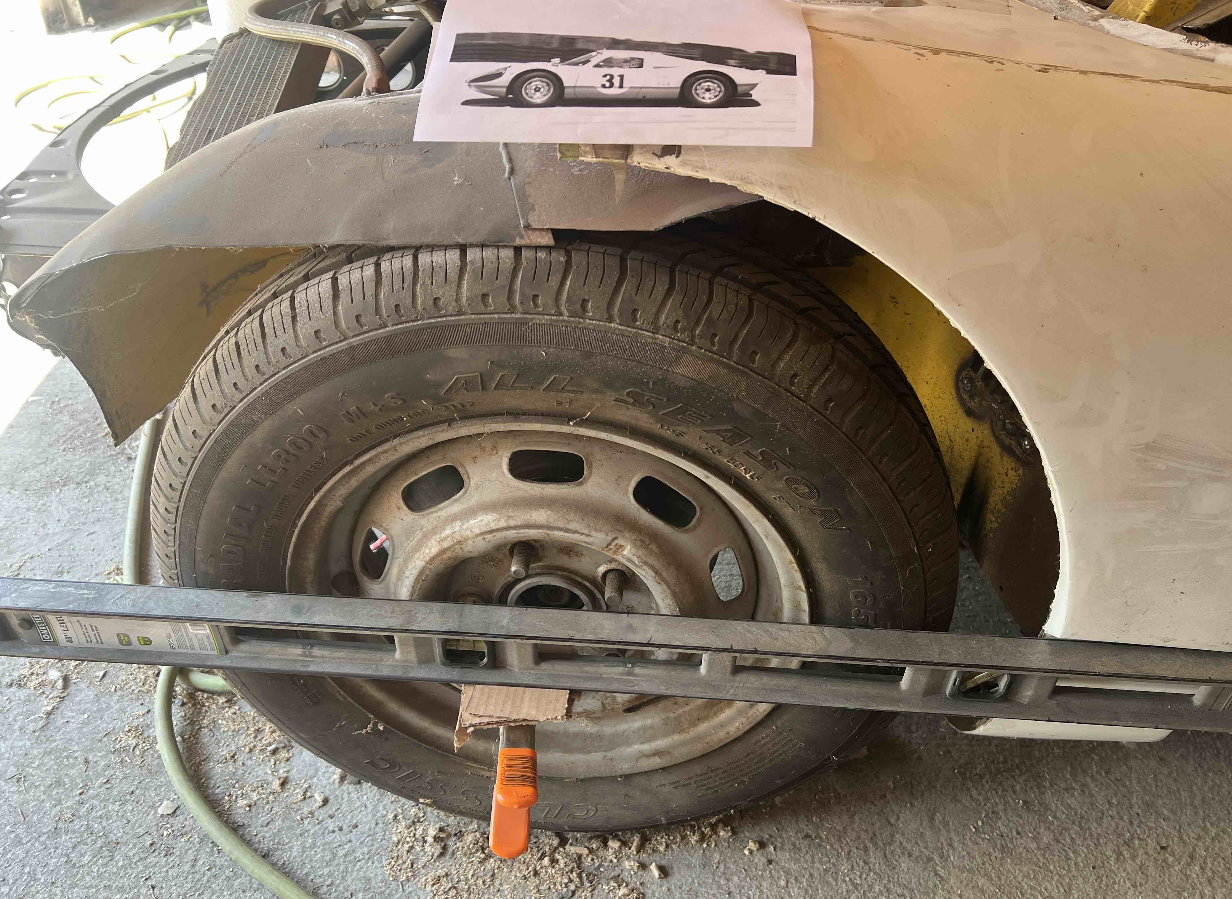

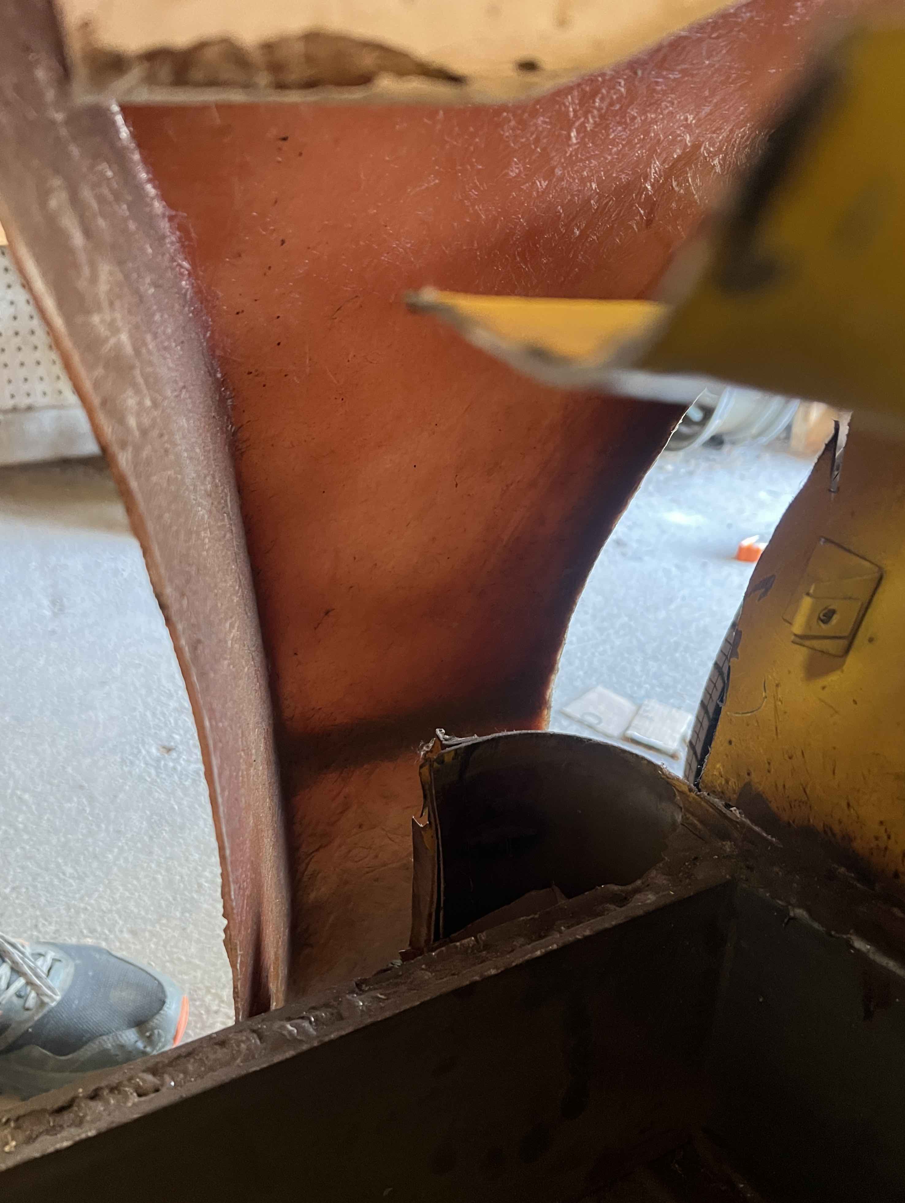

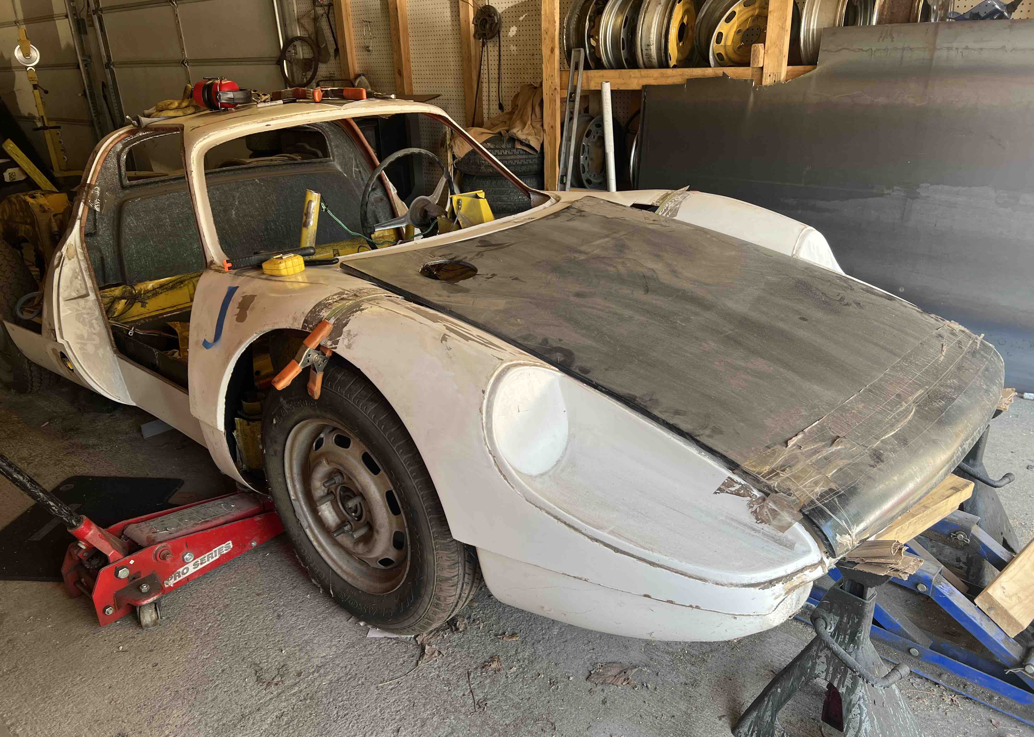

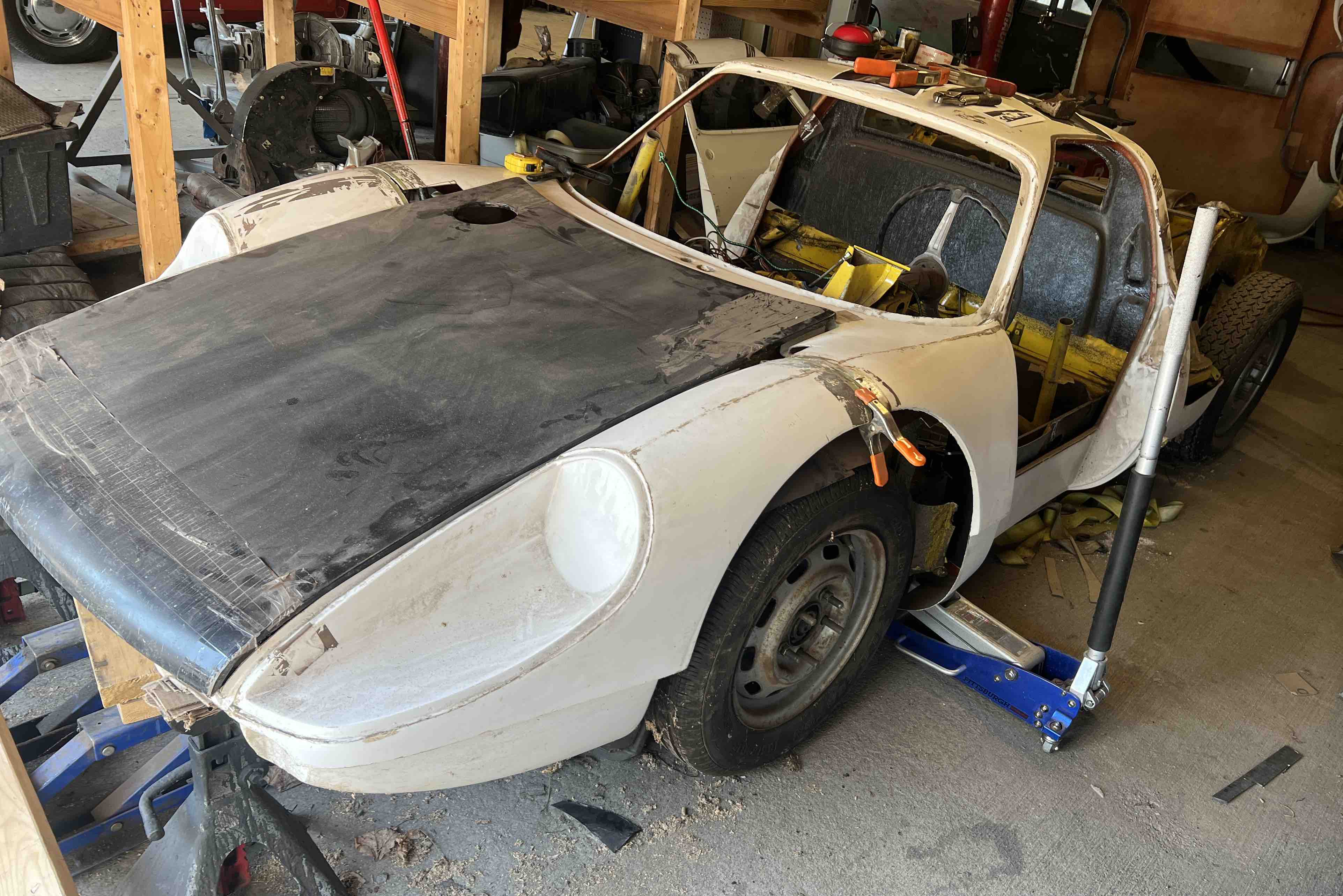

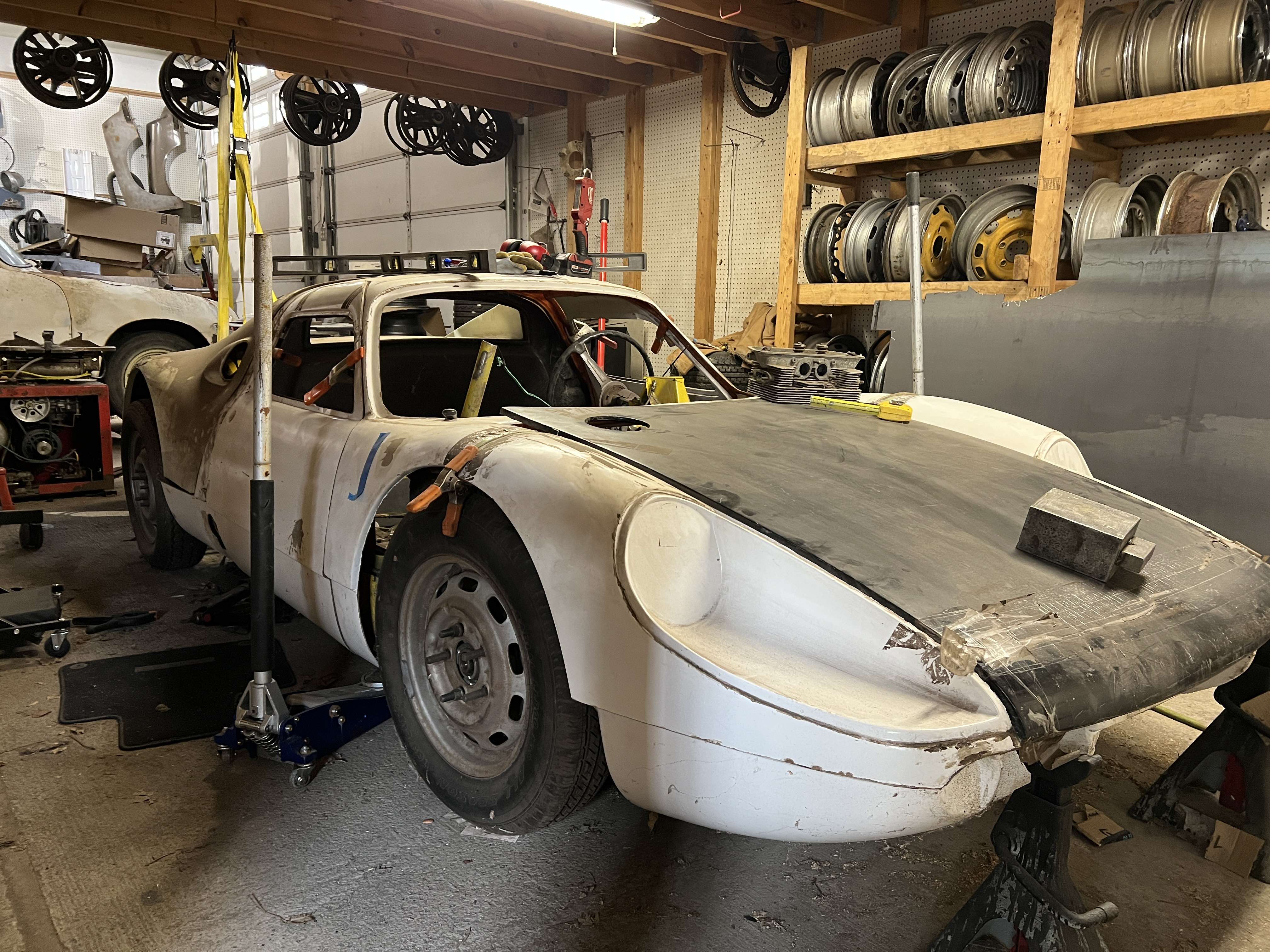

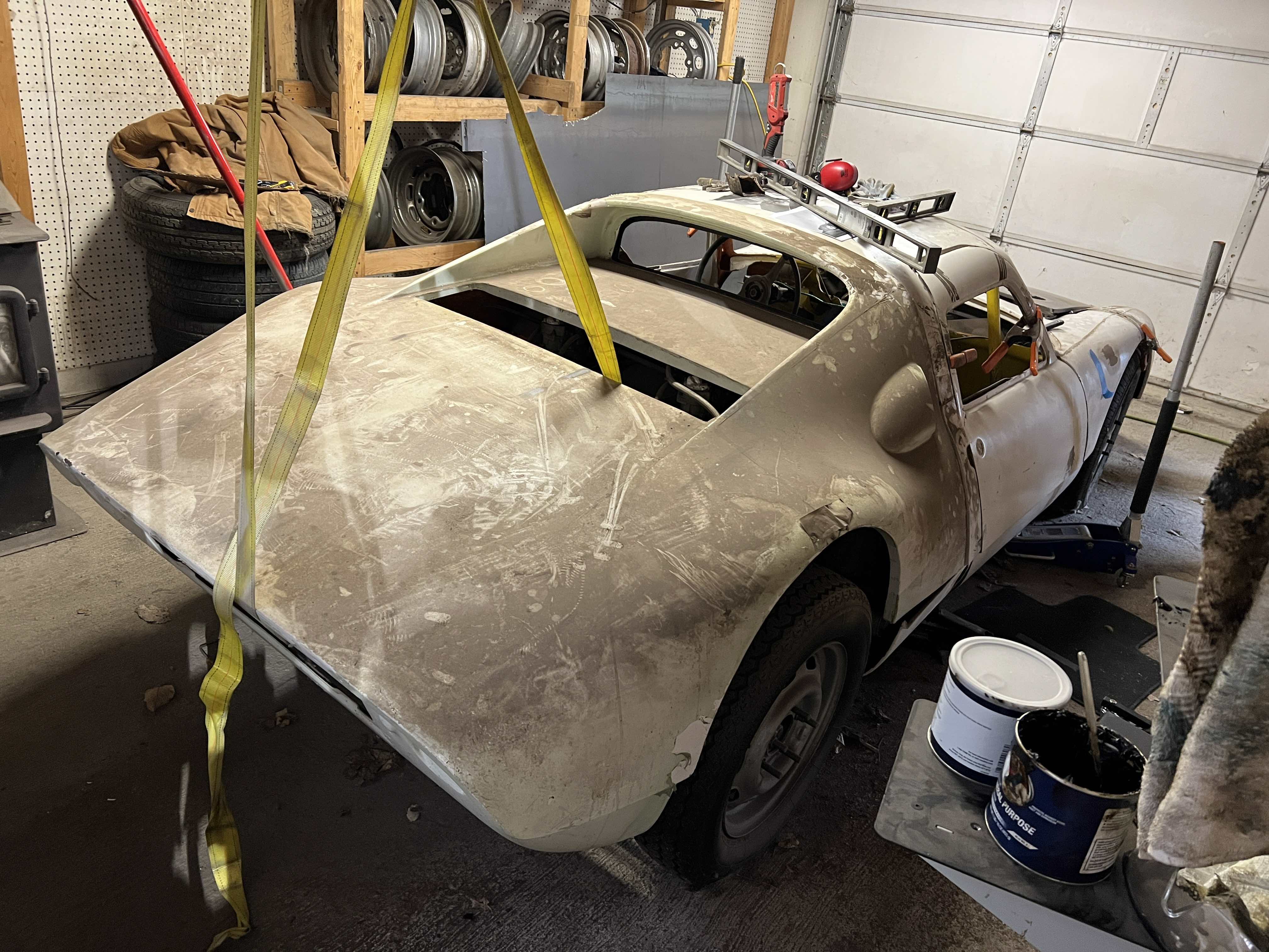

Ok, so everyone in the shop is on vacation but me, so perfect time to get back on this car. My goal is to have the body mounted by the end of the week, but even if I don't make it I hope to get some good work done.

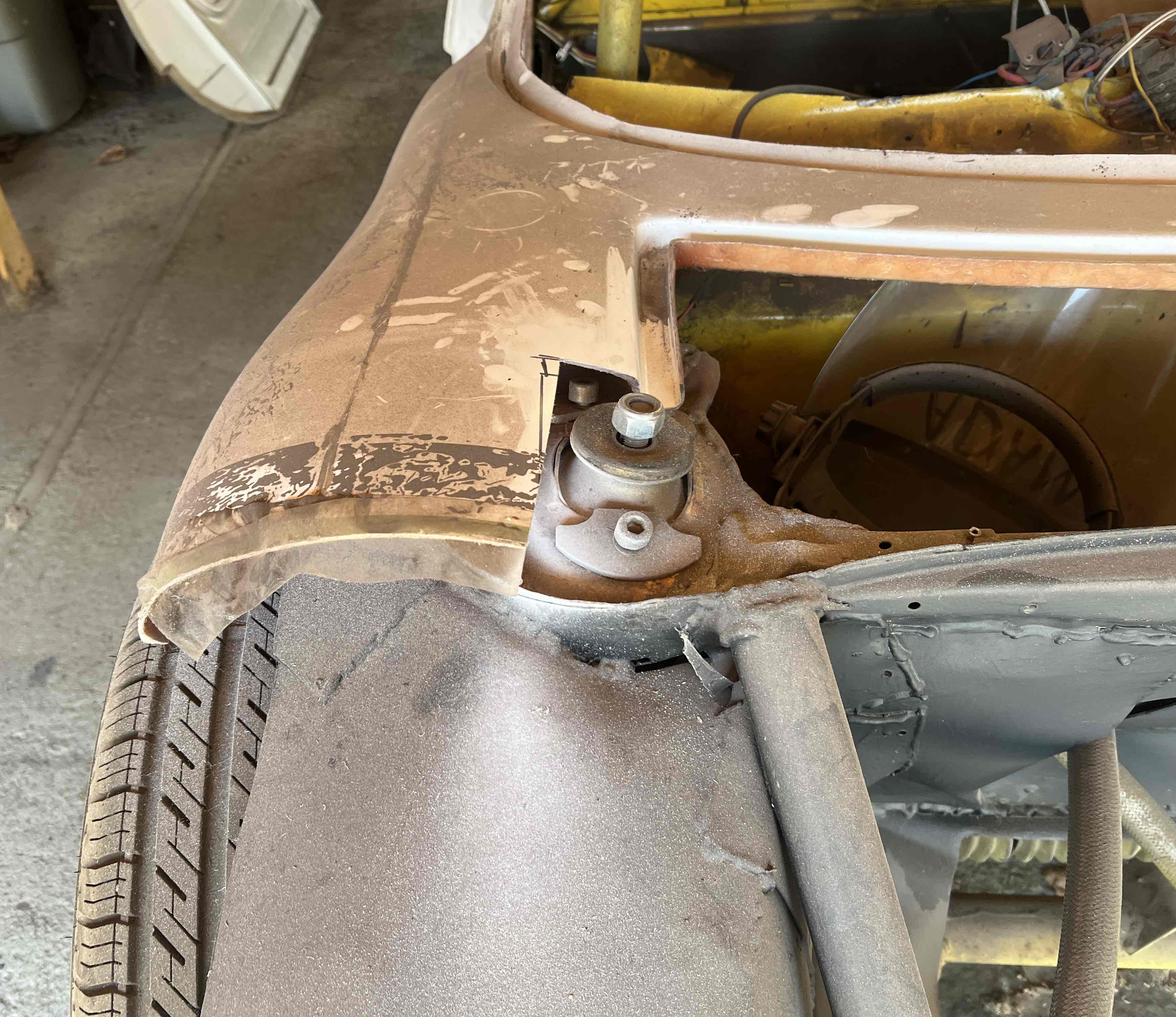

First part of the plan was setting the body where it needs to be in terms of wheel wells and over height on the chassis. I got some of that dialed in today, had to make some mods on the hood channel that I will go back and finish later. The bodywork is very tight on the shock tops, but I think I can make it work, though servicing the shock will be a nightmare later.
Once I get the body roughly where i need it I'm doing to weld up some support for the door hinge mounts, while also giving overall support to the door jamb. This will support the middle of the front part of the car, with additional supports behind the seats and along the lower door threshold.
Stay tuned, new updates all week!

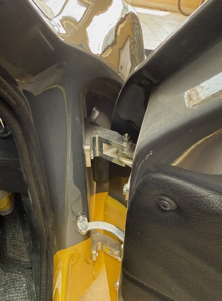

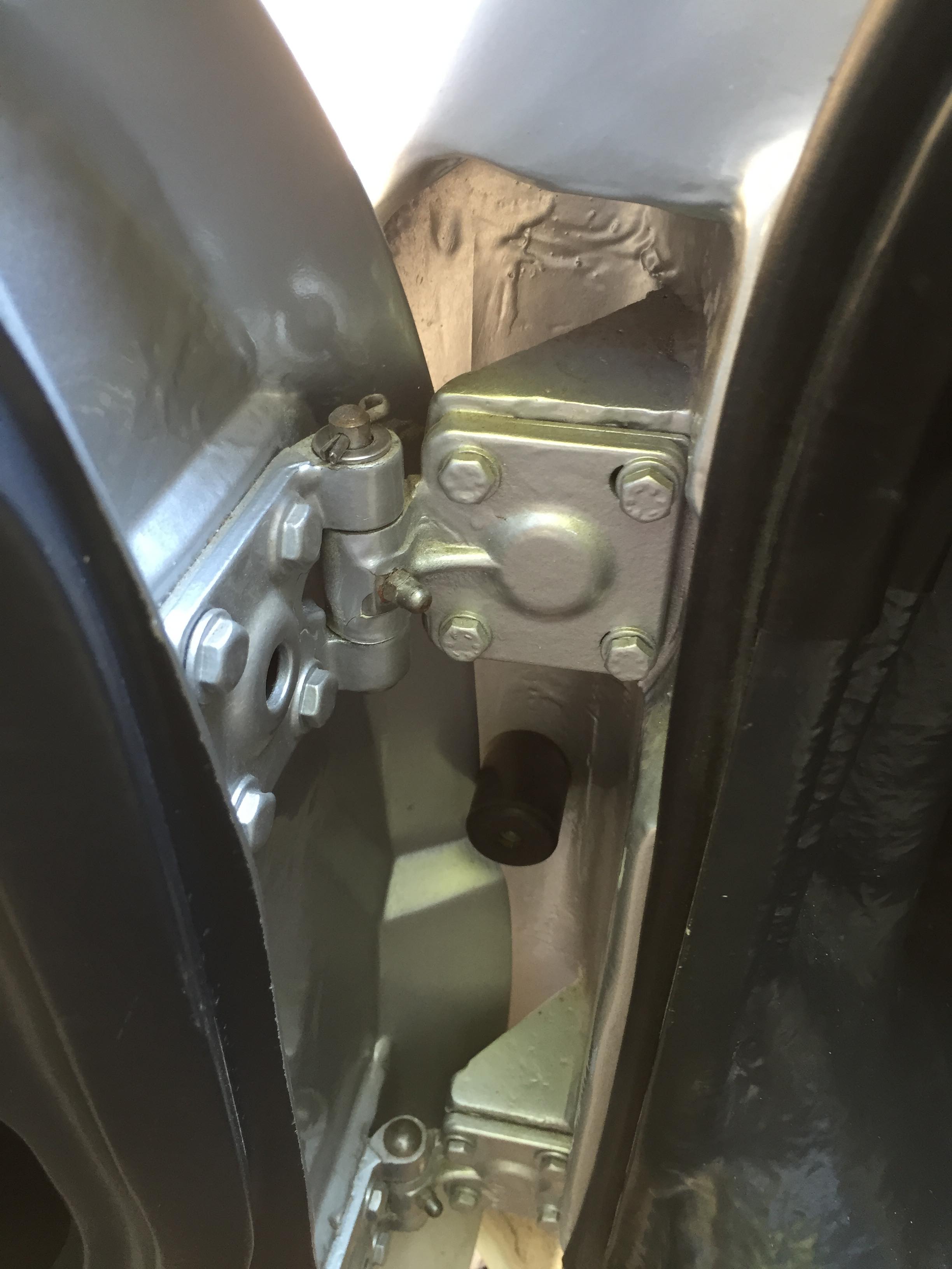

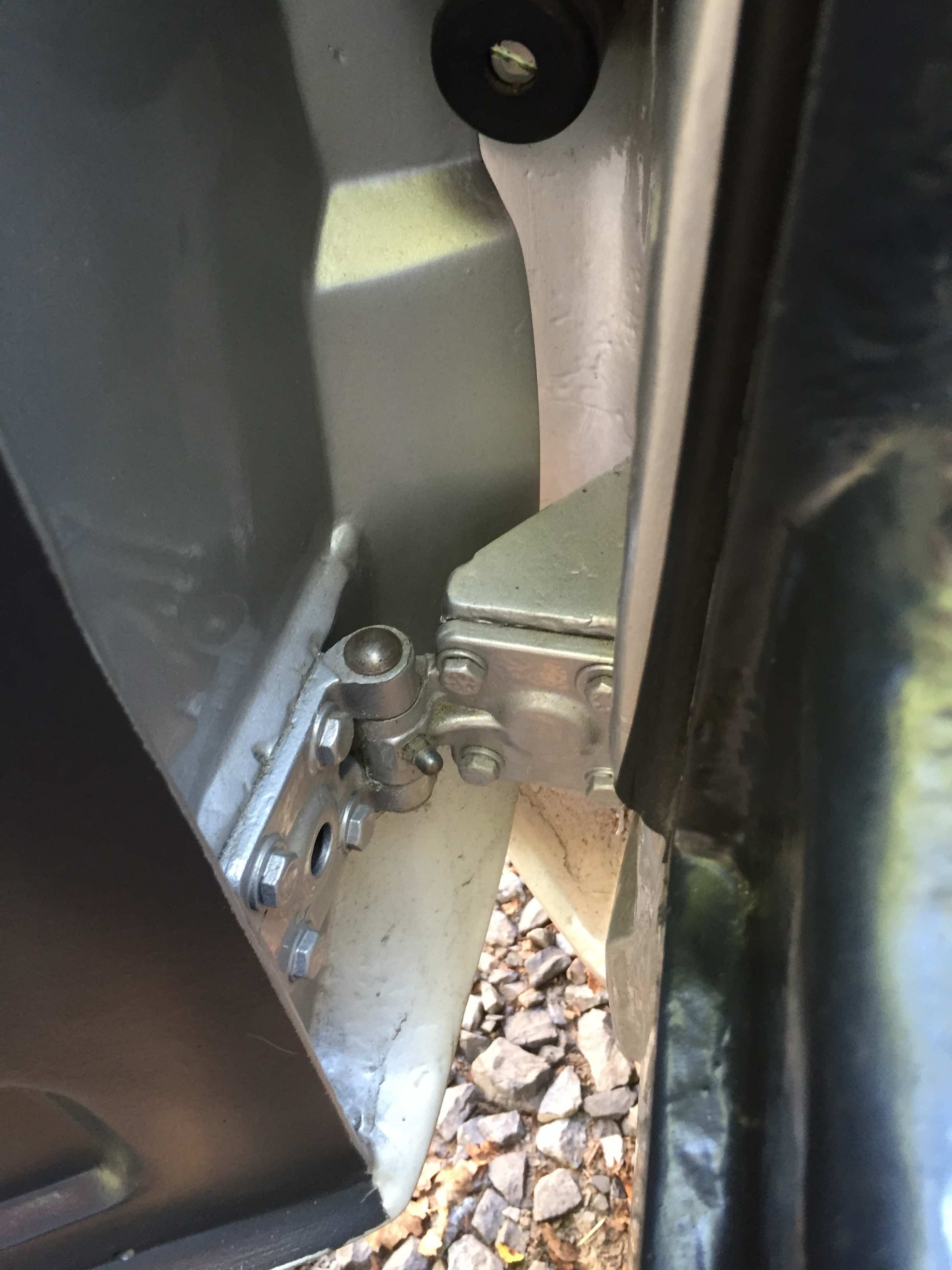

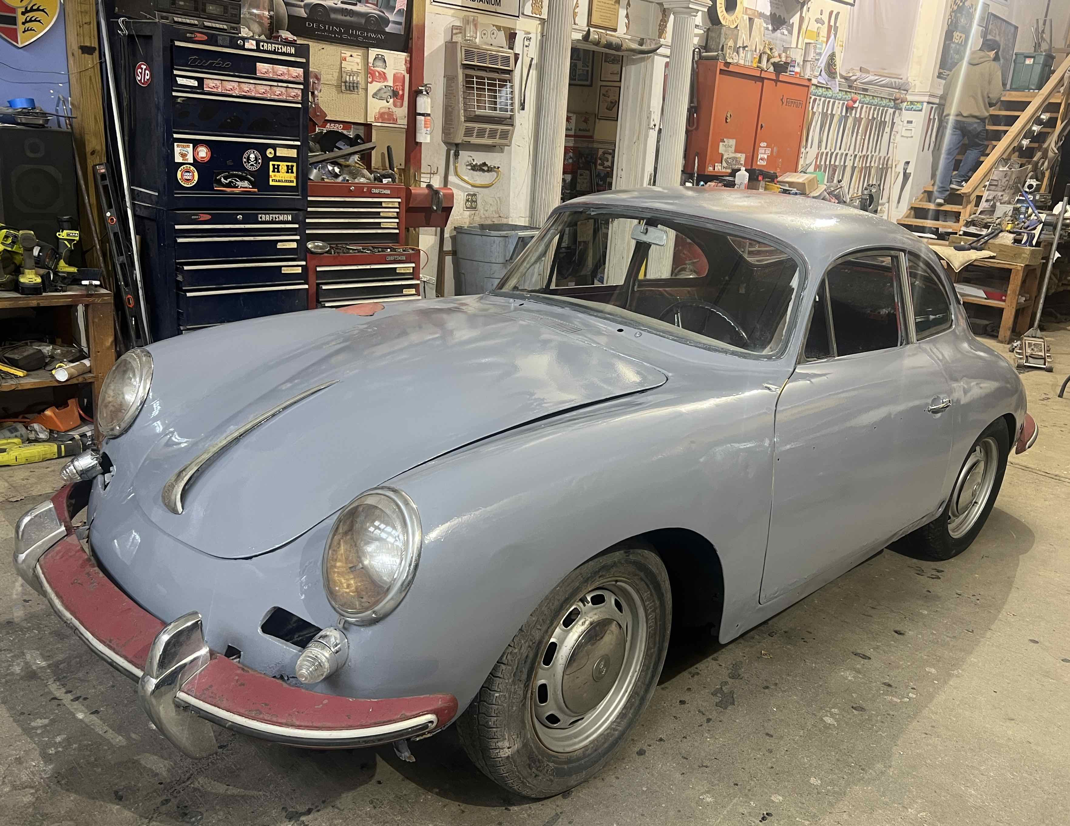

The silver car is 904-0014, which I was able to take lots of pics several years ago. I'm glad I did because my friend sold it last year! This is the door hinge mounts I have to copy.

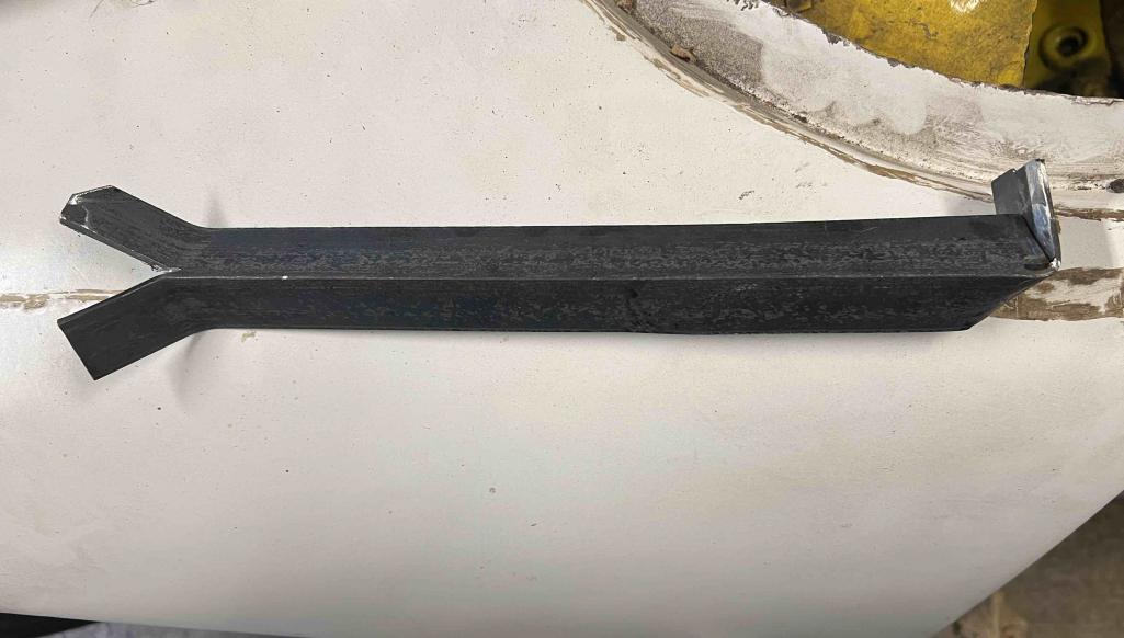

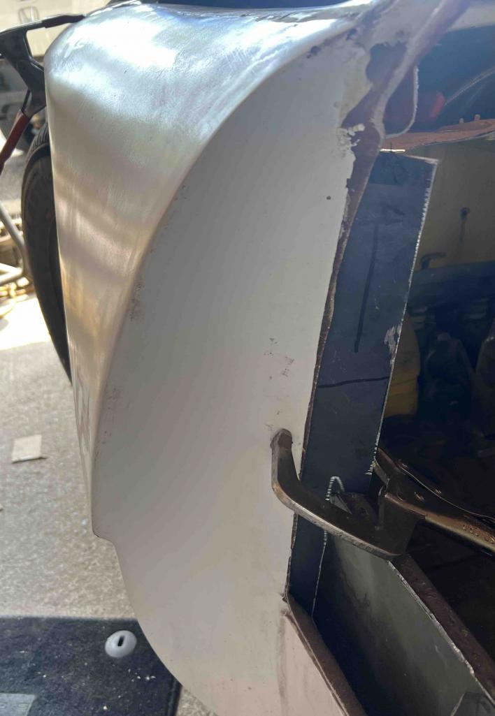

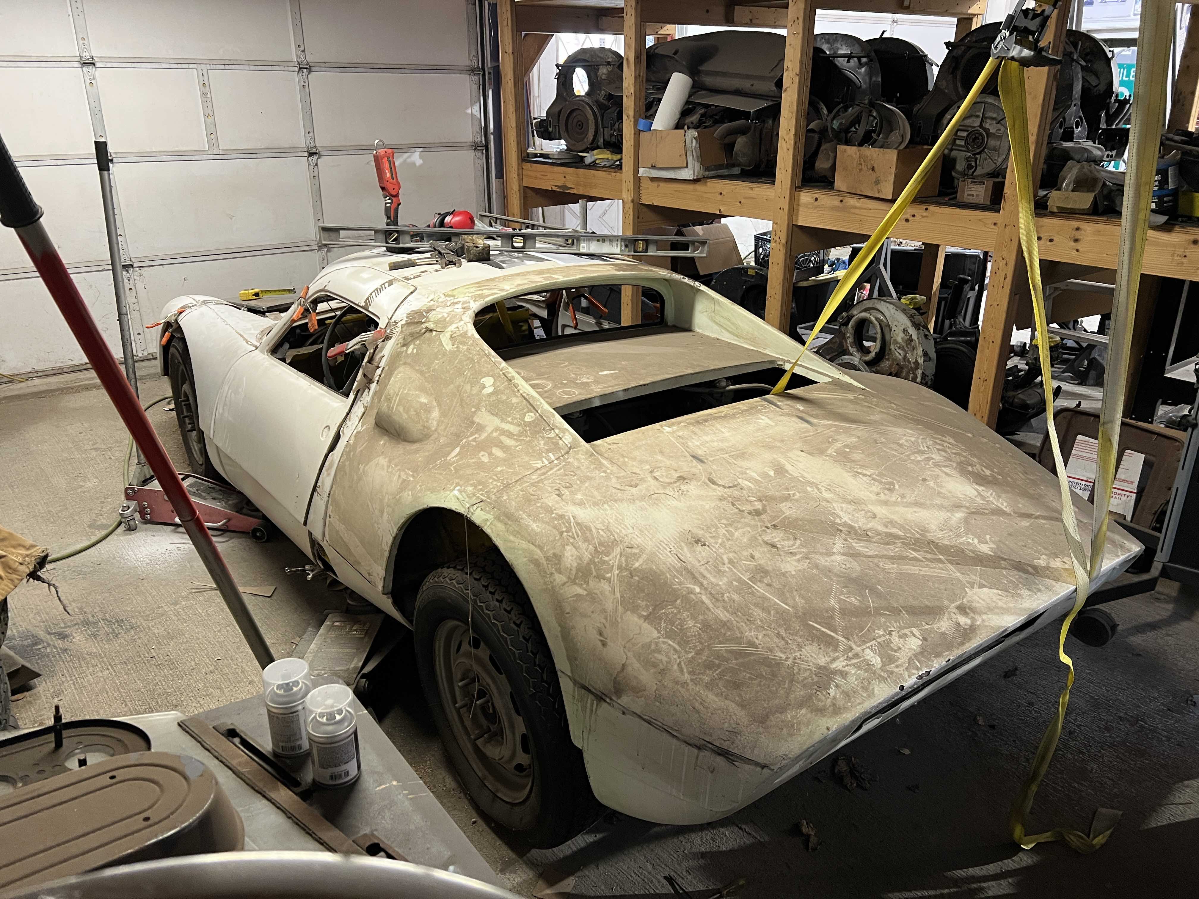

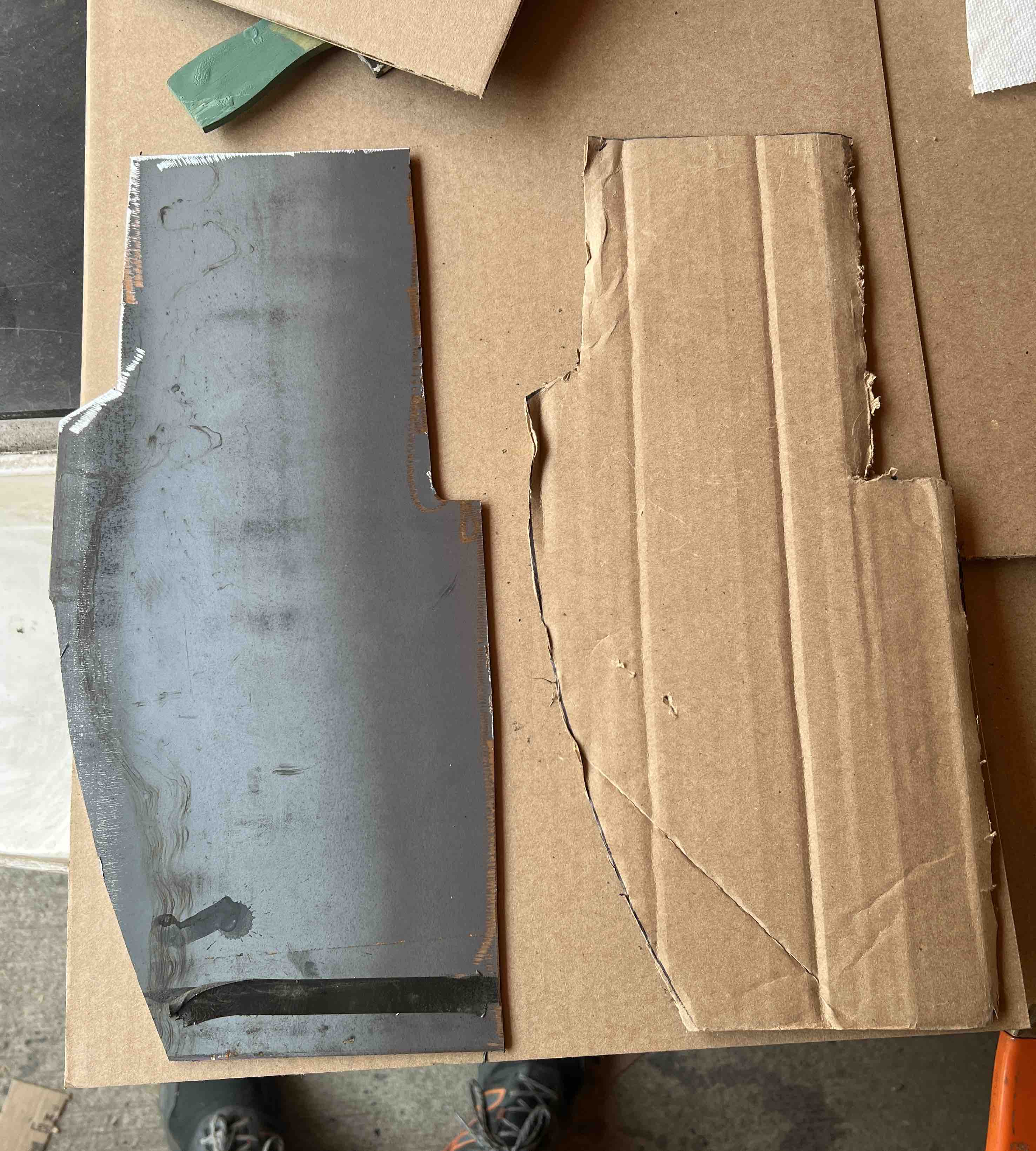

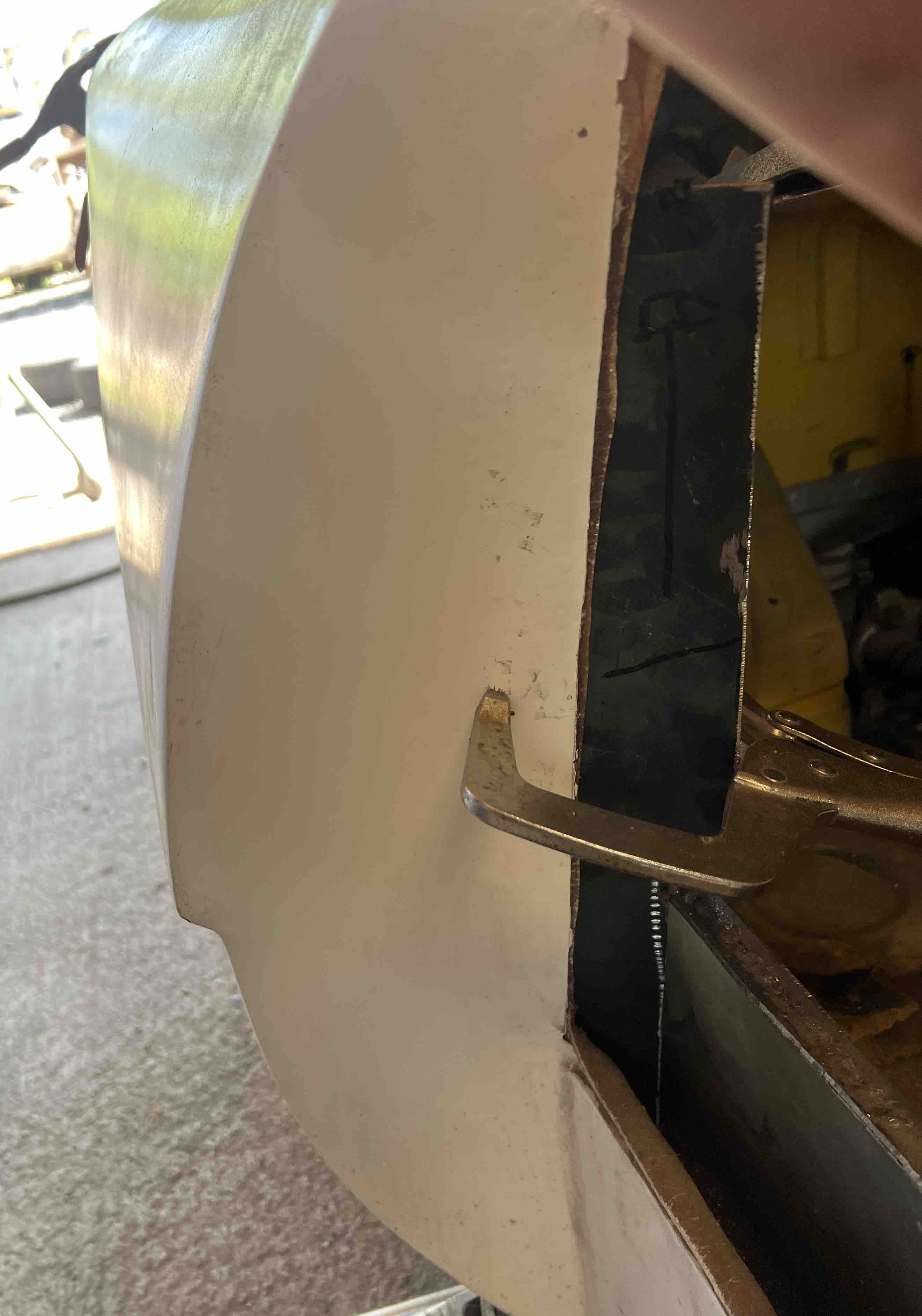

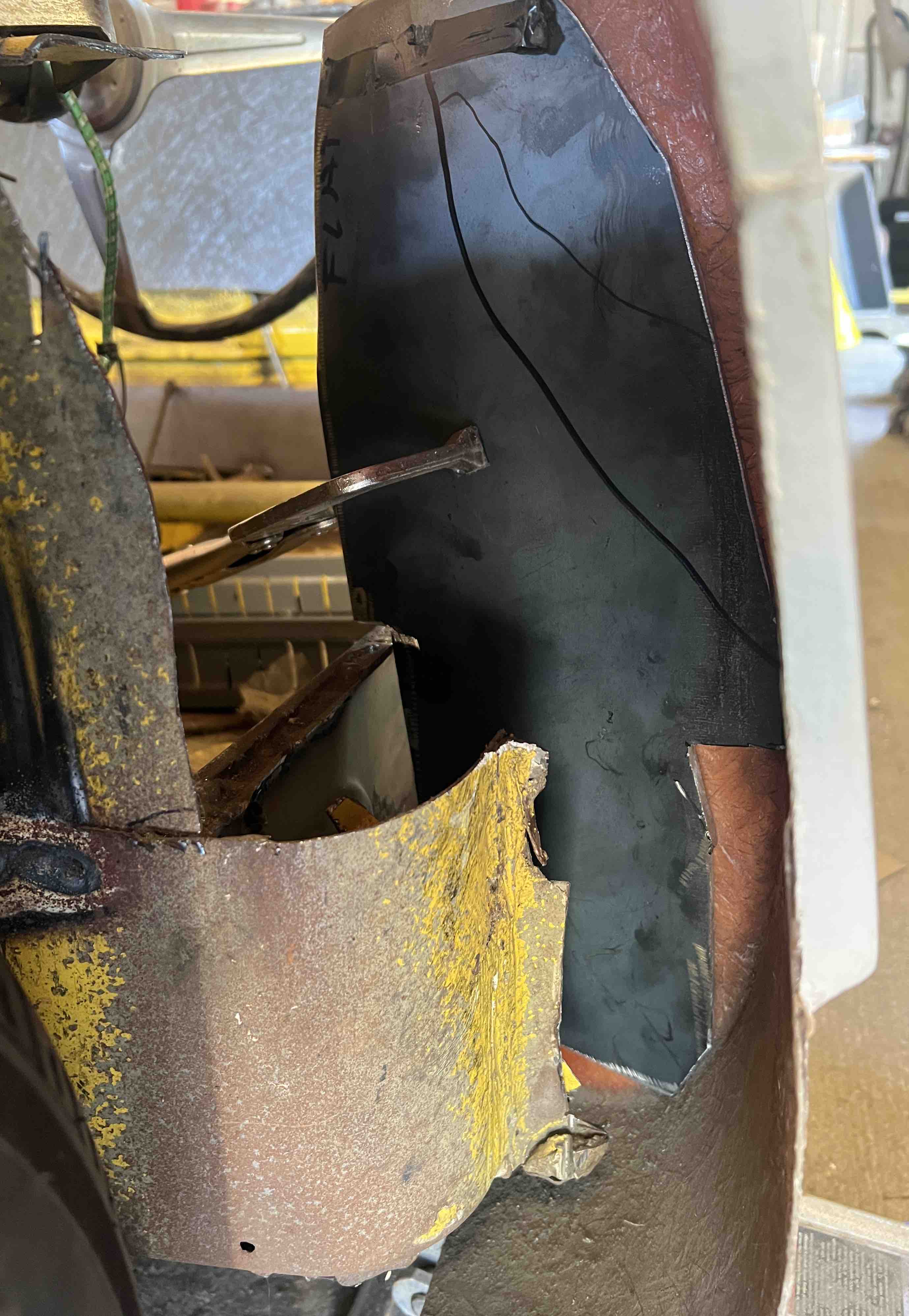

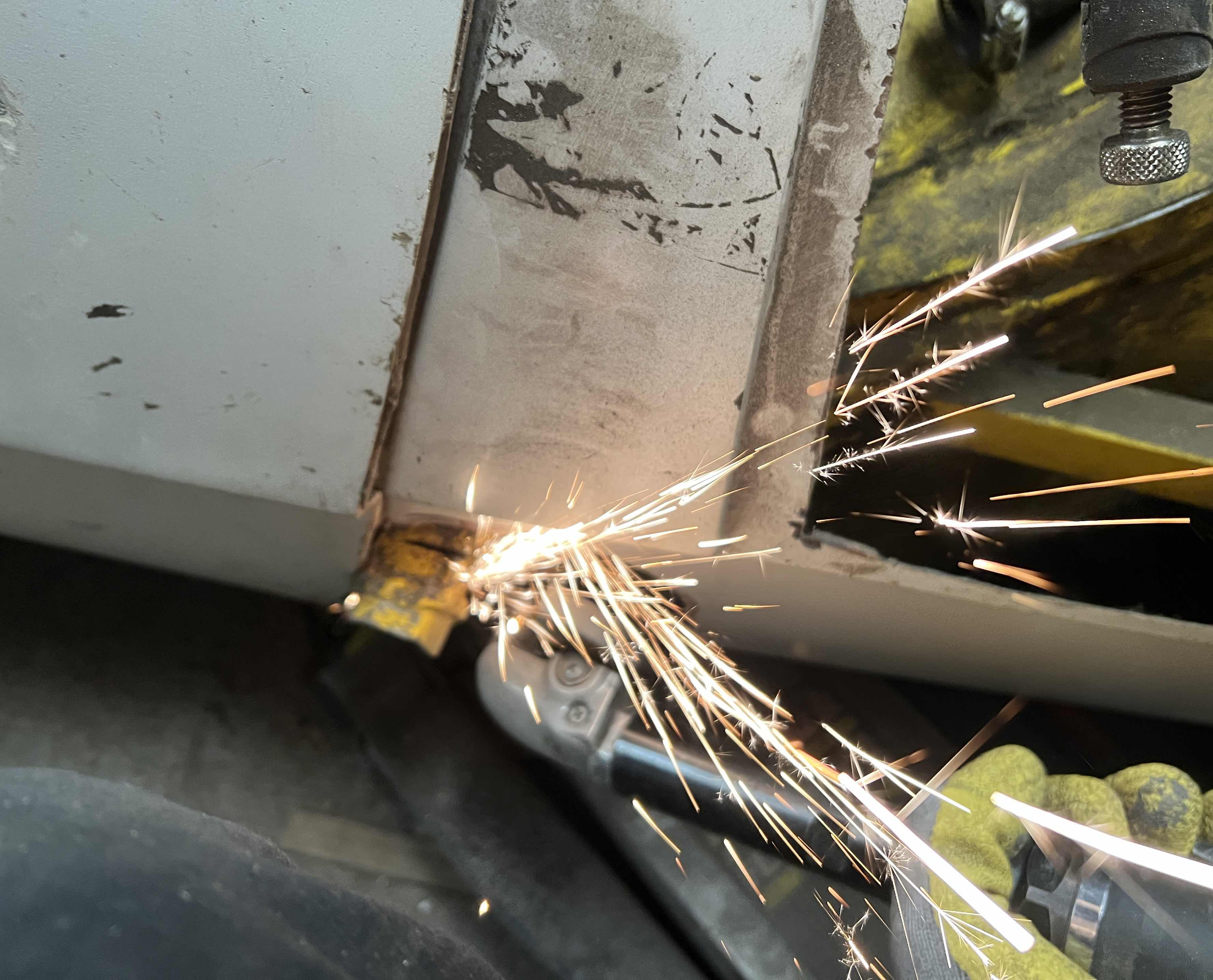

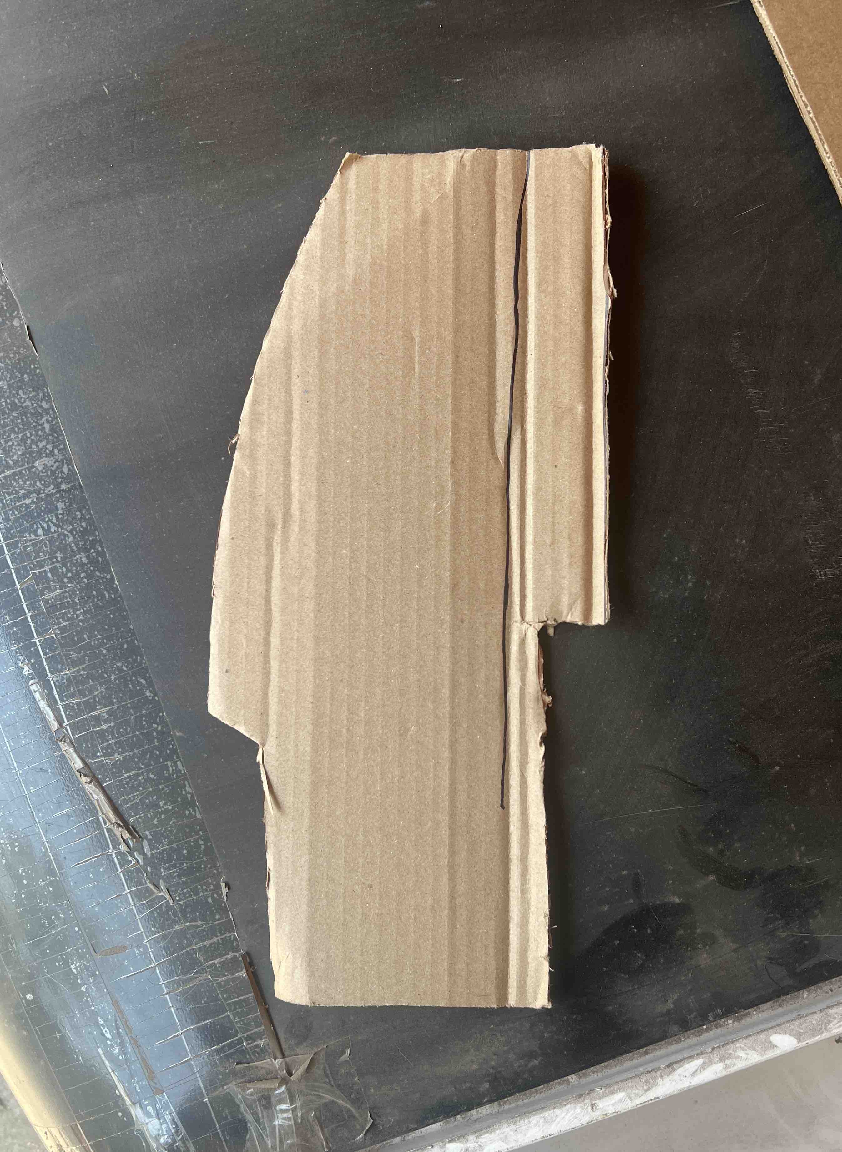

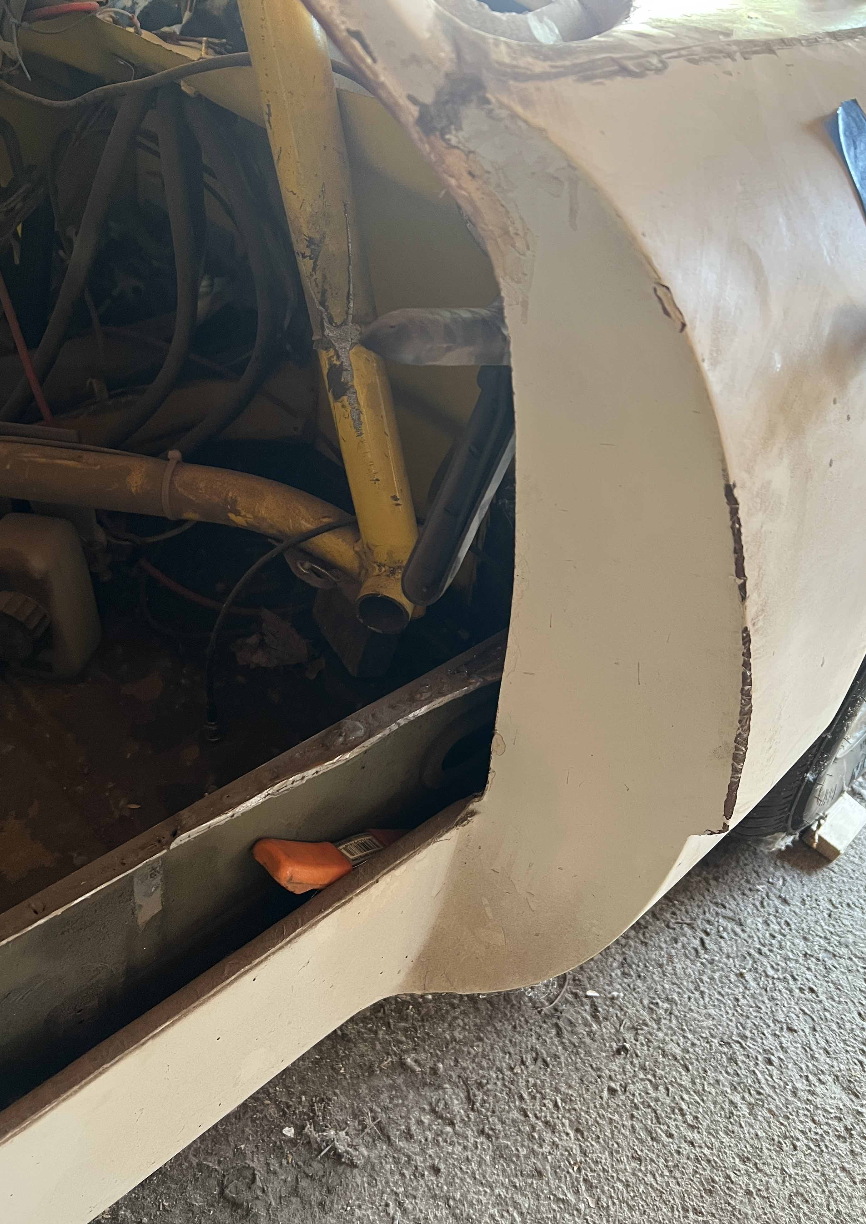

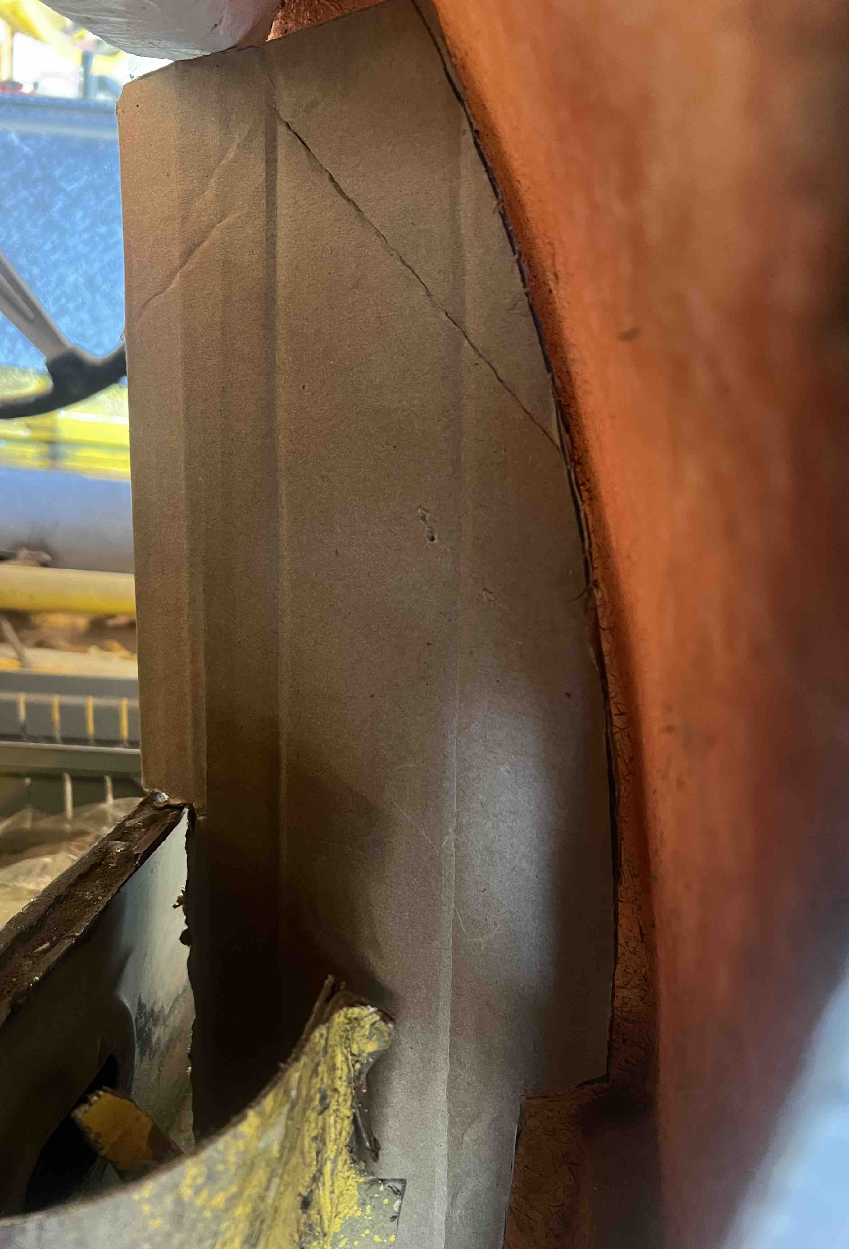

So today was a big day of which path to take? I had originally thought I would recreate the way Porsche did the door hinges. I also reached out to the guys at BECK to see how they do it, they sent me over pics of how they do it, which is different. I also had some standard 356 hinge mounts and tried those. But none were really working with the inner door setup I have. I decided to fab up a piece on either side to both support the body and provide a landing zone for the door hinges. I went by Metal Supermarkets and grabbed a sheet of 10 gauge steel. I looked at most of the heavy structural parts of the 914 and they were made with 10 gauge so figured 10 was the way to go. I have a cardboard template of the piece I'll need to make. In addition to cutting it to shape I will have to do some shaping to get it to fit the curve of the inner door, not looking forward to shaping thick metal, but it can be done. Stay tuned.

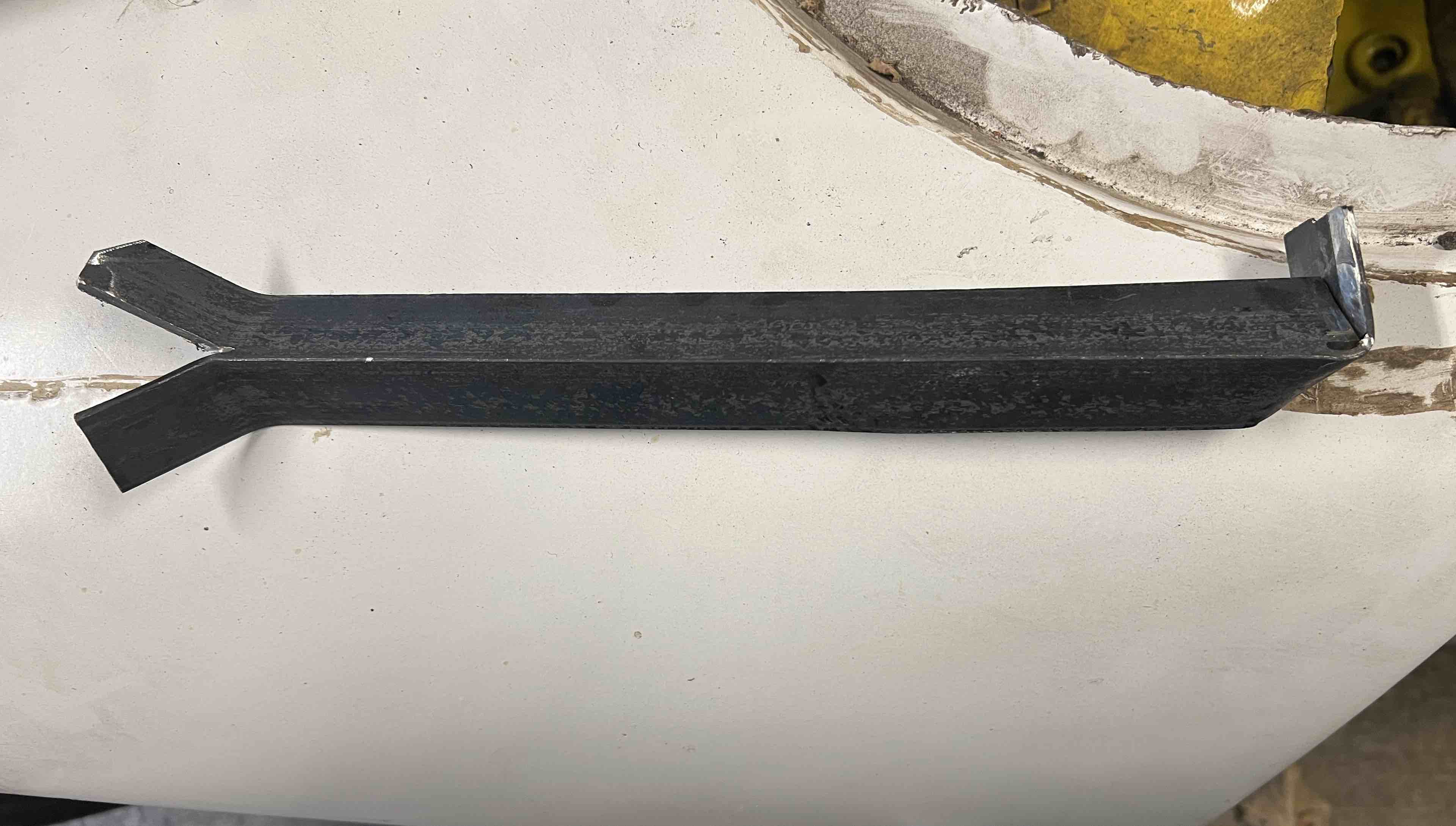

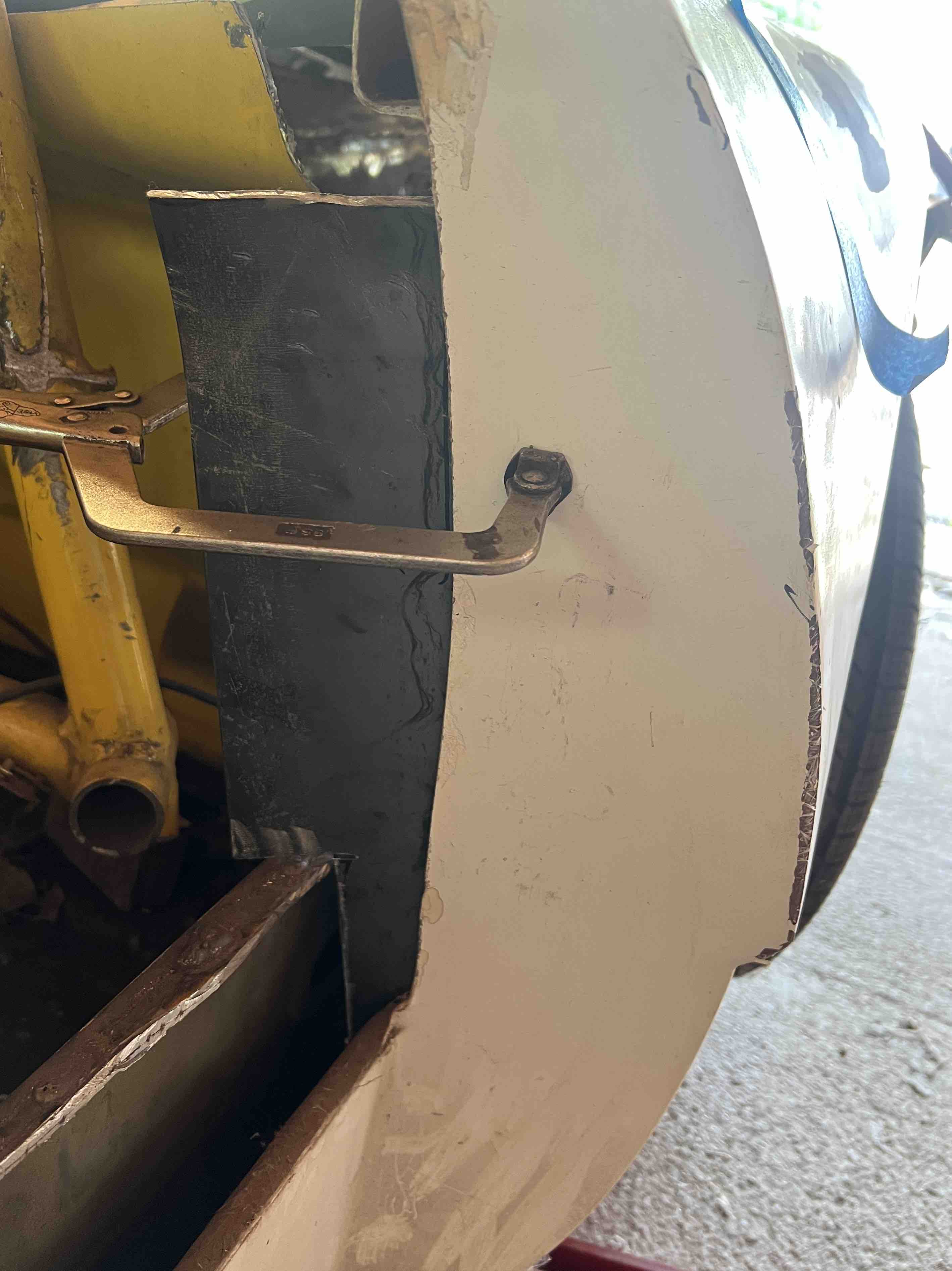

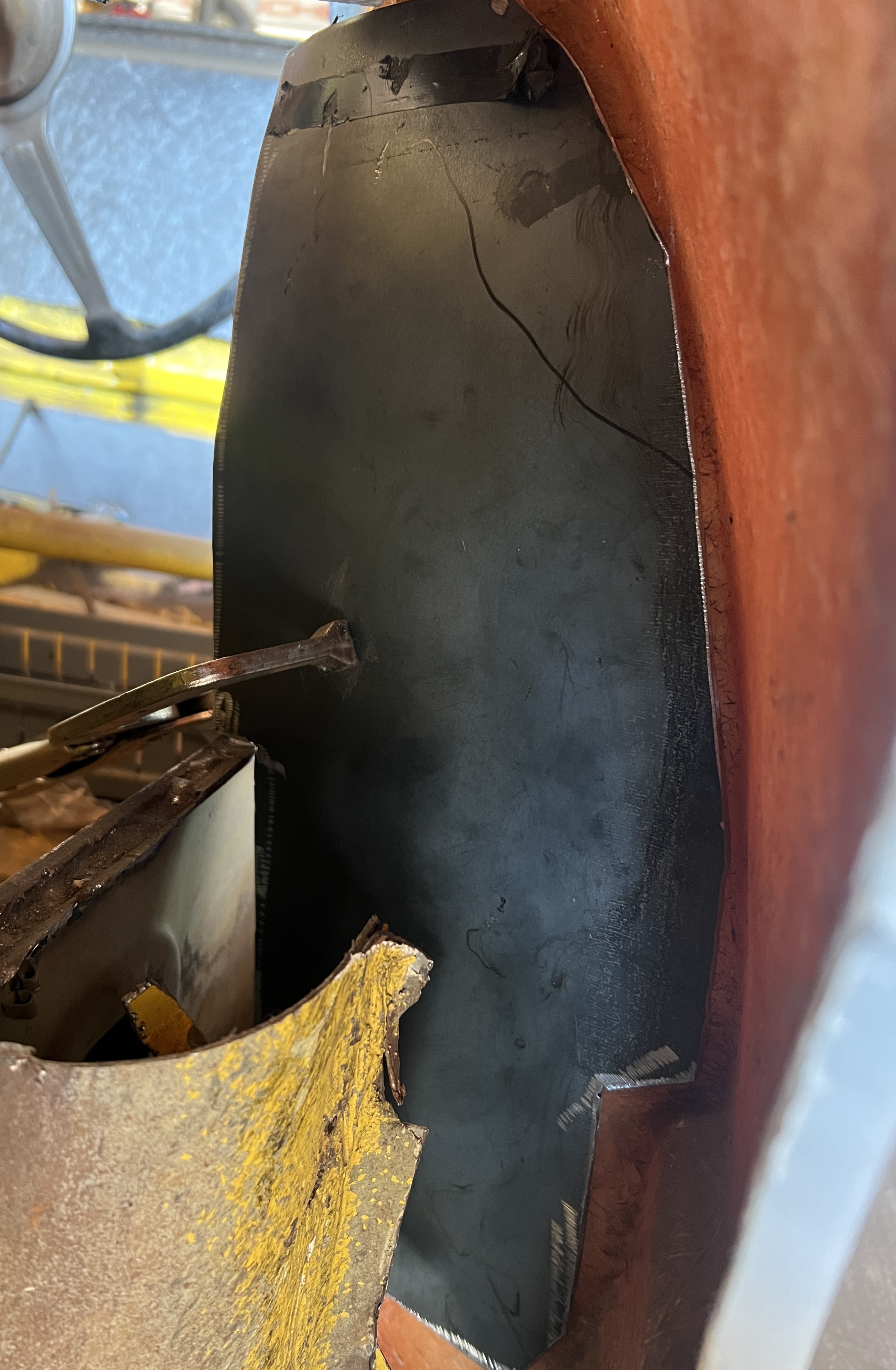

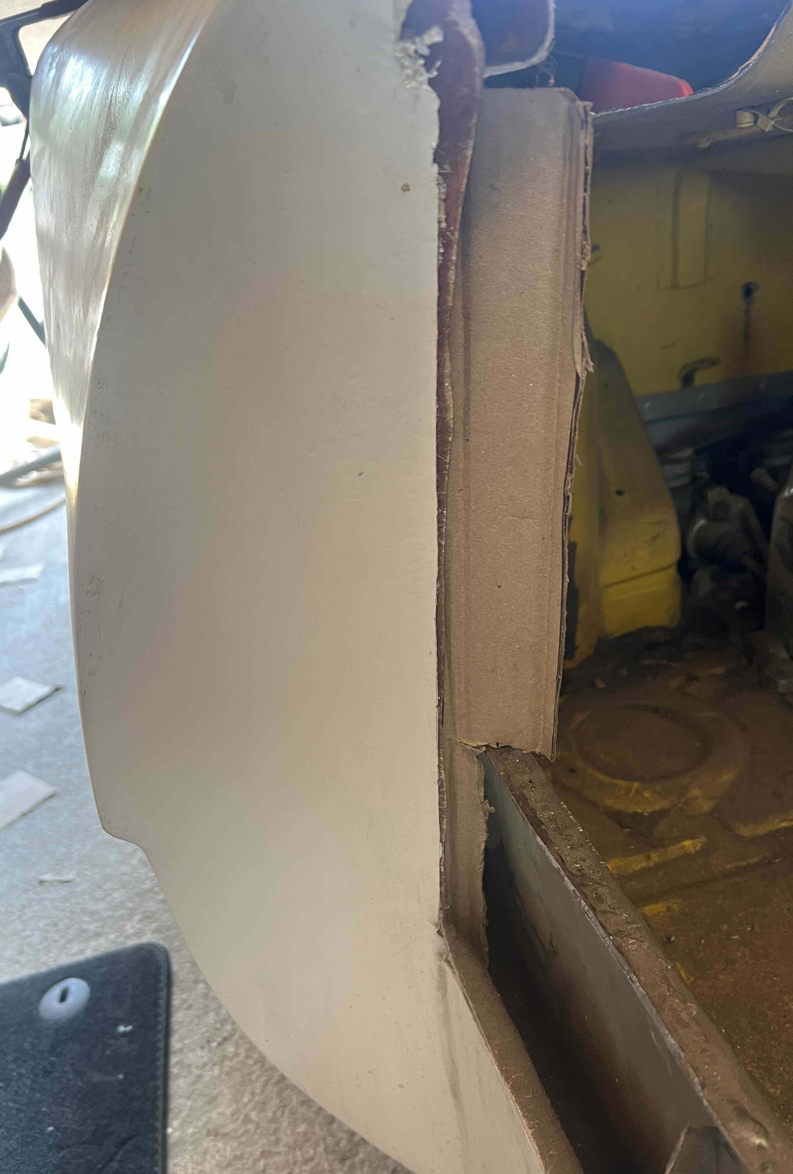

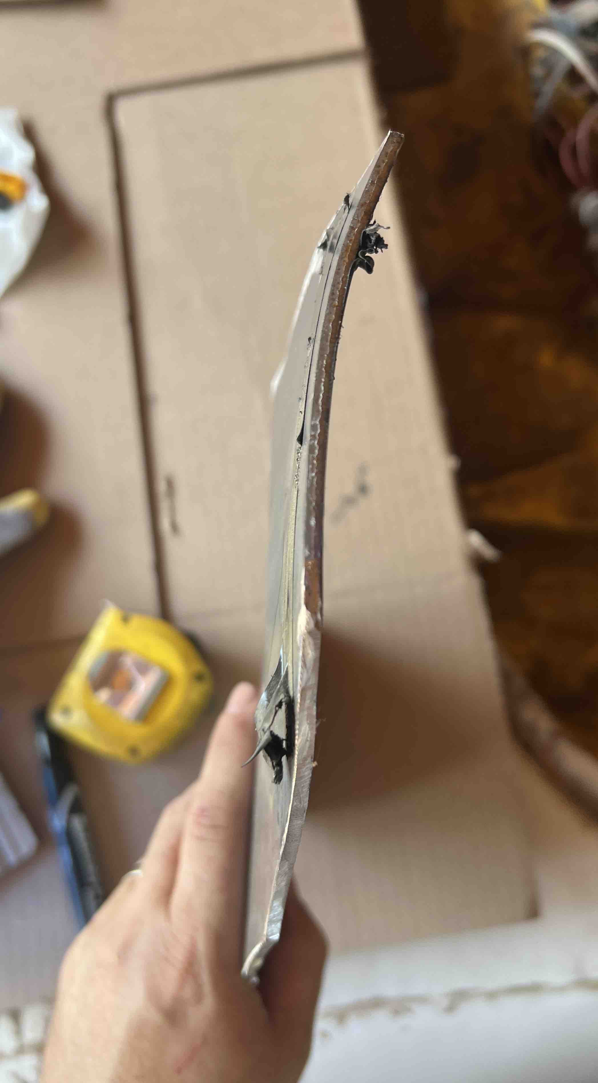

Today is shaping up to be as "went as planned" kind of day. I was able to cut the inner piece for the hinge pocket and it fits pretty nice. This will tie into the chassis at multiple points so should be strong. I was also able to make a piece on top of it that supports one of the main strong points of the body and this will weld directly into the chassis at multiple points so will provide solid support for the body.

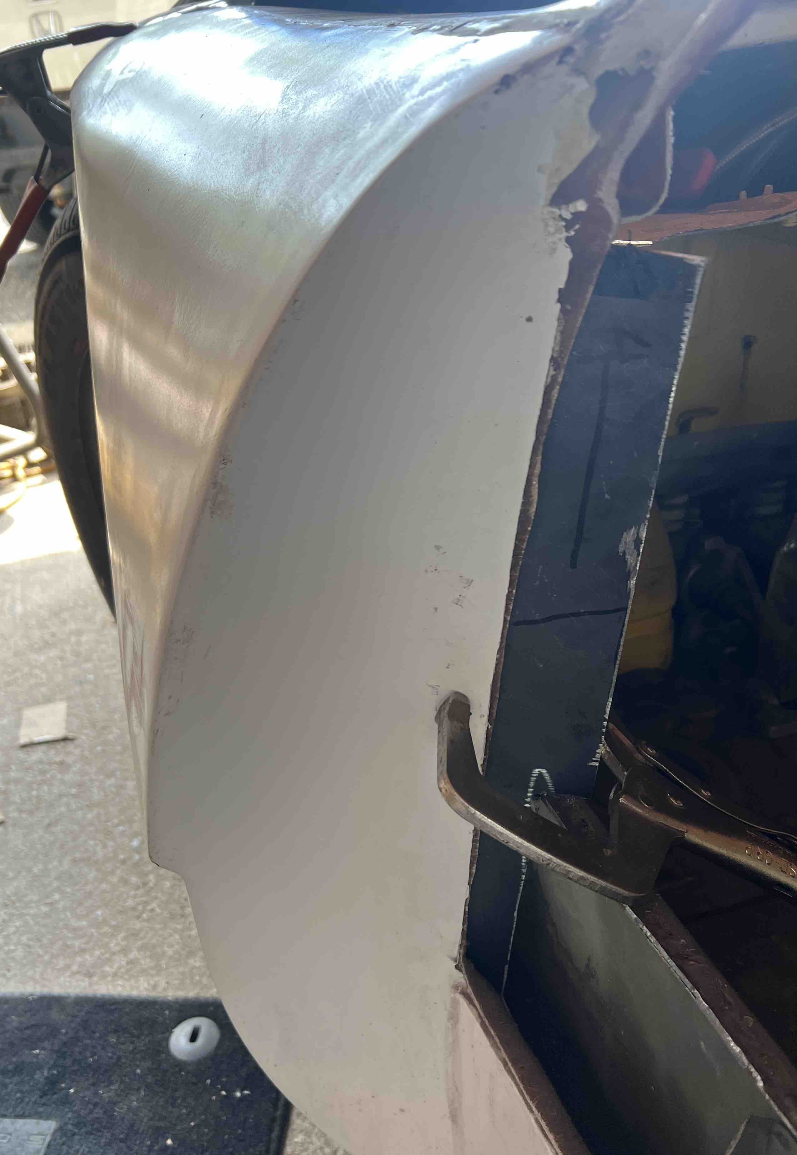

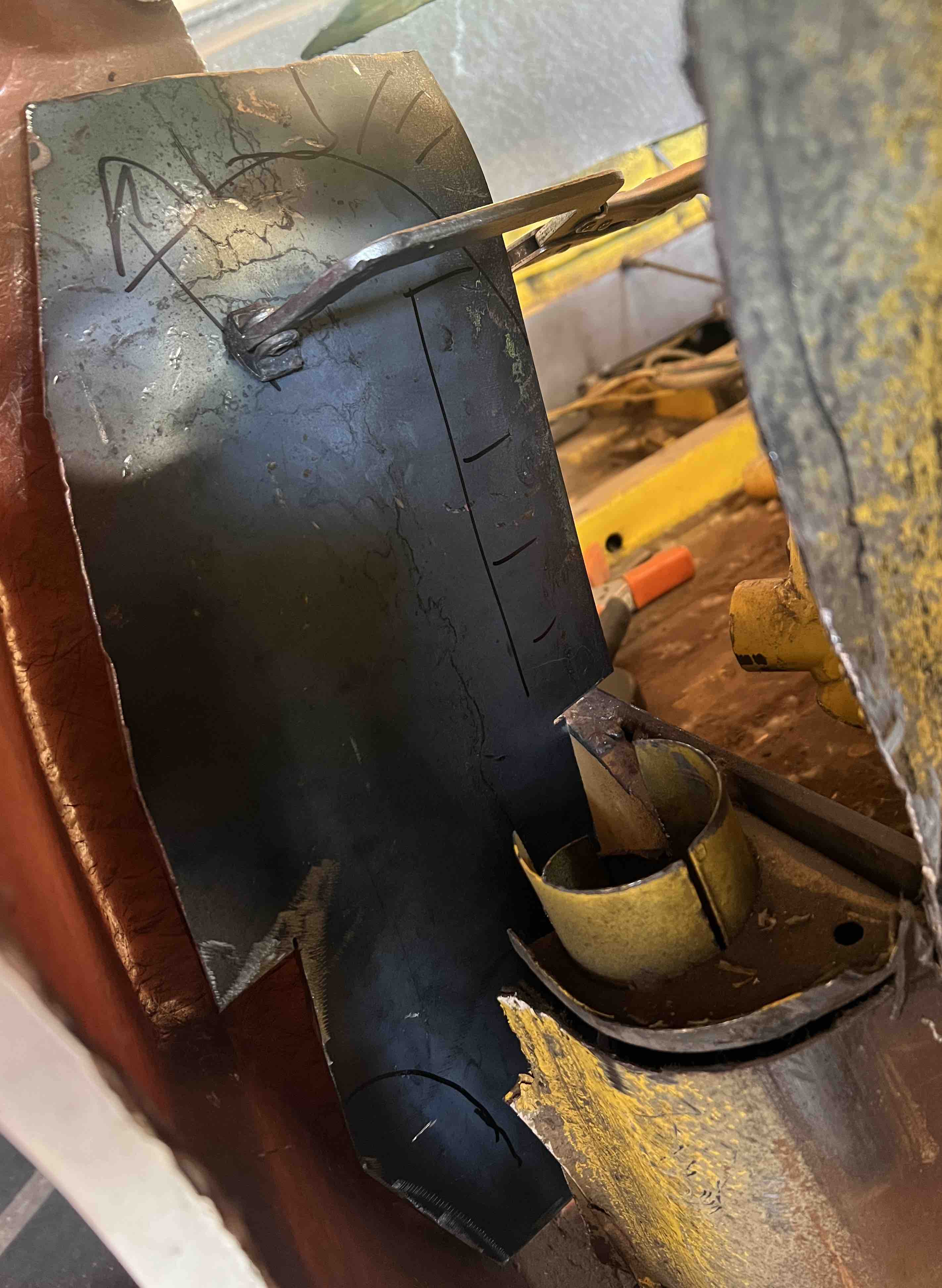

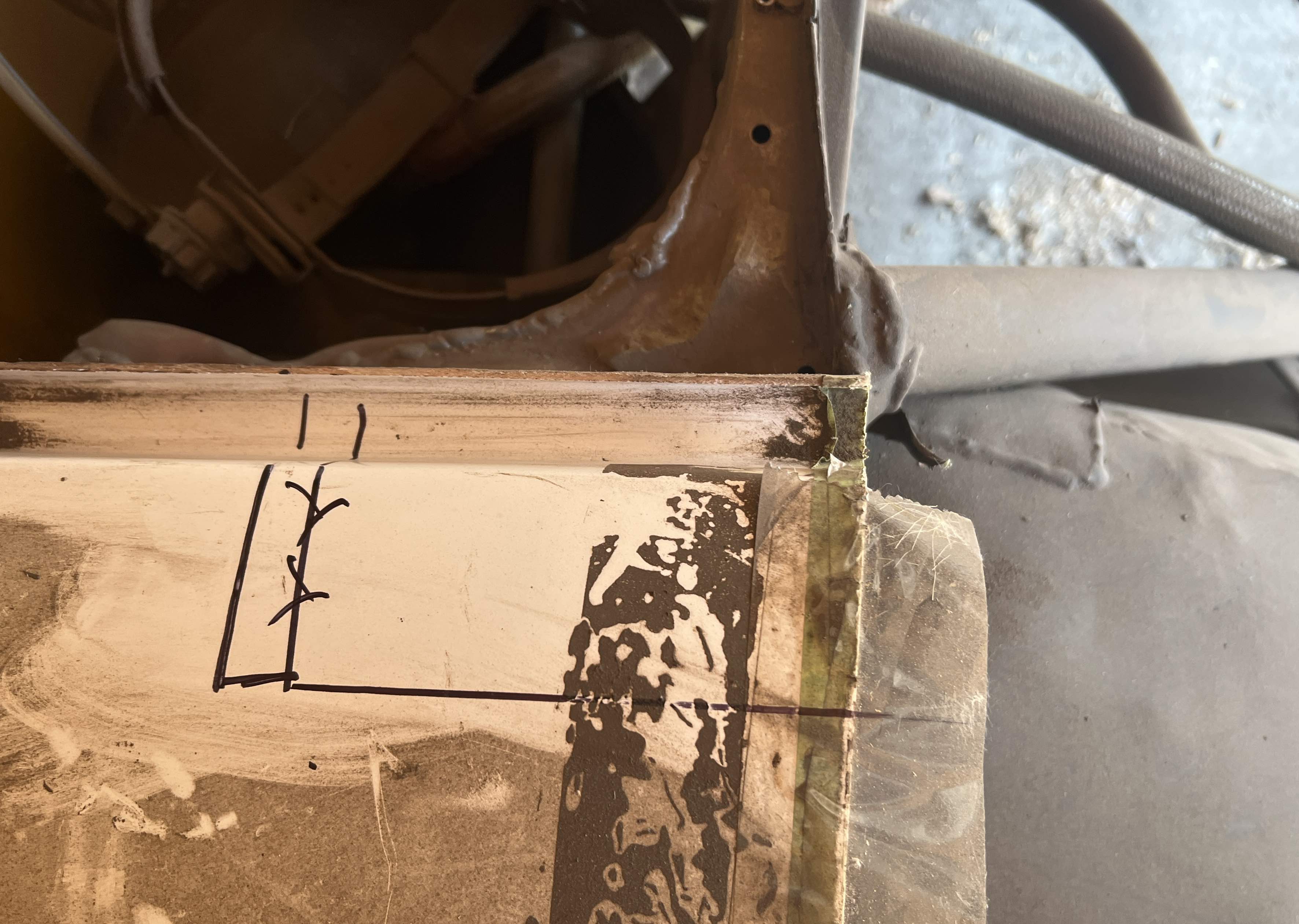

I wrapped up the week on a high note. It might not look like much but I got the body placed where I want it and made the two "ears" that go in the door hinge pocket. Shaping the thick 10 gauge steel has left with with sore wrists but I got it done.

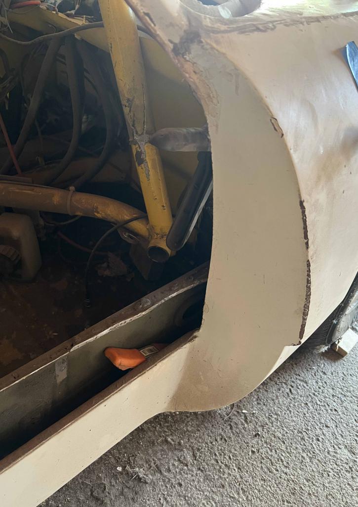

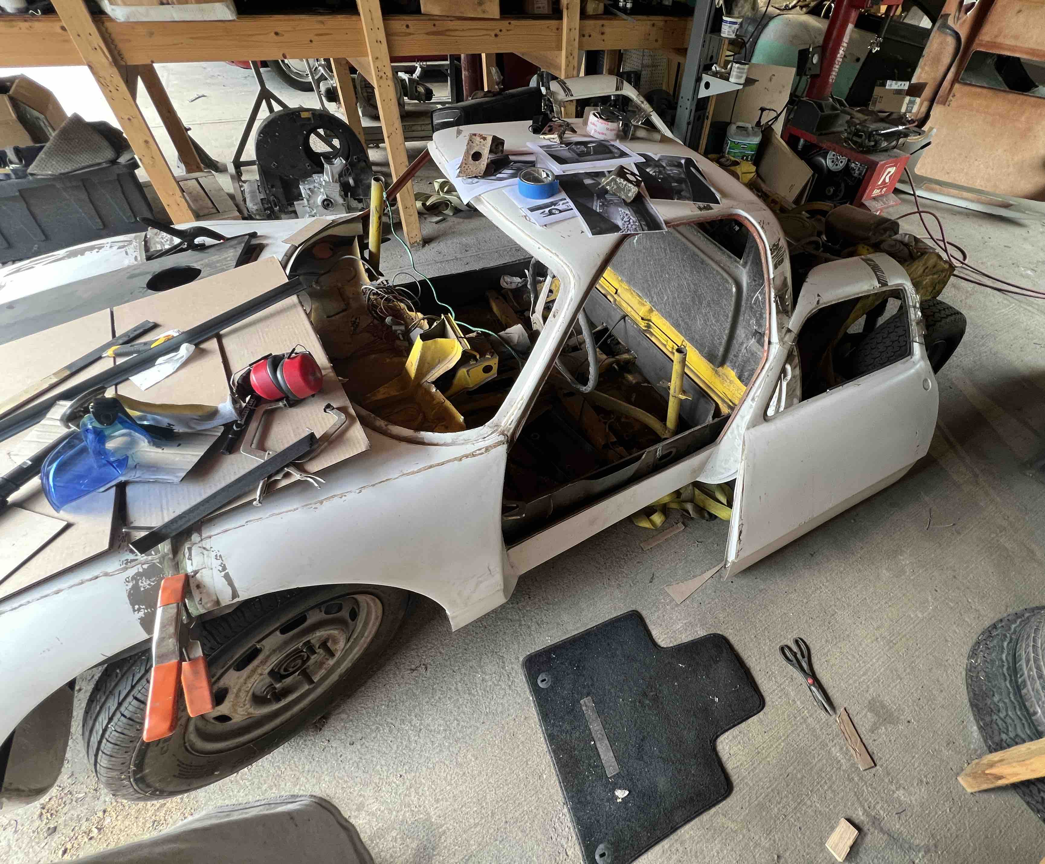

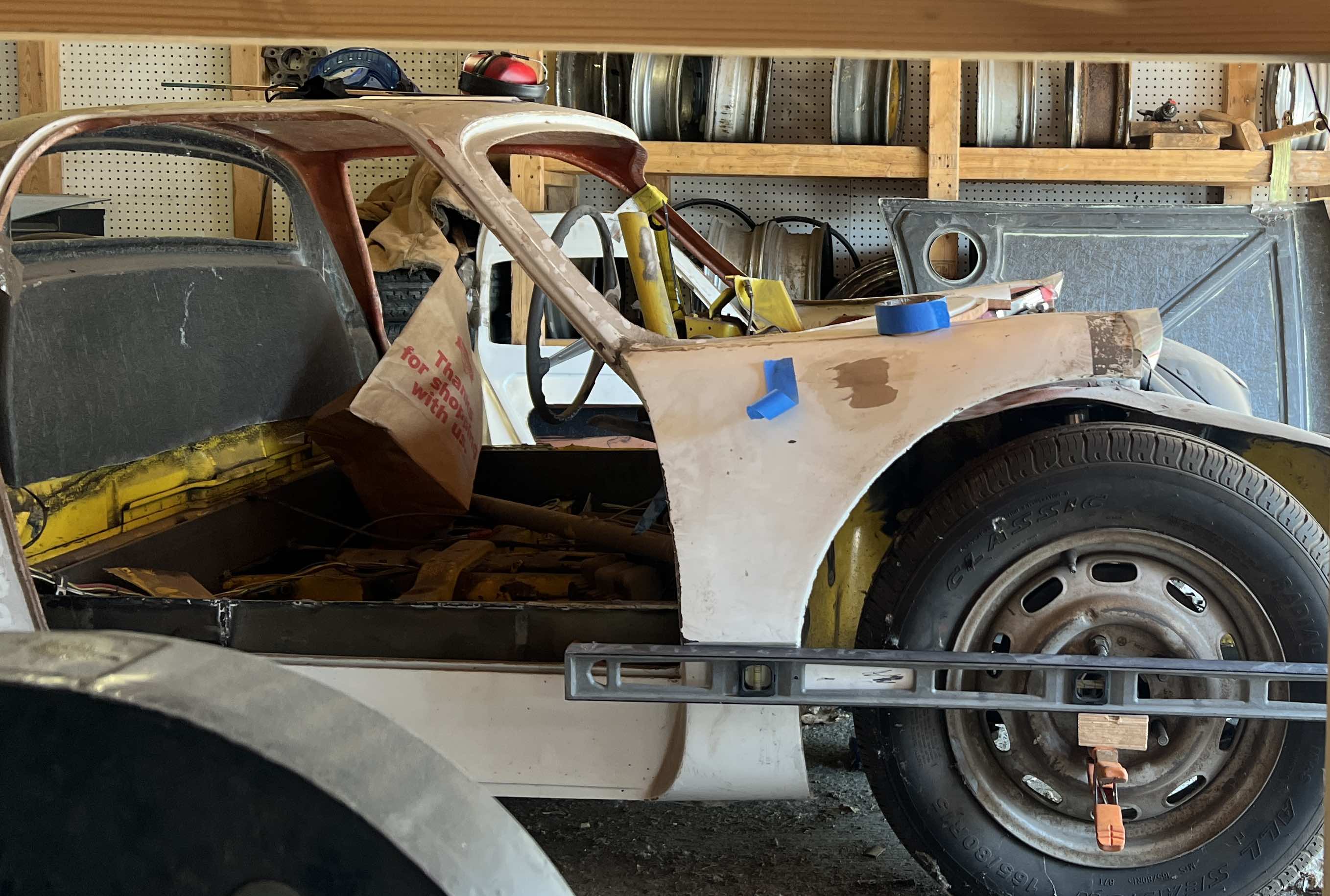

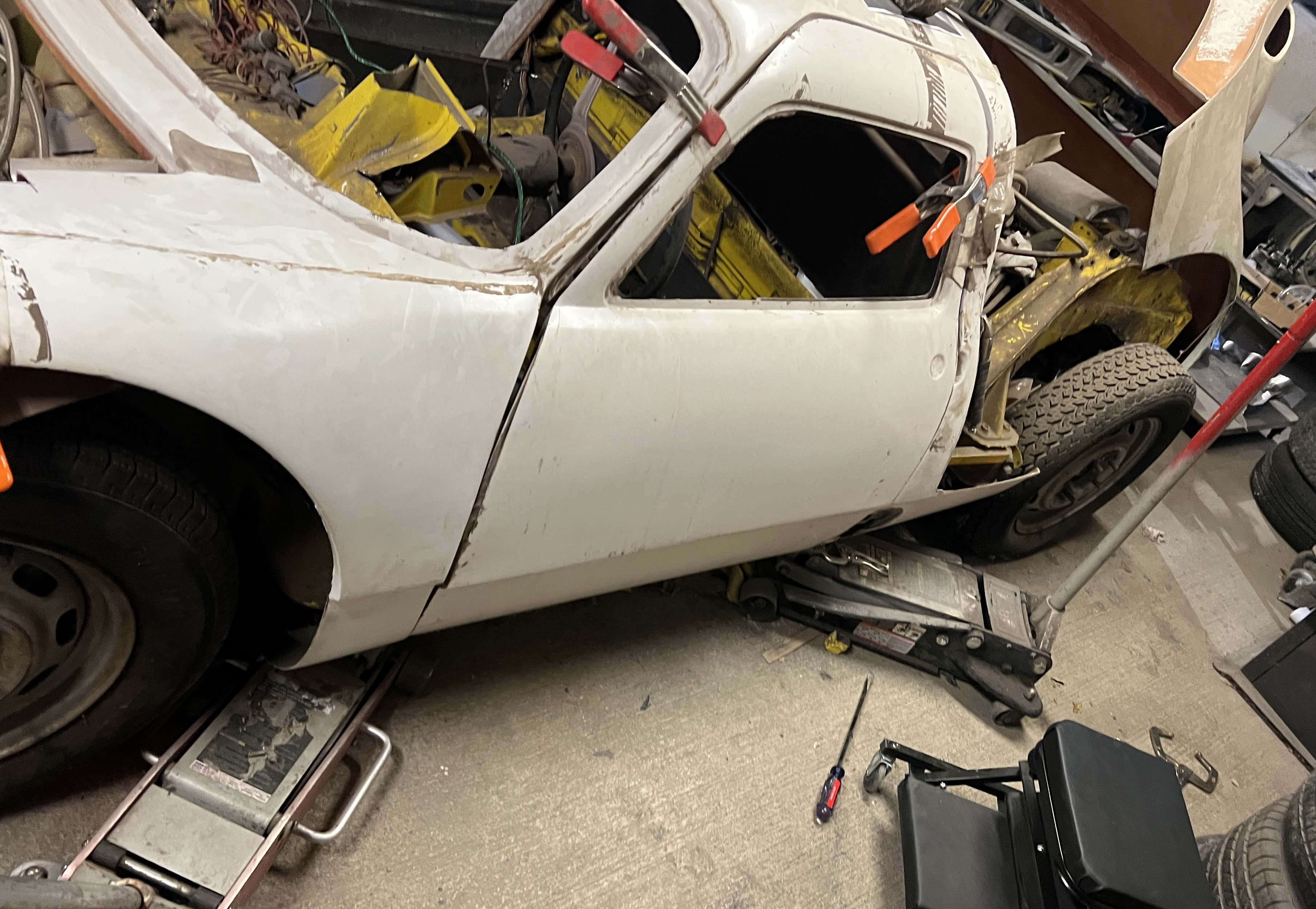

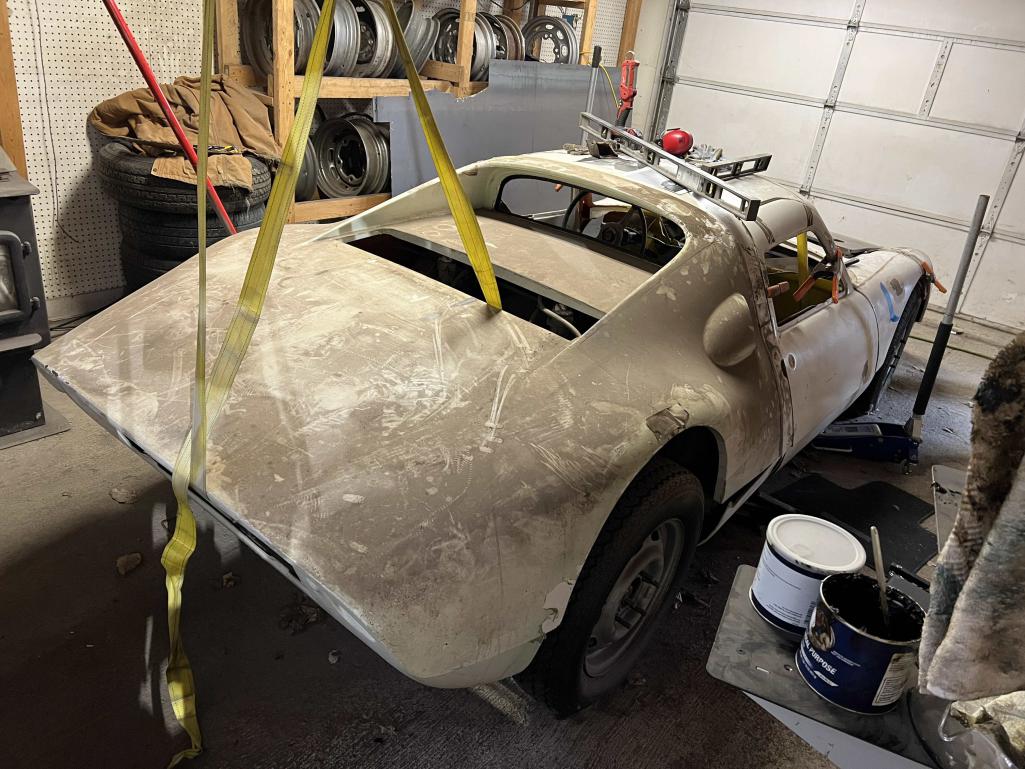

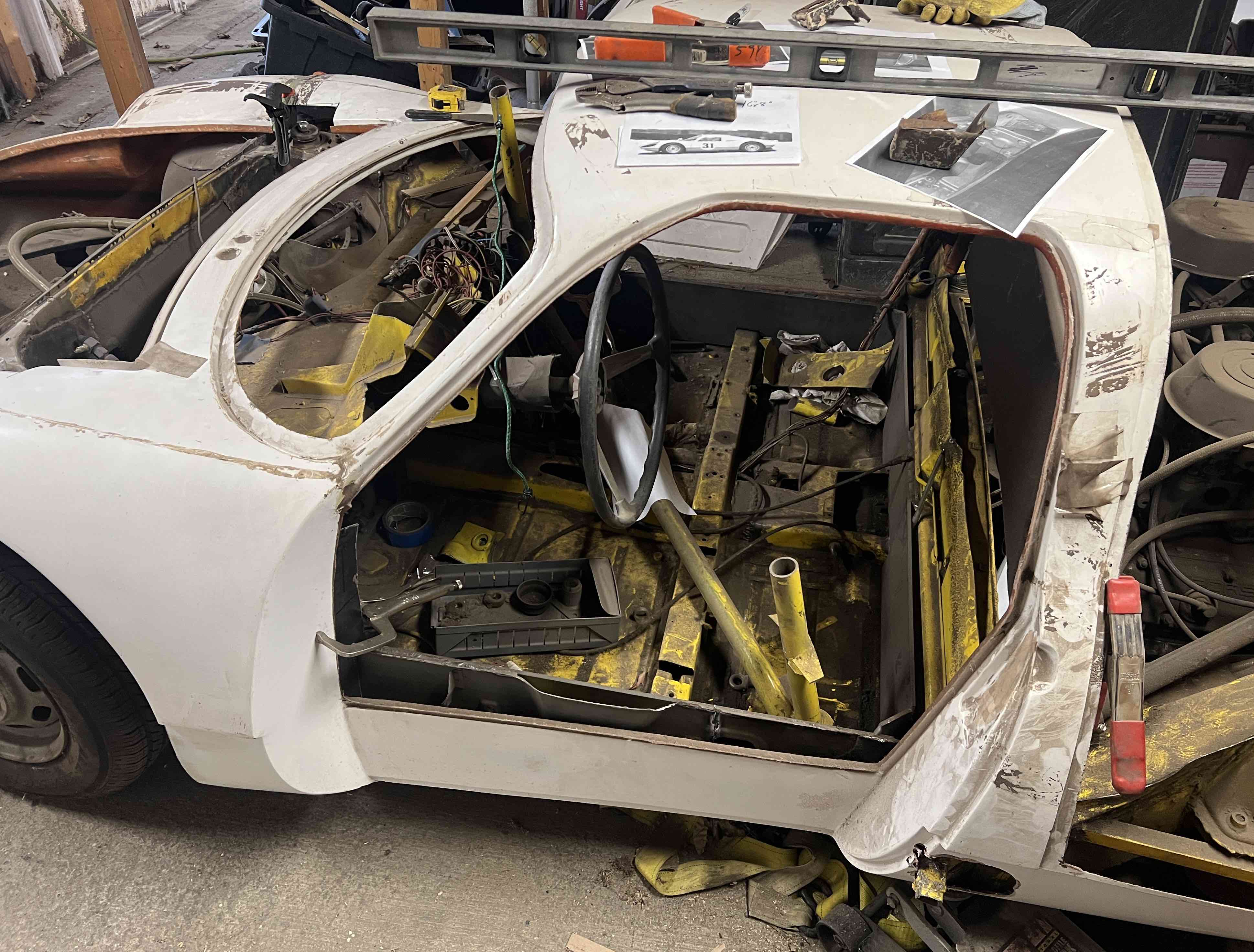

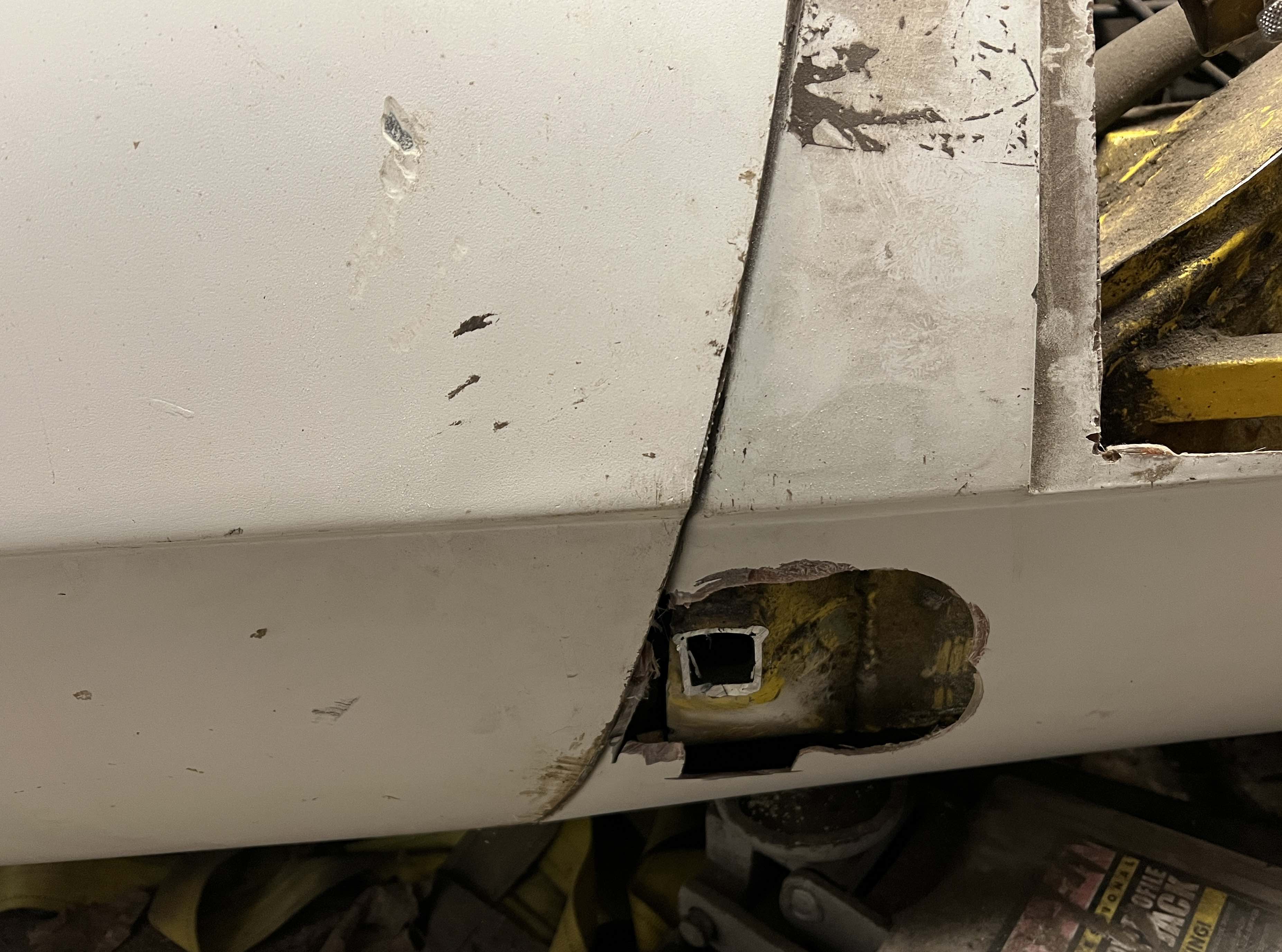

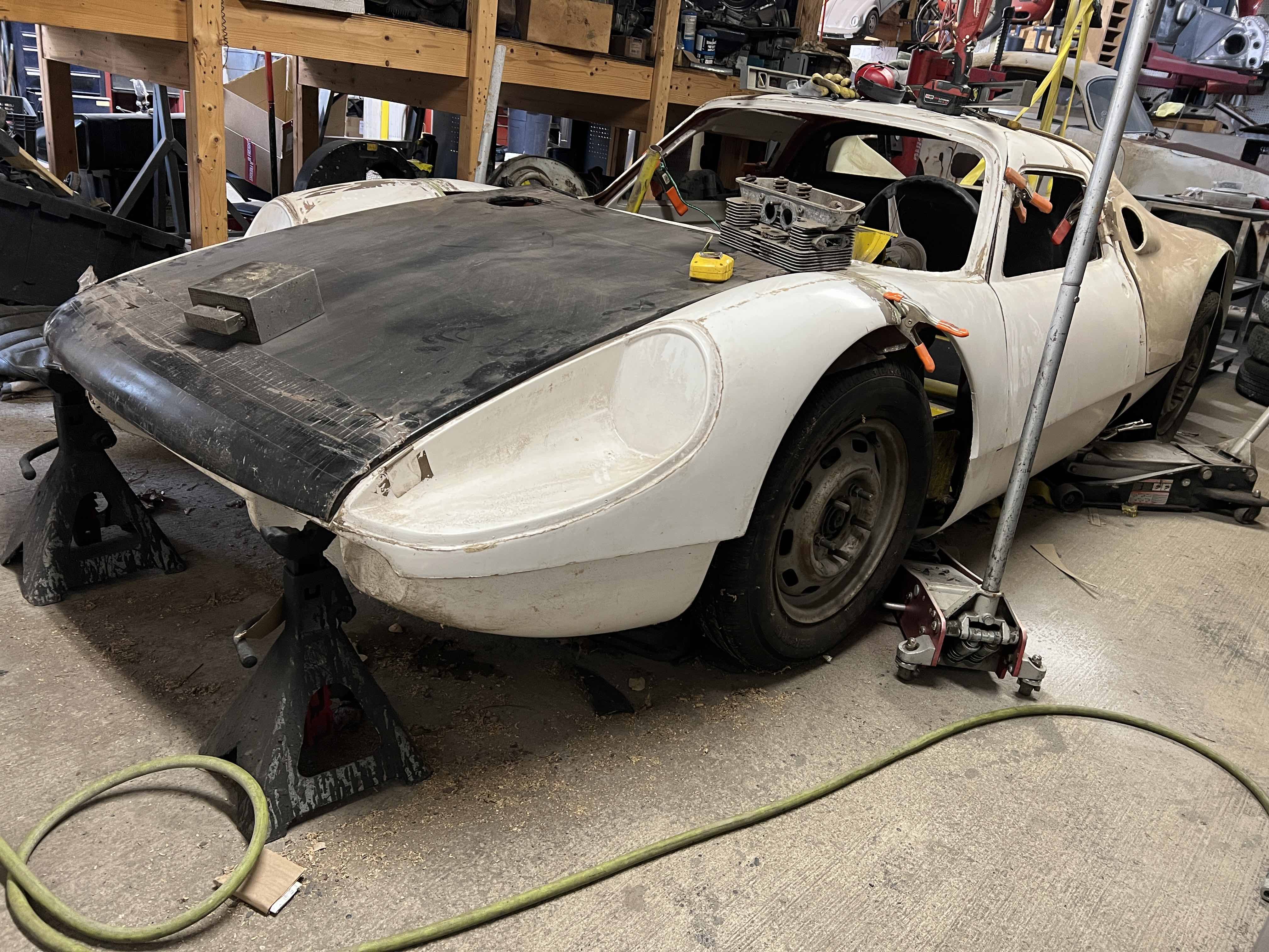

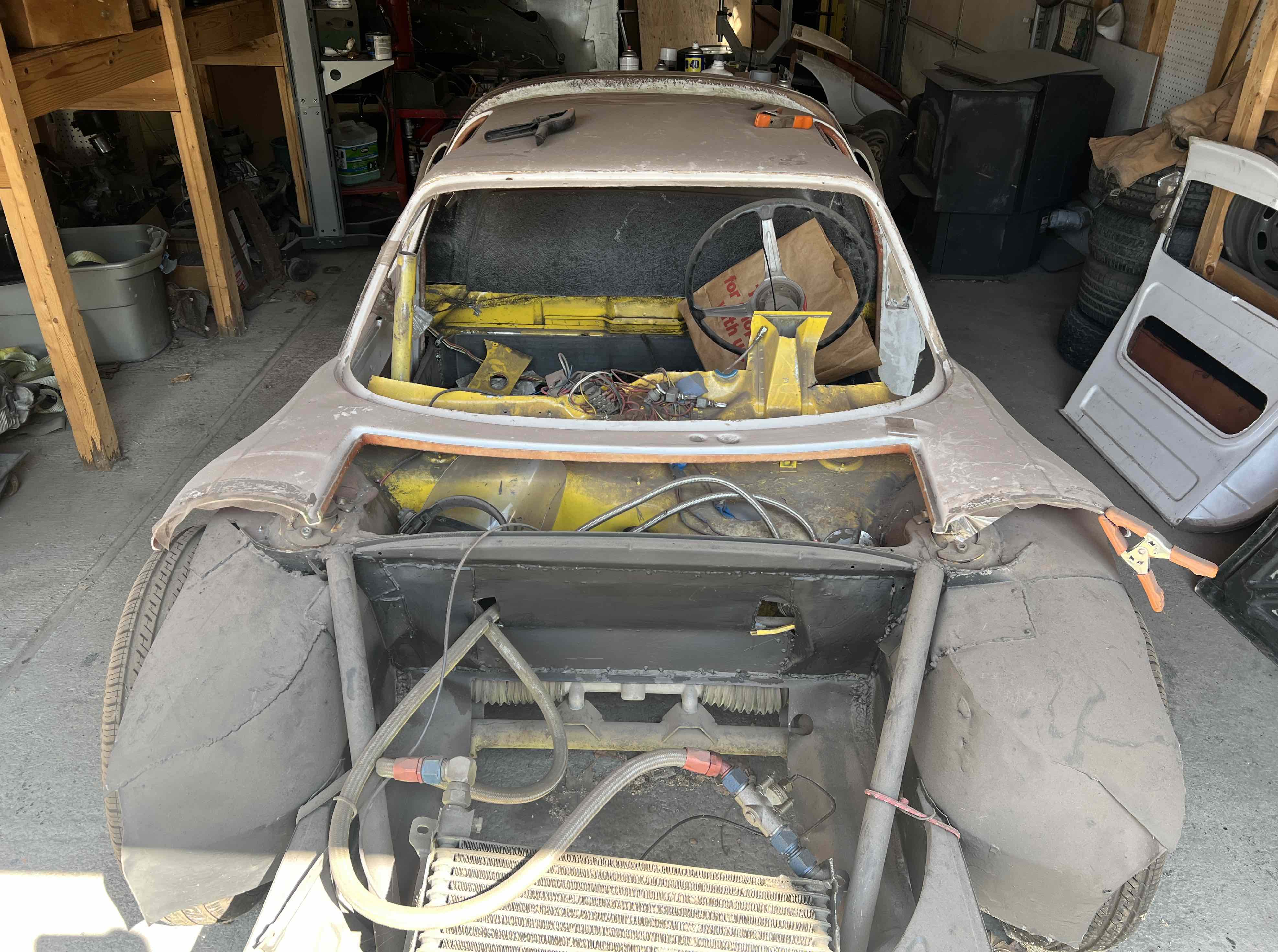

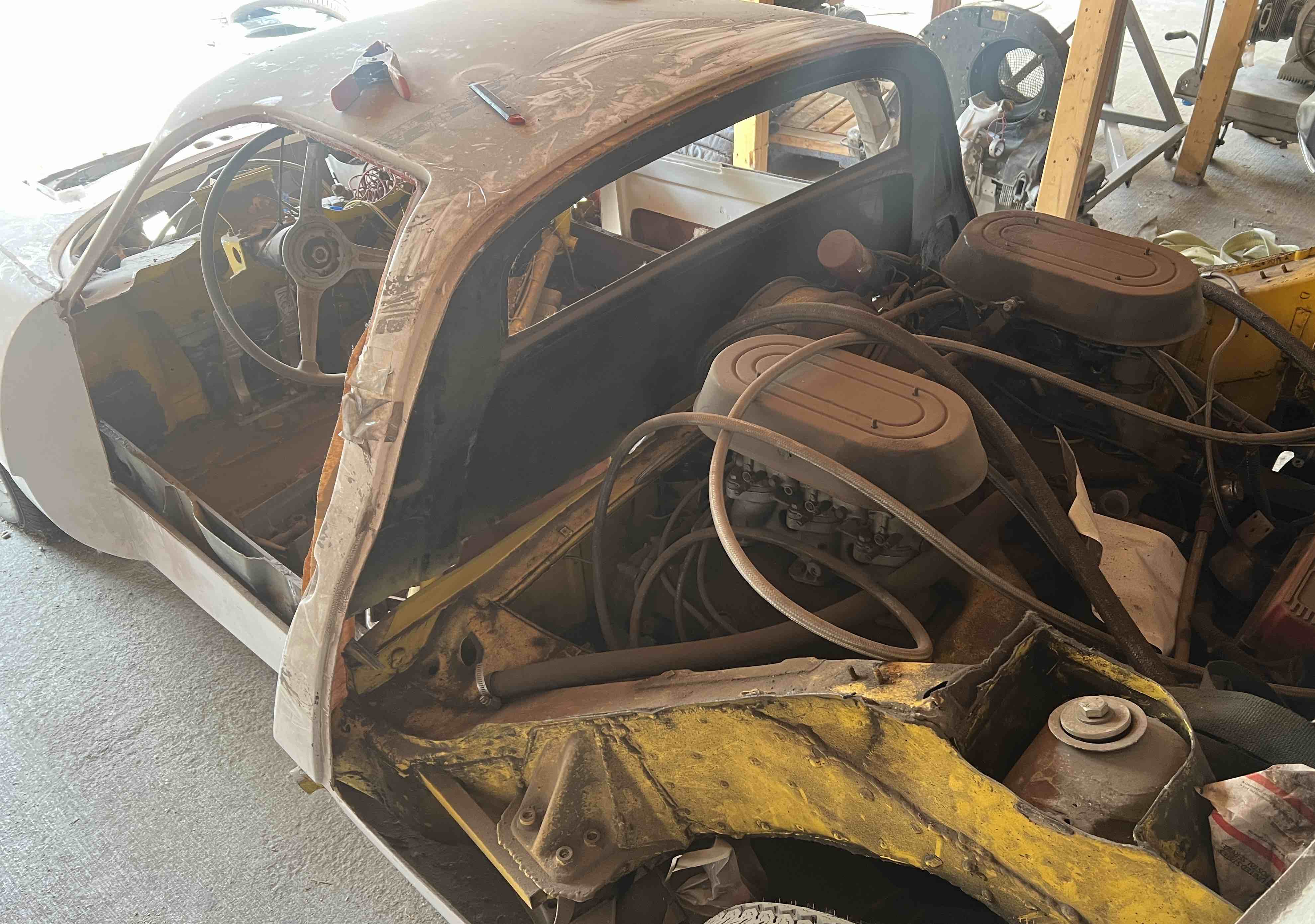

Ok, we just sold the last car of the selling season so the season is now done! This means we are now working on next years cars so the rush is off and I can focus on my own projects more. I've already starting making all the body mounting points but I first need to get the body in the right spot, checking wheel wells for uniformity, making sure the door fits, etc. All this is slow and tedious, but necessary. So the next few days will be tiny tweeks this way and that until everything looks good, then I can start the mounting.

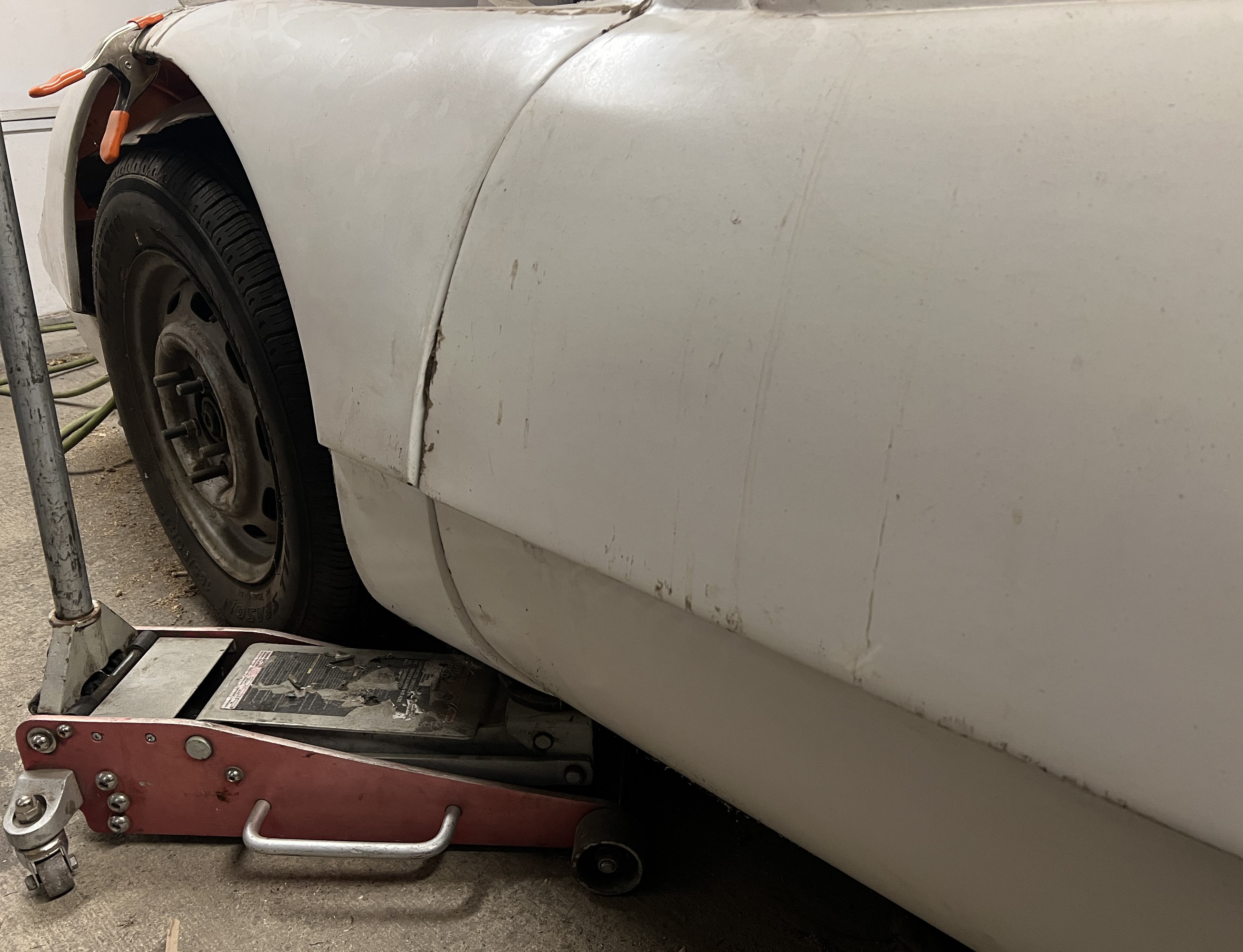

I also had to trim back the jack point but I really wanted to save it because one of the downsides of a fiberglass body is there aren't a lot of points to jack the car up from, just ask a guy with a real 904! So I think I will be able to retain the jack points.
Stay tuned!

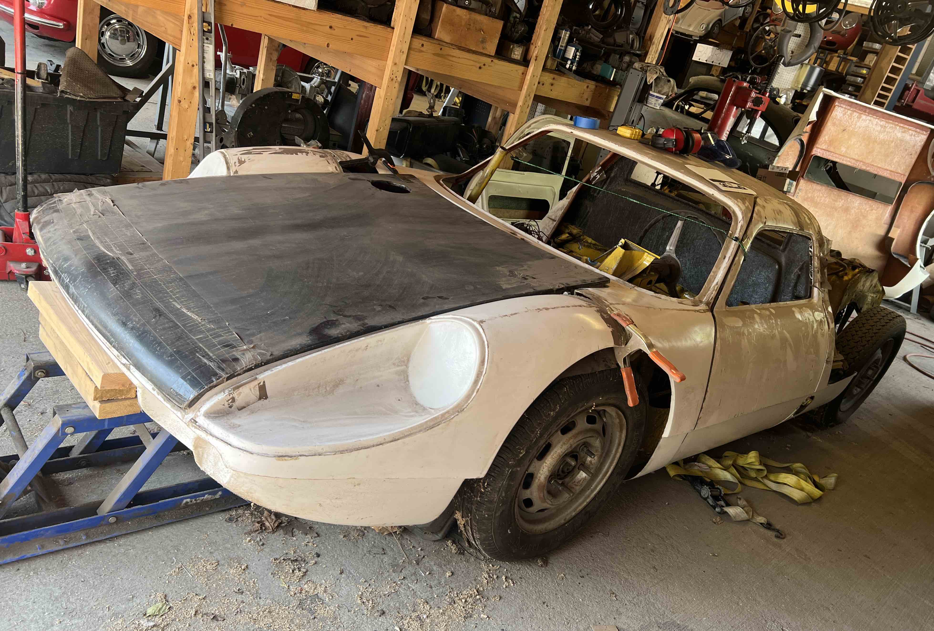

Ok, got to a good stopping point today, everything is loosely fitting, doors, hood, rear clamshell. Wheels are centered. I'm walking away for today but will put fresh eyes on it on Monday. I've found if you stare at something too much it helps to walk away and see what you couldn't see when you got too hyper-focused.
Feels good to be working on the car again.

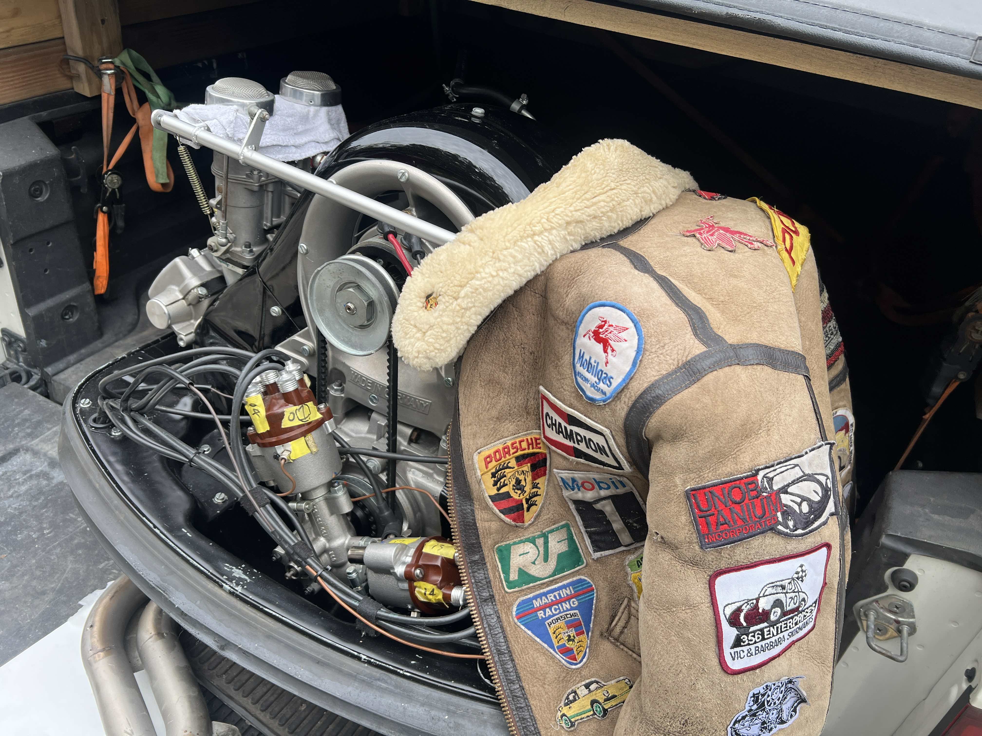

Inarguably, the most expensive coat rack I've ever bought! Will fit nicely in the 904 build. 587/3 4-Cam Carrera.
