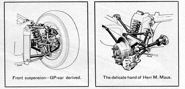

I'm already looking into changing the front suspension, one of the pitfalls Chuck Beck pointed out was the height of the shock tower in relation to the lowered hood line of the 904.

I definitely thought the macpherson strut set-up would create a problem being too tall. I would also get rid of the torsion bars system. maybe look into a mid-1990s Honda Civic unequal length double wishbone suspension.

Or substantially shorten the strut and use shorter inserts. Then you could lower the shock tower. Could be done, though not for the faint of heart ...

Not too difficult, did this on my 242 to run Koni Race inserts...shortened the strut assembly 3".
