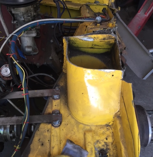

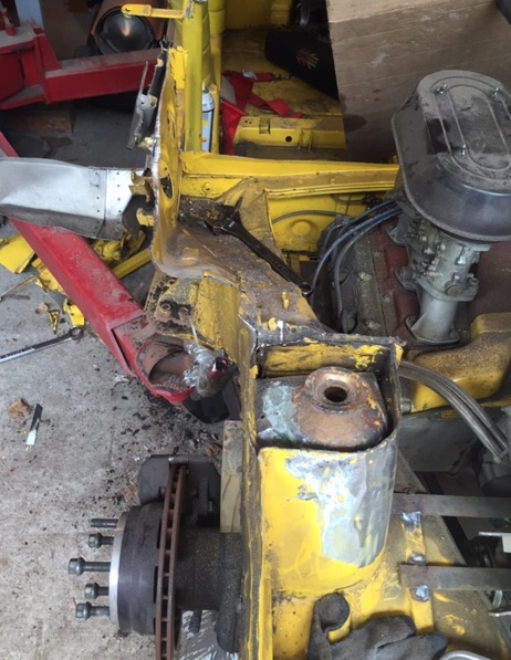

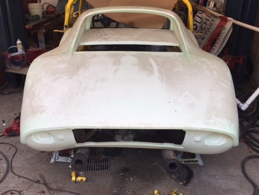

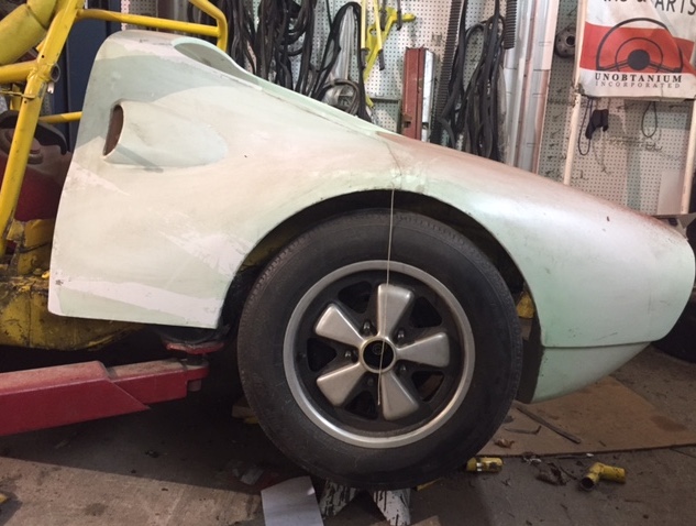

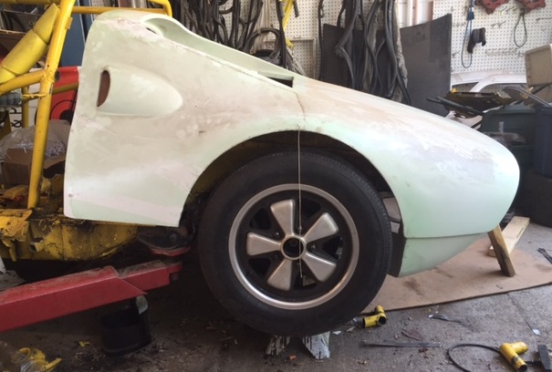

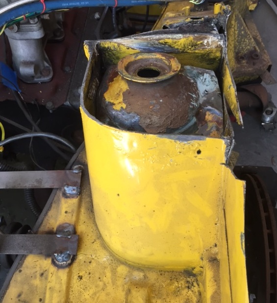

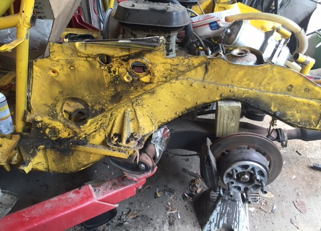

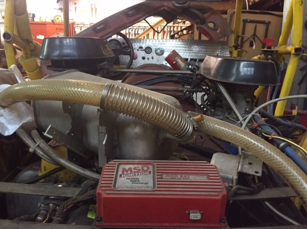

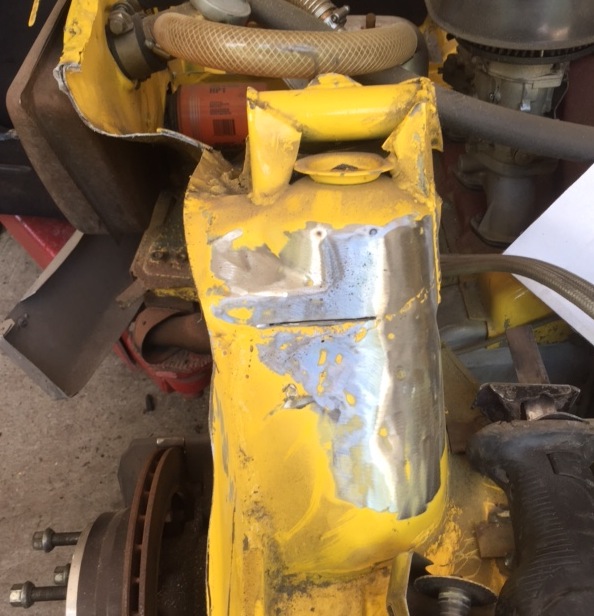

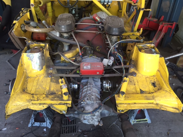

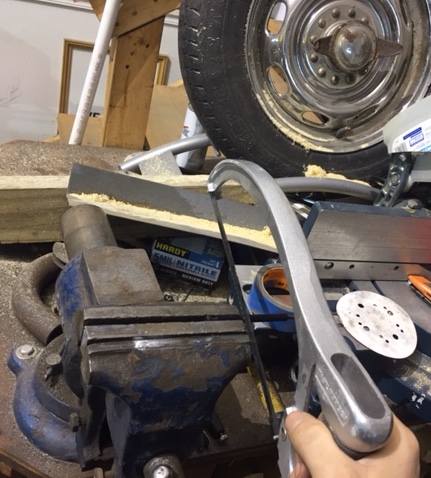

Found some time yesterday to get some cutting done. I was able to start playing with lowering the rear shock towers. The side oil tank might be a problem. I was hoping to leave it alone but it looks like I might have to move it inwards, so the rear body work can clear. I ran out of day, but at least I got some time in.
Attached Image Attached Image Attached Image Attached Image Attached Image Attached Image Attached Image Attached Image

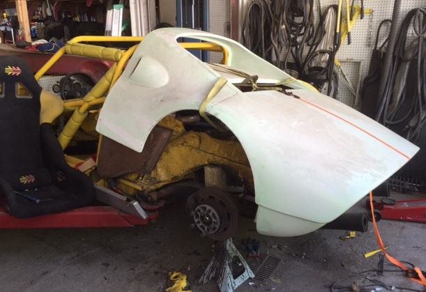

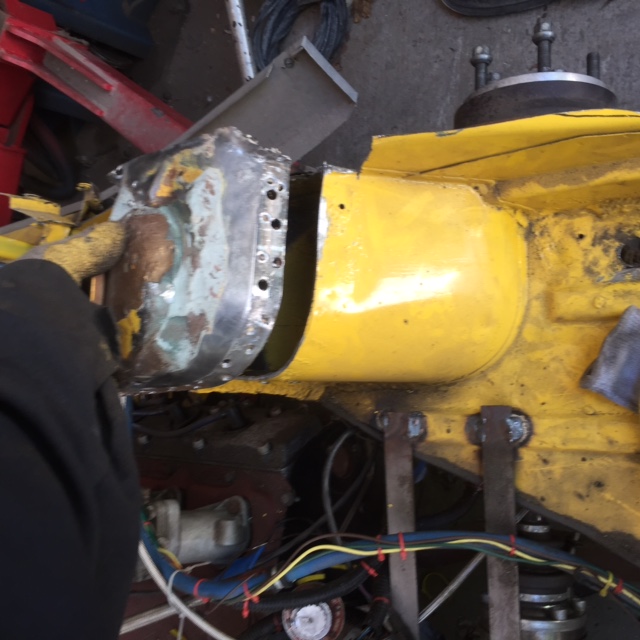

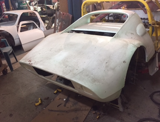

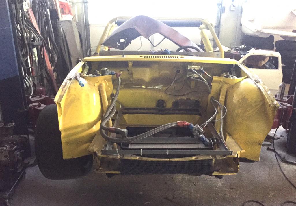

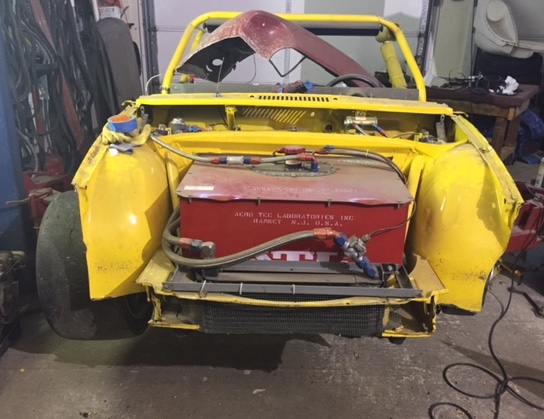

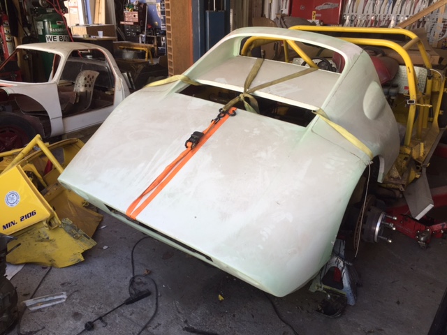

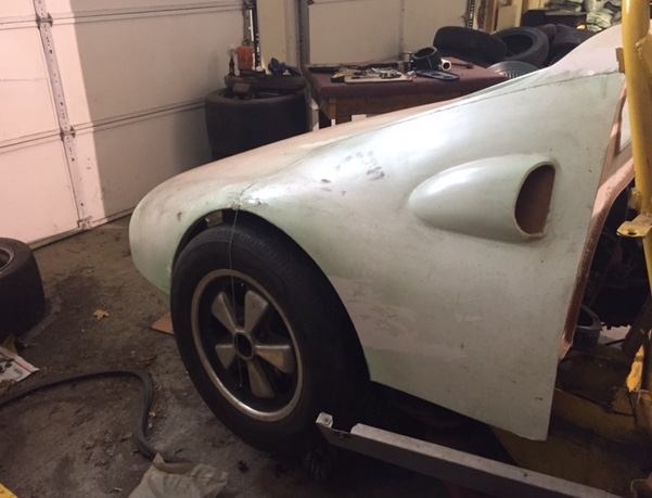

I broke away from getting cars out the door and spent part of yesterday and all of today fitting the tail. I was hoping to get away with not having to move the oil tank, but it was just in the wrong spot, so it is now moved.
I had to do some more trimming on the rear and the Supertraps were at the wrong angle, so I removed them for the time being. I'll either modify the angle later or get new ones. My new problem is the rain hats on the carbs are too high. I played around with ideas and I think the simplest thing to do is take off the velocity stacks and cut down the air filer, lowering the whole rain hat, it's worth a try anyway. The worst that could happen is I ruin two air cleaners.
It was good to get back on the project, the 550 build was sucking up all my extra time.

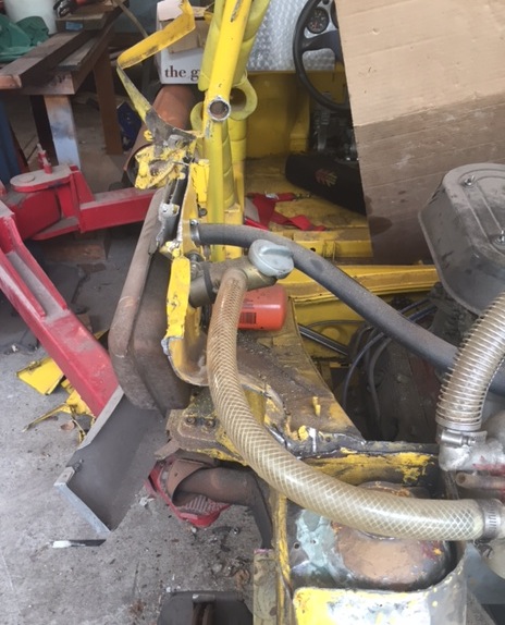

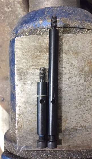

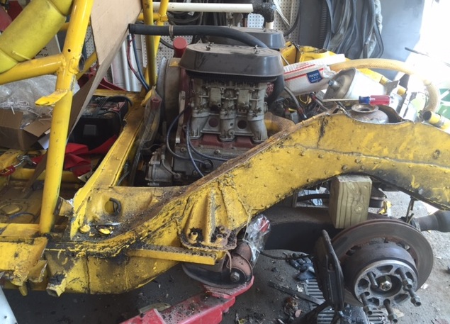

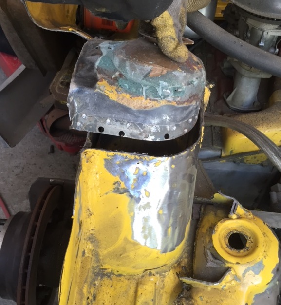

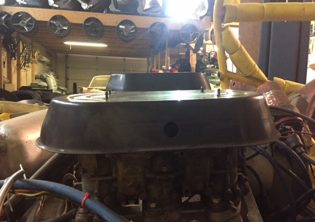

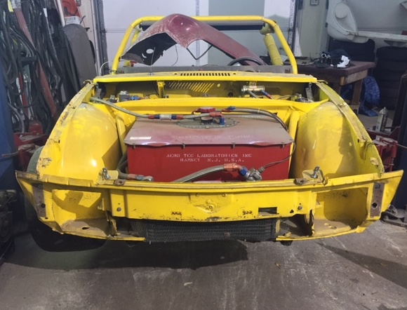

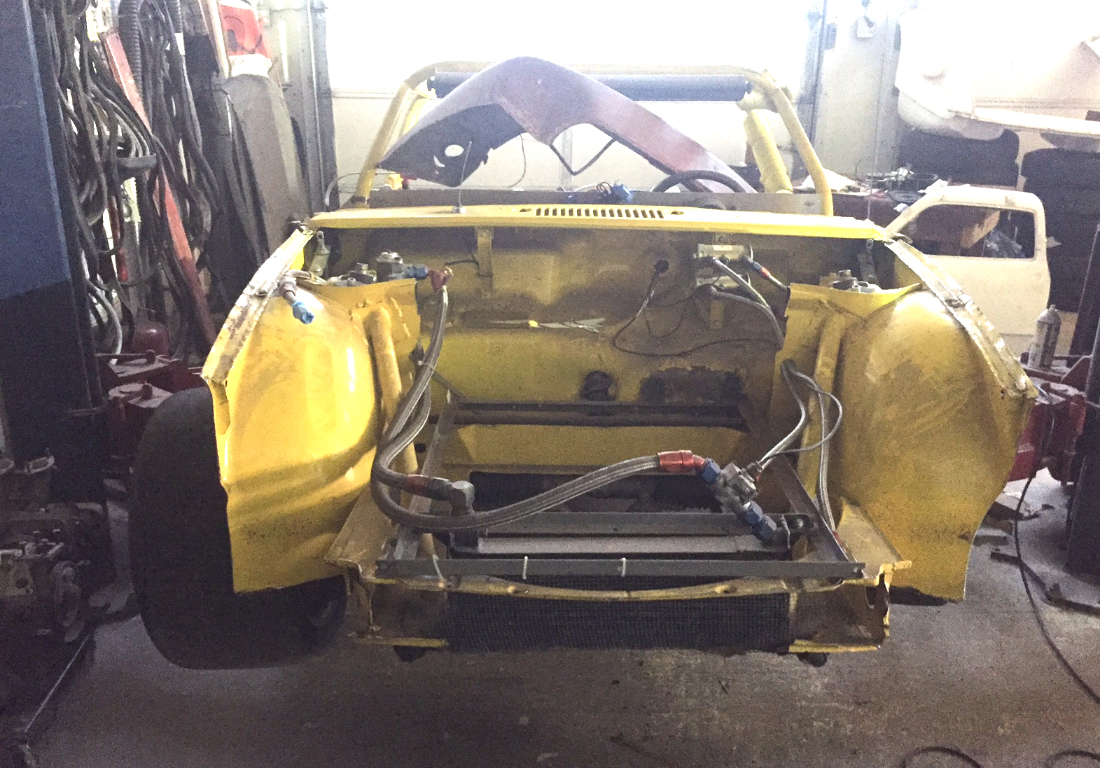

My latest hurdle was once I got the rear end dry fitted it was sitting too high. I couldn't lower the motor and I didn't want to give up running Weber's so I consulted with my mechanic on what my options were. After putting our heads together we decided if we took out the velocity stacks we could lower the rain hats. While I would lose a few horsepower the car has plenty to spare. Once decided on this course I had to figure out how to do it. I cut the K&N filer in half and it fit well and then I took the studs the rain hats sit on and trimmed them. This involved hacksawing and JB welding. Once I prove this as a working system I will probably get K&N to make me the correct height air cleaners and maybe make better rain hat studs, though these may work. With that done the rear end was fitting at a much better angle. The other option we toyed with was running the velocity stacks out of the body like a 906, but with the rear grill it would have been awkward.
Once this was done I started on cutting the sheet metal off the front but ran out of day. Tomorrow will be a little dull, it will take me awhile to dis-mantle the fire suppression system and take out the fuel cell. I don't think the out-dated fire system will be missed and the fuel cell is huge, like something you would need to run the Dakar Rally. I figure after lunch I can start getting the rest of the sheet metal gone and hopefully if I'm real lucky I can pack up and get the shocks off to Elephant Racing for their haircuts. After that I'm out of time, hitting the road again on Monday, picking up a very cool and rare 356, so rare I've never had one like it before.
Attached Image Attached Image Attached Image Attached Image Attached Image Attached Image Attached Image Attached Image Attached Image Attached Image

Ran out of day and the fire system took some slow brain work to figure out how to get it out. It was still fully pressurized so I didn't want a face full of Halon. It came out in one piece, I'll take it to Hershey this year to see if anyone can't live without it. Also got the massive fuel cell. The rest of the day was taken up with measurements, figuring out where to trim the front and how much can be saved. When I chopped the test body I wasn't really thinking about how much to leave since I just wanted to see if the body would fit. Now that I want to save as much of the original body as possible and want to save as much structure as I can the cuts are getting much more deliberate and surgical.
