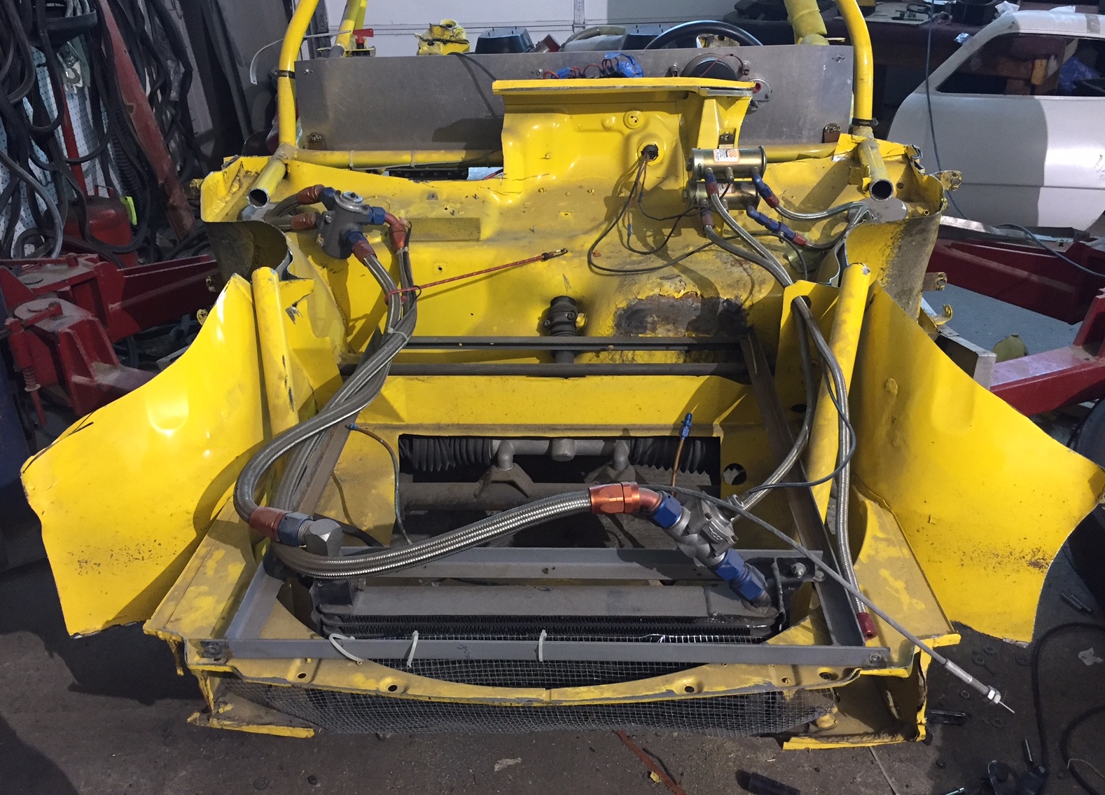

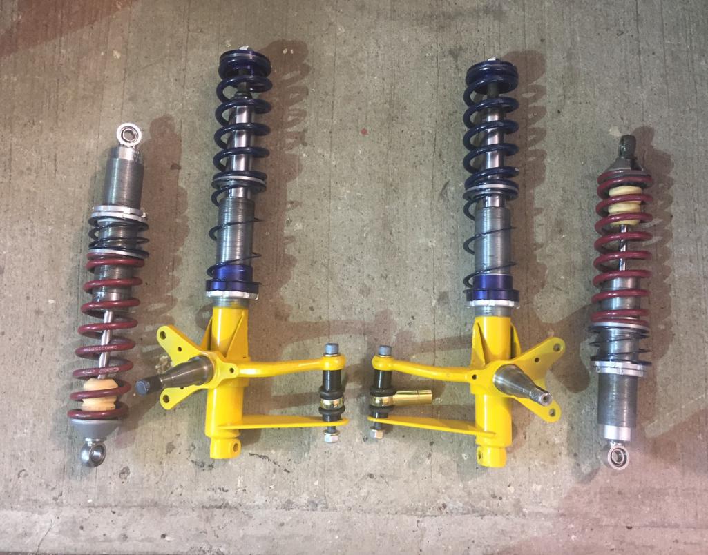

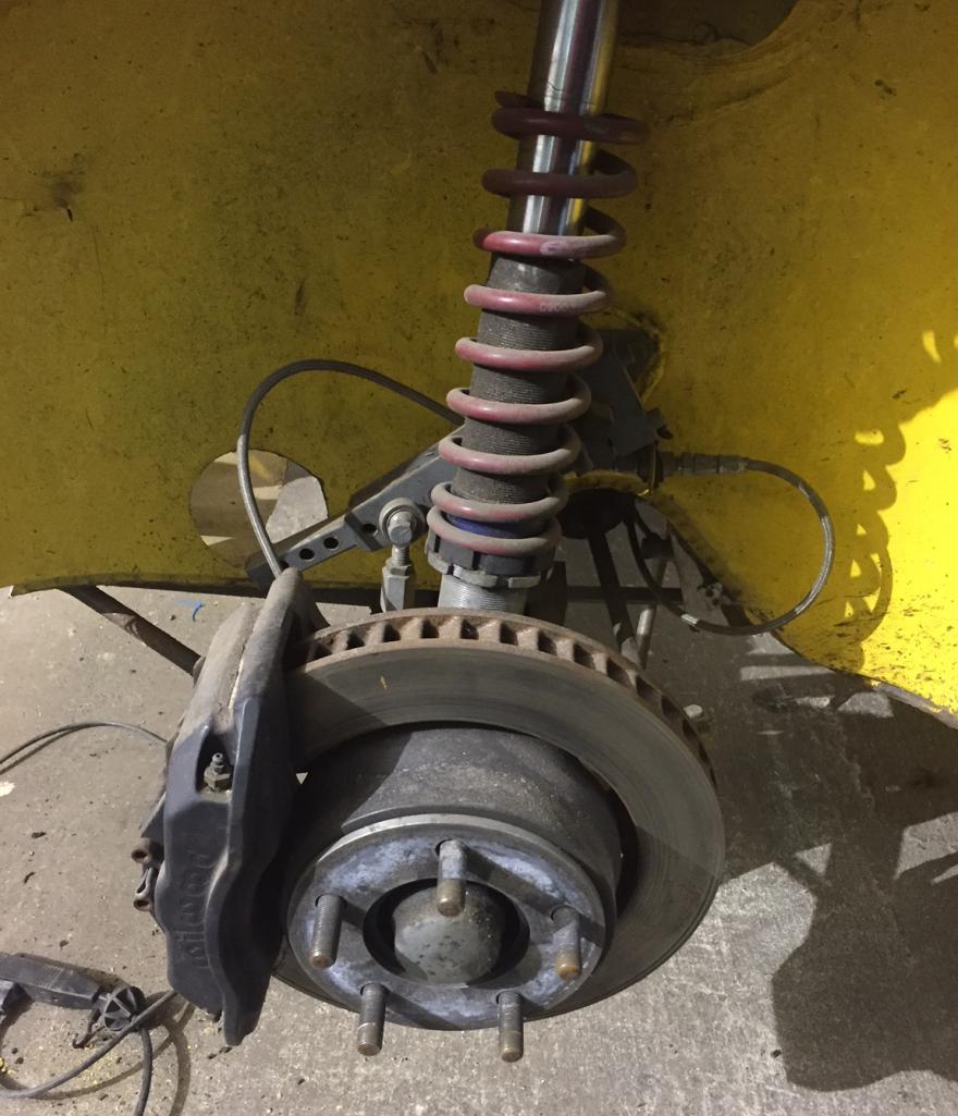

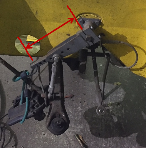

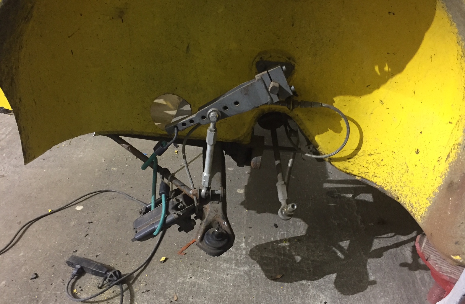

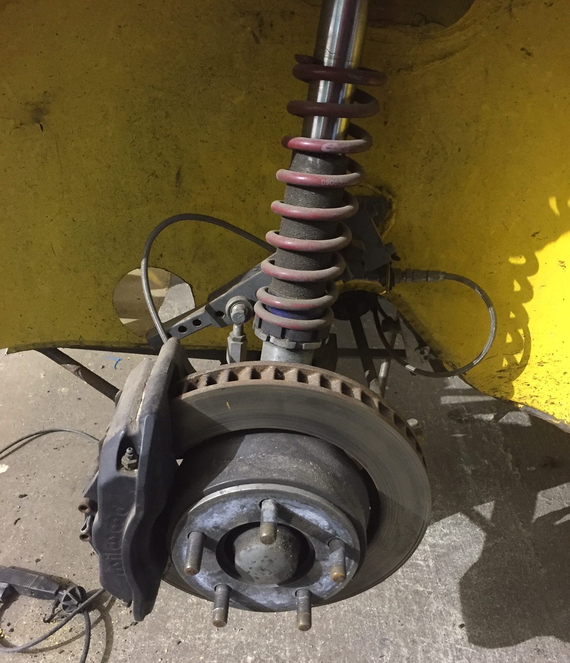

Didn't get as much as I had hoped done today but I did make some progress. First I removed the front struts so I can send those and the rears off to Elephant Racing to get them all shortened. Once I got that done I started trimming the fenders down to accept the new body. I will probably have to do more fine trimming once I get the body closer but this was a start. I was hoping to get both fenders done and the front cowl/dash cut out, but like Mick Jaggers says, "time waits for no one, no favors has he, time waits for no one, and he won't wait for me."
The day is done.

Adam-if you wouldn't mind measuring, about how long is that sway bar arm?
Is Elephant shortening the Bilstein or swapping to a Koni 8610/11 of something with a shorter body?

QUOTE(jd74914 @ Jan 12 2017, 01:25 PM) *
You mean the up and down arm?
They are modifying the existing bilsteins. I'm not sure what all they are doing. Basically he told me 2" would be pretty easy, 3" would be tricky, they can do it but don't complain about the bill. (IMG:style_emoticons/default/happy11.gif)

QUOTE(Unobtanium-inc @ Jan 12 2017, 05:08 PM) *
I think so? I marked it on this picture.
hahaha Interested to see what they come back with!

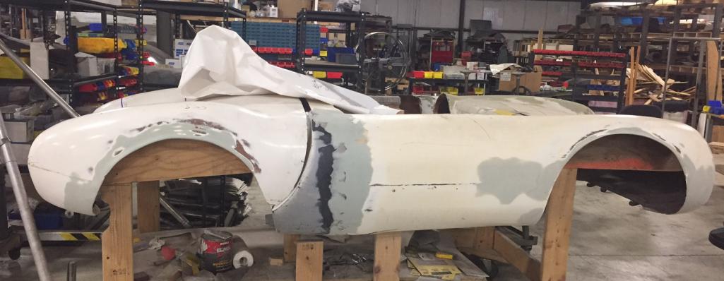

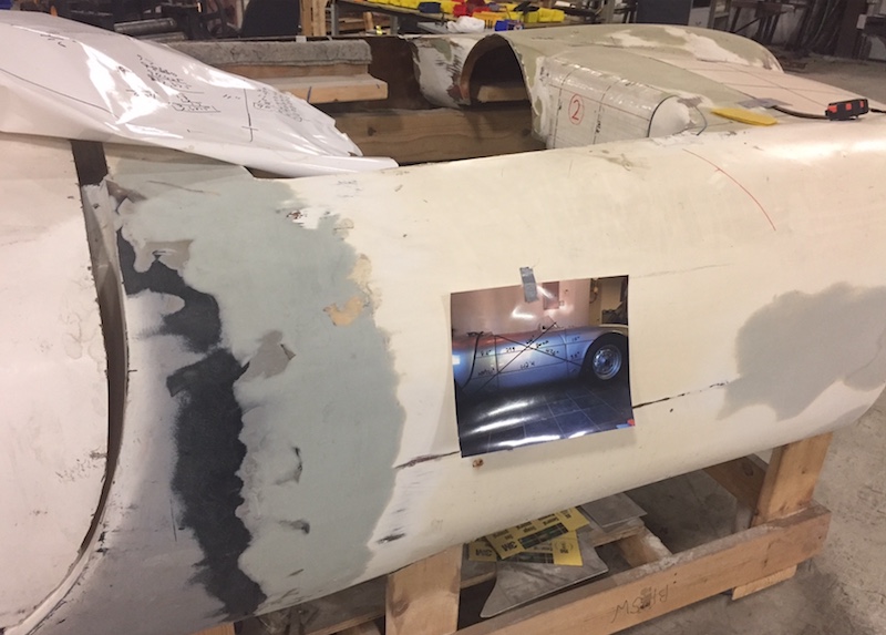

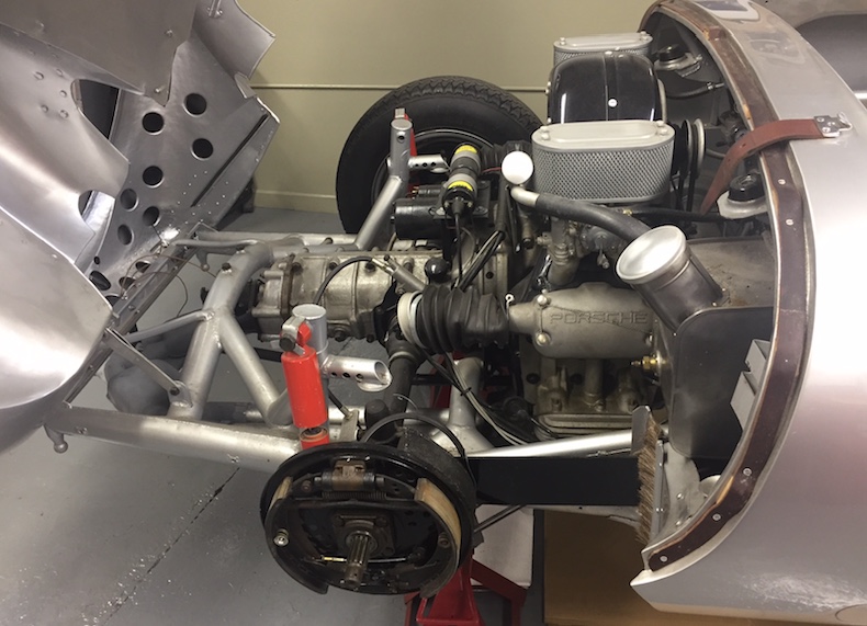

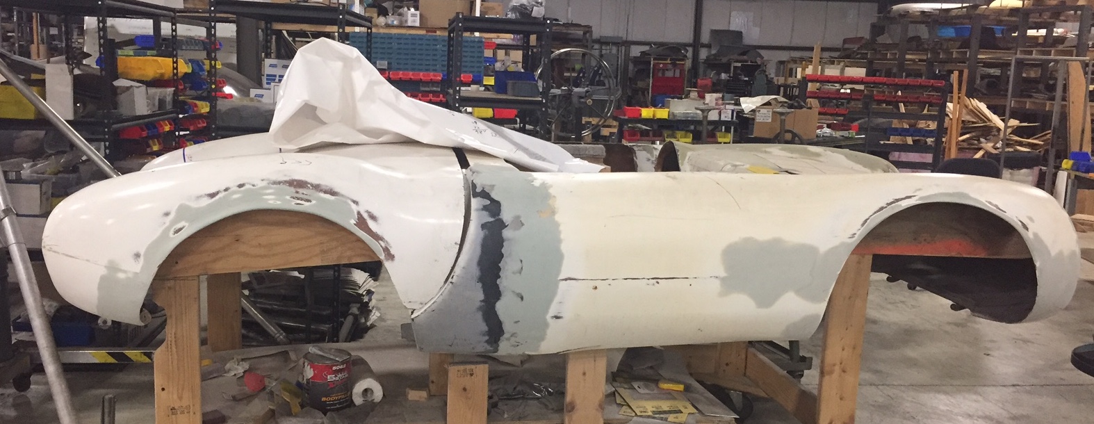

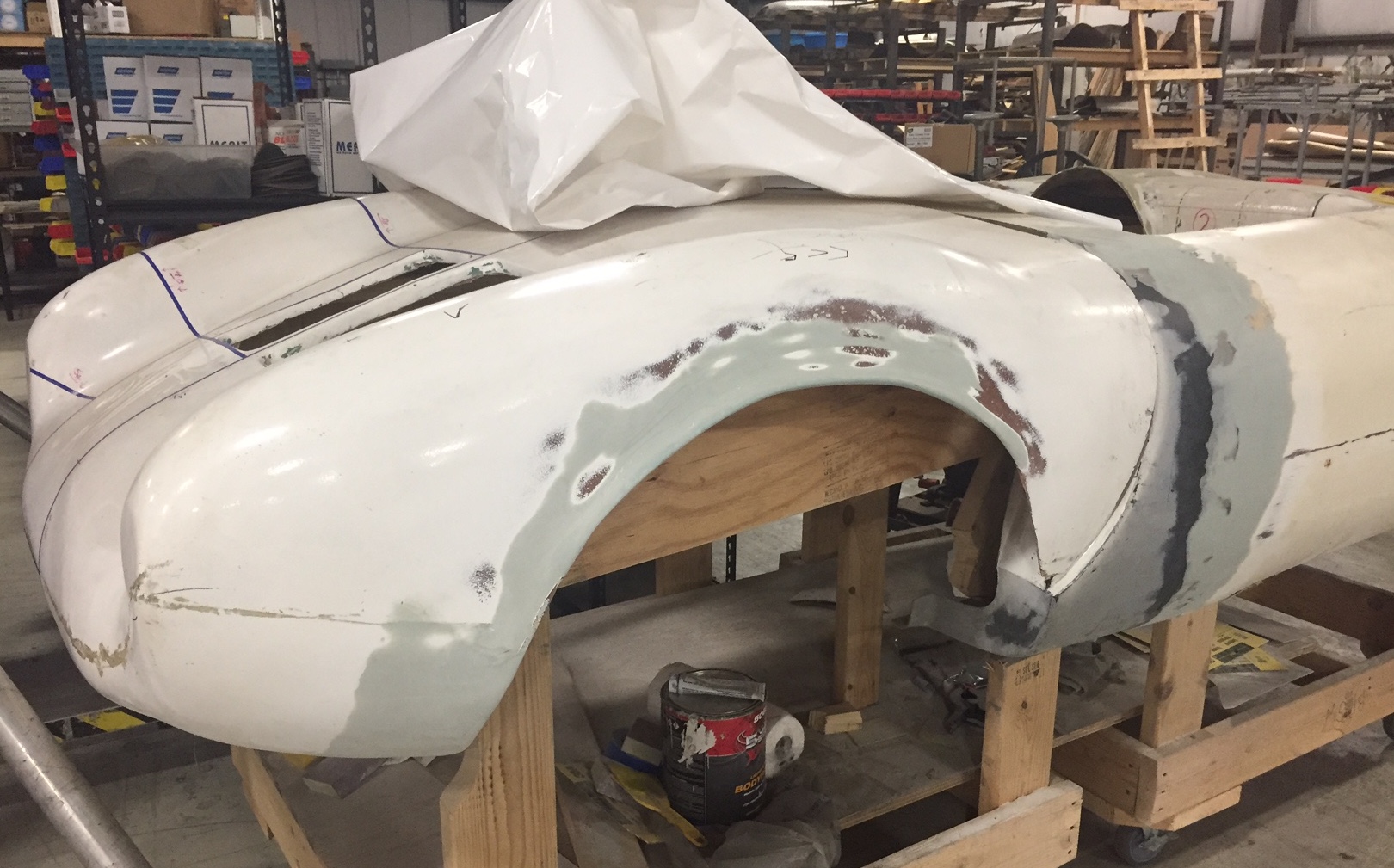

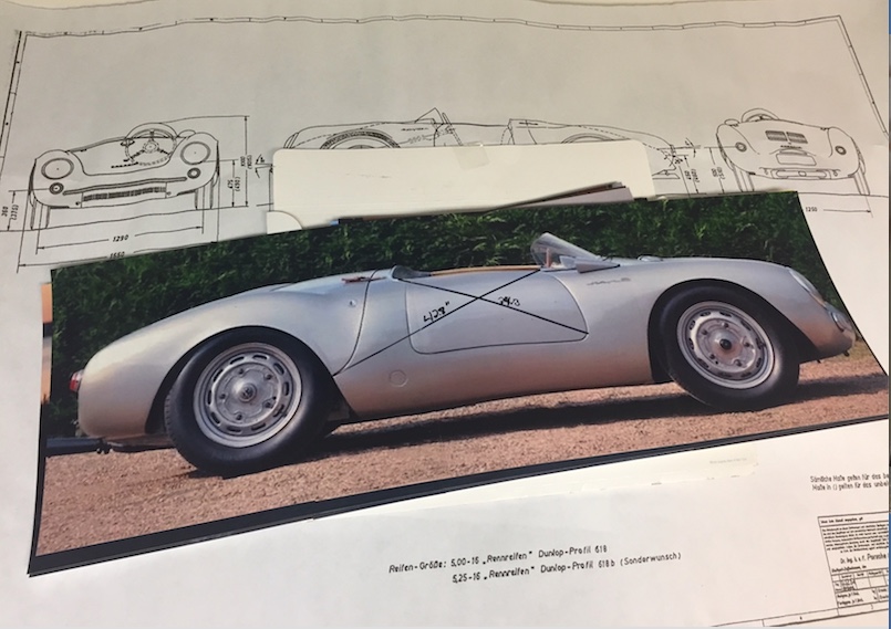

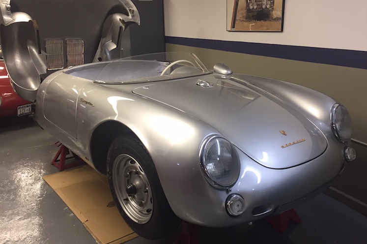

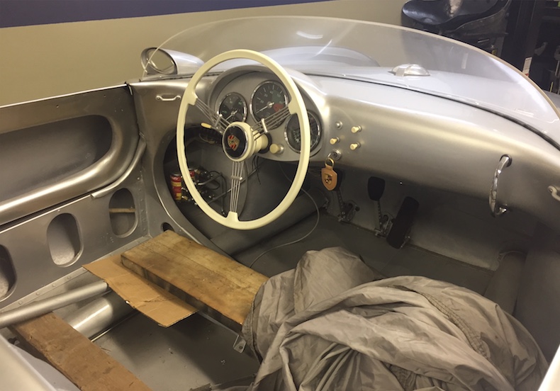

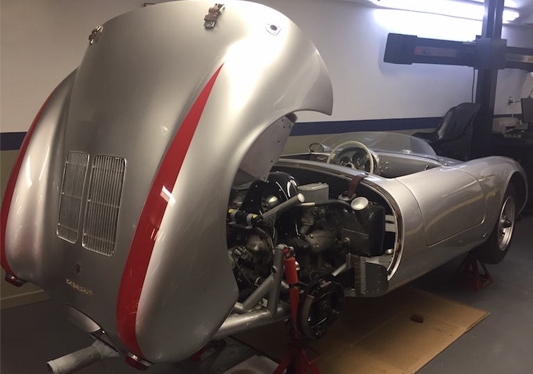

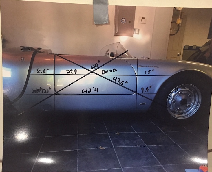

Didn't get anything done this week on the 904 project, had to jump back to the other one, the aluminum 550 build. Took lots of measurements off of 0054, and drooled a lot. I did get the suspension shipped out to Elephant Racing and strategized with them on everything we can do to get the shocks shorter including moving the placement on the strut.
The aluminum 550 isn't completely off topic, I'm using a huge chunk of 914 for that one too, but that's a couple of years down the road. First the body has to get built.

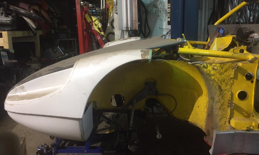

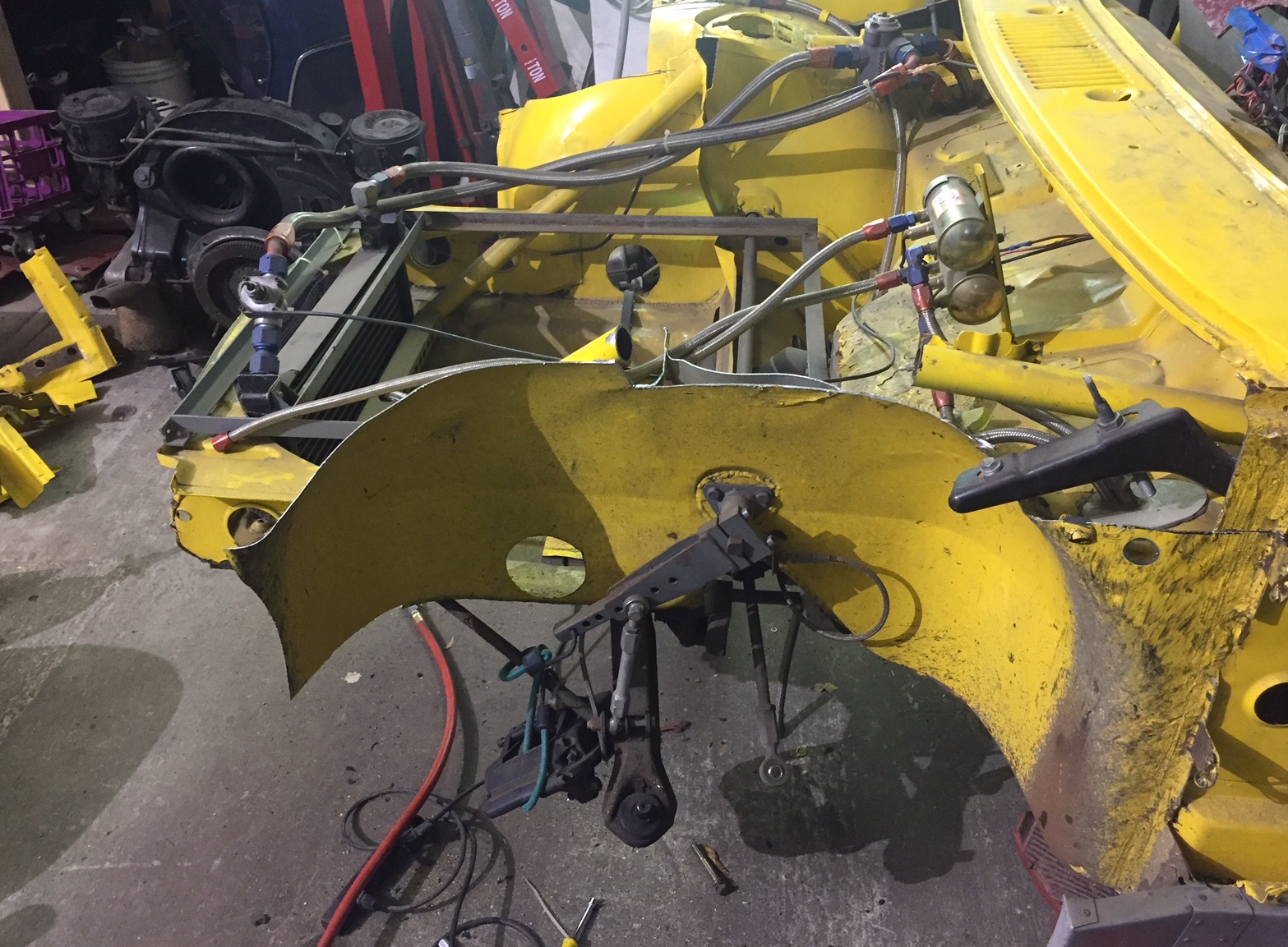

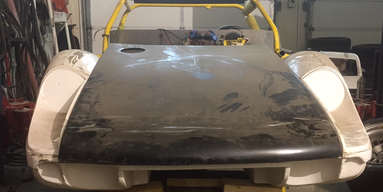

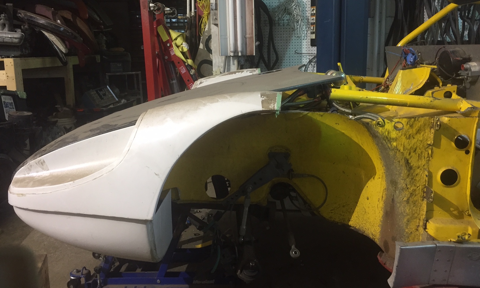

I was only to get a half day in today, had to leave early for a daughter orthodontist appointment, but tomorrow I will be alone at the shop to I can keep the momentum going. I was able to cut away the top of the cowl and the hinge area, ran out of time on the steering column area, going to leave as much of that as I can because I don't know how much I will need and where everything will align with the new dash.
Unobtanium-inc
post Jan 27 2017, 01:07 PM
Post #612
Posts: 2,381
Joined: 29-November 06
From: New York
Member No.: 7,276

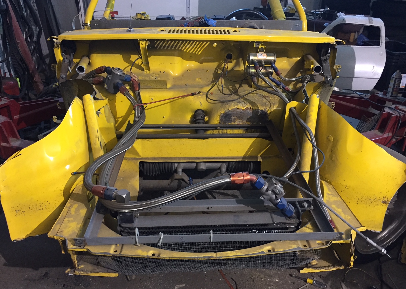

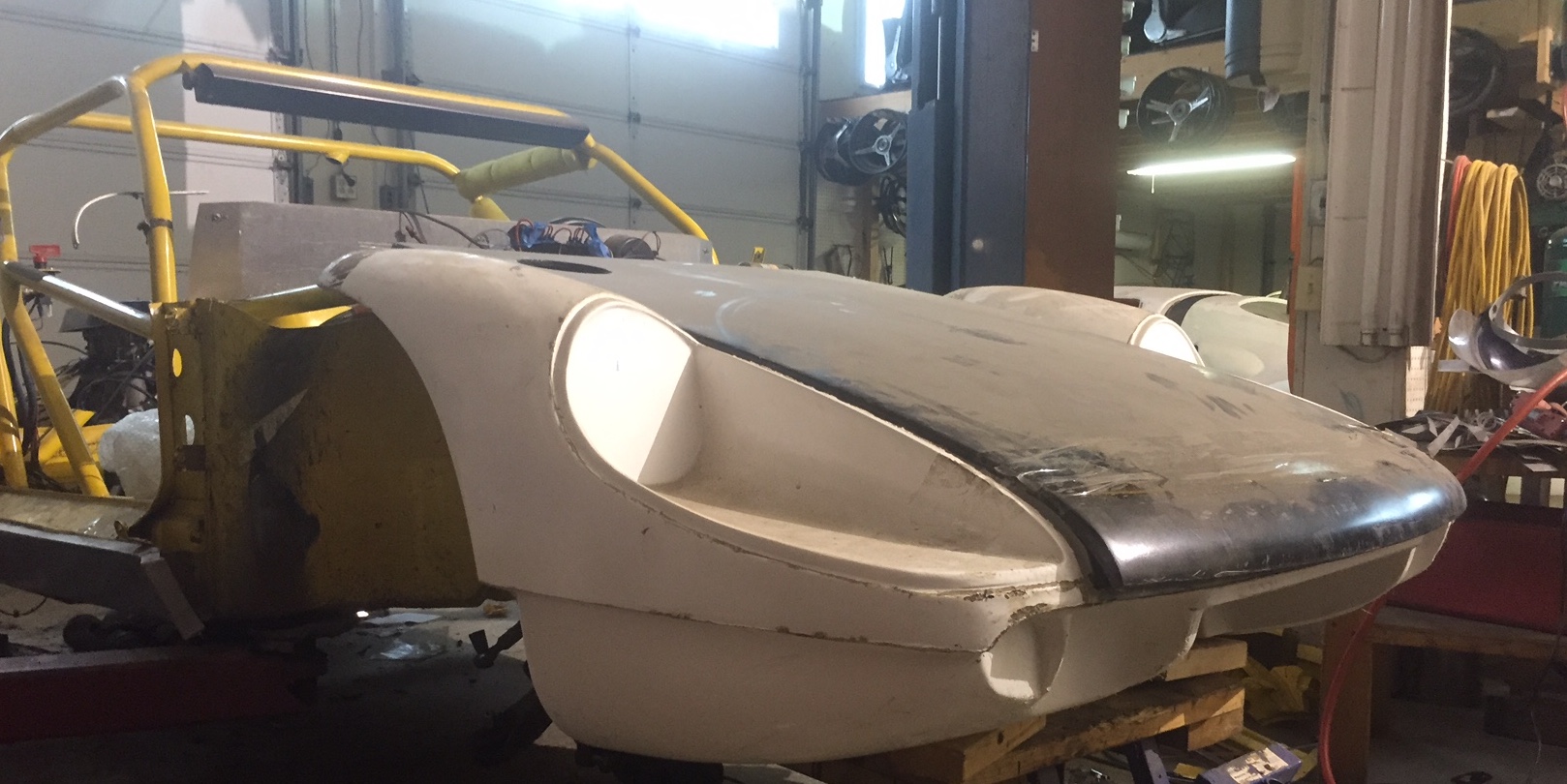

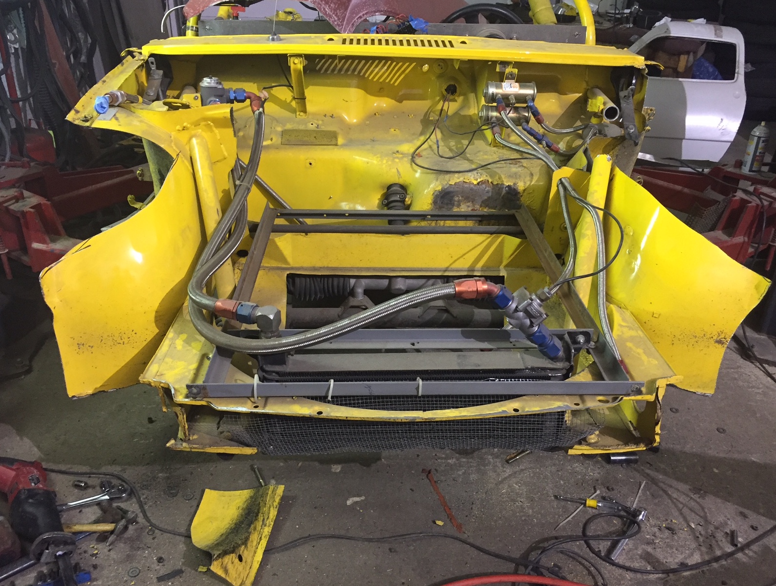

Ok, today was dramatic, starting to take shape. The front nose is right where I need it. I will have to relocate the oil cooler from where it was on the 914. But I was able to retain 914 wheel wells so that is good news. This is getting fun again!

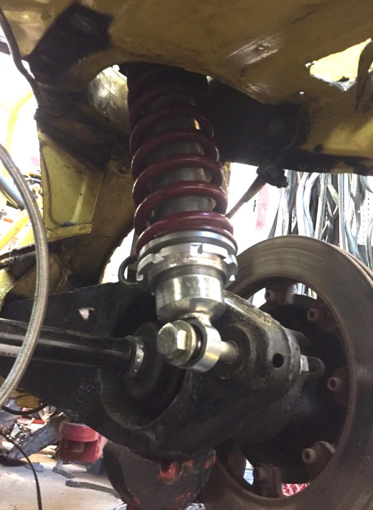

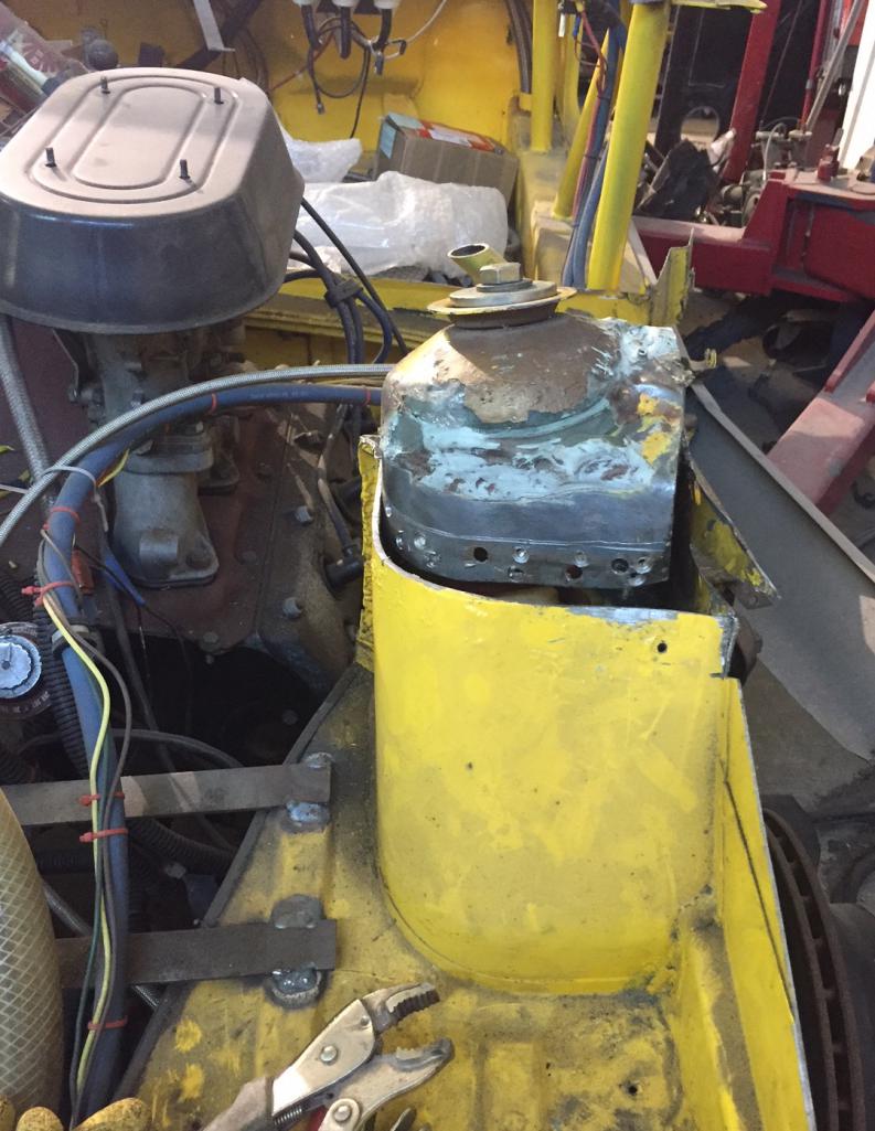

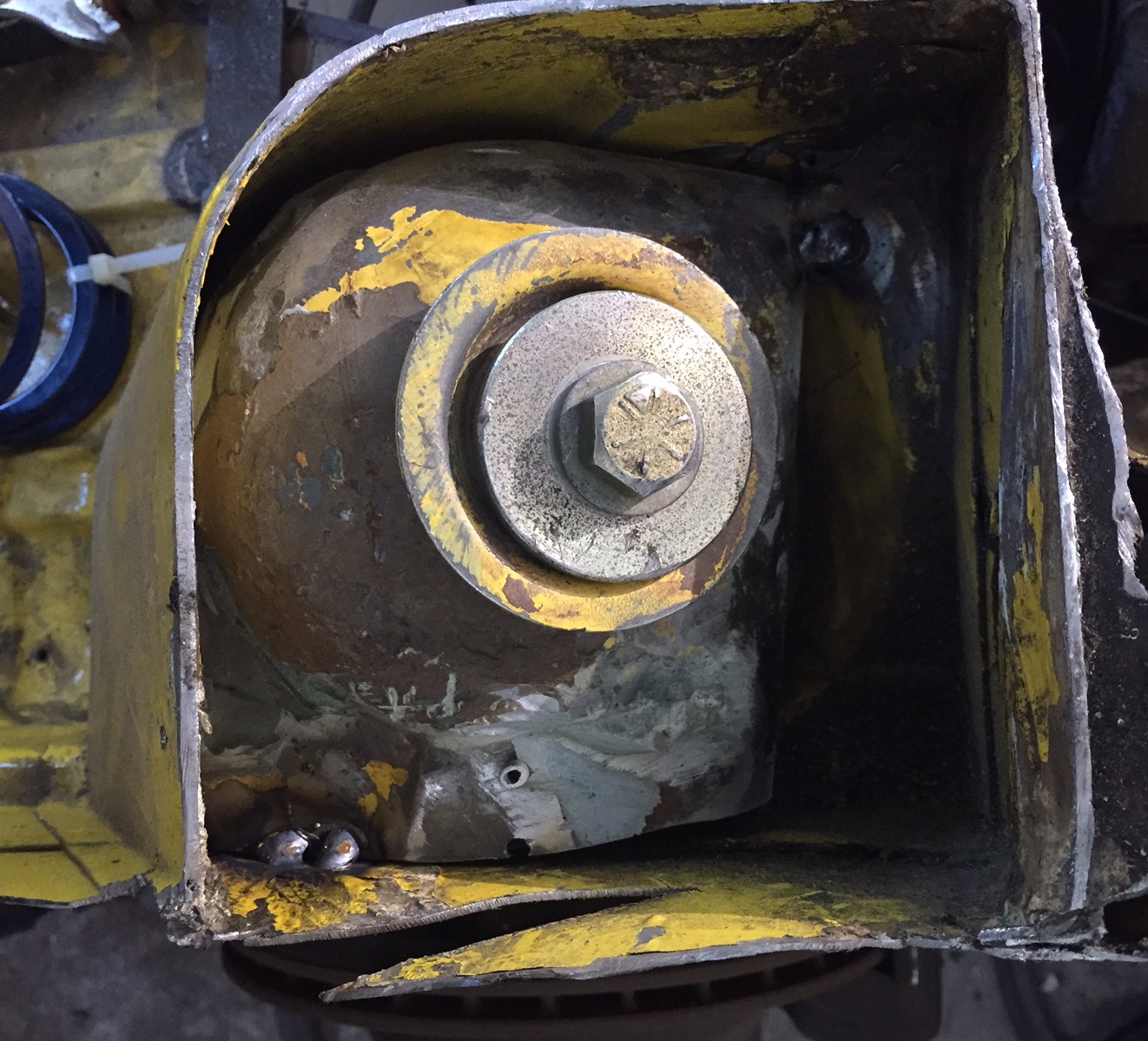

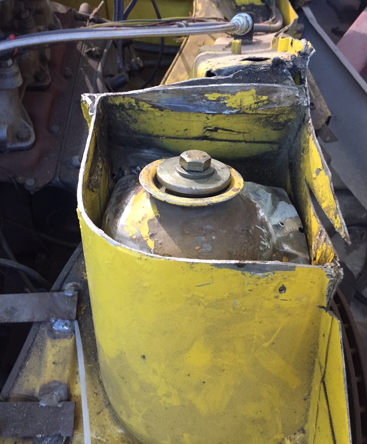

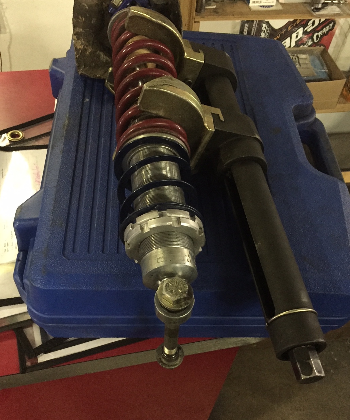

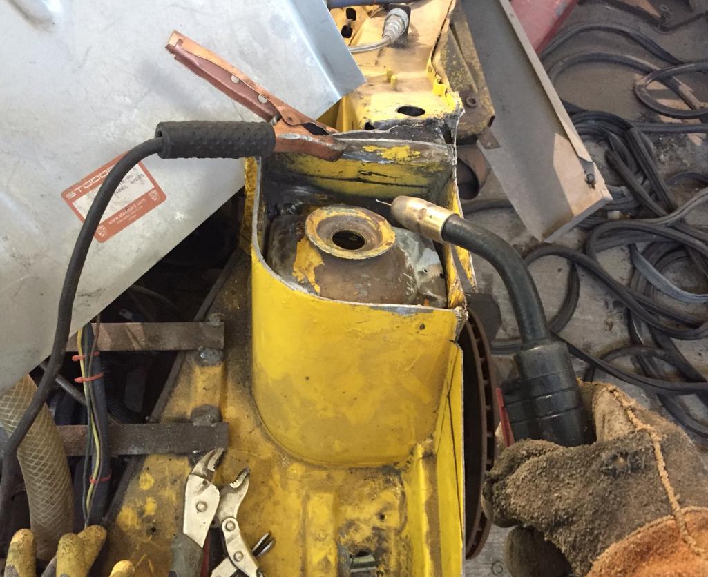

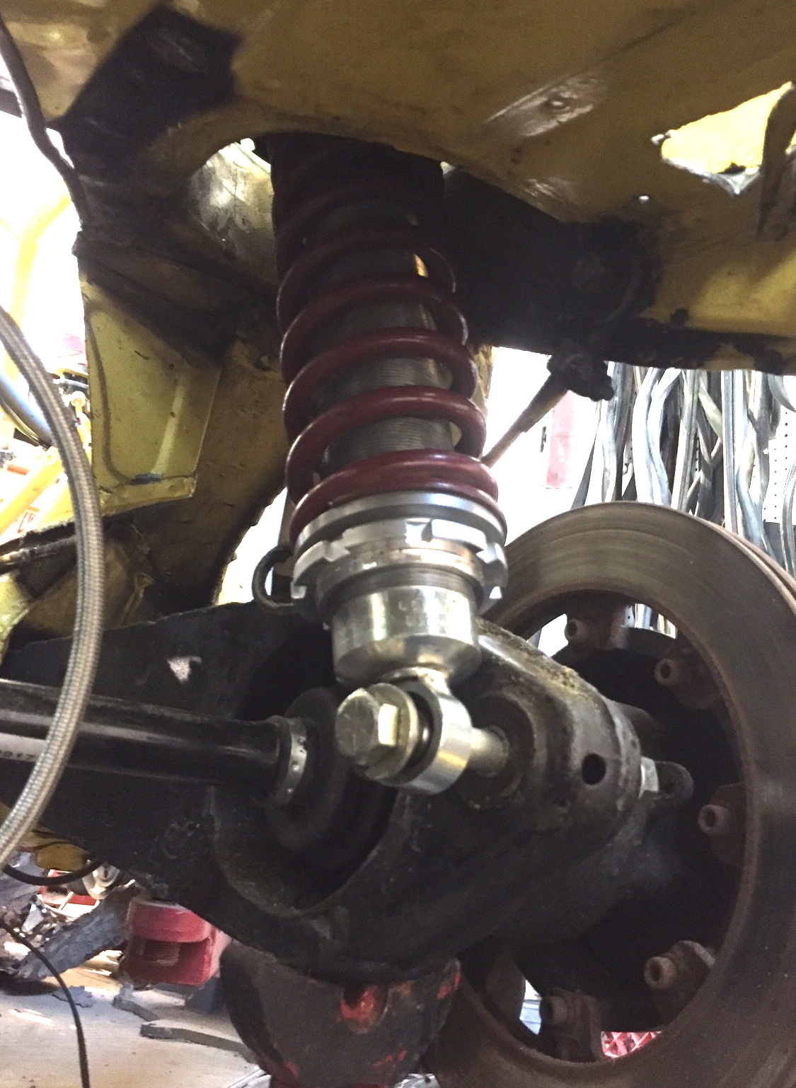

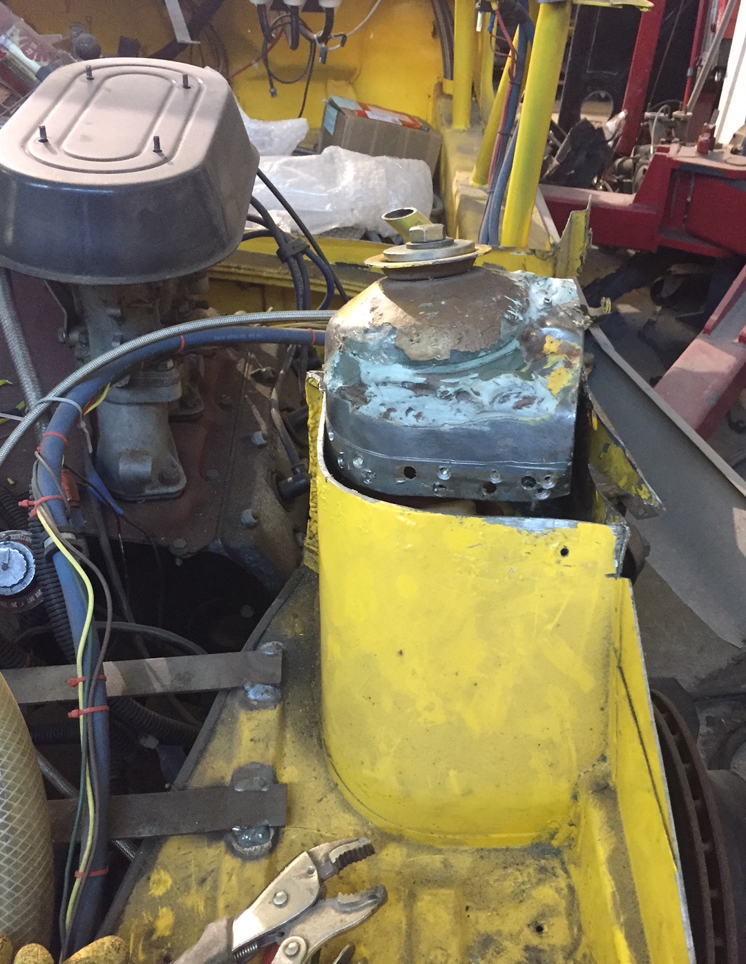

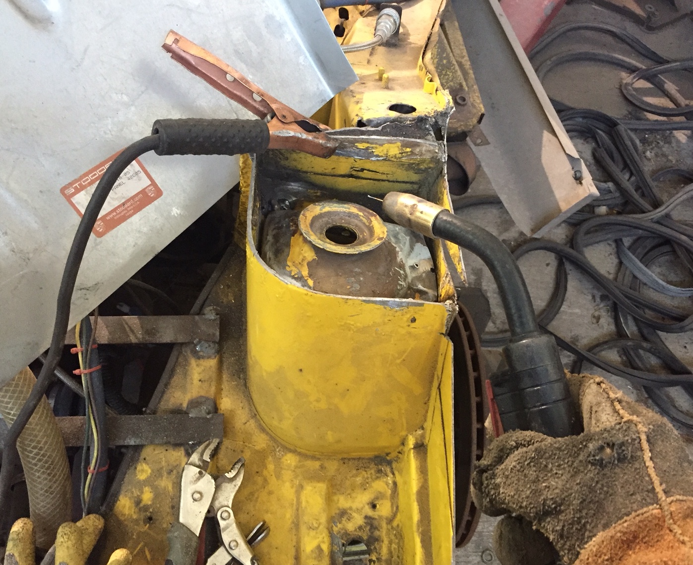

Ok, back in action, real life takes ahold every now and then and we have to bring it back to the fun stuff. Elephant Racing got me the suspension back in good time. Not cheap but very nice work, so very happy with the results. One thing I learned a long time ago, the words cheap and Porsche don't flow well in a sentence, this project is no different.
I was having a hard time getting the shock to compress enough to bolt back up, so I borrowed some tools and brains from my mechanic Rick at Bavarian Rocket Science. We figured it out and I welded the lower tower in place enough to test fit the shock, and it fit, it took some wrestling but it fit. I ran out of day but it was a good day. Hopefully I can wrap up the rear end next week and then move to the front which is far more complicated and daunting.
