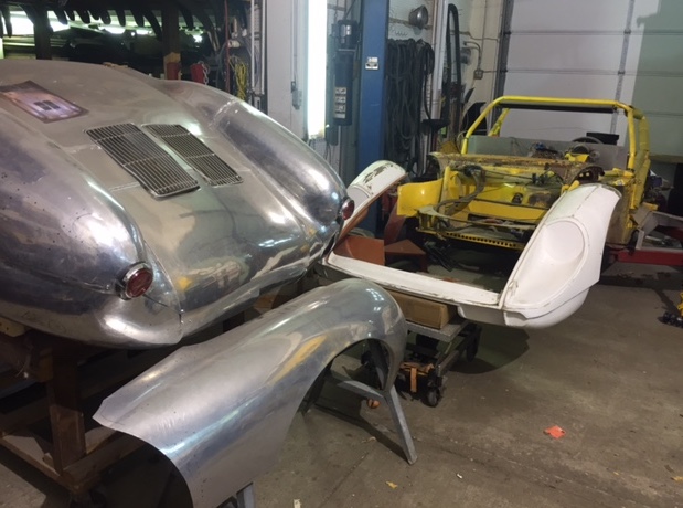

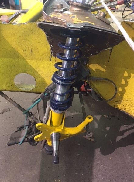

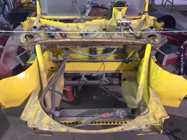

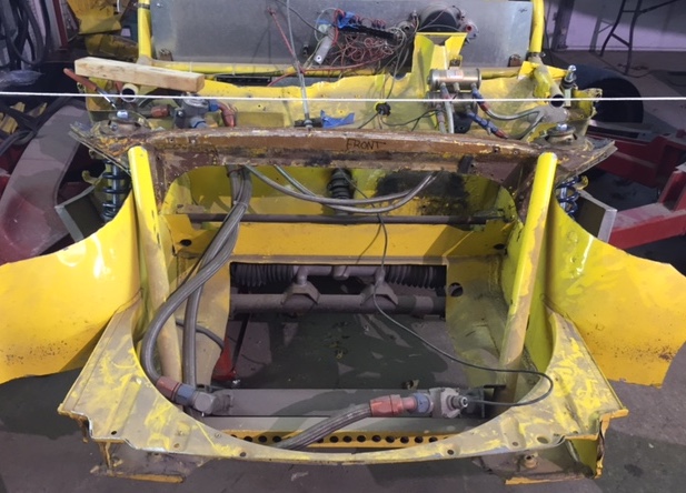

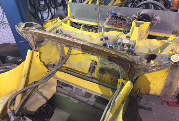

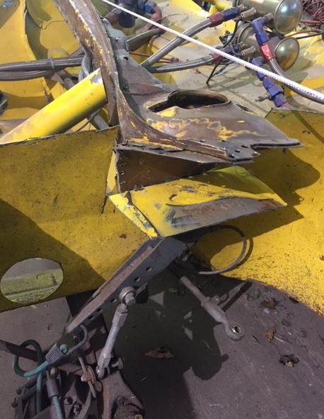

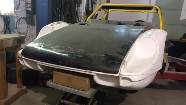

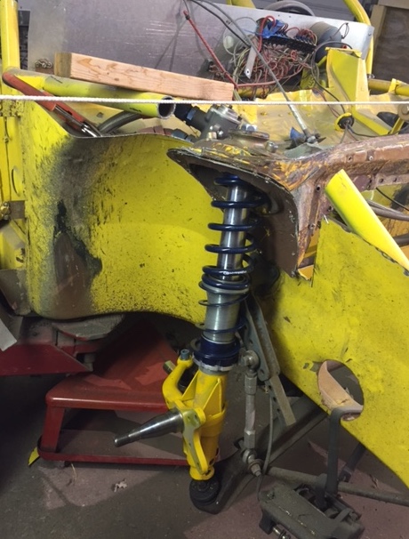

Ok, the selling season is quickly ending so I took today and got some real progress made on the front shock towers.
We drilled out the spot welds on the test bed chassis so I have a complete shock tower rack to work with. The front struts from Elephant Racing fit very well and I got in under the wire, literally, see the wire! I ran out of day but at least I know where the shock towers need to go, now I can fab and weld them in. Look for weekly updates now that I have more time.
Attached Image Attached Image Attached Image Attached Image Attached Image Attached Image Attached Image Attached Image Attached Image

QUOTE(Unobtanium-inc @ Oct 26 2017, 03:54 PM) *
does this work, without fixing the poor leftover on a bench ?
I'm mean, the chassis looses more and more structural integrity while stripping down.
When welding the relocated suspension mount points I would expect to get lots of trouble regarding warping and other issues resulting in a twisted chassis (IMG:style_emoticons/default/confused24.gif)
br
Benno
Any slight warpage will be more than fixable with the infinitely adjustable suspension. It's an old race car that's been modified to no end already.

QUOTE(carr914 @ Oct 27 2017, 04:06 AM) *
QUOTE(Unobtanium-inc @ Oct 27 2017, 07:29 AM) *
QUOTE(sechszylinder @ Oct 27 2017, 02:51 AM) *
br
Benno
Again you show why you have no business working on a car, much less destroying one.
What Benno was saying is without it being built on a Bench, it will be a twisted mess that Suspension doesn't fix. It might mask it till something breaks because of undue stress.
And any Member here is able to post here whether you like it or not!
This was a Car, now it can only be a
