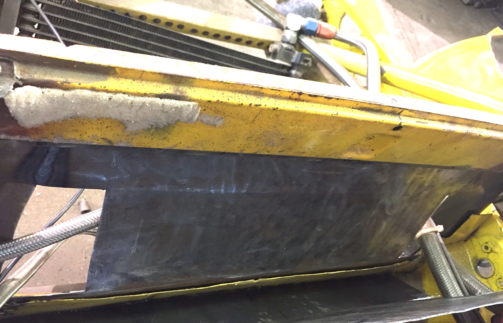

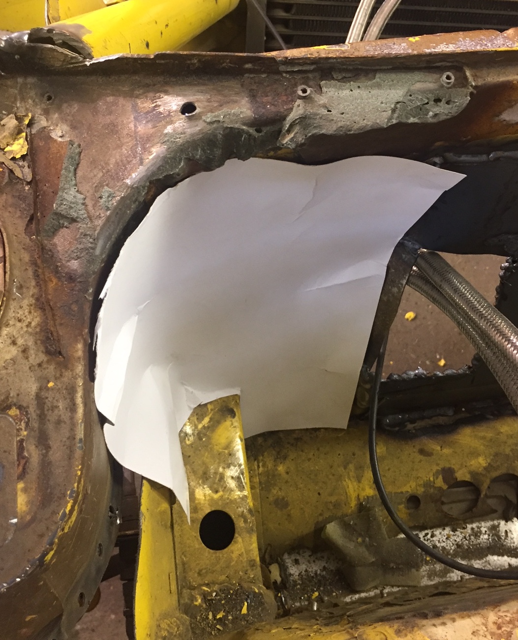

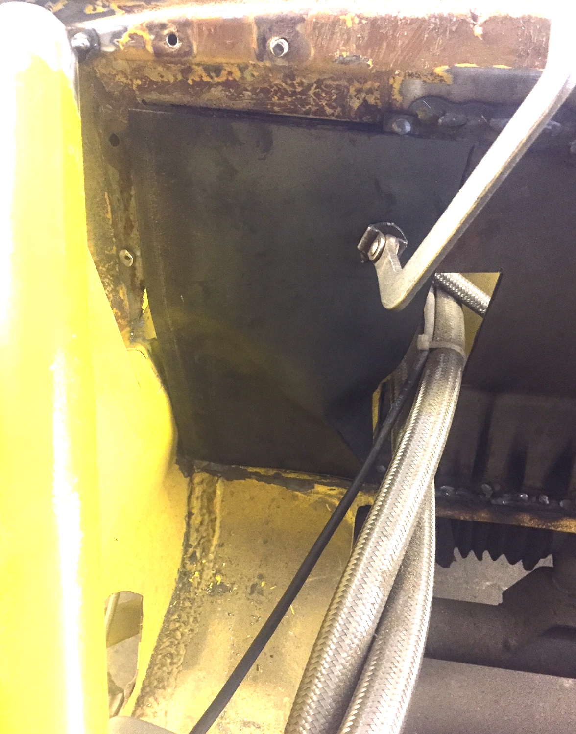

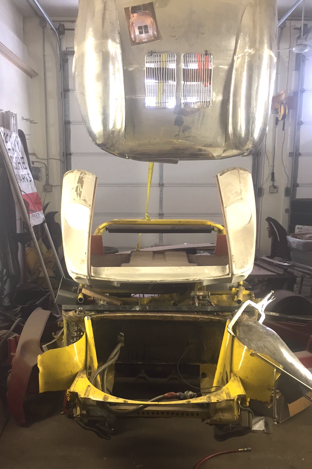

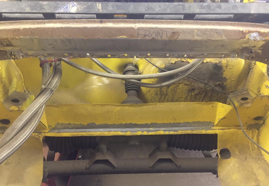

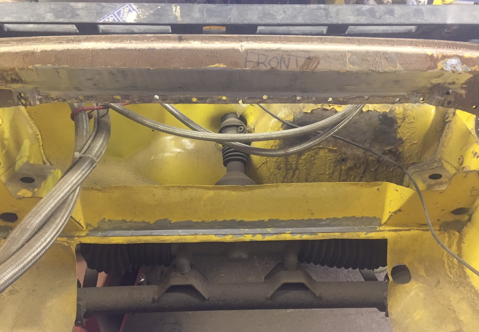

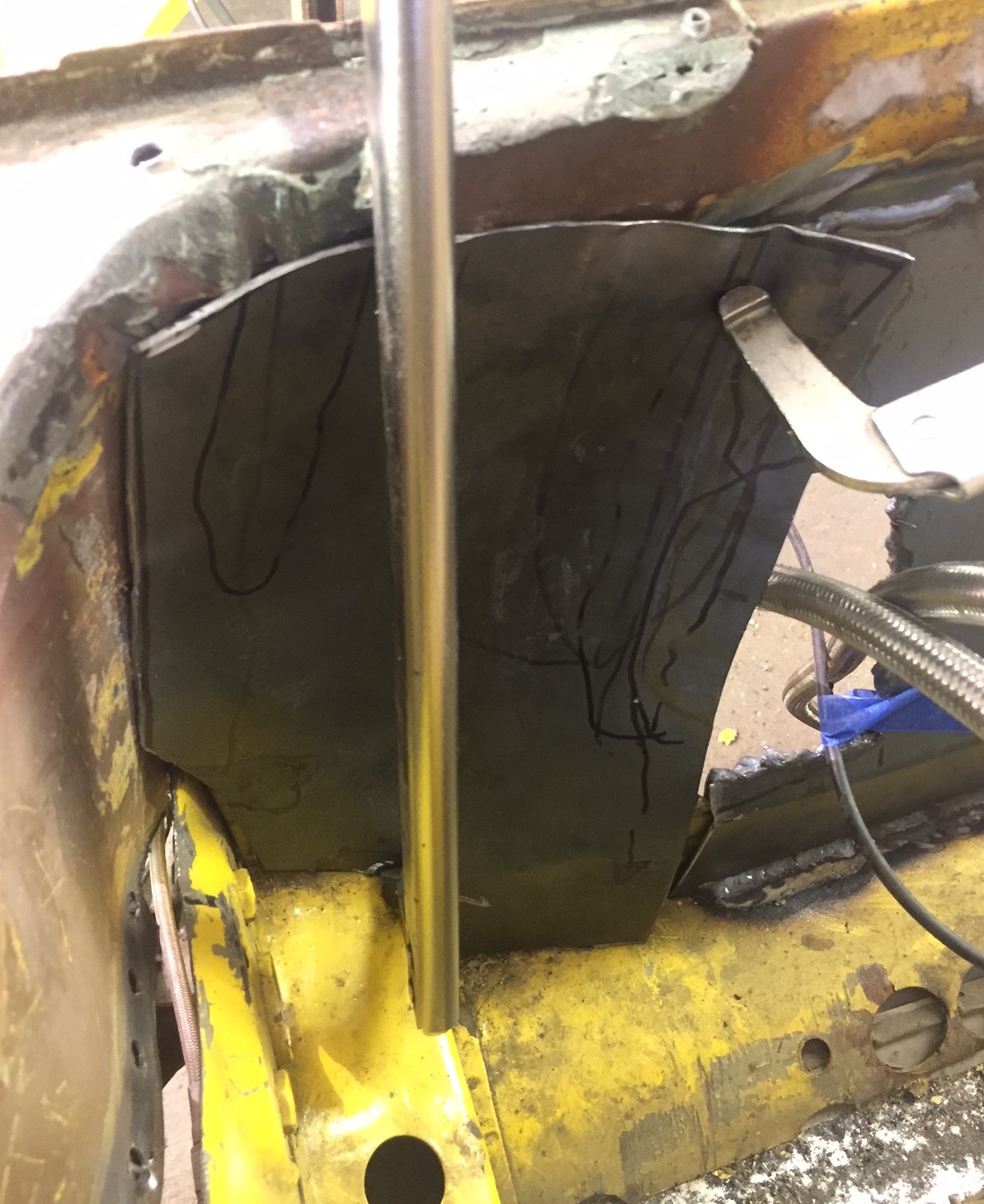

I started with the middle section of the cowl under the suspension beam. It went in almost perfectly, a little tweeking, but I was happy with the result. I then went to the passenger side piece and it was all wrong, I messed with it for about an hour and finally tossed it and made another, which I was much happier with. The driver's side piece needed a little finishing but was un-eventful. I got all three pieces welded in and it's strong. I plan on doing more metal on the back side and in the corners to make sure the strength is there, but I am happy with the result today.

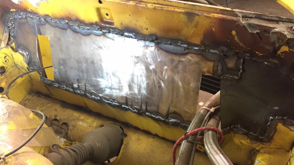

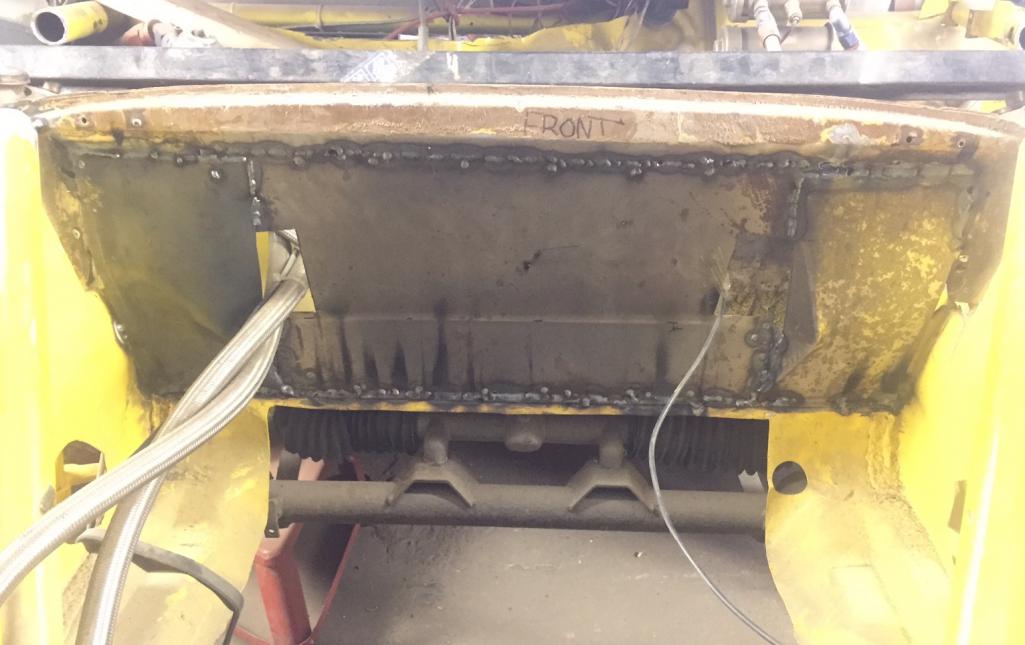

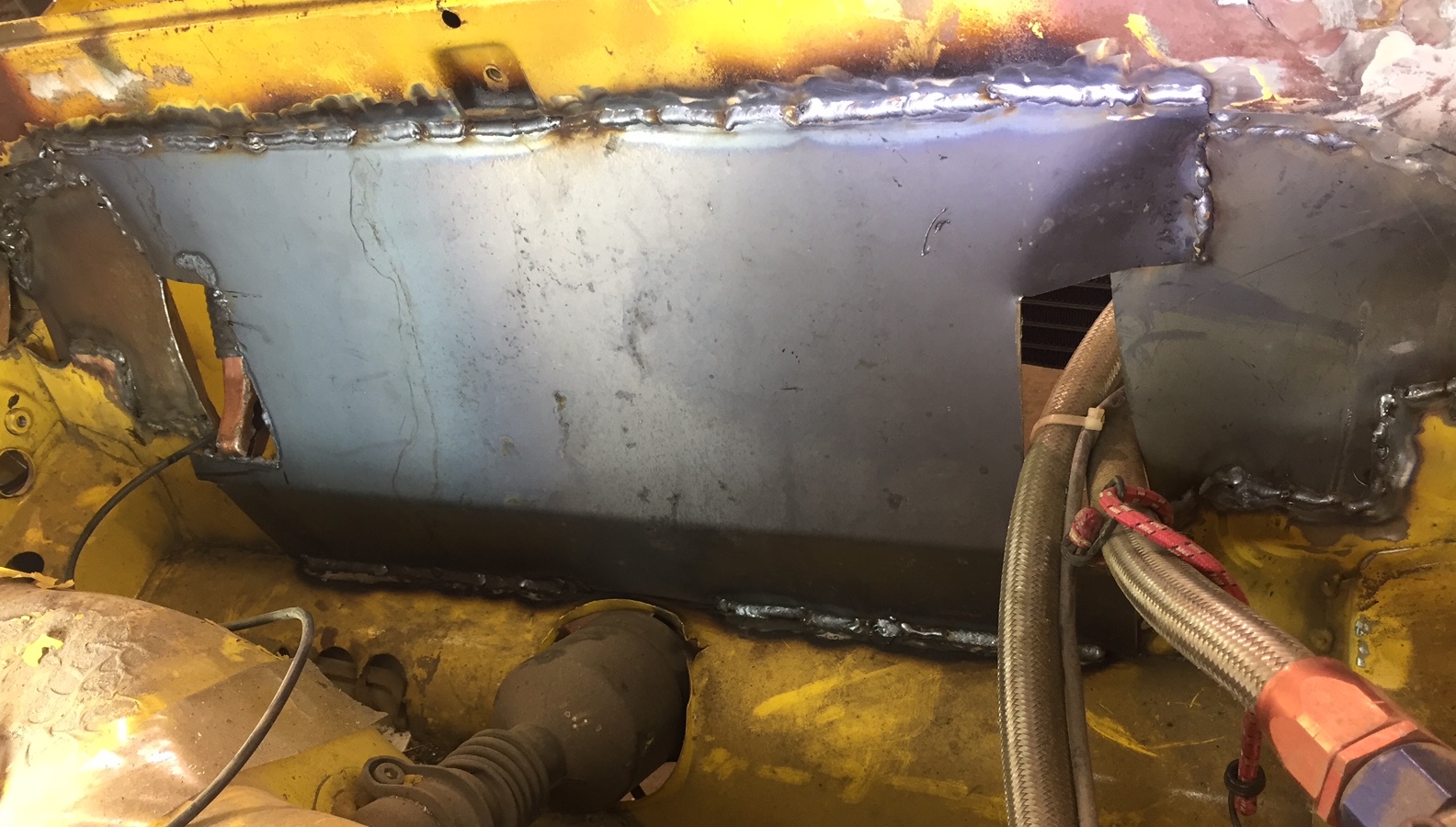

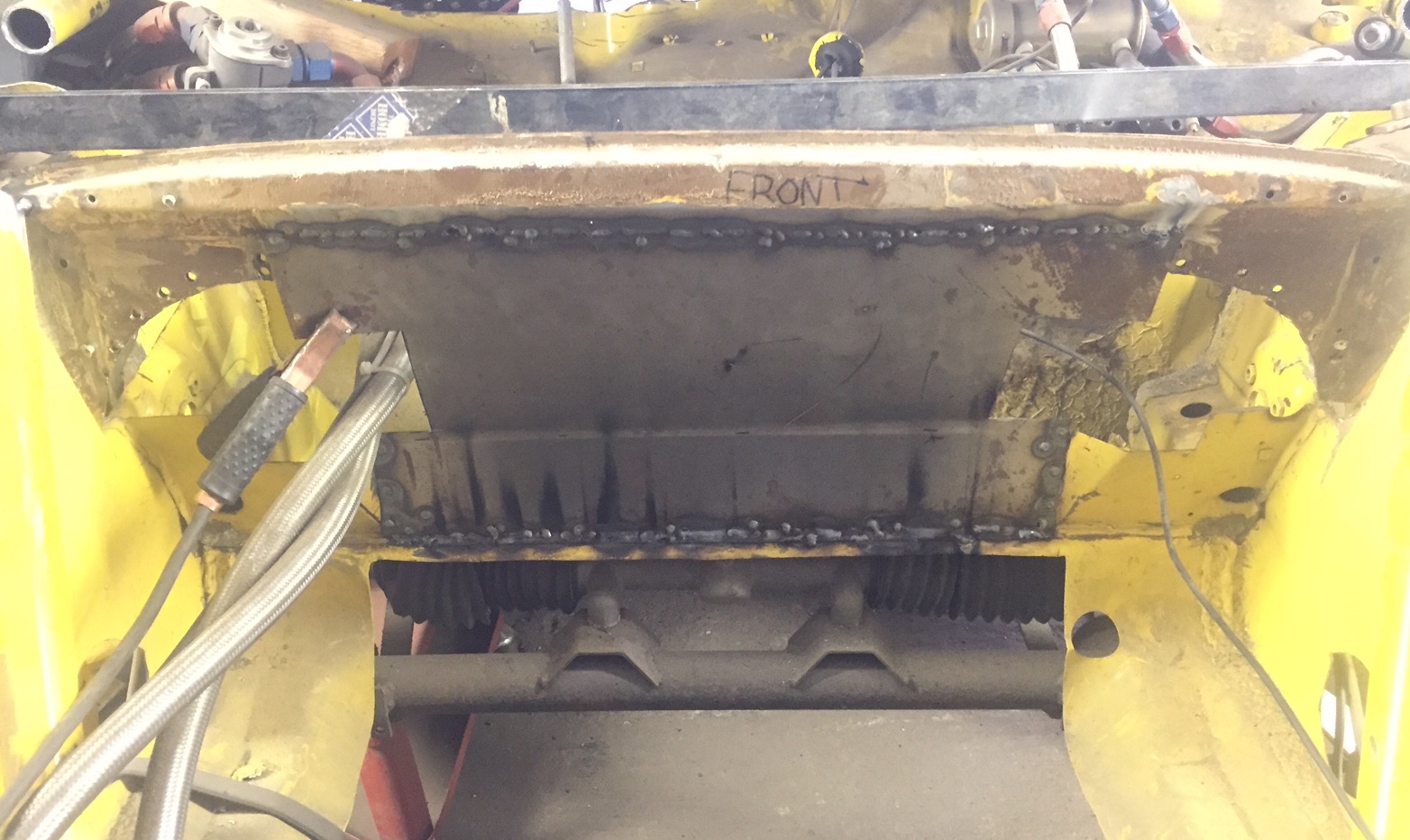

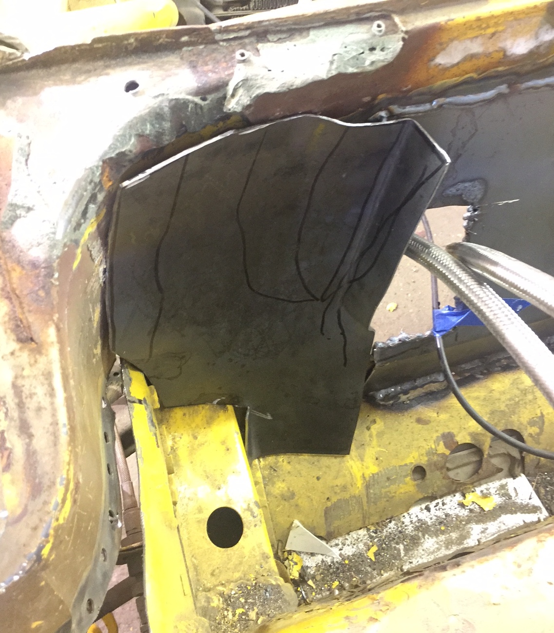

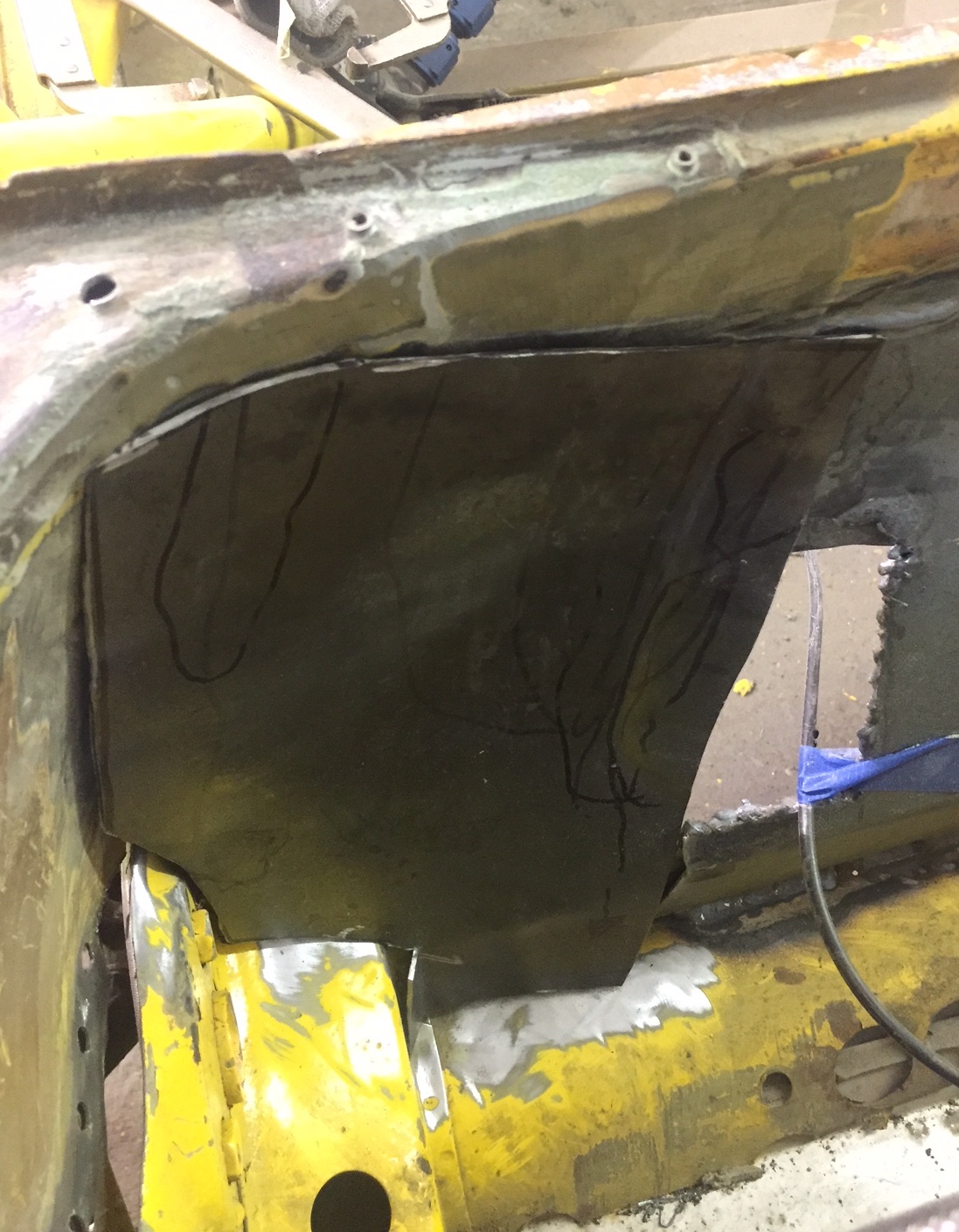

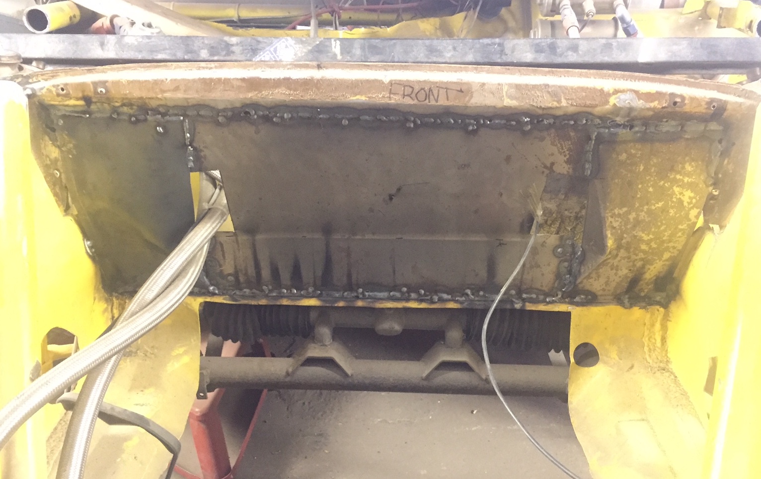

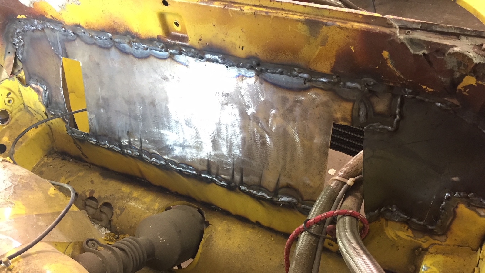

Today was very productive. I welded up the front cowl panel, and then made and welded up a backside panel. The fit was very nice and I have to say after welding on rusty 50 year old 356's all week, welding newer steel to brand new steel was wonderful. It was flowing so nice it was laying caulk.
A good day indeed!

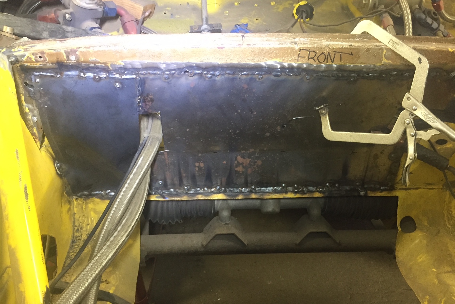

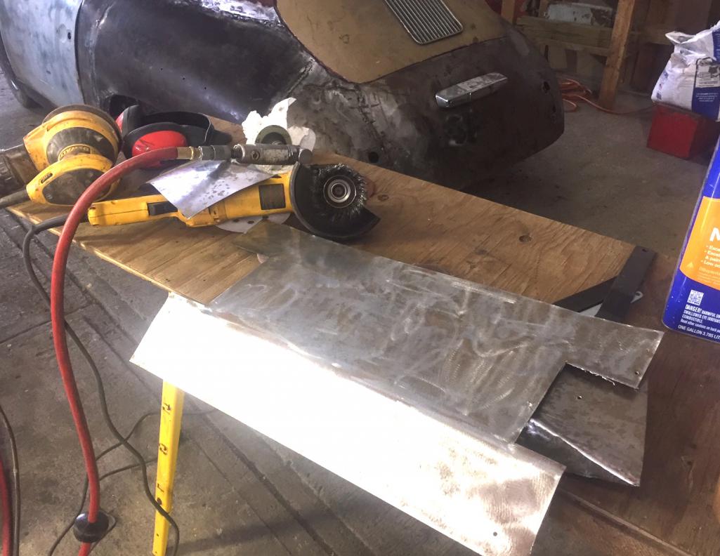

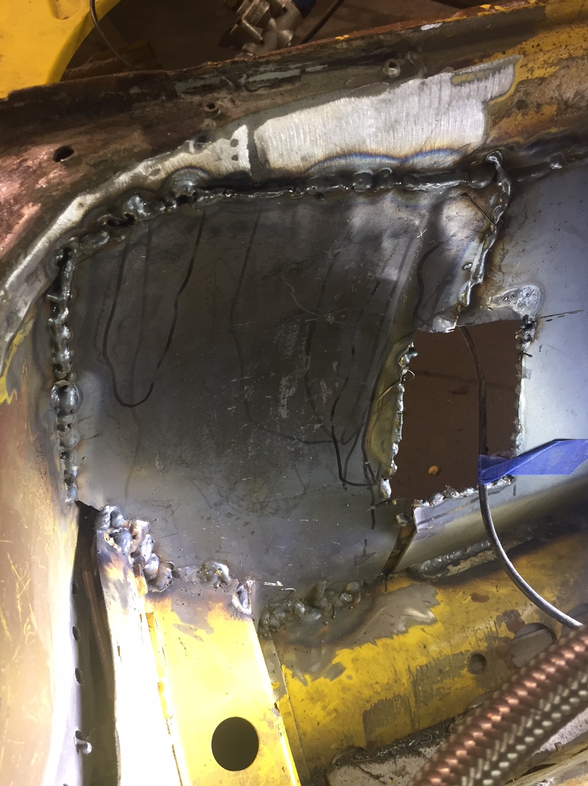

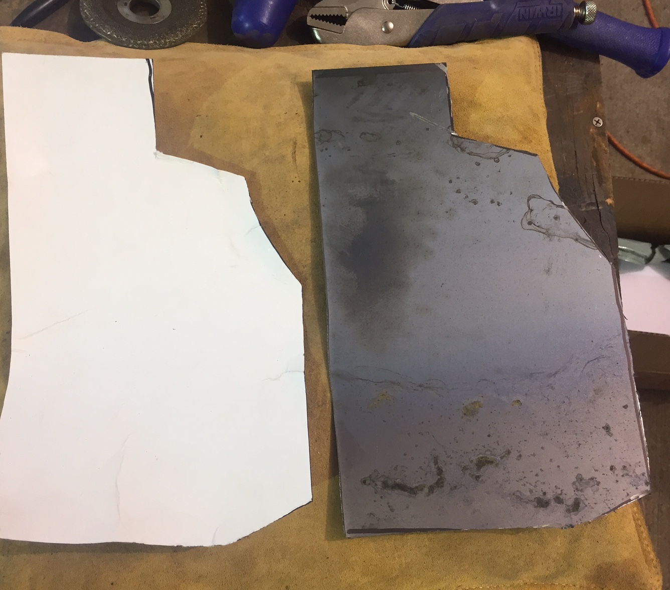

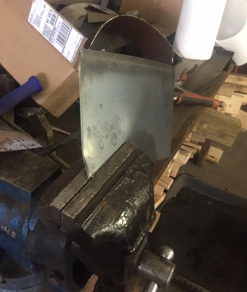

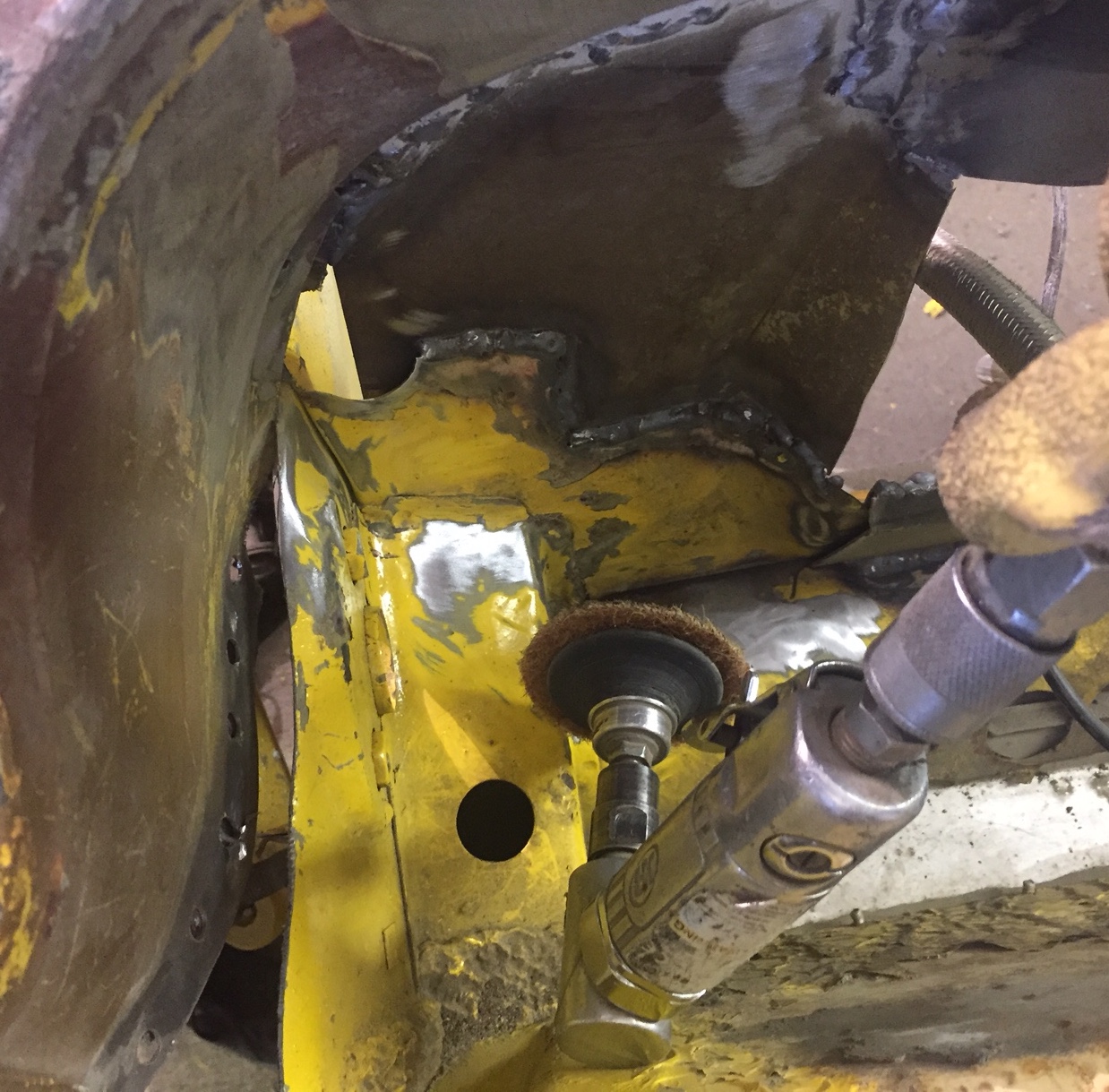

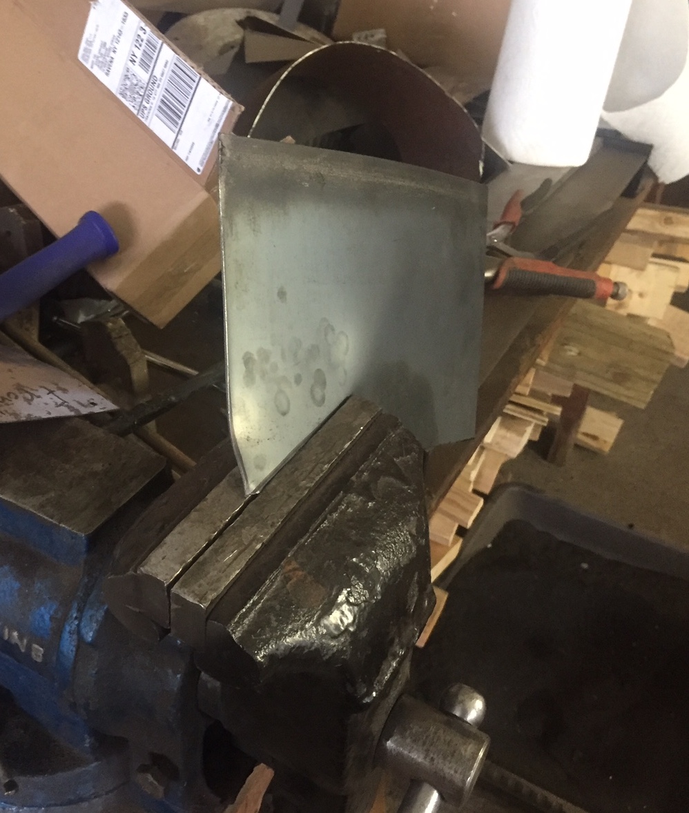

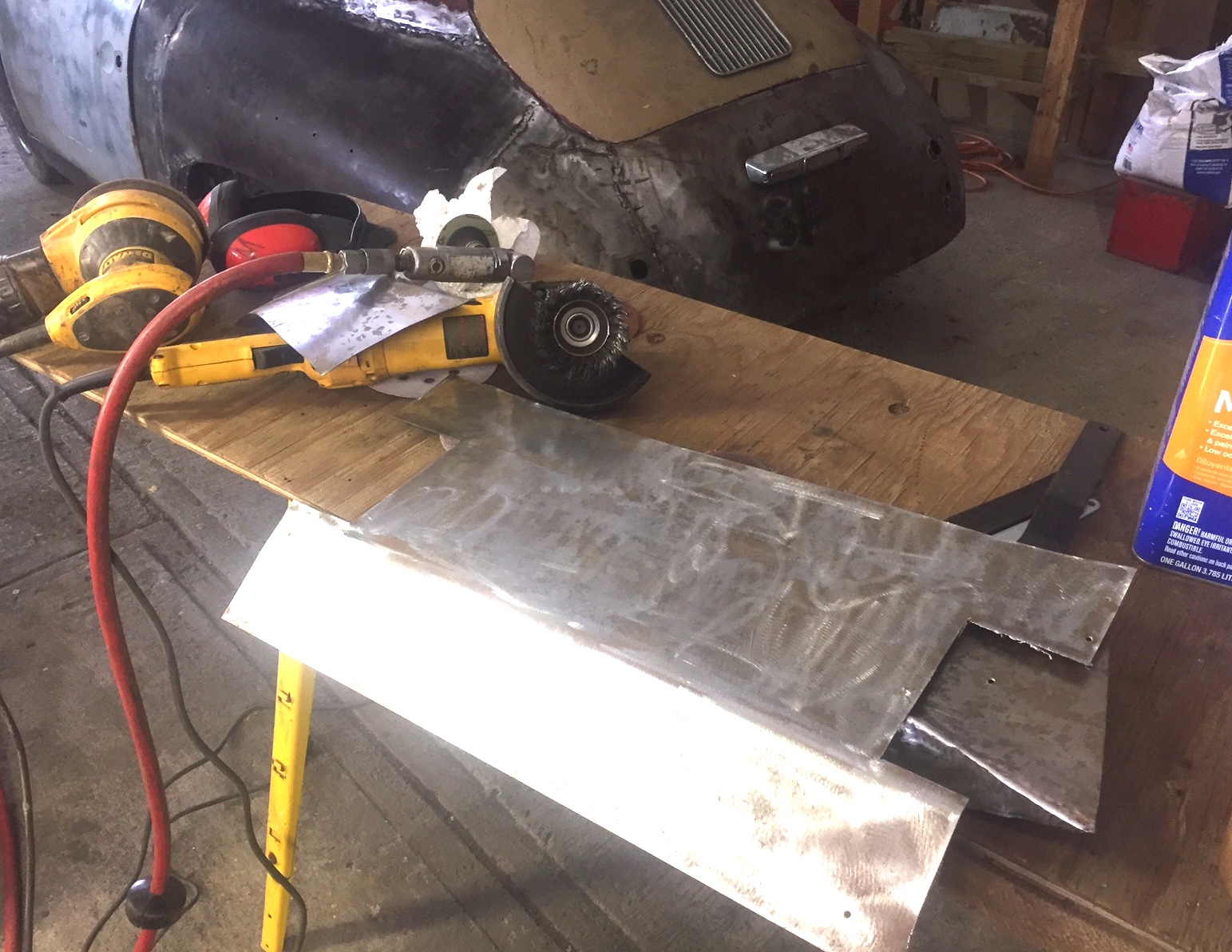

My wife was having friend's over today so I got to slip away to the shop. It doesn't look like much but this piece curved in about 5 different directions, so it was a lot of fitting, banging, fitting, wheeling, fitting, banging, and finally welding it in.
The other piece of good news is a I talked to a friend of mine who lives behind a race track and he said I can bring the car to his place, he will help me set up all the suspension (corner balancing, toe-in, camber, etc.) and then we could run it on the track. I'm still several months out from this but it's nice to know I can really sort it on the track when the time comes.

Adam,
Clean up the metal before you weld.
It may help to get better welds.

QUOTE(r_towle @ Mar 18 2018, 04:53 PM) *
Adam,
Rich, thanks for the tip.
I think a lot of that was coming through from the backside, I cleaned the surface but I was welding deep and it finds contaminates and draws them to the surface. The welding was also hard because on the back side I had to do most of it upside down and at funny angles. The front part of the cowl came out much cleaner. But thanks for looking everything over.

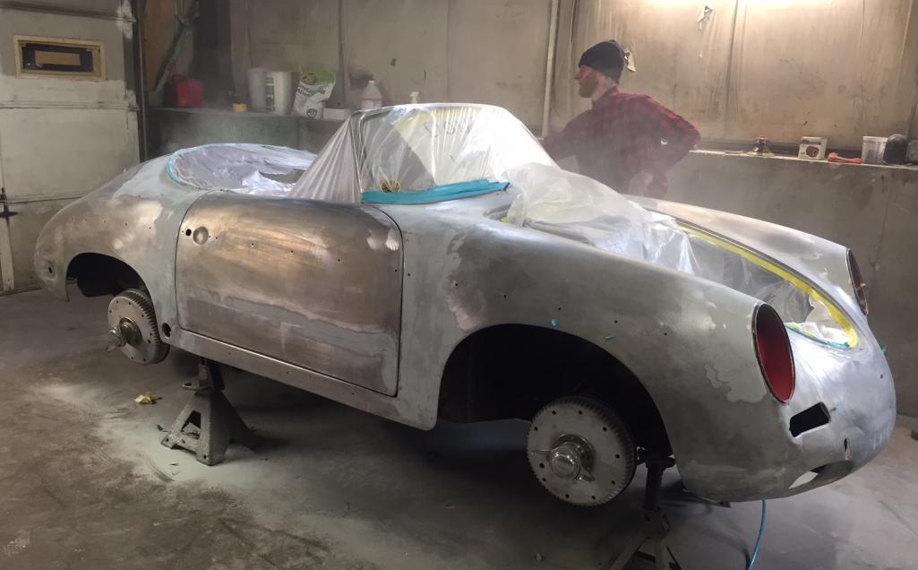

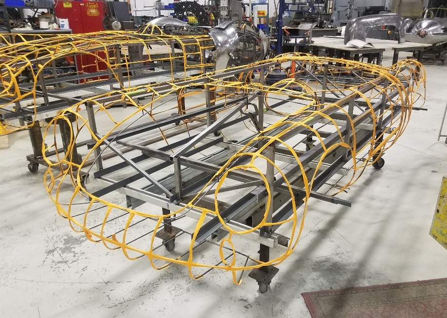

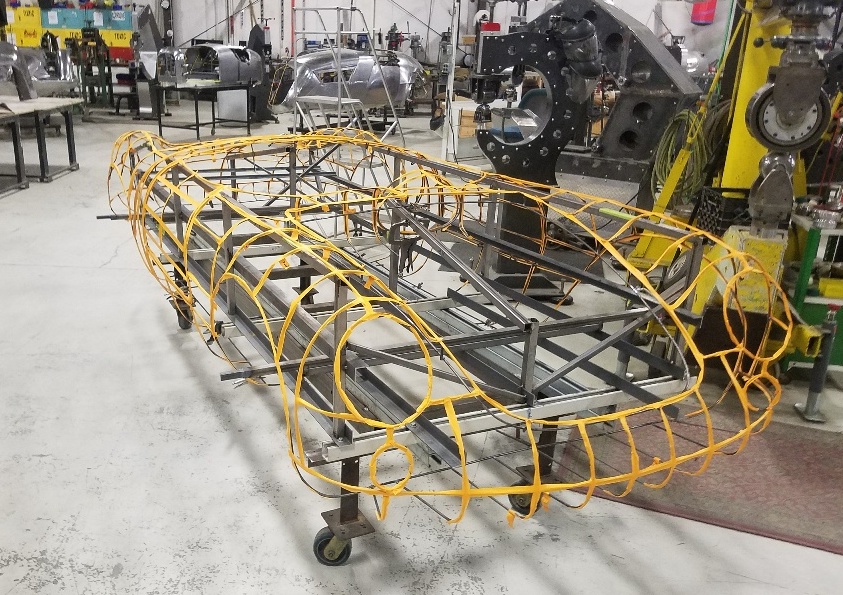

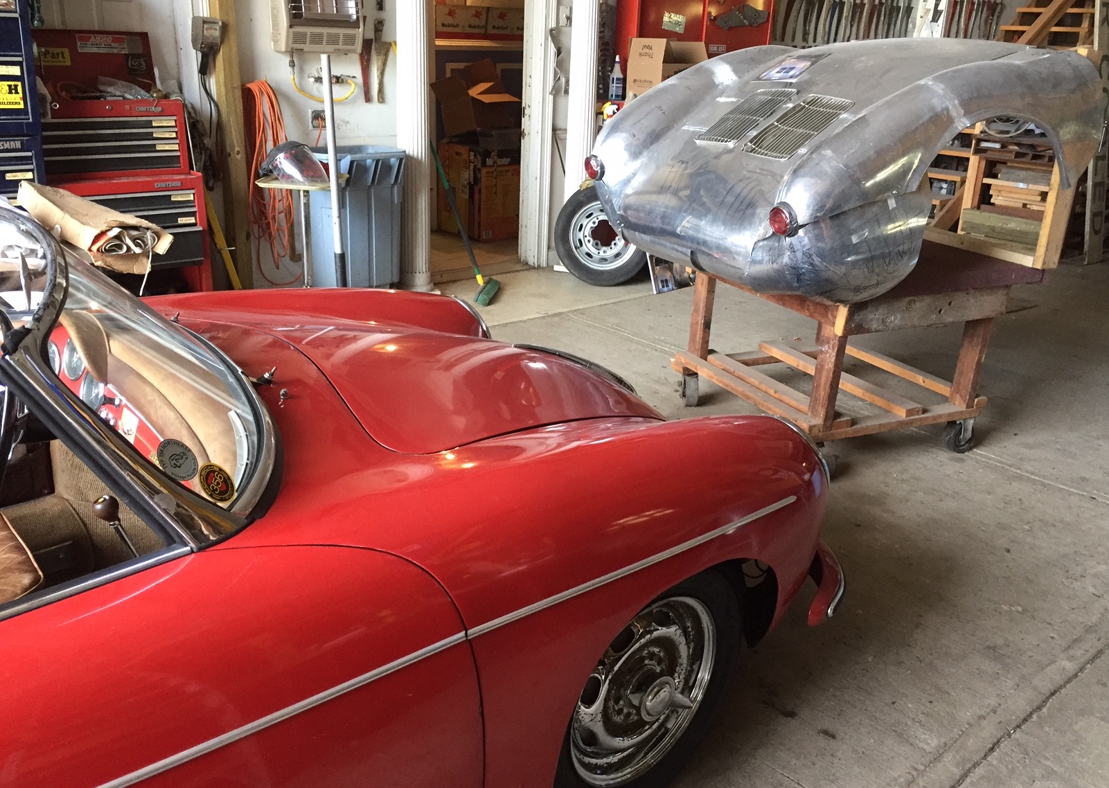

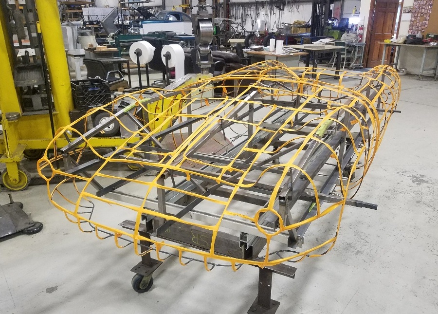

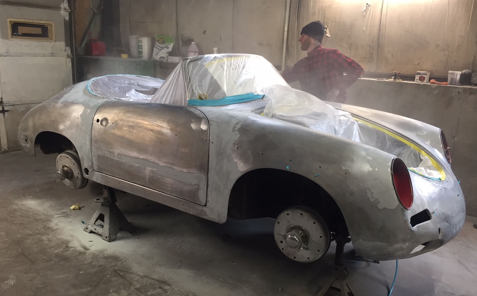

Sorry everybody, no 904 work this week, I headed out to MA to check on my 356 paint job and spent the rest of the day shaping 550 metal. The wire form is almost done, much easier than a wooden buck.
904 updates next week!

Interesting looking drums on the 356... and knock offs?

Adam - the 550 work looks like it's happening at Wray Schelin's place?
I'll be there next week for his 4-day coach building course (Fri-Mon).
Any chance you'll be stopping by?
Chris

QUOTE(Edward Blume @ Mar 28 2018, 04:50 AM) *
Yes, Rudge knock off wheels. People tend to knock them, but if they were good enough for Steve McQueen, they're good enough for me.

Yes, at Wray's place. The wire frame is finished so I'll be there a lot and maybe next weekend, hope to see you there!

One last thing my number is in my signature I would be happy to talk with you , give pointers, etc.. My biggest critic is proper prep of the weld areas, proper but joints, cut materials with plasma or oxy torch as a last resort and use shear and cut off wheels as standard.
I am absolutely sincere in my offer. Give me a call.
