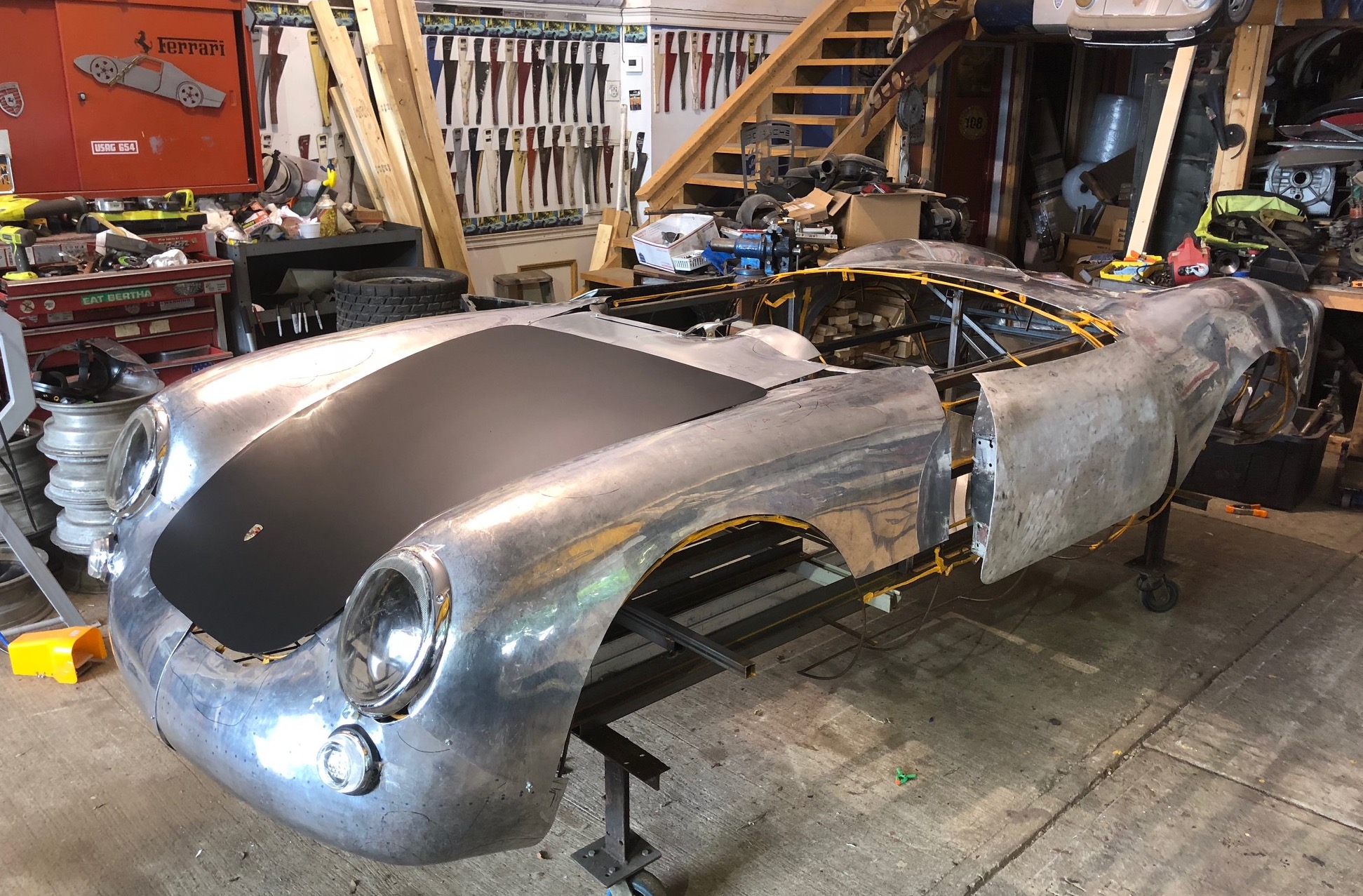

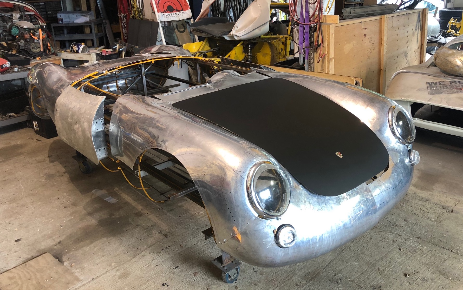

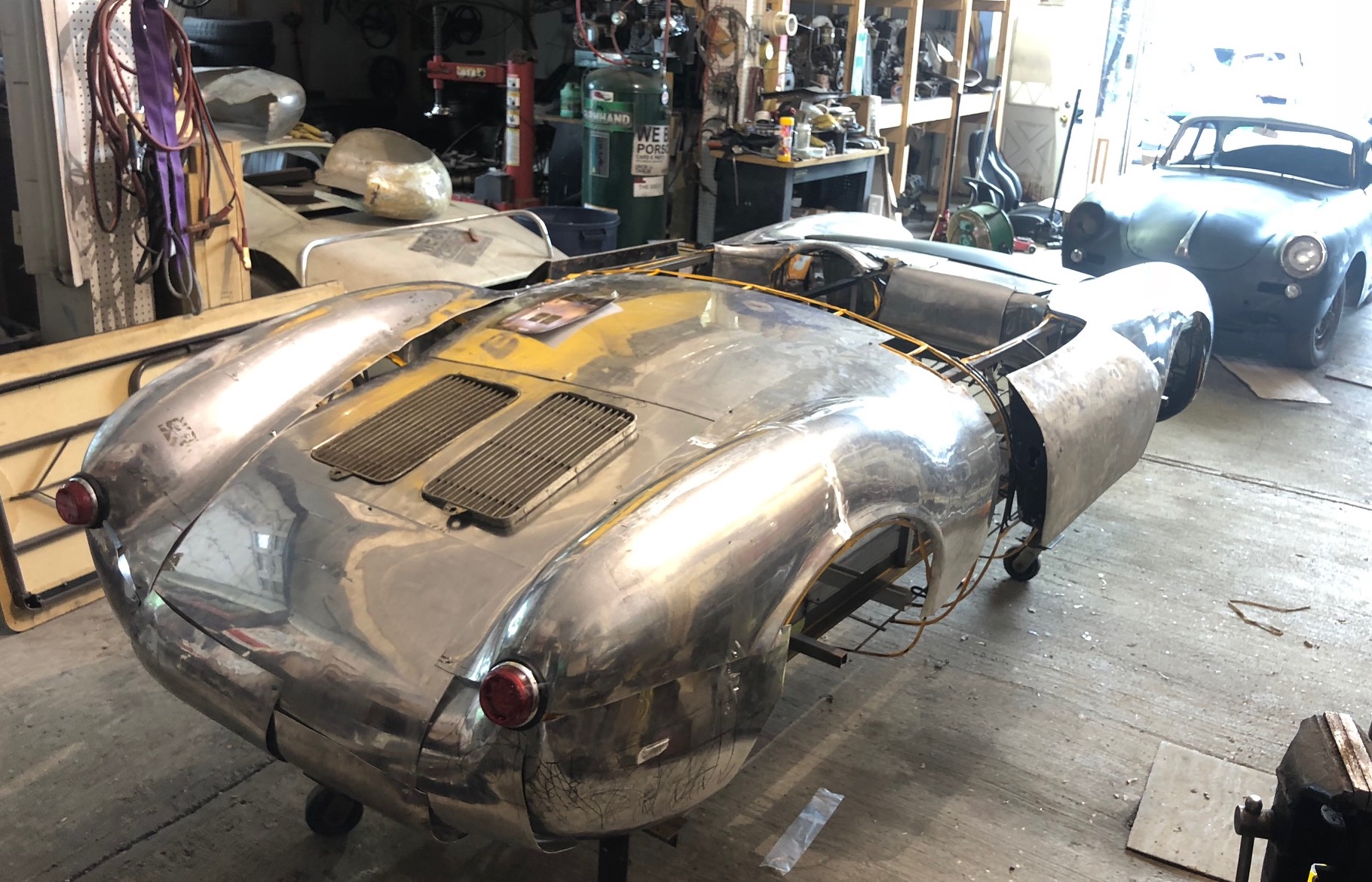

Ok, so the 550 is now at a good stopping point, I can jump back on the 904. If only we didn't have to have jobs, think of the things we could all do!!!

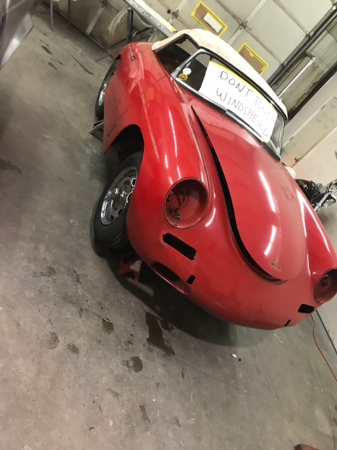

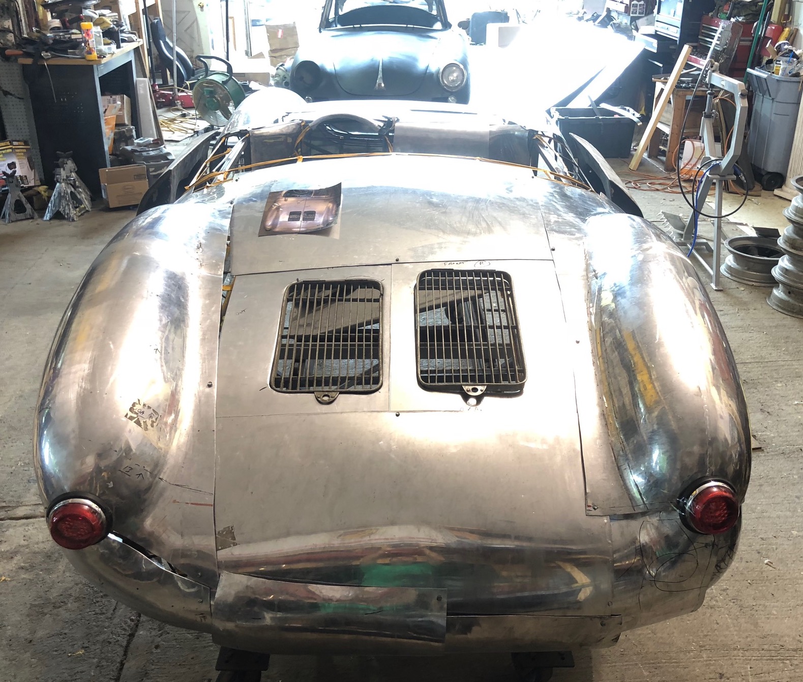

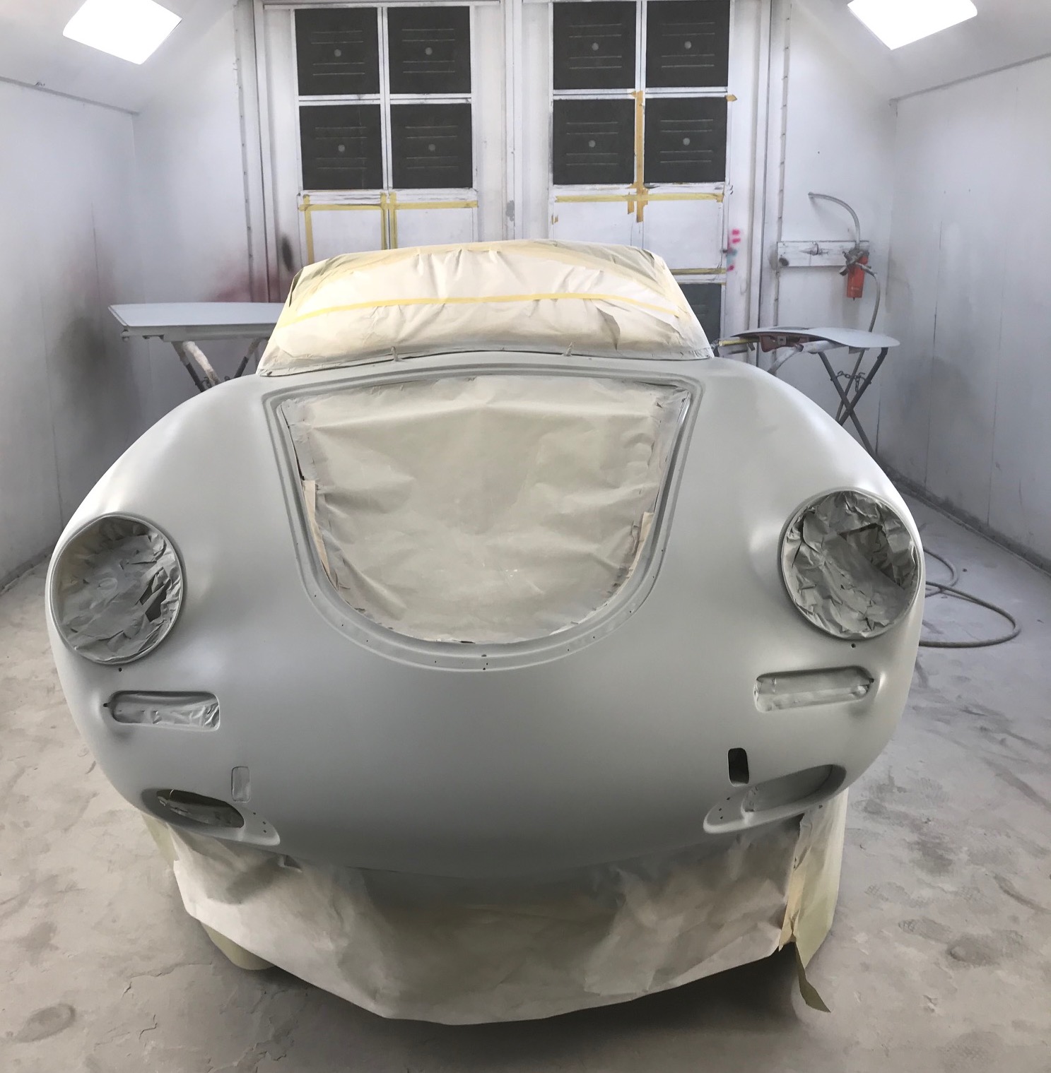

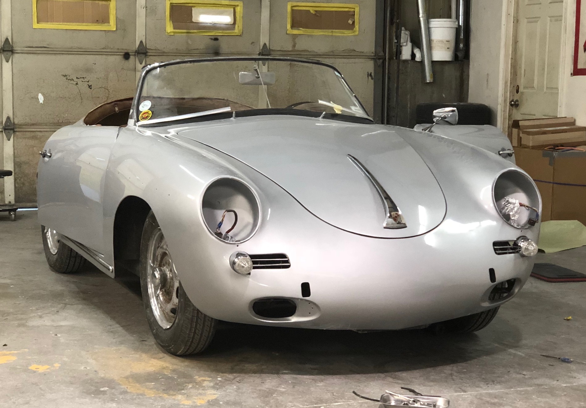

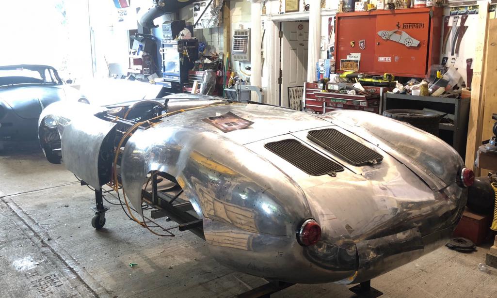

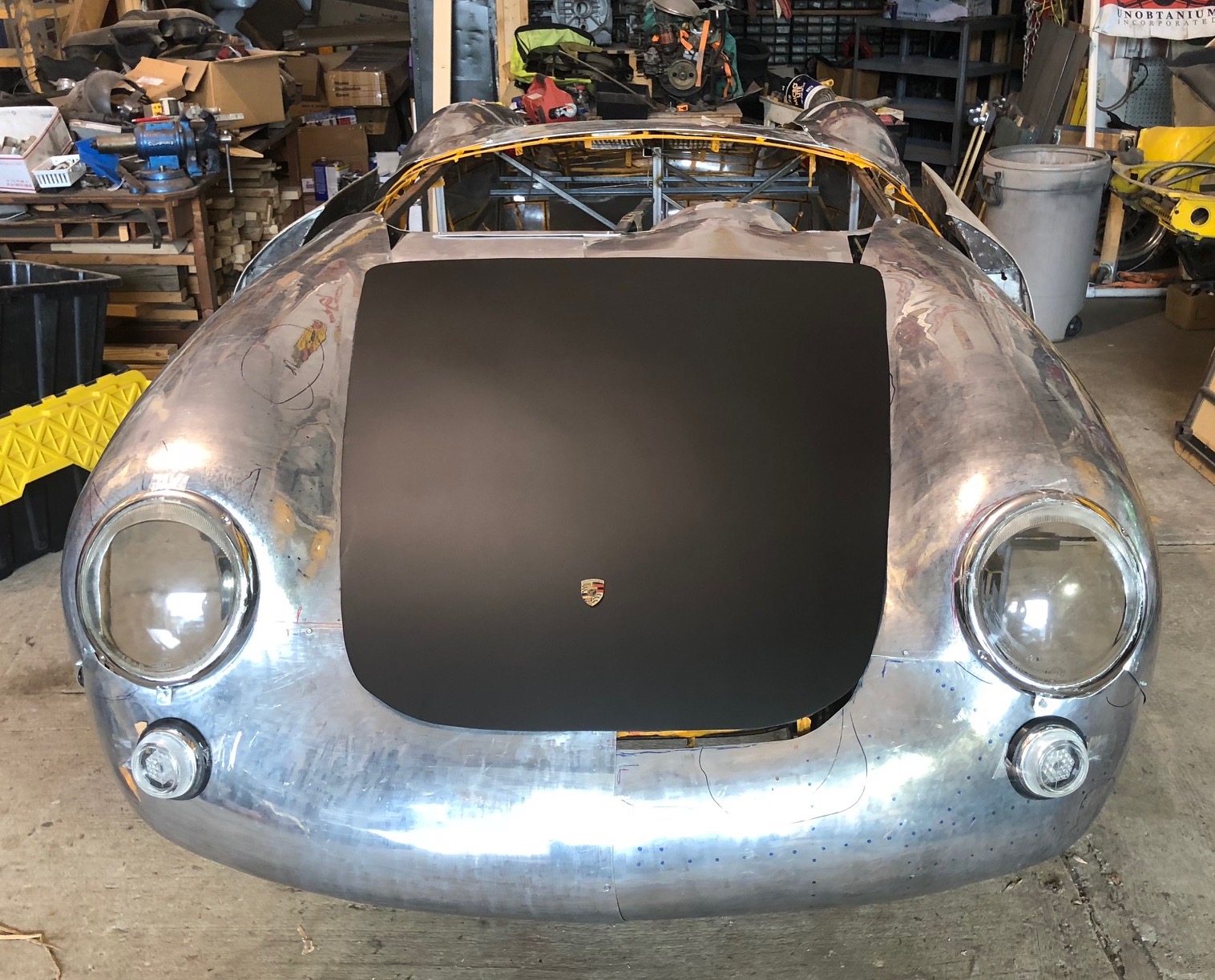

Ok, back at it, now that the Roadster is out of paint, the Mustang is pretty much done and the 550 is at a good stopping point, I will have some time to get back to the 904. I had a good day today, I just need to get the pics done.
Here are some highlights of the other cars.
Attached Image Attached Image Attached Image Attached Image Attached Image Attached Image

Finished Roadster.

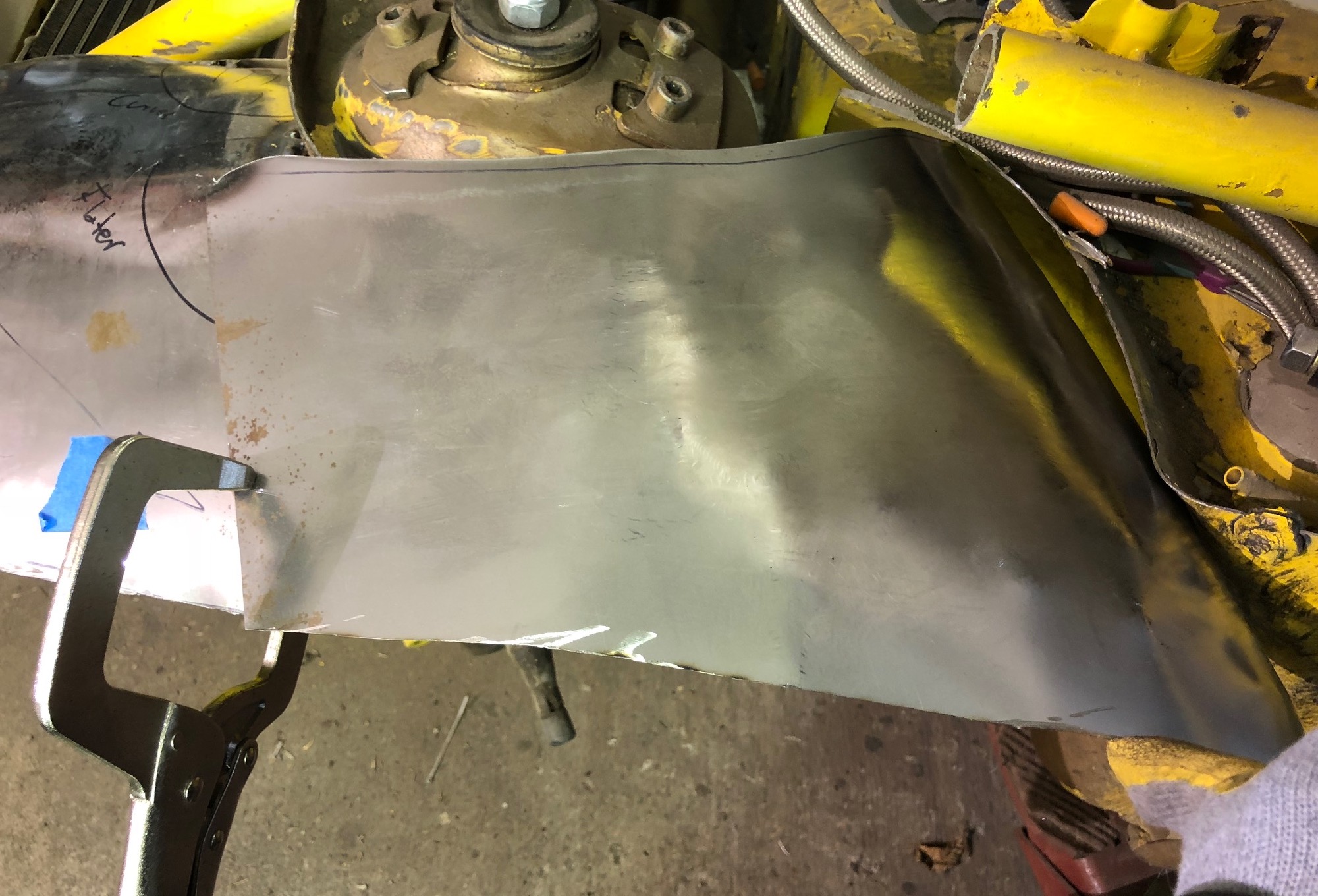

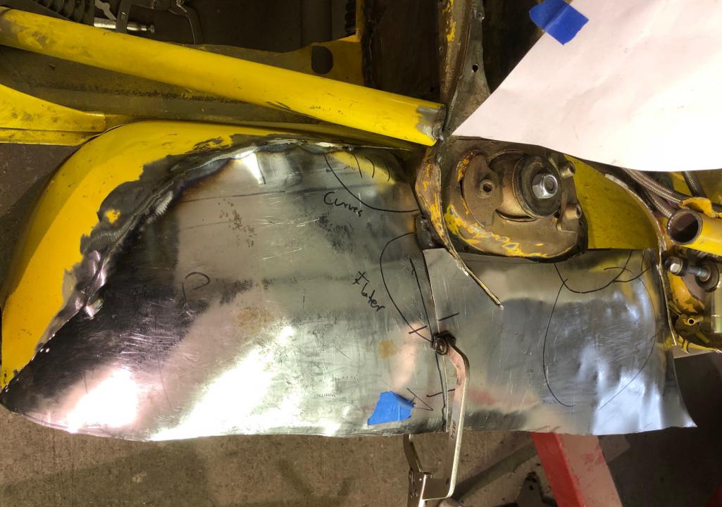

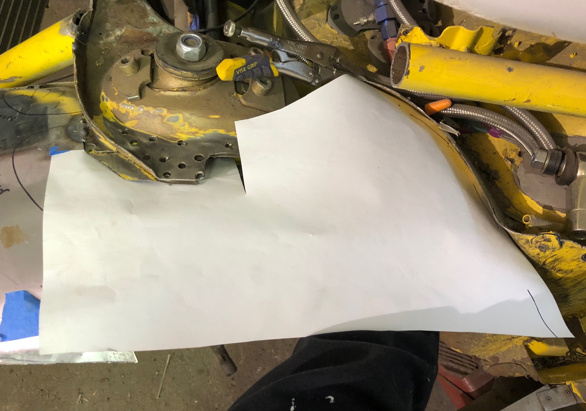

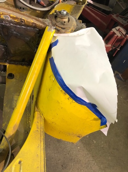

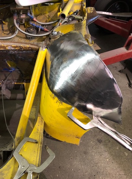

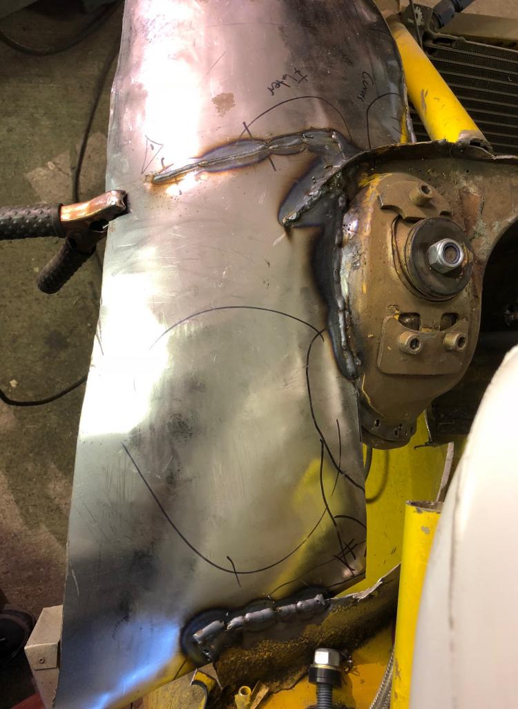

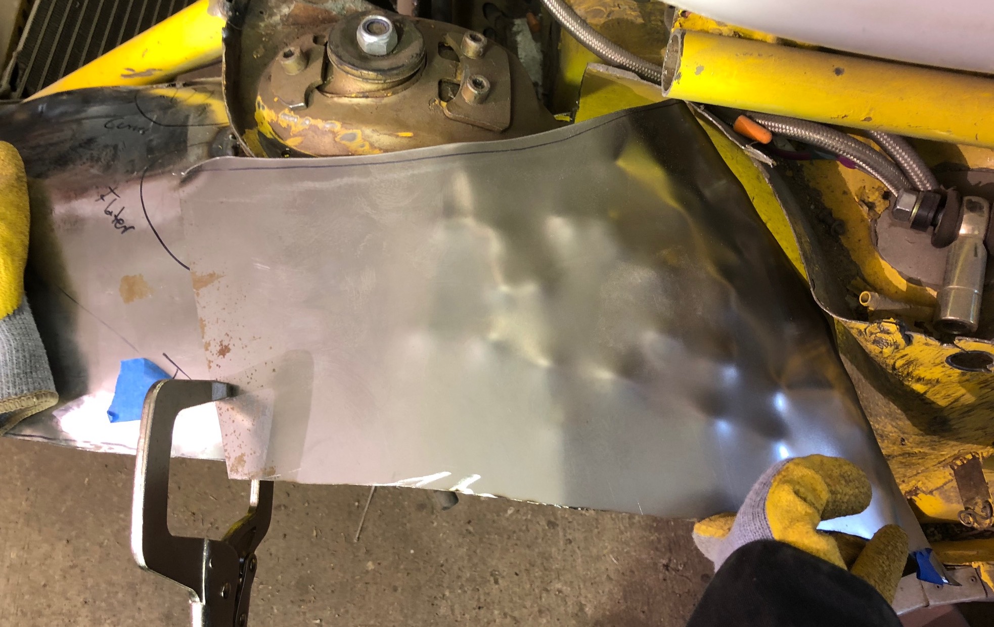

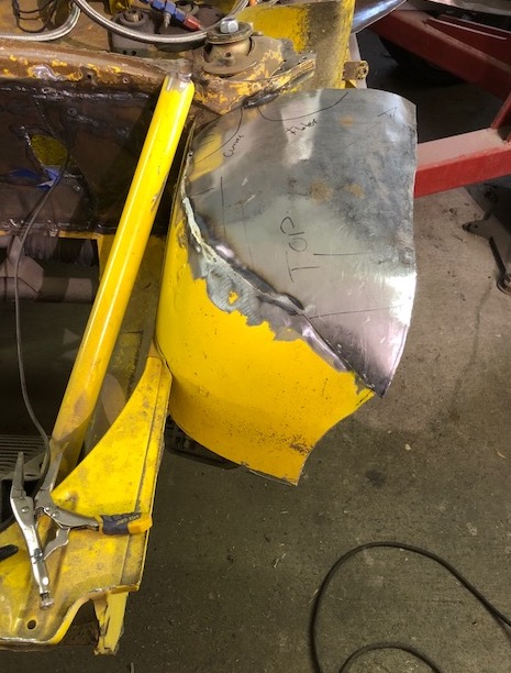

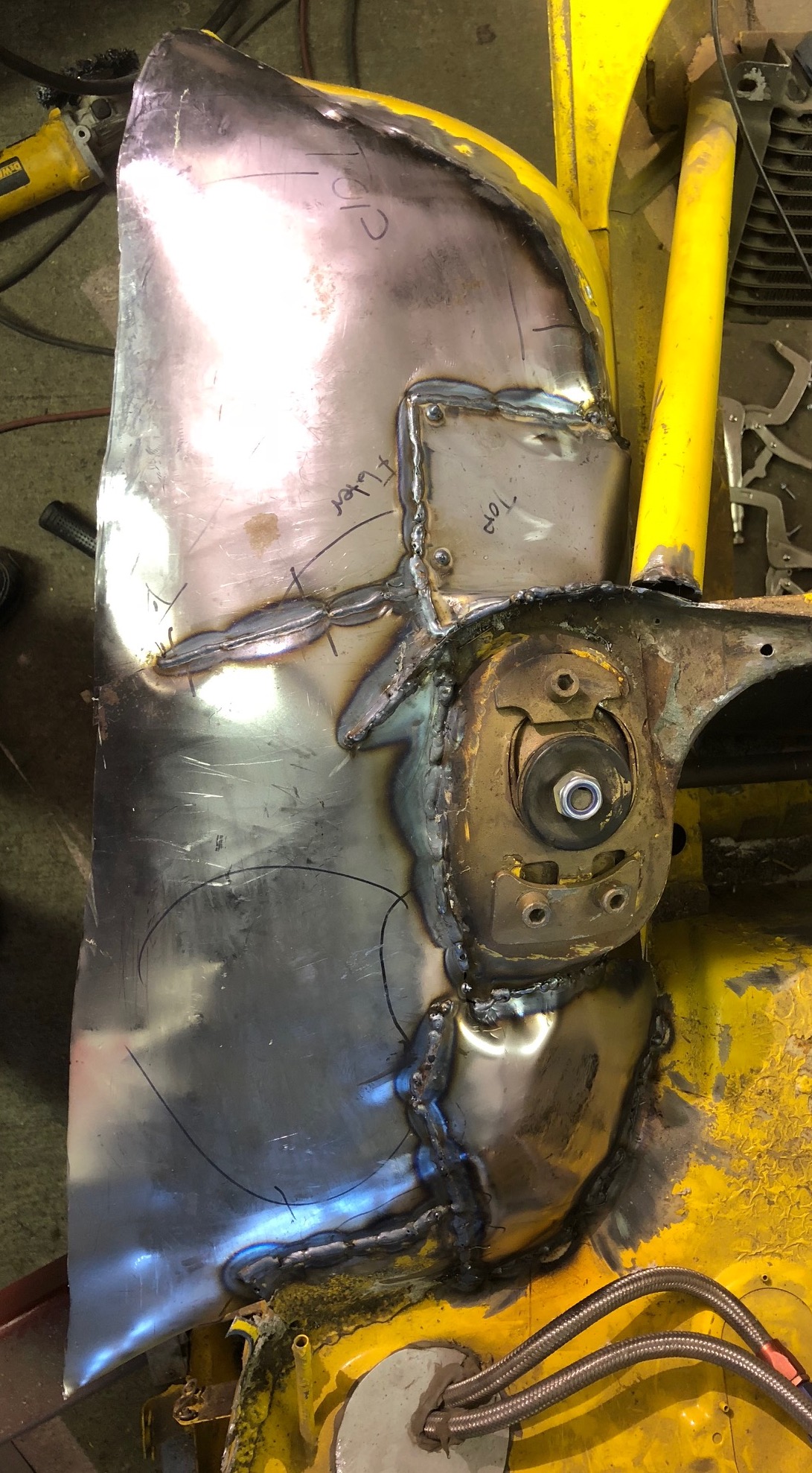

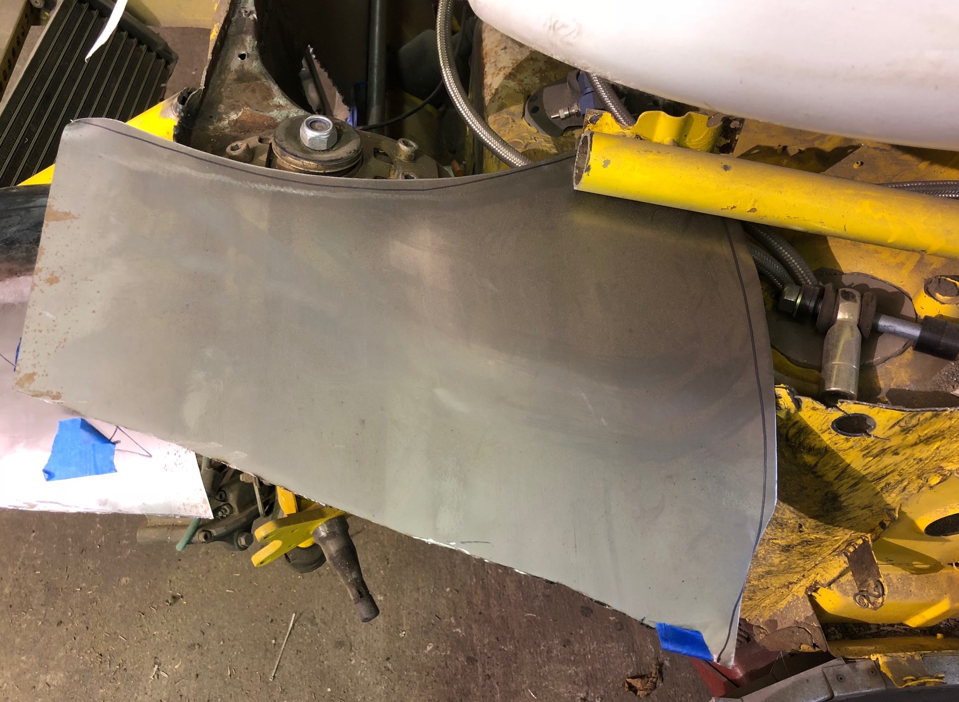

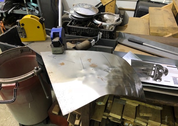

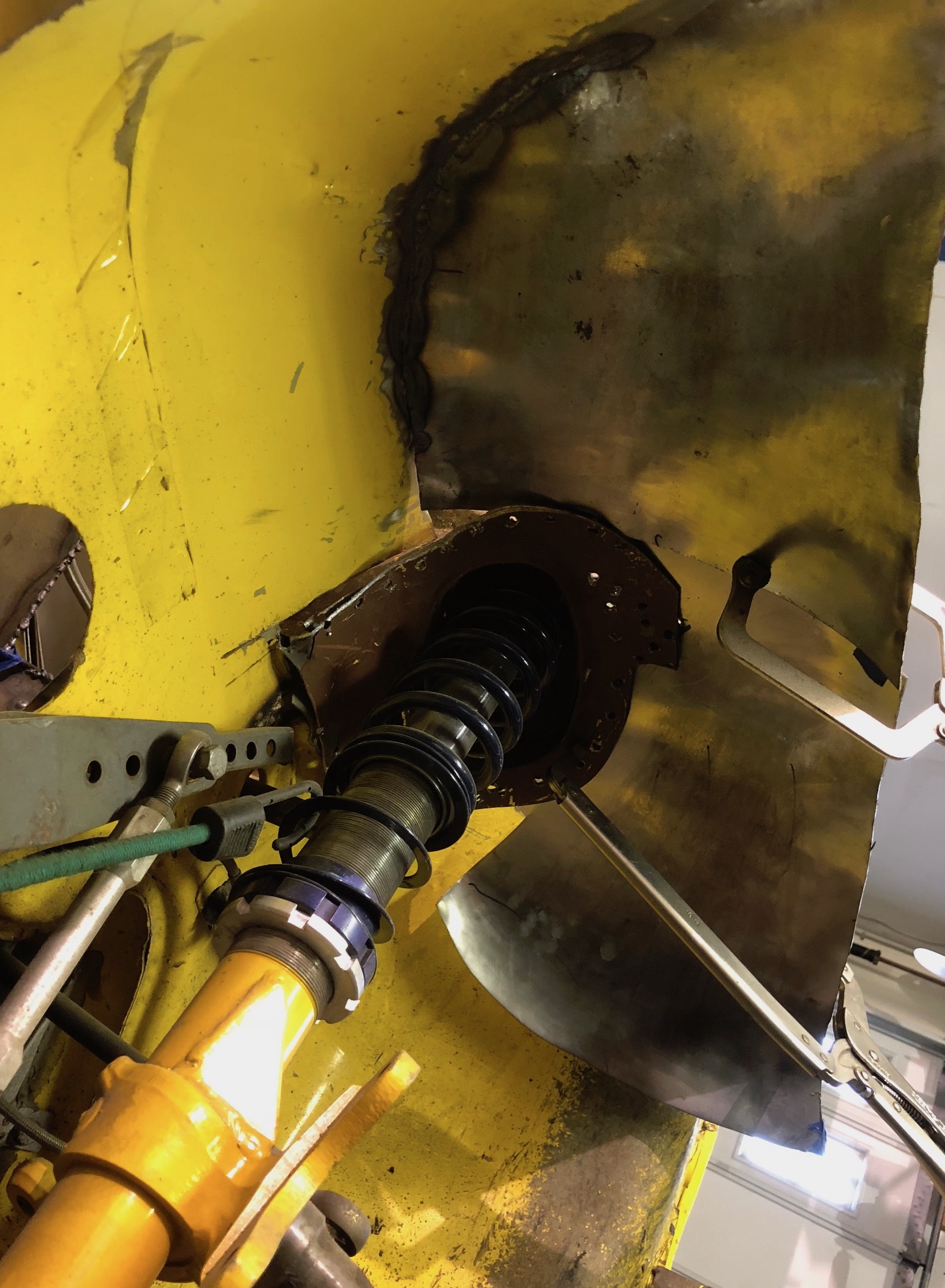

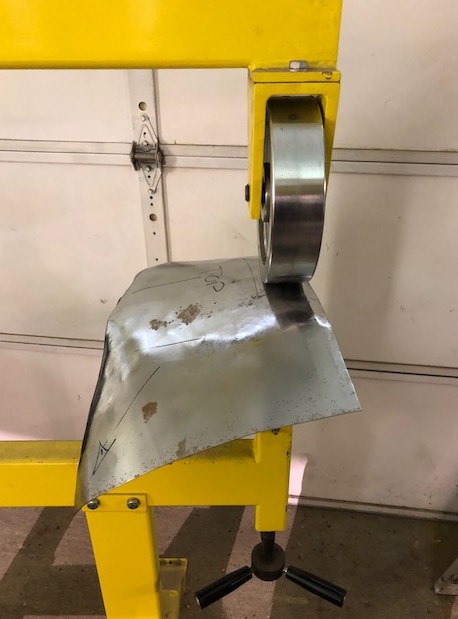

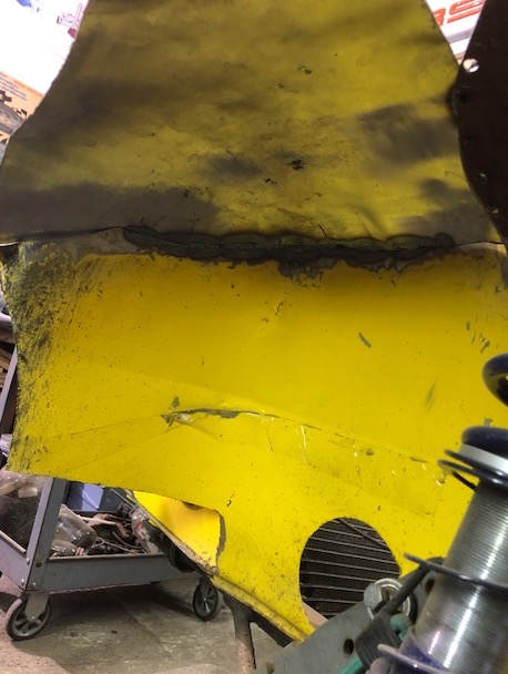

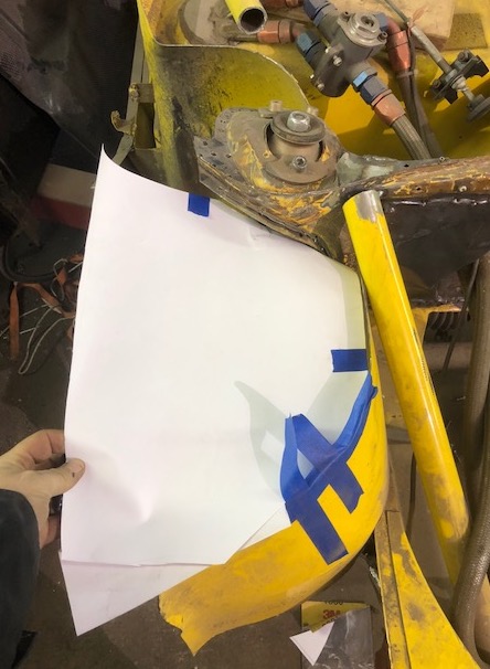

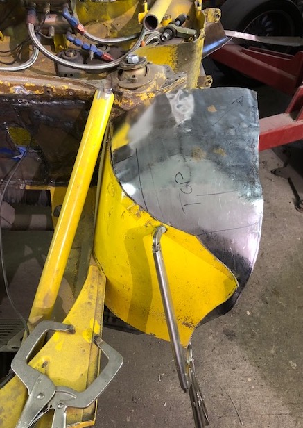

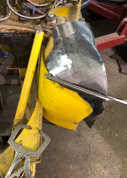

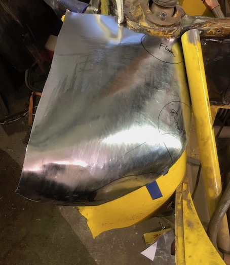

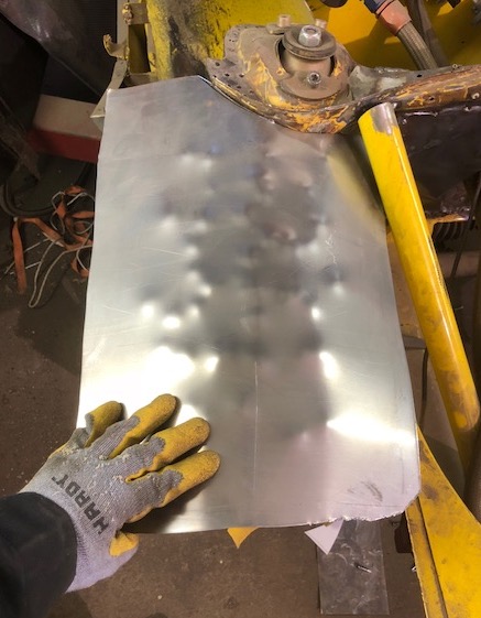

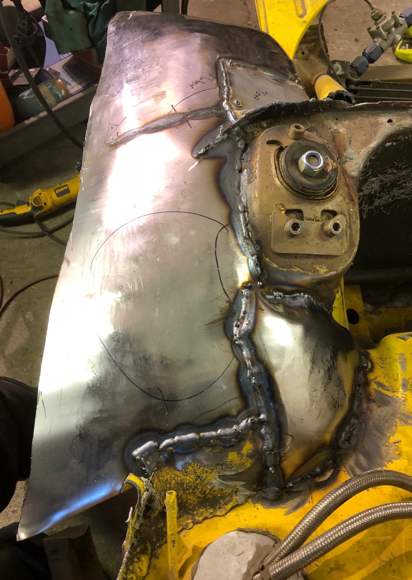

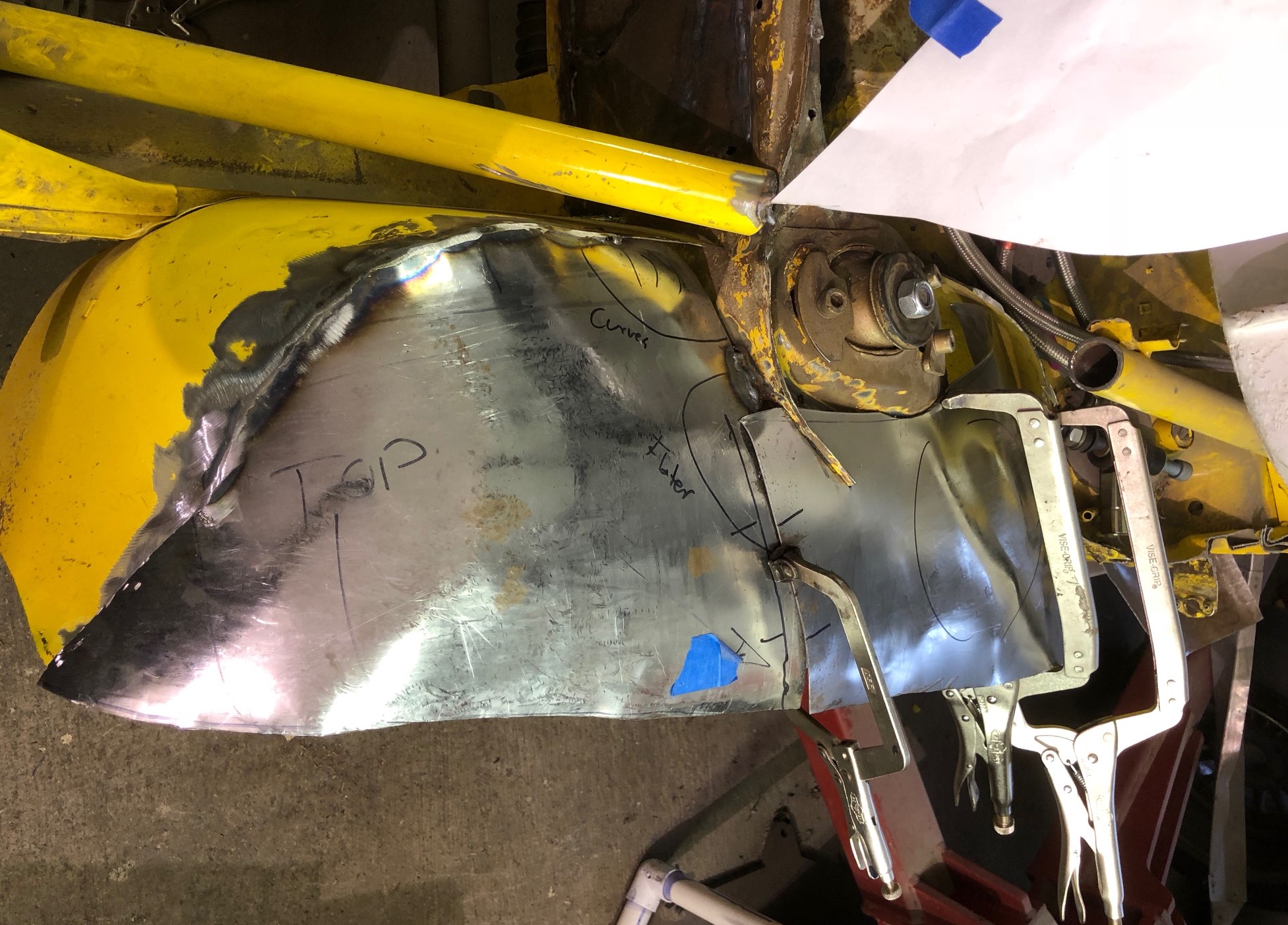

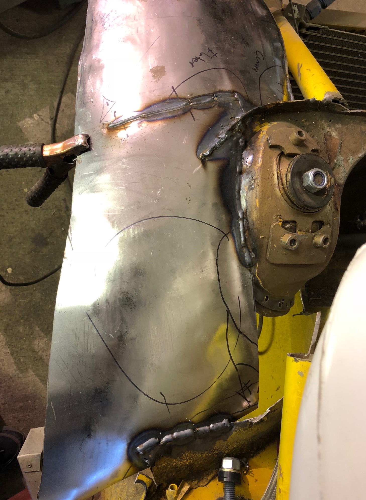

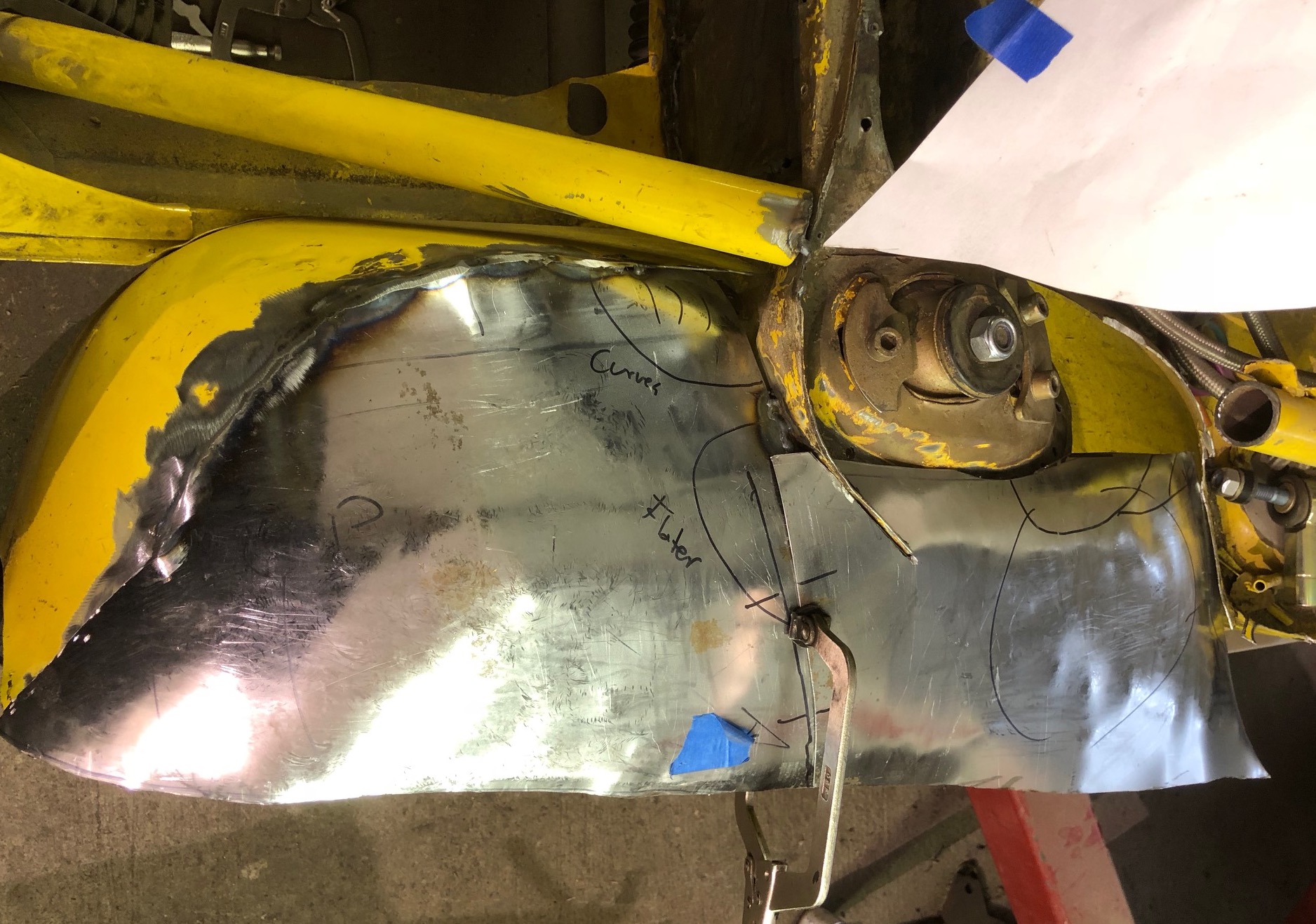

Ok, I worked on the driver's side fender well today, forward of the shock tower. It was a tricky piece because it had two curves, which fought each other in the shaping process. I was able to get shape it and get it welded in place.
Look for more updates on the regular now that my other cars are done or able to be back burnered and with the selling season closing fast. Long cold NY winter days are perfect for beating metal!
Attached Image Attached Image Attached Image Attached Image Attached Image Attached Image Attached Image Attached Image Attached Image Attached Image

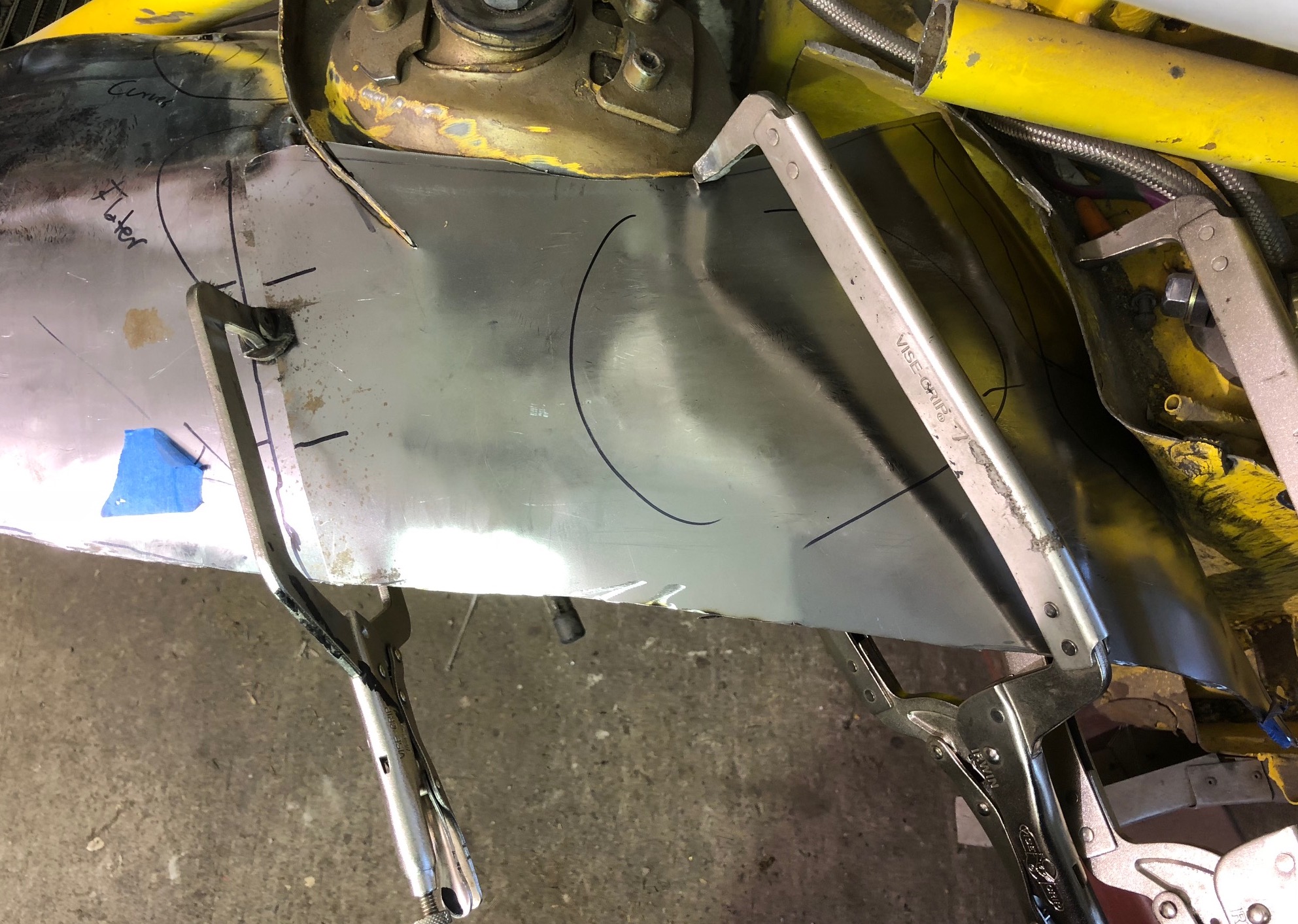

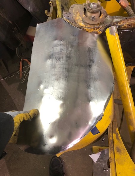

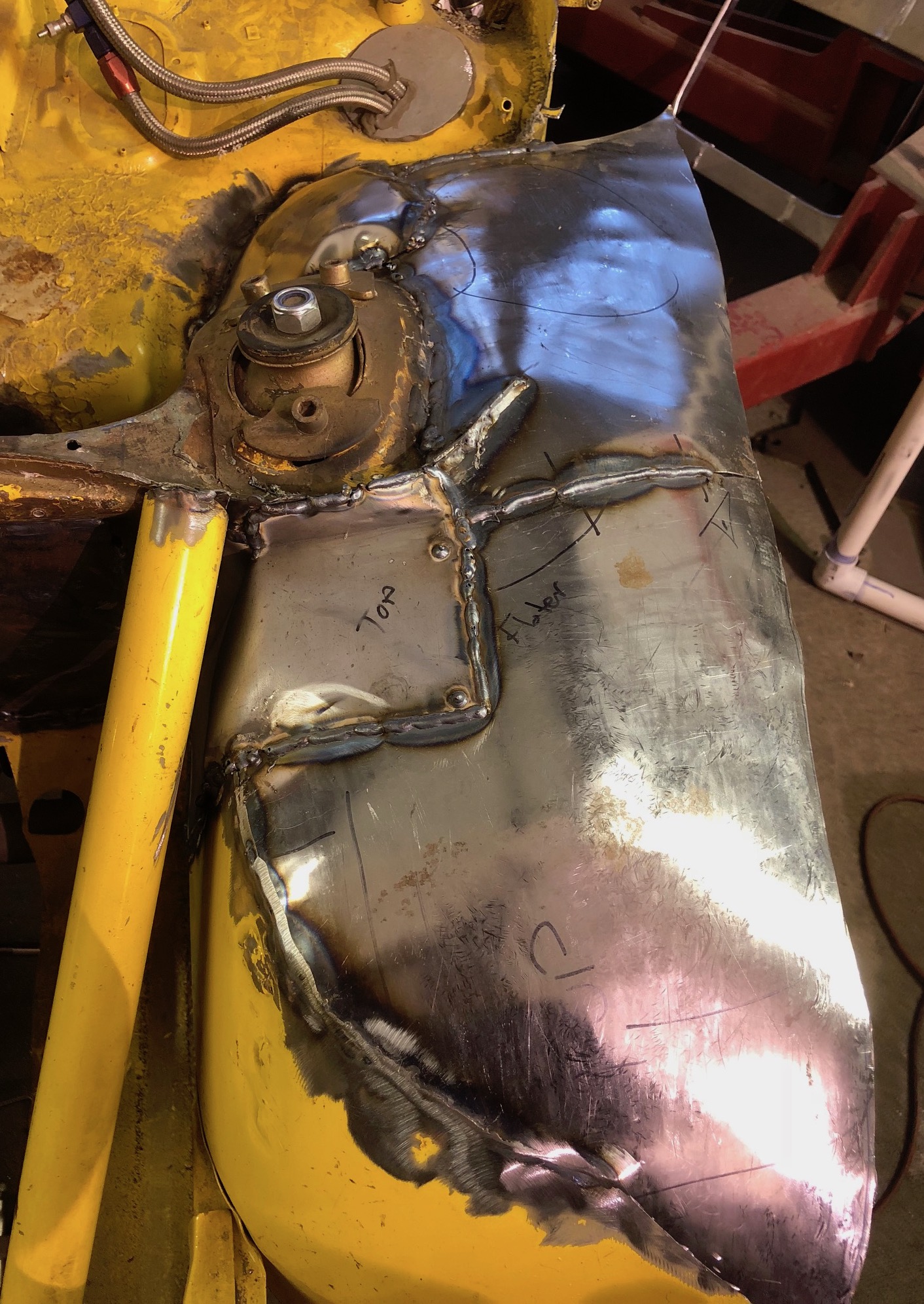

Ok, selling season is officially over, so the personal car fun can go full swing. I was able to shape the rest of the inner fender today, it actually went pretty smooth. I plan to work on it again tomorrow, so stay tuned for welding.

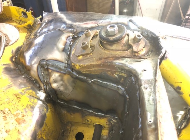

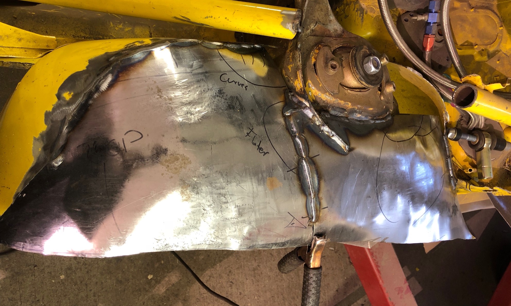

Ok, my hands hurt from pounding metal, but I got most of the fender shaped and welded in. It's ugly but I'm going for strength of the shock tower over beauty. All of this will be covered up by the fiberglass body so unless someone is reading this years from now the work I'm doing now will never see the light of day once the body is on.
Hopefully the passenger side will go faster. That's usually the way it works for me, 1st one is slow, 2nd one is faster.

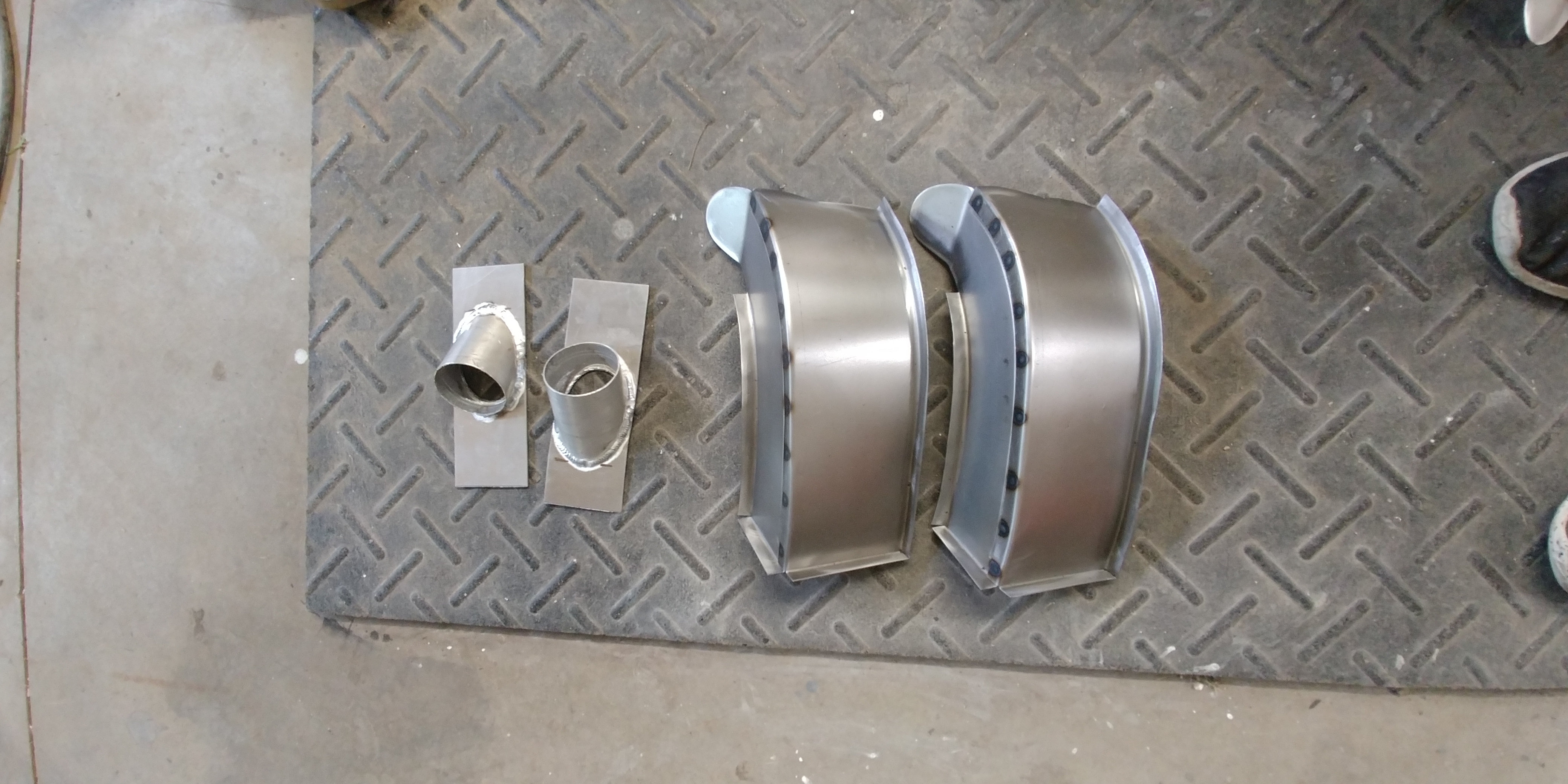

My question is why not just keep it simple and use sharp 90s.. Way easier and if its hidden under glass does the same thing.
Example is this GT oil cockpit cover. Very simple and effective. Attached Image

QUOTE(mb911 @ Dec 7 2018, 12:58 PM) *
You mean use 90 degree right angles instead of shaping the metal in a curve? If that's what you're asking, I'm trying to squeeze maximum space in the wheel well. it's going to be very tight since I lowered the tower and changed the pickup on the strut.
If that's not what you're asking let me know.
mb911
post Dec 7 2018, 03:25 PM
Post #853
Posts: 7,723
Joined: 2-January 09
From: Burlington wi
Member No.: 9,892
QUOTE(Unobtanium-inc @ Dec 7 2018, 01:13 PM) *
Yes thats what I meant.

I got some work done today, finished up the driver's side fender, and was able to move onto the passenger side. I was on the road yesterday and it ended up being a 16 hour day, so I wasn't at 100% today, hopefully I'll get some good time in tomorrow, stay tuned and happy holidays!

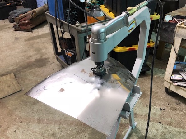

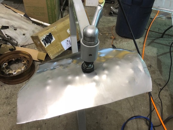

914forme
post Dec 22 2018, 12:25 PM
Post #857
Posts: 3,899
Joined: 24-July 04
From: Dayton, Ohio
Member No.: 2,388

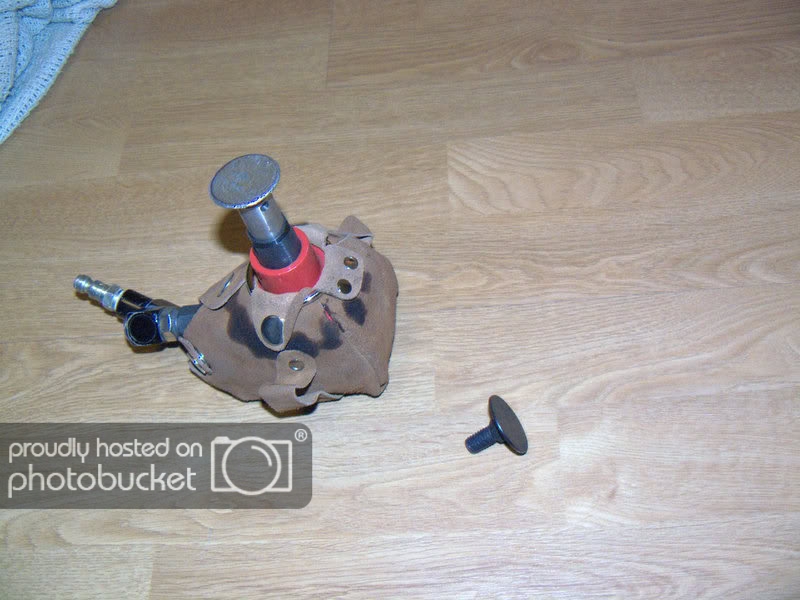

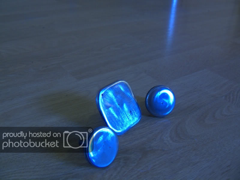

It is used for nailing framing in tight spaces. It is a small hammer in the palm of your hand driven by air. You make a head for the end of it, lots of people use a carriage bolt. This person went all out.
Pictures lifited out of this post credit where credit is due.
Unobtanium-inc
post Dec 22 2018, 12:39 PM
Post #858
Posts: 2,437
Joined: 29-November 06
From: New York
Member No.: 7,276
QUOTE(914forme @ Dec 22 2018, 10:25 AM) *
So it's like a small power hammer when you convert it for metal shaping?
bbrock
post Dec 22 2018, 12:49 PM
Post #859
Posts: 5,269
Joined: 17-February 17
From: Montana
Member No.: 20,845
You can also use a rivet gun with the same type of head. Look up "flow forming rivet gun" on Youtube for some good videos.
rhodyguy
post Dec 22 2018, 01:42 PM
Post #860
Posts: 22,252
Joined: 2-March 03
From: Orion's Bell. The BELL!
Member No.: 378

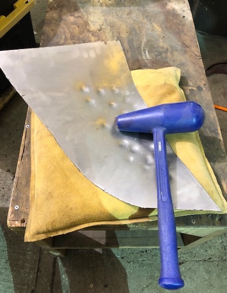

Actually for use in tight quarters when framing with a nail gun or hammer won't work. The little Tico nails that usually result in pain. You stick a nail in the biz end and simply push. The nail drives in with no smashed fingers. You substitute a carriage bolt or other as shown in that link. Watching John Kelly, who used to sell shrinking discs also, move metal around with one was amazing. He would back up the area to be worked with a leather bag filled with sand.
