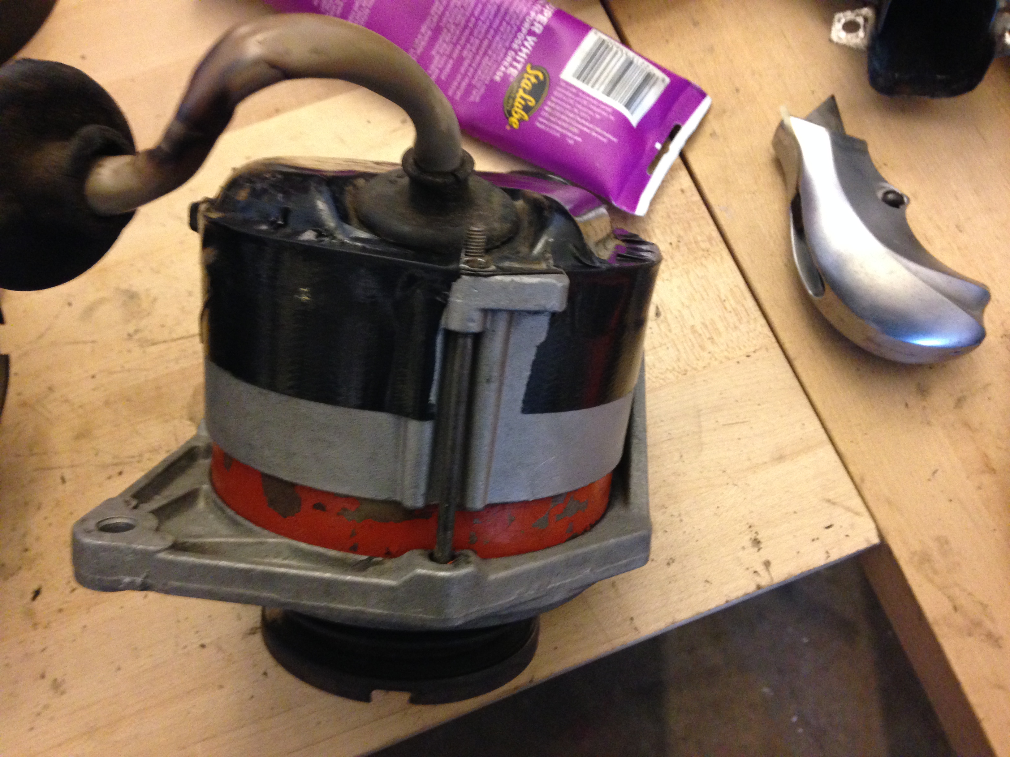

#16
Member ![]() ![]() Group: Members Posts: 62 Joined: 1-January 15 From: San Francisco Member No.: 18,277 Region Association: Northern California ![]() |
One thing.
The alternator I bought had openings on the sides of it in two places on the back side--where the back cover with the wires goes on. I'm guessing that this alternator had a different back cover, or maybe some little rubber bits that filled the gaps. It looked to me like the original had taken some effort to seal off the hot/wet side of the alternator, so I duct taped the gaps on my alternator. I bit hoopty for a Porsche, I know. Are these openings supposed to be closed? Are there rubber bits? A different cover? Attached thumbnail(s) ![]() |

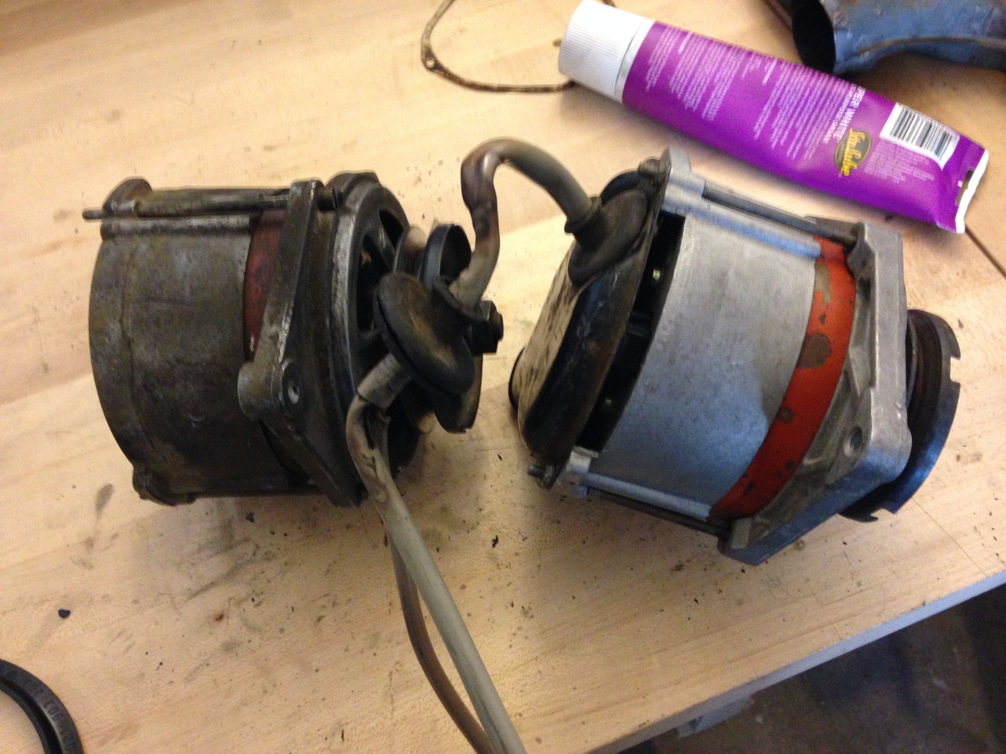

72 IXXIV |
#17
both alternators side by side
