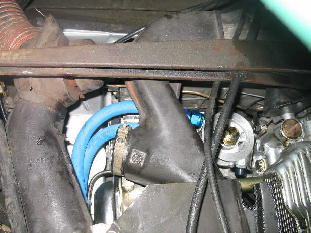

I finally got around to installing my aux oil cooler. Used a Mocal thermostatic sandwich plate and Derale fan/cooler. Aeroquip blue hose with -8AN push on ends connected it up. Hose runs next to valve cover and zip ties to the wire bales (should make valve adjustments interesting). I removed the heater J tube on the passenger side to route the cooler lines. Since that J tube was just capped anyway, I just removed the J tube and put the cap where the J tube normall attaches to the heat exchangers. So there is no change to the heating system.

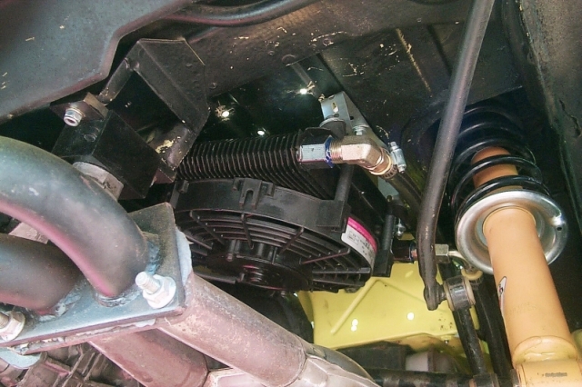

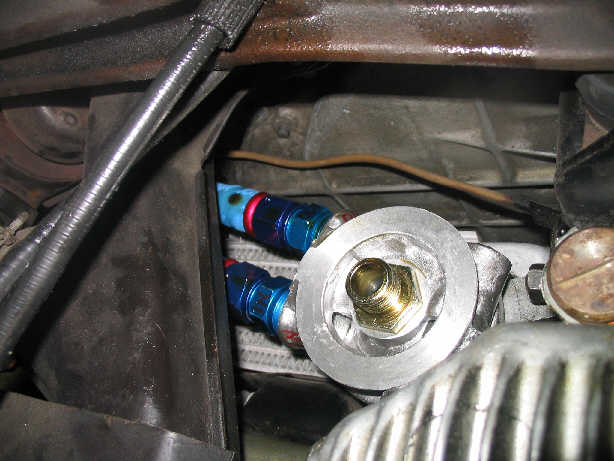

And here is the sandwich adapter showing oil line routing.

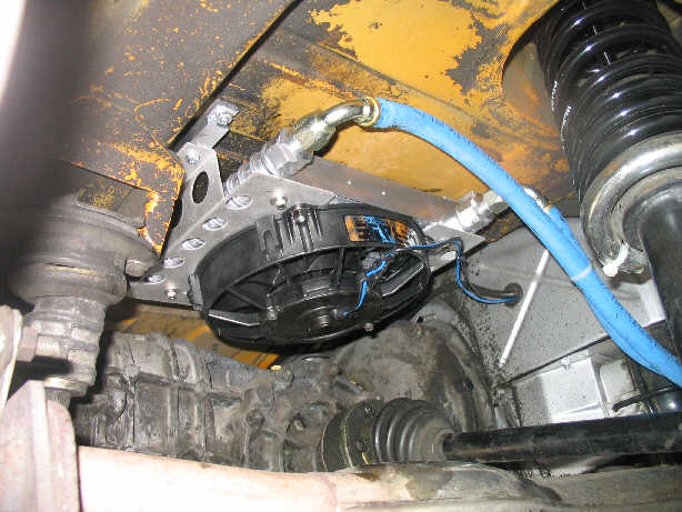

more

QUOTE (Demick @ Feb 13 2005, 07:43 PM)
more
so you're blowing the hot air from your internal oil cooler right onto the feed/return line for the external cooler.
then you proceed to blow hot air from under the car over a cooler that has no natural air flow what-so-ever.
did you mount it flush with the rear trunk? it looks like it. if so, where is the air from the fan supposed to go? the fan won't create any air-flow this way (IMG:http://www.914world.com/bbs2/html/emoticons/screwy.gif)
*if* you see any drop in engine temp with that setup, it's most likely due to the fact that you're adding 3 or 4 quarts of oil to the system.
i doubt that cooler setup will do anything for 'ya ...
(IMG:http://www.914world.com/bbs2/html/emoticons/idea.gif) Andy

Air does not blow onto the cooler lines. There is 1" of space between the cooler and the trunk floor (twice the space required by the cooler). Air is pulled down through the cooler - not up. Cooler and lines only add .6 quarts of capacity to the system.
I believe it will do what I need (provide 20 degrees of additional oil cooling on a hot day when doing 80mph for extended periods).

QUOTE (Demick @ Feb 13 2005, 08:07 PM)
ok, am i nuts?
i see the 2 oil lines running right under the stock oil cooler where they exit/enter the sandwich adapter ...
(IMG:http://www.914world.com/bbs2/html/emoticons/confused24.gif) Andy
ok, then you're sucking hot air through a hot cooler instead of blowing it, big difference ...
i doubt you'll see a 20 deg. drop with that setup, especially not on a hot day.
but hey, that's just MHO ...
(IMG:http://www.914world.com/bbs2/html/emoticons/biggrin.gif) Andy
I think it will work, too.
Nice job Demick. (IMG:http://www.914world.com/bbs2/html/emoticons/clap.gif)
As long as the air passing over the cooler is a lower temp than the oil, it will offer cooling.
KT

Andy - you are right - the lines run under the stock cooler. But that is the only place to run them with a sandwich adapter. Still, the air exhausting the cooler is still cooler than the oil temp in the hoses. So it cannot further heat the oil.
The air going through the aux cooler is not ambient, but it isn't 200F either. If I am stopped at a stoplight, it probably gets pretty hot under there - but I don't need extra cooling when I'm stopped. I need it when I'm going down the freeway at 90mph or whatever. At higher speeds, there is lots of turbulence and fresh air gets mixed with exhaust air etc.
Here's an example. Drive down the freeway on a warm day. Now pull over and open the rear trunk and feel how warm the floor of the trunk is. Is it warm? Yes. Is it 200F? Nope. Maybe 120 or 130F. The air under the trunk is pretty much the same temperature as the floor of the trunk. So that air is still about 100F cooler than the oil. Should be able to do an adequate job of cooling.
Is it good enough for a 20 minute session at Thunderhill on a 105 degree day? Nope. But I didn't intend it for that.
Aaron: The sandwich adapter was about $90. The price per foot of hose was just over $3. But the real savings on this type of hose is the fittings. The 90 degree elbows were $7 each as opposed to nearly $20 each if I had used the traditional Aeroquip reusable hose ends.

Demick,
I have a similar setup and have been happy with it.
It the oil lines bother you too much in that location, you might try running them the way I did.
Since you already removed the passenger J pipe, run the oil lines up into the engine compartment, then stright back, exiting out 2 holes cut into the rear engine sheet metal. This will keep them out of the way.
That's assumming you have room in the engine compartment.
I put red circles on your picture to show where the would exit.

Tommy: Yes, I considered running the hoses throught the engine compartment, but with F.I., there's a bunch of stuff in the way.
J.P.: The blue hose is meant for socketless fittings with no hose clamps. Good to 300psi. More than 4 times what I will ever see. Like Tommy says, hose clamps will actually cause problems rather than solve them.
